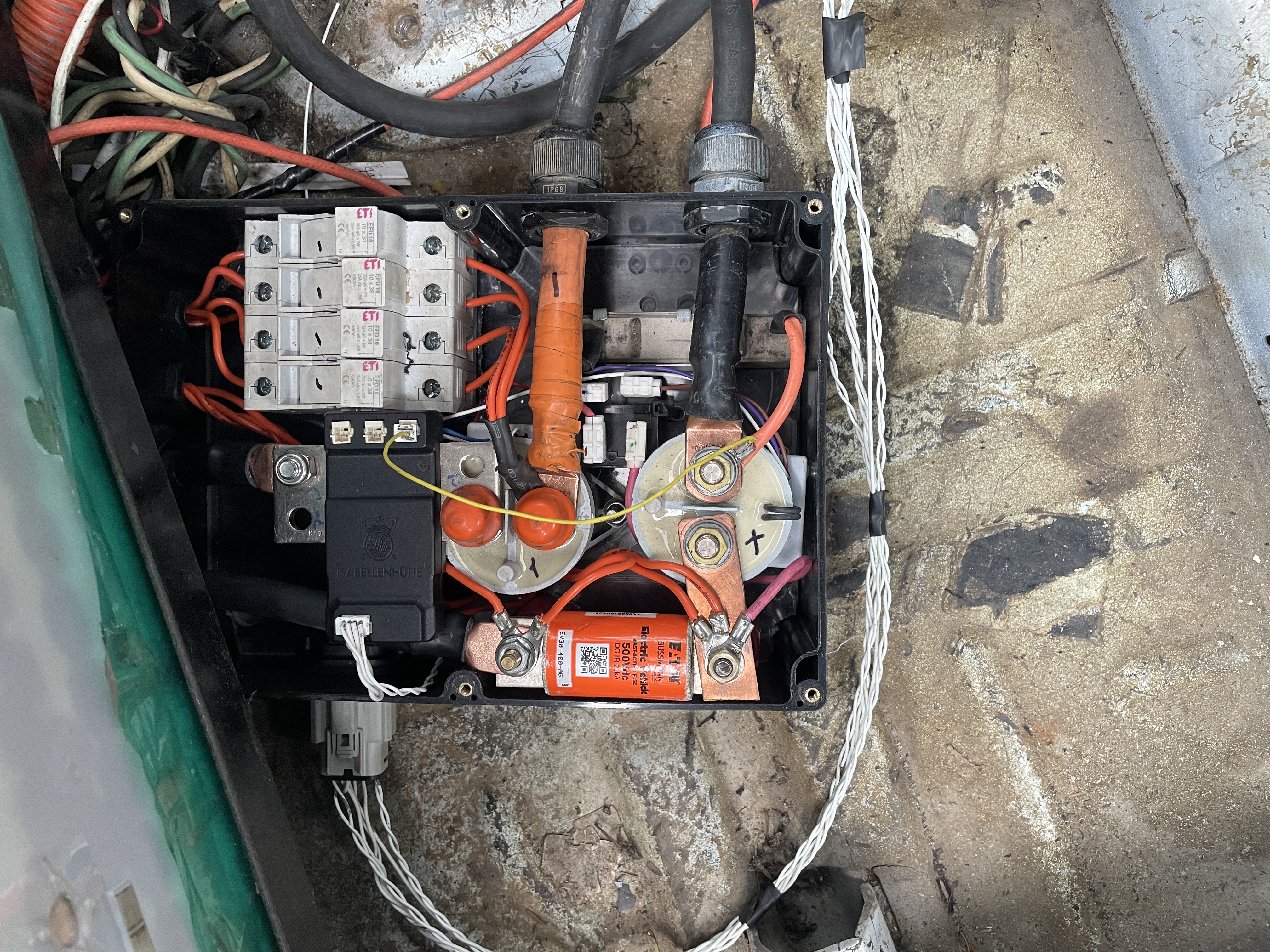

Re: [DRIVING] leaf powered 1983 Subaru BRAT (dual outlander WIP)
okay played around the inverter can setting abit to no effect.
then disconnected the dcdc can from can2
and we are back!
with the transmission in neutral, i slightly pressed the throttle, and the motor spins up... too quick and it takes off. yikes.
pull the for/rev switch to neutral and instant regen slows it down then what i presume an over current event.
not sure as i was logged into the zombie interface, not the inverter.

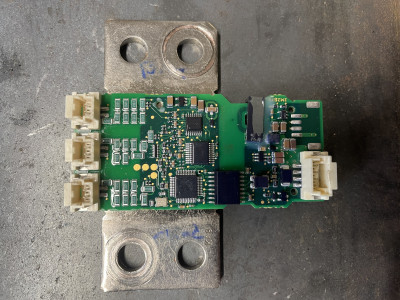

start everything back up....and precharge fail....hmm okay not getting proper reading in the web interface. opened up the contactor box, the shunt on the negative contactor terminal is a little loose. yikes.
tighten that back up, run the sequence and looks like i killed the shunt. its not providing proper udc data.
2 steps forward 1 step back.
arhhggg.

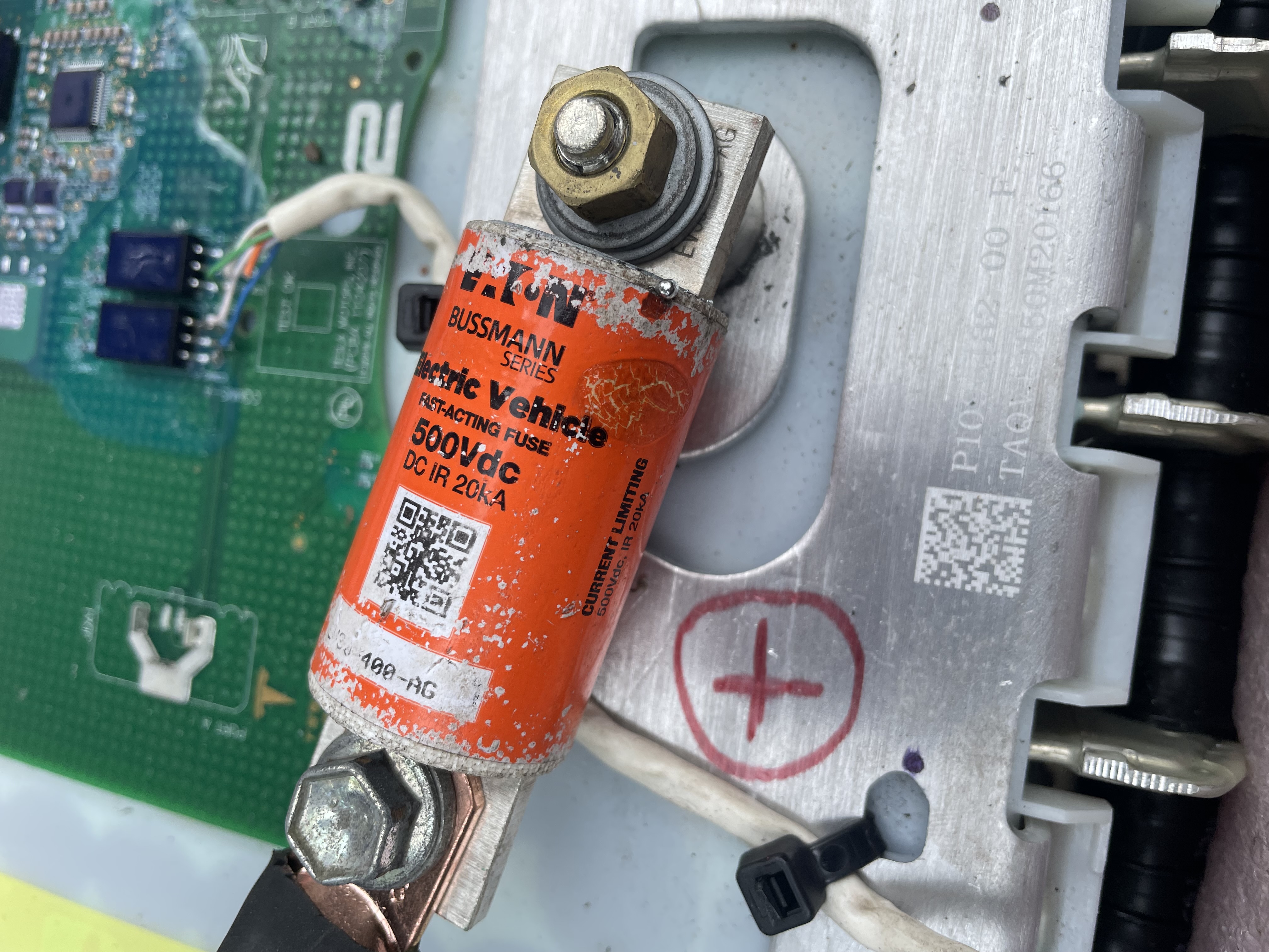

Okay so nope! I blew my mid pack fuse

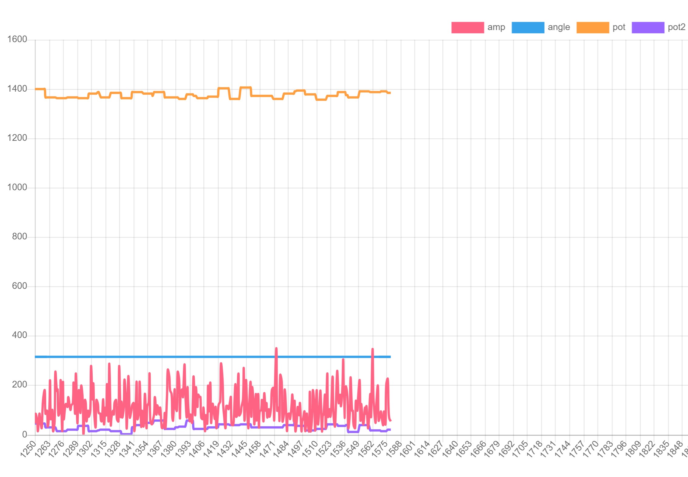

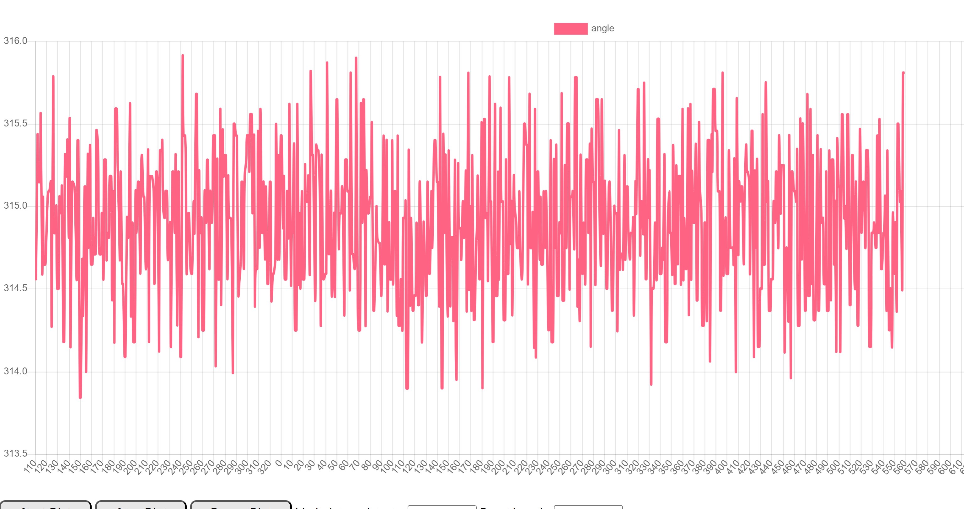

took a closer look at how the inverter is functioning when in drive.
current firmware is 5.32
i'm getting pluses /oscillations in the motor rpm when applying a little bit of throttle (with transmission in neutral) and the same (lurching) when in gear.
this happens regardless of throttle over can, or throttle directly connected to the inverter.
i loaded johu leaf prams viewtopic.php?p=63866#p63866 in case i had some strange tune.
made no difference.
ill down grade back to 5.27 to see if theres any change.
made no difference.
another stupid mistake. i loaded 5.32 SIN instead of FOC.
loaded up 5.27 FOC. fired it up. click/ pop sound moment i touch the throttle. desat.
lots of noise on everything. doing a full shut down and reset it will slightly spin moment i select drive, then desat.
plots are with inverter on and no HV. ill take the zombie out of the equation. its currently handling the contactors.

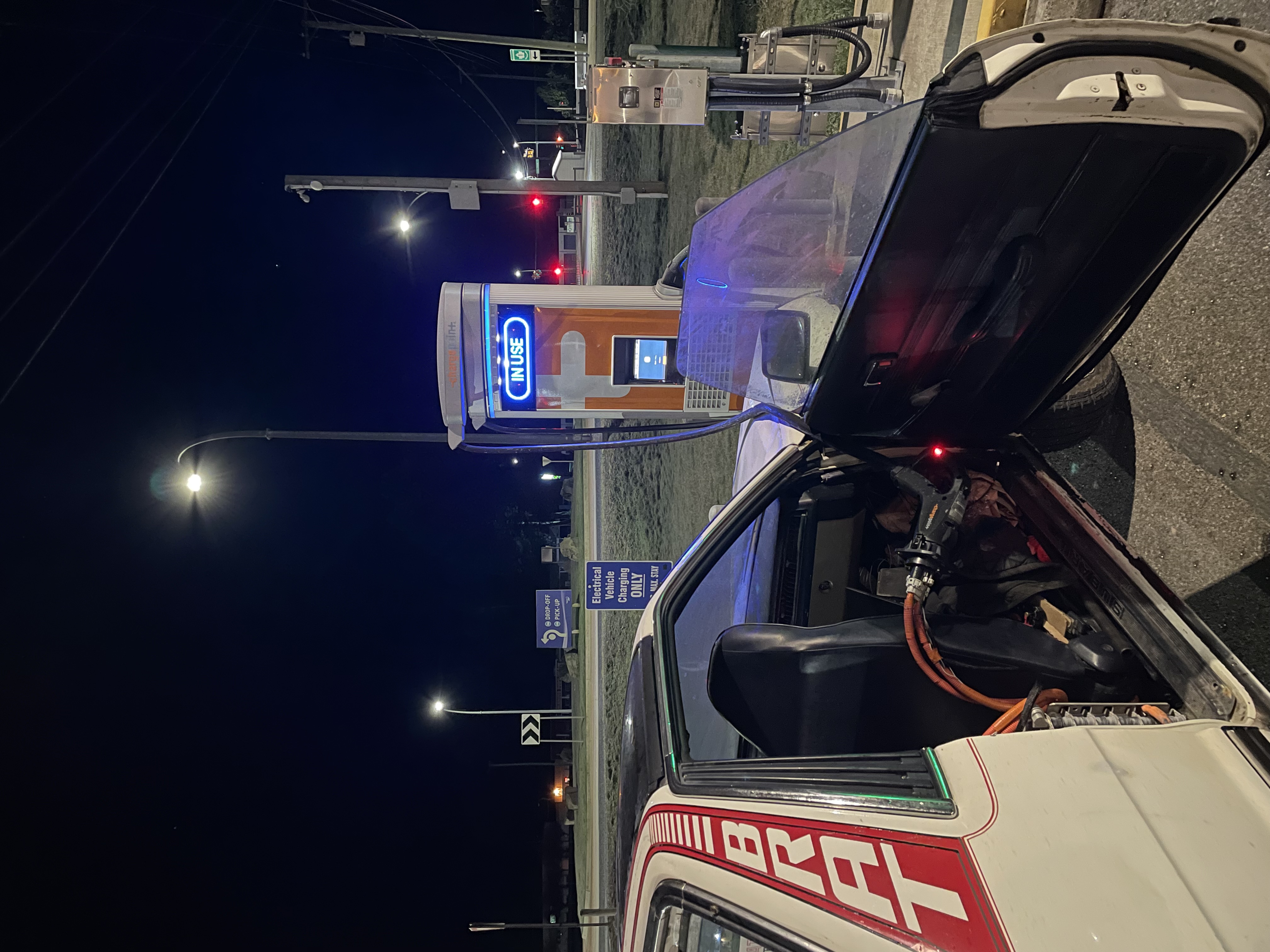

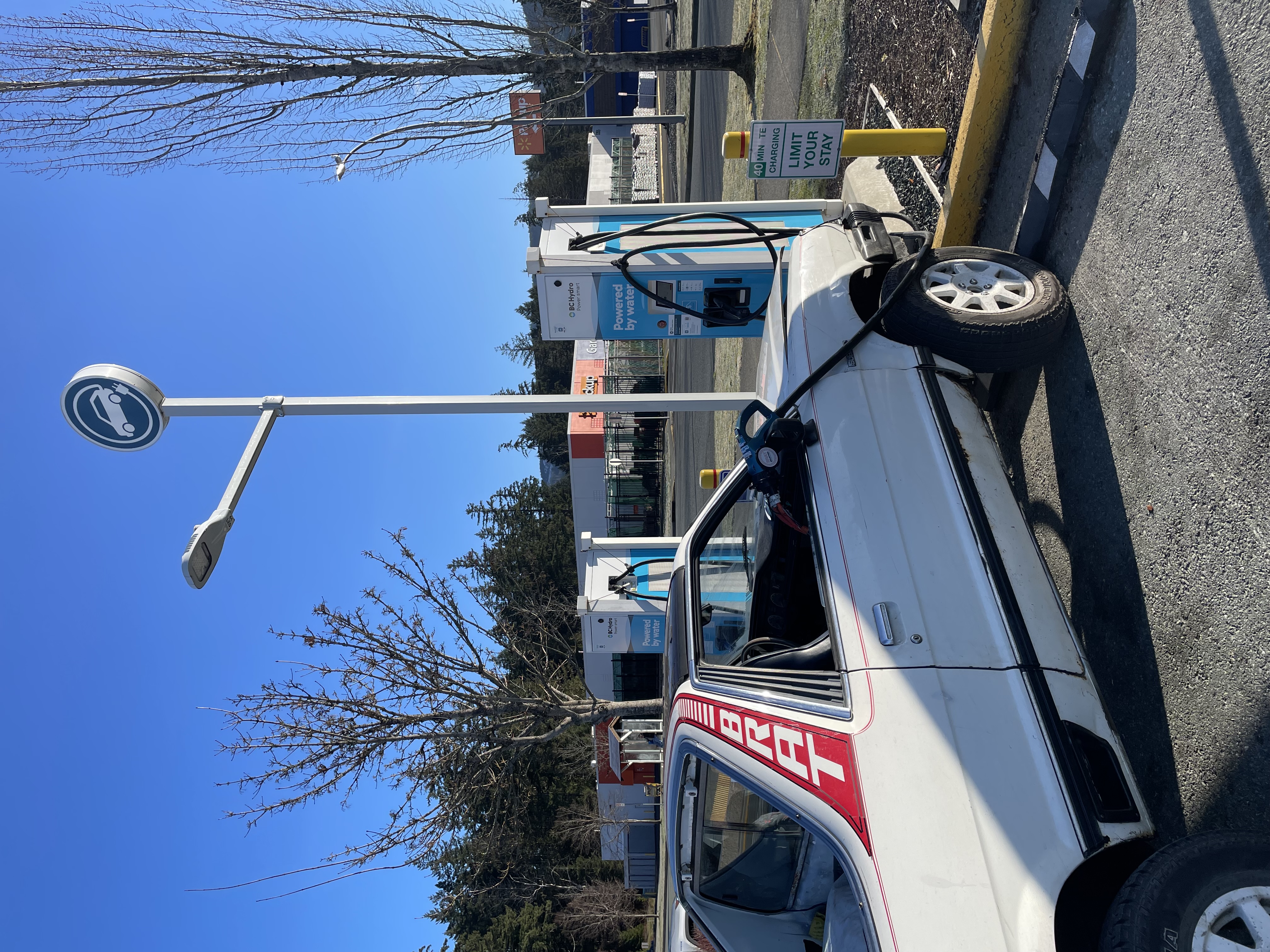

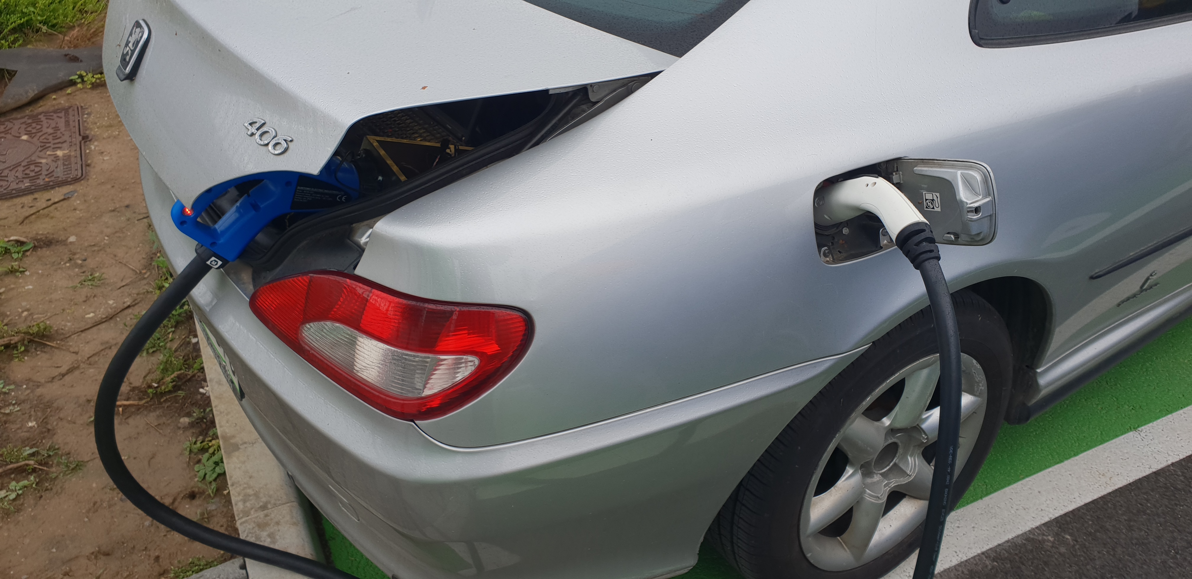

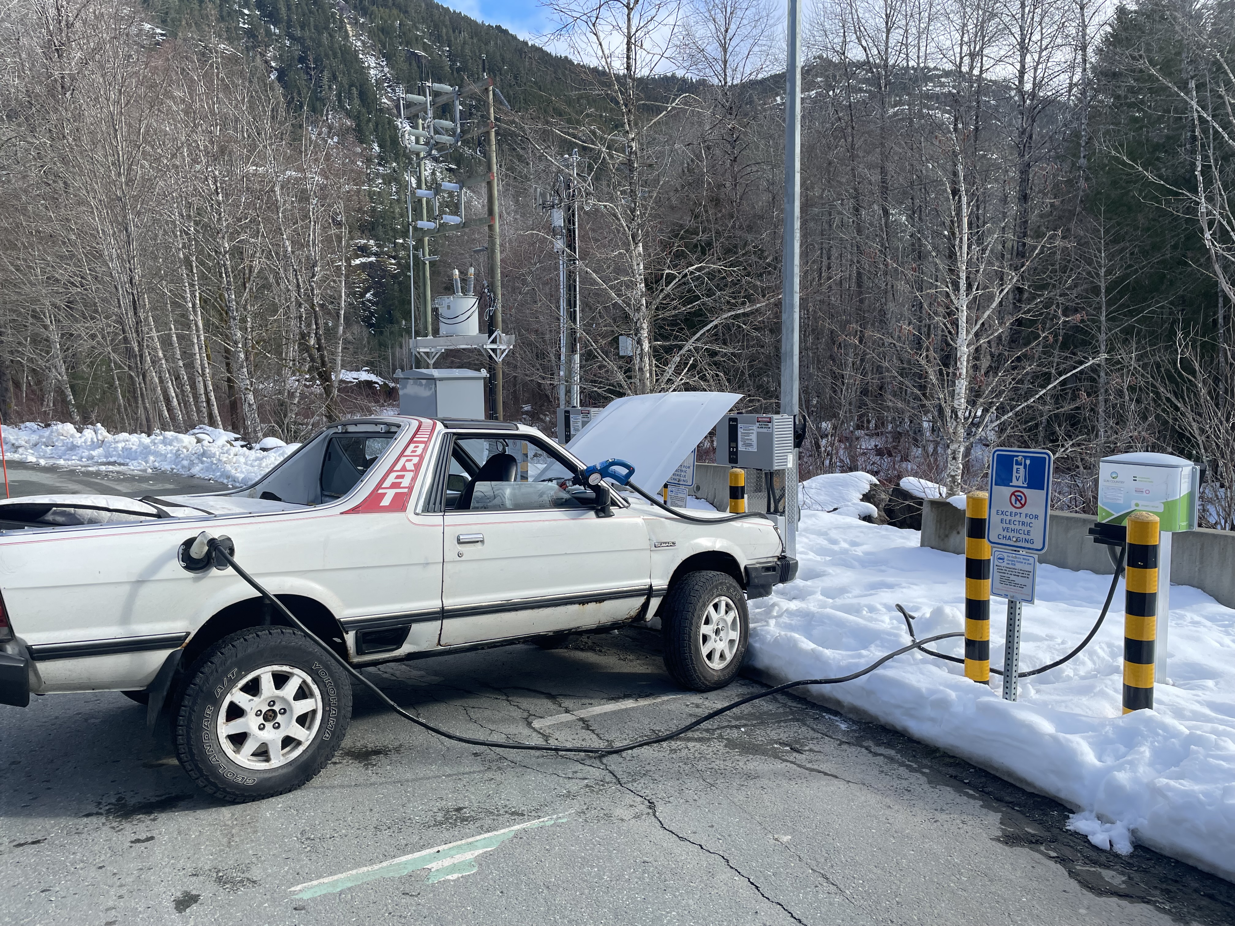

Just finished a 370km drive. Smooth driving.
And got CHAdeMO working with zombie.
First station (charge hub)charged me for time but provided 0 power.
The bc hydro dc fast charger(abb) worked great!
There’s a remote delta 25kwh fast charger at a rest stop. along with a 48amp level 2….
I feel like I’m cheating

Some more CHAdeMO updates:
FLO dc fast chargers result in an over voltage fault.
I’m guessing this is a result of the isolation test?
During the charger start up udc voltage rises up to 650v.
Shortly after starting the charge, the zombie shut it all down.
some of the newer bc hydro station seem to do the same thing!

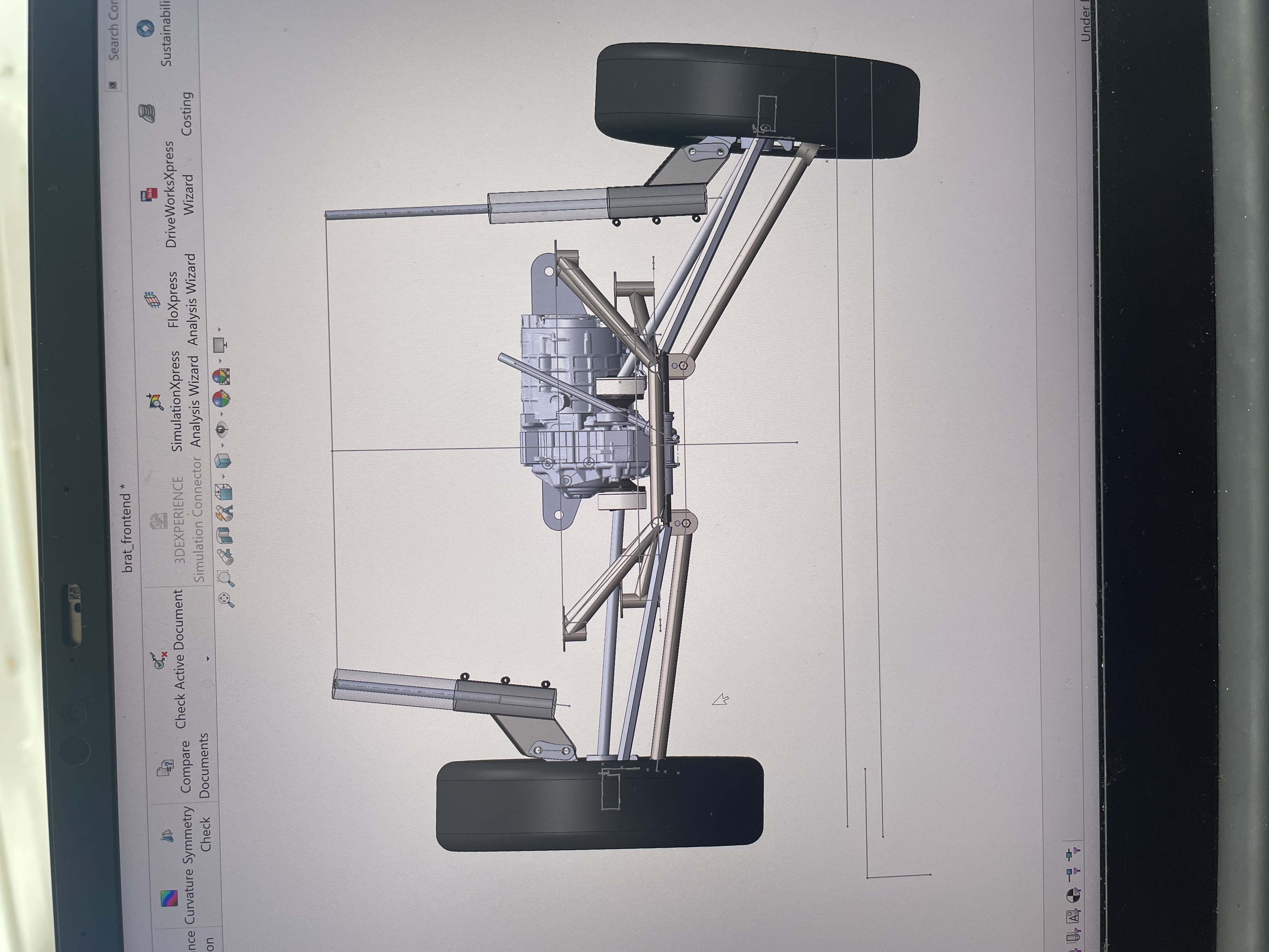

Brat is pretty beat up at this point. I’m slowly gathering the bits for v2.
here’s where I’m at with the new front end:
new subframe to accommodate the outlander drive unit and fixes the suspension geometry.
Packing is definitely getting tight be everything should fit where I’d like.
subframe will be 1.25 od .83 wall dom about 15lbs
Huge weigh reduction from the stamped steel Subaru subframe that’s around 35-40lb

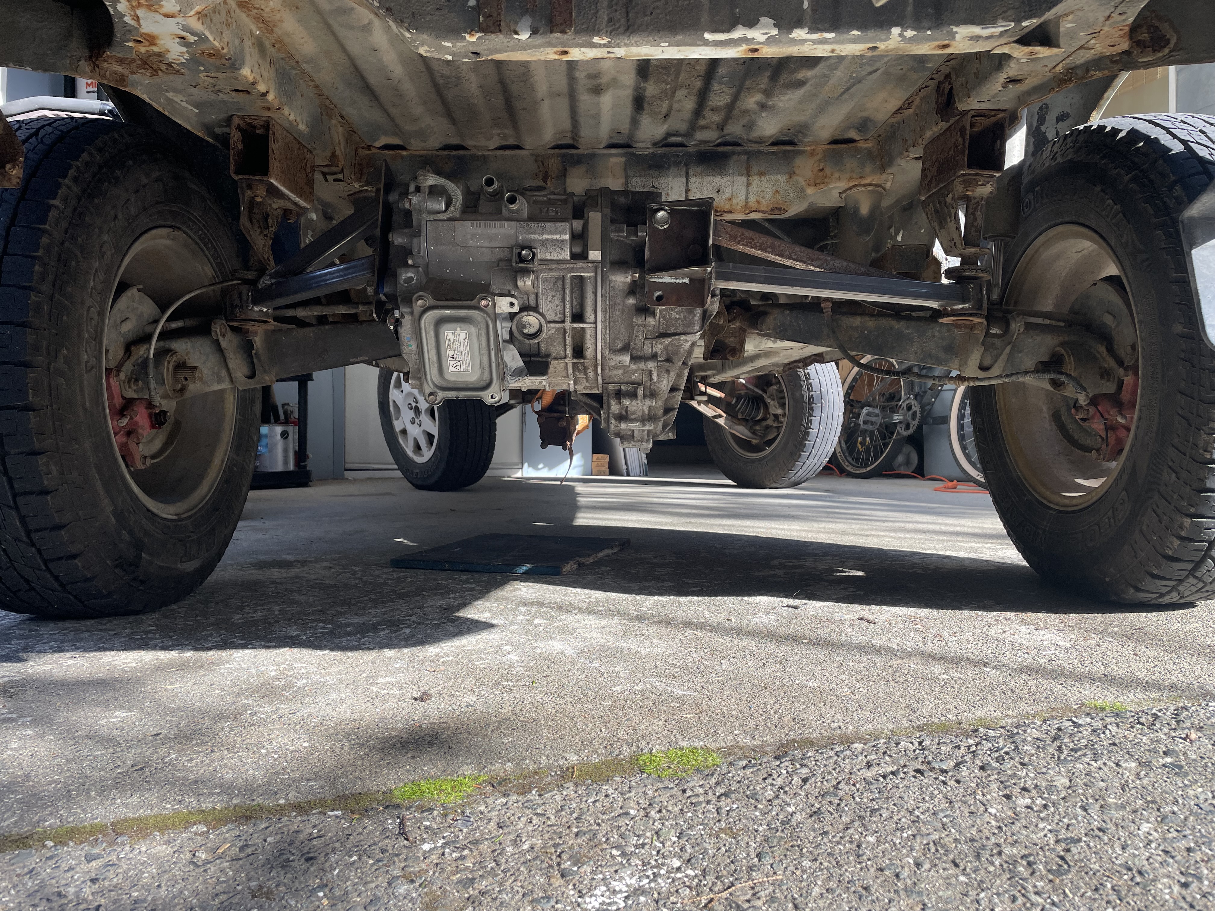

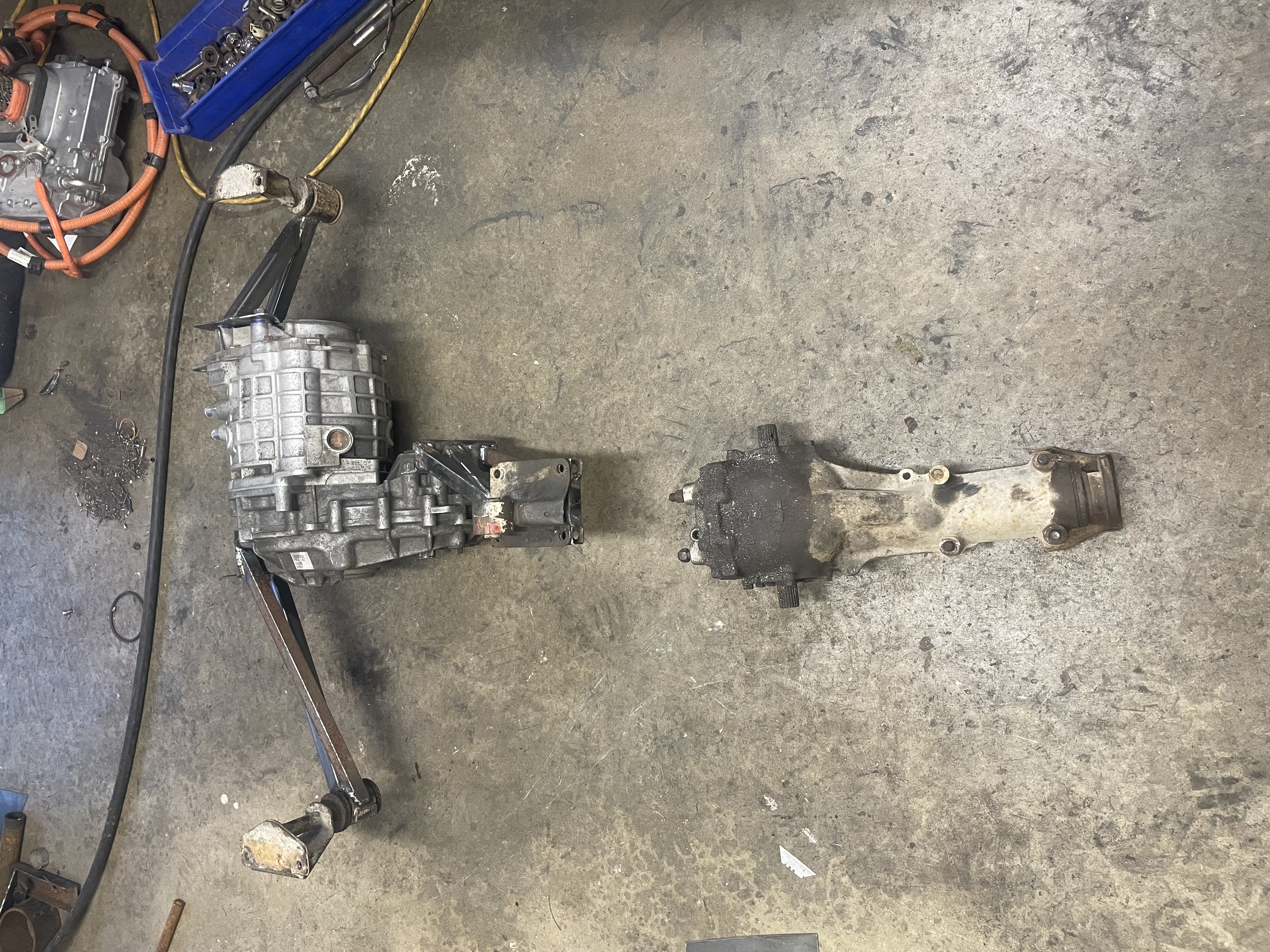

R160 rear diff is out, outlander DU is in!
Built a jig and welded up the new mounts remotely and then brought the parts to the brat. not perfect but it’s in. Next up axles, then I can pull the original gearbox and leaf motor and loose a couple hundred lbs!

unfortunately have had no time since to attend to the brat, but after measuring the required axles lengths, I found I need 19.5in axles shafts. Being I’m planning on using vw 100mm joints… very conveniently that vanagon axles are…19.5in longSteamboater wrote: ↑Tue Jun 24, 2025 3:03 am Couple months have passed, you been driving RWD or what!?
So now to just turn down and weld on some flanges for the outer stubs on the trailing arms. Then drive train is done!
