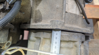

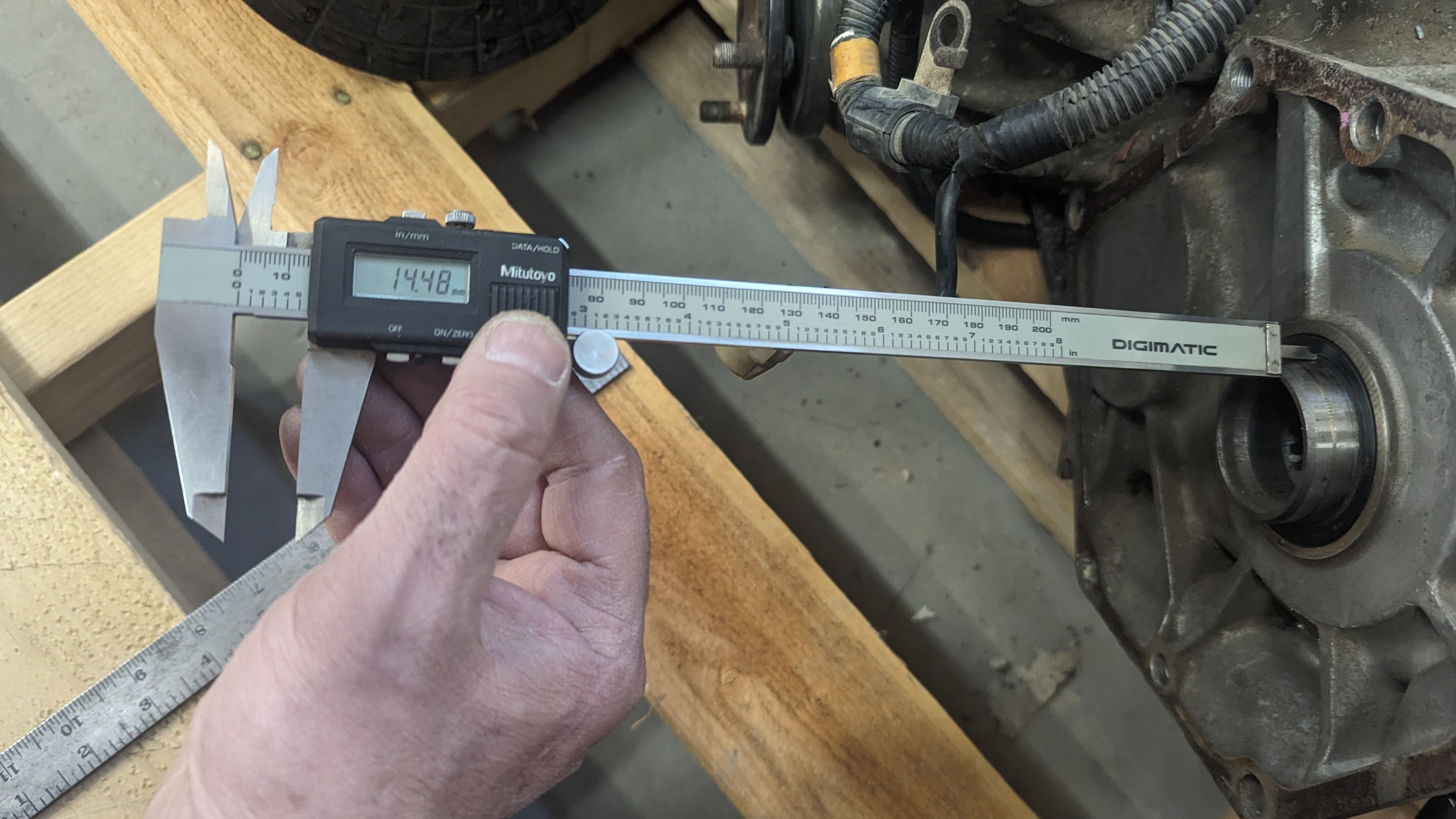

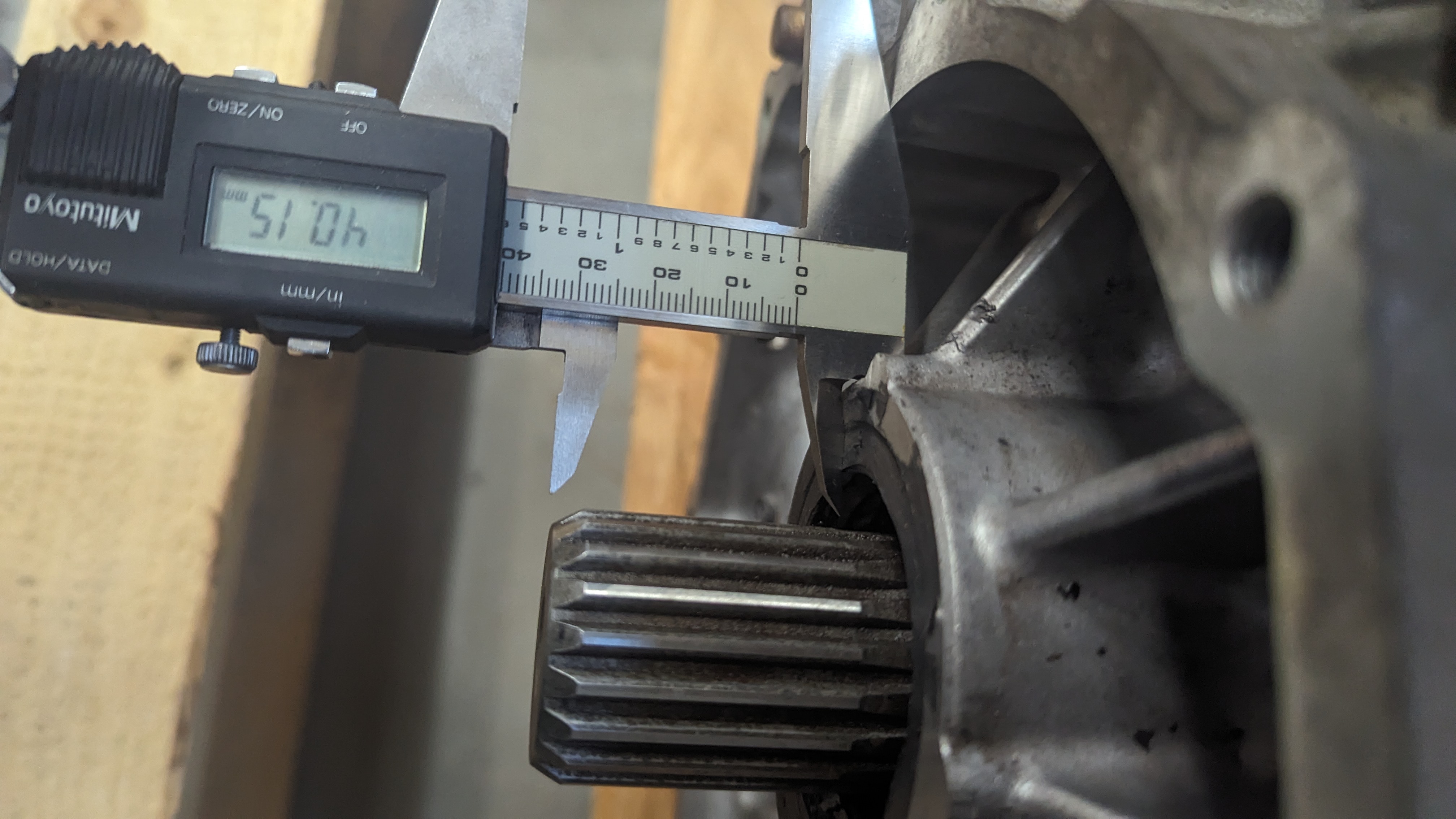

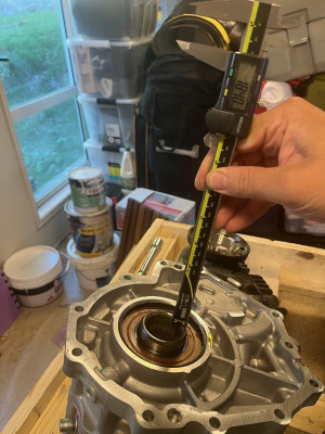

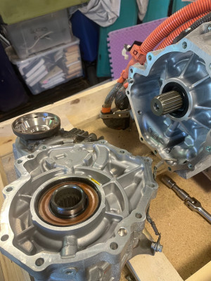

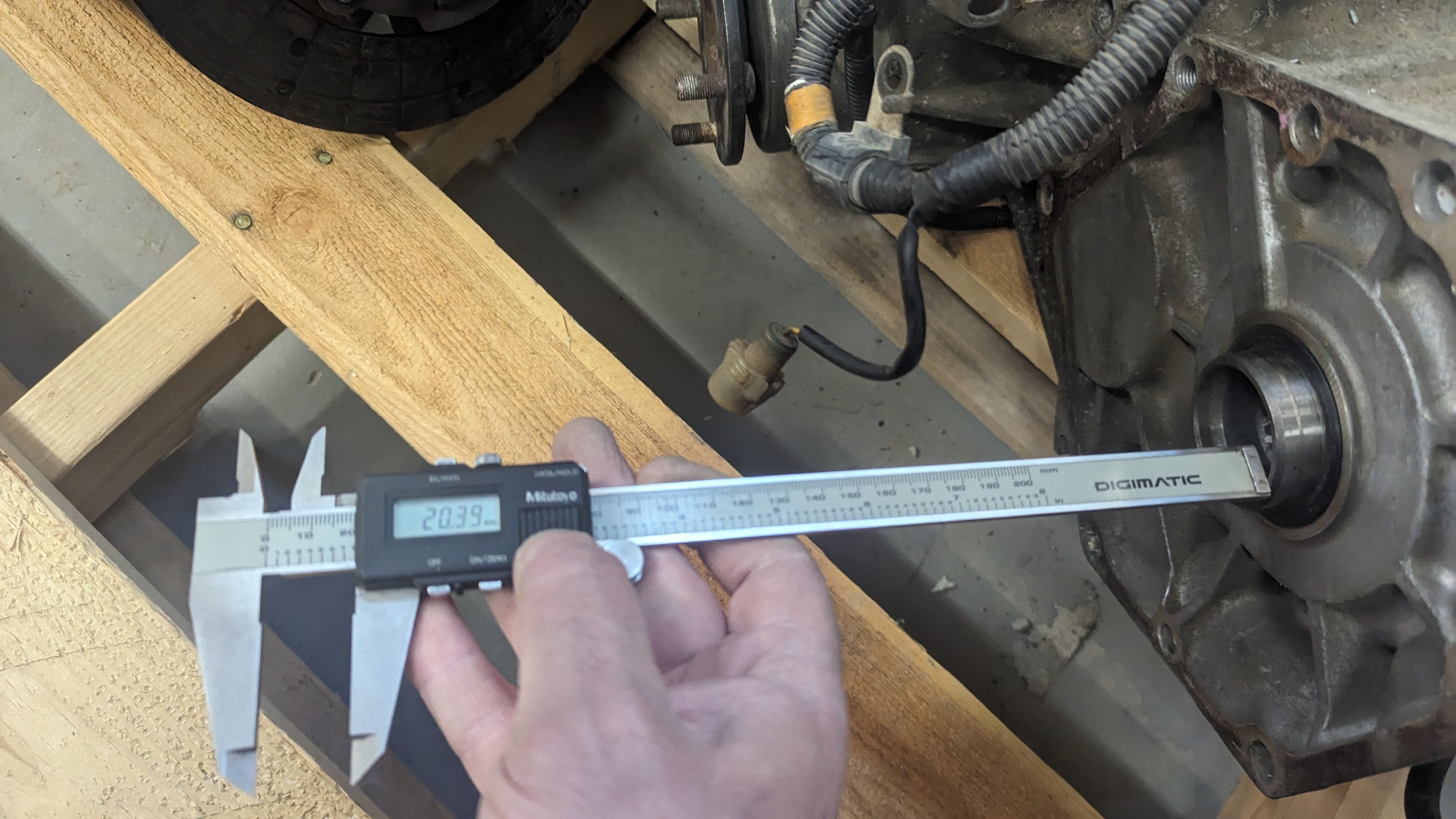

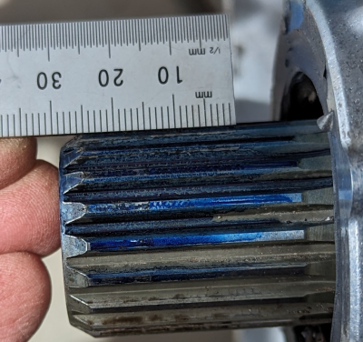

I took some measurements yesterday. In short:
  • * There is 40mm of spline sticking out of the L110F from the seal surface
    * There is 20mm of no-spline at the front of the HF1A inside the protrusion of the seal surface.
    * The seal surface protrudes 14mm from the HF1A.
    * There is 4mm of protrusion of the face of the output seal on the L110F relative to the output mating surface.
I conclude there is around 34mm of spline engagement when the L110F is face to face with the HF1A and we have 4mm of room for an adapter plate plus whatever amount of spline engagement we're willing to sacrifice.
In this photo, I've placed a steel ruler across the mounting surface of the L110F to try to measure the amount of seal protrusion. I didn't take a picture of the measurement which is 4mm incl thickness of ruler.
The rest of the pictures:
More and more I'm swayed towards the spud shaft idea.

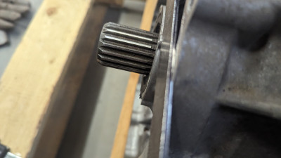

My thoughts are scattered. My other friend Peter also has a 3D scanner. I think there's a lot to be learned by disassembling the case. Can only see so much in the osti.gov document.
I don't have much to report. My spring TODO list is interfering with my truck project. I did toss the whole kitten kaboodle on the engine hoist yesterday just to check for driveshaft clearance and actually measure the spline engagement. It's actually worse than I calculated. Only 25mm of actual spline engagement which shows that I don't know how to math.
In the second photo, I sprayed some machinists ink on the output shaft and slid the tcase as far as it would go. Then I worked the tcase back and forth to show me where the splines engaged. It's hard to see in the photo but the wear stops at 25mm. The last photo shows the 3mm that the seal surface of the L110F protrudes from the mounting surface.

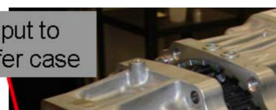

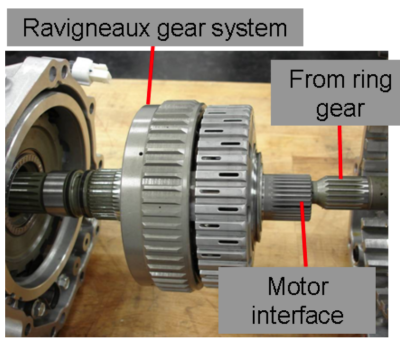

From p51:
That looks like a complicated shaft to remake. That section of the case also contains the parking pawl mechanism so there'd be some complexity with recreating that in a 3D metal print.
We're so far above my paygrade now that I can't even conceive of it.

I agree that it is probably 'too hard' to remanufacture the Ravigneaux cast section due to the complexities in the casting (oil galleries etc).
I am not giving up on remanufacturing the output shaft just yet. In the photo you linked from the OSTI documentation it isnt clear whether the planet gear housing is integral to the shaft. The parking pall certainly just splines onto the output shaft as can be seen in the OSTI photos.
As soon as I work out how to separate the Ravigneaux section from the transmission I'll pull the output shaft to bits and post some photos (the Ravigneaux section is glued on like a bastard).

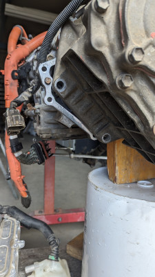

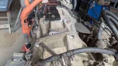

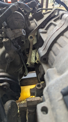

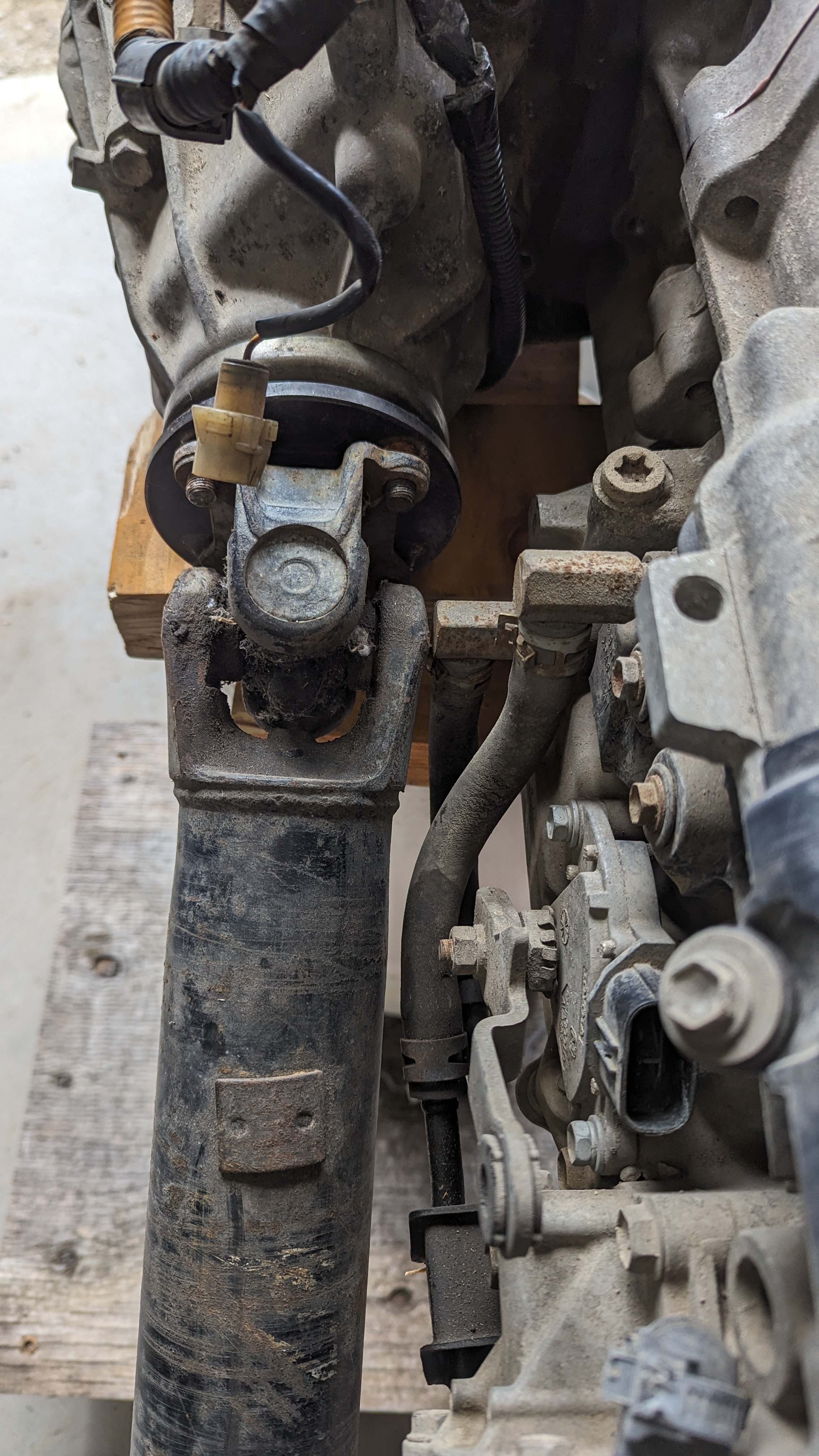

btw, here are some pictures I took the other day at the optimal clocking for my driveshaft which just barely clears the oil cooler line. The driveshaft clears better if I adjust the clocking so the driveshaft is higher but then my driveline angle might be pretty extreme and I might need a double cardan shaft. There might also be an opportunity to modify the oil cooler fitting but clocking the output much lower causes other fitment issues. I'll understand this better once I pickup my chassis.
The pictures gave me a bit of insight as to what an adapter plate might have to look like.

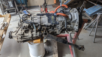

I have achieved "spinning flanges".
https://photos.app.goo.gl/vMQaq9dDA3qkEJkY9
It's not bolted up and just kinda supported by a block of wood so it's shaking a bit.

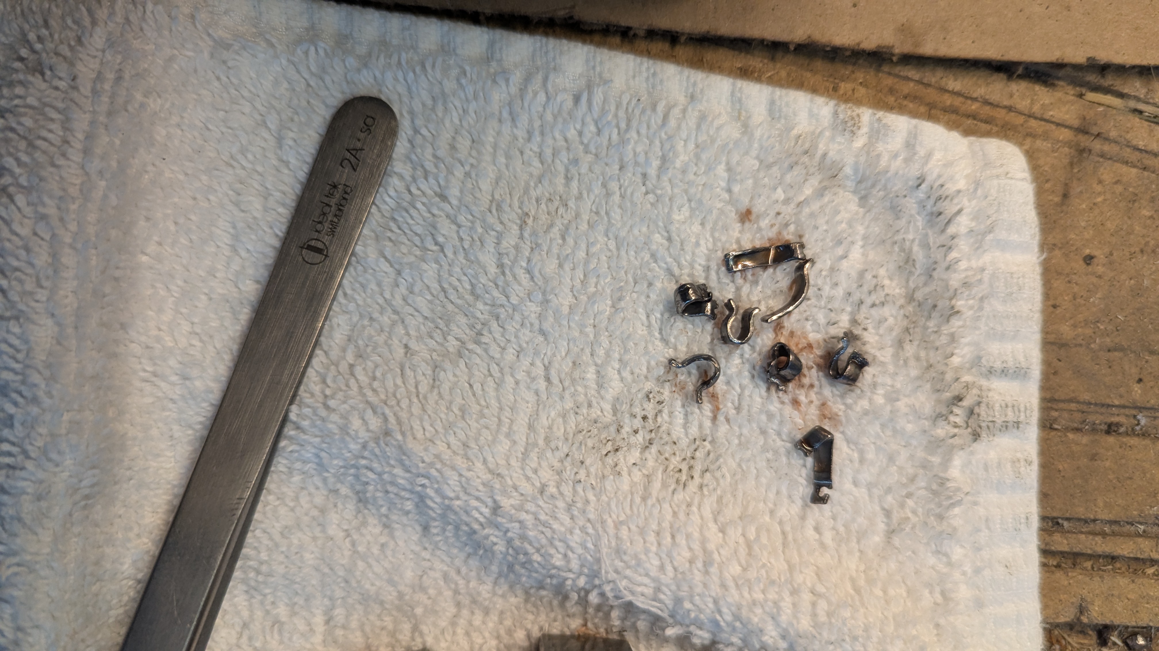

Removing the R section was fairly straight forward. I found some shrapnel inside the housing between the two bearings. The shrapnel was from a bearing cage but the cages on the two bearings inside the R section were fine. I conclude a bearing (the smaller rear bearing) had been previously replaced and there were some witness marks to confirm that someone had been in there before.

Per my WIP reports https://openinverter.org/forum/viewtopi ... 439#p89439 in the Projects board, here is the adapter I came up with.. It's made of .250" hot rolled steel. Thanks to @jrbe for his immense help converting 3D scans into models. He has a thread on this here: https://openinverter.org/forum/viewtopi ... 032#p88032
The transmission and transfer case both share the same shaft seals so theoretically, I don't need any gasketting between the ravigneaux section and the transfer case. In the photos below, I just used some M12x1.25 lugnuts to mount the tcase but have since bought proper nuts to match the studs I welded on.
CAD is here: https://github.com/hpeyerl/evj55/blob/m ... apter.step
Here's a short video:
Part of the challenge here was that the front driveshaft really wants to occupy some of the same space as the L110F electric oil pump. The clocking of the HF2A relative to the L110F is a bit tight. With the drive flanges too high, the driveshaft wants to hit the oil pump when the suspension compresses. With the drive flanges much lower, the u-joint interferes with the L110F oil pan flange (and in my case, sticks too far below the frame rails directly in harms way). As such, I switched to an electric oil pump and you can see the custom adapter I made for this purpose in the photo above. The CAD for that is at https://github.com/hpeyerl/evj55/blob/m ... apter.step.
I'm satisfied with how low the transfer case hangs below the frame. I'll make a skid plate for it later. Thankfully the crossmember I re-used is still lower.
