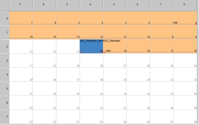

The "position" is not related to the 11 or 29 bit ID. The ID is a fix number, which you just select, like the 0x500 in your example.
After the ID (and some control information, which we can ignore in the discussion), there are the real data bits. A CAN message can hold between zero and 8 data bytes. In https://en.wikipedia.org/wiki/CAN_bus#Base_frame_format they call it "Data field". The "position" in the CAN mapping let you select, at which position of the 64 data bits (8 data bytes) your value will be located. So just assume, you have a plenty of space (64 bits), and you have two signals you want to transfer, lets say a lamp for "foreward" and a lamp for "backward". Each of this is a single bit information (the lamp can be on or off, nothing else). So we can chosse that the forewared lamp shall bit on bit 0, and the backward lamp on bit 63 (just as an example, more likely would be choose bit 0 and bit 1
The receiver needs the same information: "There is a CAN frame with ID 0x500 and on bit position 63 of this message you will find the bit which shall control the backwards lamp."
For values that are more than "on/off", both, the sender and the receiver need to be aligned about the scaling of value. Lets say, accu voltage. In can be 1 volt resolution, or in 0.1V resolution, or anything else. So you need to define, what is the intended scaling of the signal on CAN. Lets say, on CAN we want a scaling of 0.1V, and in the control unit the variable has a scaling of 1V. So the CAN mapping needs to multiply the internal value by factor 10, to have the intended scaling on CAN. Also the number of bits need to be configured, so that both, the sender and receiver are aware how many bits to write or read.
Example with a 20-bit-signal, which fills bits 0 to 19 (orange), a one-bit-signal (which is at bit 20), and empty space in bits 21 to 63. [Edit] The CAN mapping parameters and how they work are explained here: https://openinverter.org/wiki/CAN_commu ... N_messages
