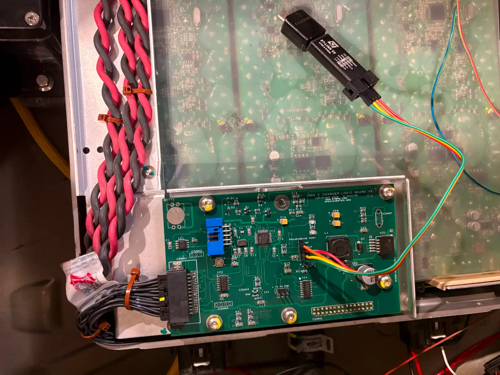

Hi Everyone,
Just have a quick but maybe stupid question on getting the charger configured. I know in the instructions, I need to use the STM32 programmer, but on the youtube video, as soon as you apply 12V to the unit, you can connect to the config panel by connecting to the charger wifi network and then going to 192.6.4.1.
Instead of getting the config page as shown in the video, I get the following image:
Do I really need to program through the STM32 or is there something I'm missing in the web interface?
Thanks in advance!

So the web interface is on the esp322 board, and the actual charger firmware is on the stm32.
The web interface can load regardless of if the stm32 is programmed or not.
If you bought a pre built programmed board, when and where from?
Might not be running the latest interface or firmware

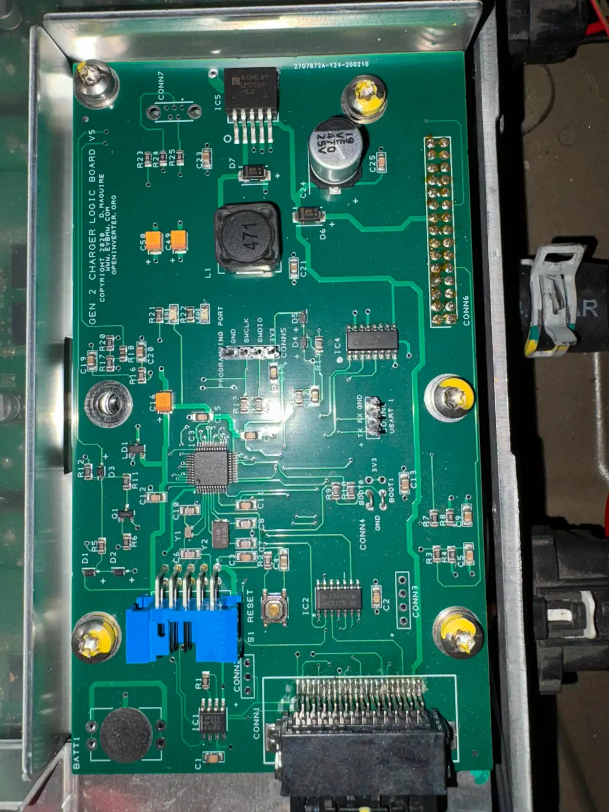

Please provide pictures of the charger board. There have been a few versions.
spiff
Posts: 28
Joined: Thu Jul 14, 2022 8:44 pm
Location: Toronto
Re: Tesla Gen 2 Charger configuration help
Post by spiff »
Here you go... I removed the wifi board currently because I'm trying to program it.
Posts: 989
Has thanked: 168 times
Been thanked: 348 times
You have a v5 board. There’s 4 pins below in inductor in the middle of the board, labeled: “GND”, “swclk “, “swdio”, “3v3”
You just need gnd, swclk, swdio wired to a st link
And the board supplied with its own power

Doh!! Labelled “Programmng Port”. Boy do I feel stupid… and grateful. Thank you! So then I can configure the charger here via stm32 programmer. Do I still need to update the wifi board?
