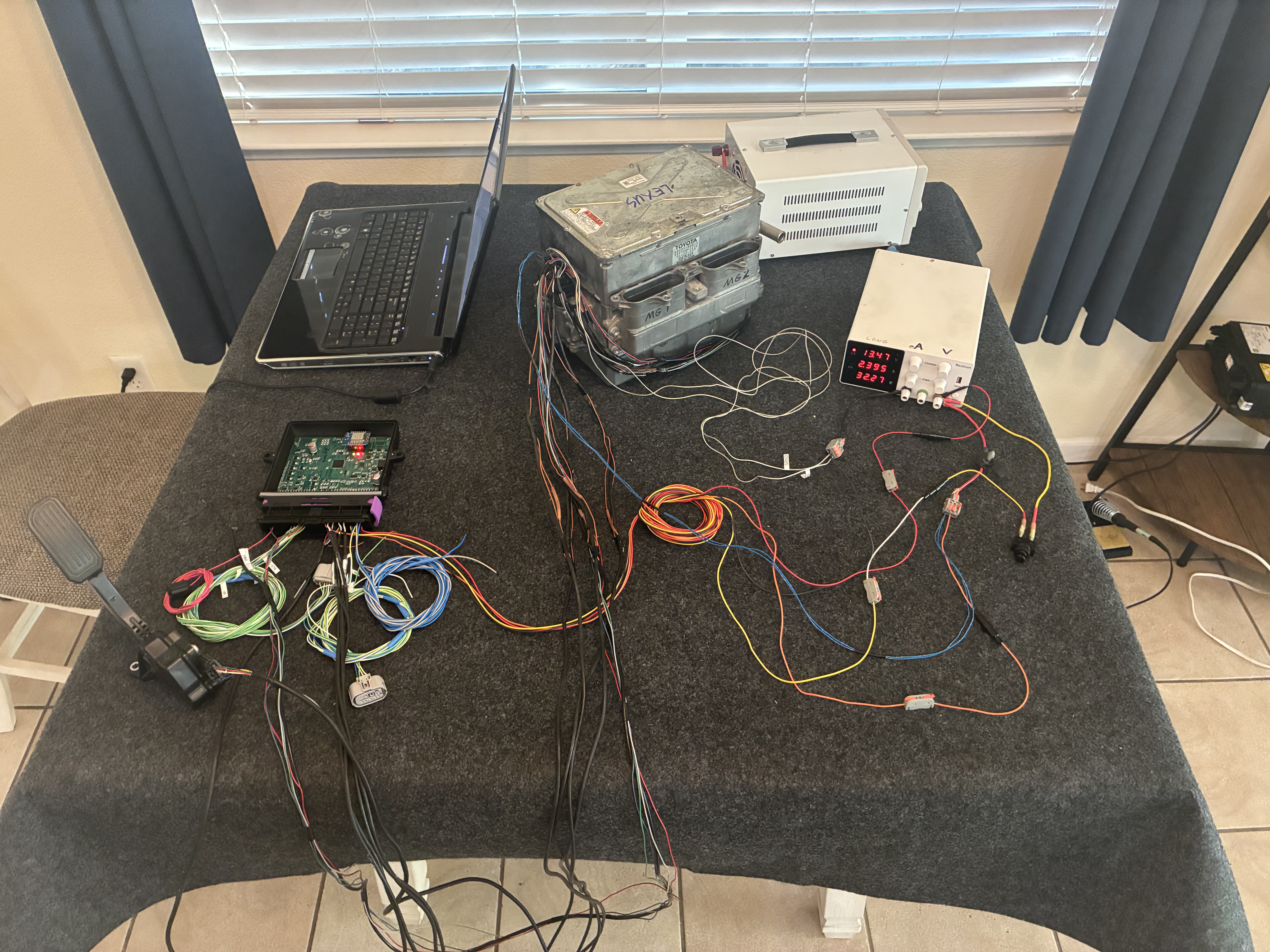

Bench Testing...
slowly it's getting there, the vision is that you will receive everything except for the ZombieVerter VCU circuit board which you can obtain from EVBMW.com
this will be nicely loomed eventually
Bench Testing...

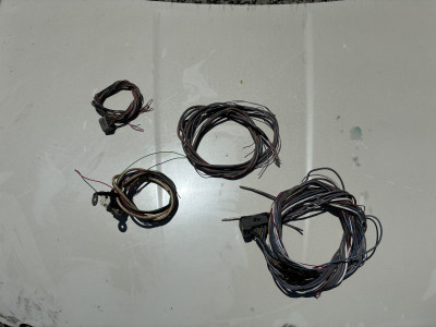

On this episode of How To Put Yourself Out of Business, I give away all my secrets on how I harvest all them parts for you
the 4th Generation Nissan Altima 2007-2012 has the same inverter plug as our beloved 3rd gen Lexus 2007-2011 (it is pinned differently but the plastic part be the same, if you follow, the resolvers also live on a separate connector but we'll get to that)
so my day begins at 0800 when Pick N Pull Opens and before I proceed to show you what the vehicle looks like when I find it as opposed to what it looks like 4 hours later when I leave it, let's level set.
Here are the things to keep in mind as you consider pulling these parts yourself, and I have gone through this myself so I am not trying to talk you out of it I just speak from experience.
1. Do you have a junkyard in your area that allows YOU to pull your own parts? Yes or No
2. Do they have the car you need? Yes or No
3. More importantly is the part you need still there, or did someone already pull it, or is it broken? Some yards have an online inventory system but it only shows you when the car arrived and not what's been already sold, this is quite annoying, see my I drove 3 hours for a Lexus inverter, only to find it was no longer there video:
ok on with it, this is what this sexy 2009 Nissan Altima looked like when I found her in the wild, she was 97.2% in tact
one of the first things I like to do is check to see if it has an inverter, and if so if it is a part number that I don't have already, Artur K of the Jaguar XJR EV fame and I are hoping to do some testing of running the much cheaper Altima inverters against the Lexus GS450h gearboxes and dyno test them to see if there is any pony loss or if we can live with it

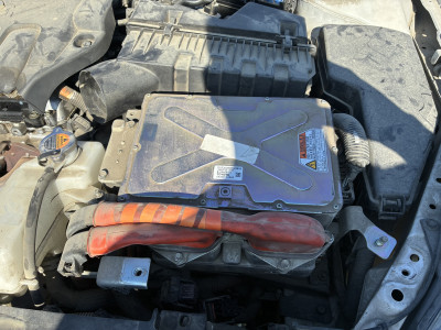

OK, so you saw what the car looked like when I found it, trust me the engine bay was all stock, and here it is 4 hours later, yes we get to remove the hood, among a million other components that are in the way
yes I had to remove that silly ram horn wrap around plastic intake manifold to get to the main wire harness that runs across the entire firewall (yes to unbolt 4 of the 6 intake manifold bolts blind by feel, Fun Leve: -2)
I call this Civilized Carnage

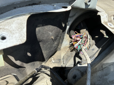

so if it all goes well we get to yank part of the main wire harness that looks like this, and I say part of it because the way it is routed is completely insane, the inverter lives behind the headlight on the driver side, well this stupid harness runs from the inverter to the firewall than across all the way to the passenger side, yes in front of the firewall in the engine bay, then it goes through the firewall, into the cockpit where it runs back over to the driver side and into some black box module thingie I'm sure, Why? why not just run it from the inverter into the cockpit on the drive side an be done with it?
so all that work for pretty much this, which then has to be cleaned and washed and de pinned and repined, etc.

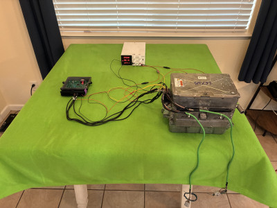

having sold a number of wire harnesses now, I figured might as well finally build myself a prototype, and test one out

here I am fixin' to test a 3rd Gen (2007-2011) Lexus GS450h OEM(ish) harness

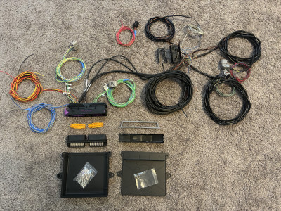

working on a custom $350 dollar harness+ for a lad in the UK, he is converting a 1965 Rolls Royce Silver Cloud 3 and wants to retain the original throttle pedal, so in lieu of a throttle pedal and throttle harness I am sending him the oil pump controller harness and pinning the Zombieverter header connector for him and tossing in the enclosure for good measure, he best have some good Chuck Norris jokes on the ready

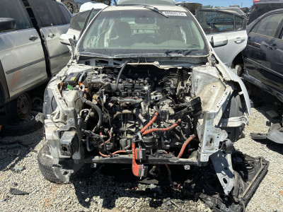

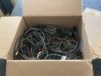

another option is to yank your own harness(es) and ship them over to The Greg to thin out
here I am about to thin out my very first Lexus LS600h all wheel drive Engine Harness and Transmission Harness that a customer has sent in to Good Enuff Wire Harness Worx
I want to share this process and offer up some tips
Very impressed how he managed to get both harnesses in to this box!
Fun Fact: Wire Harnesses are heavy !!!

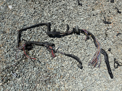

so let's start with the Lexus LS600h Engine Wire Harness, cause it just so happens to be on top
So what's the first thing we notice?
here it is nicely spread out so that we can get the lay of the land
and more cut branches

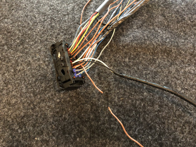

So what exactly do we need out of this so called Engine Harness?
Well, this! The Inverter plug and the tail that comes out of it.
We don't need this white plug below, I just pulled it as a home run for completeness to show where the other ends of the sync serial cables from the inverter plug terminate

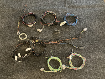

so this is what we need, note the two Resolver Cables have been cut prematurely, both of them should run to a single white plug which then accepts the resolver cables from the gearbox
and here's a fun little Stare 'n' Compare of what we need and what's left over

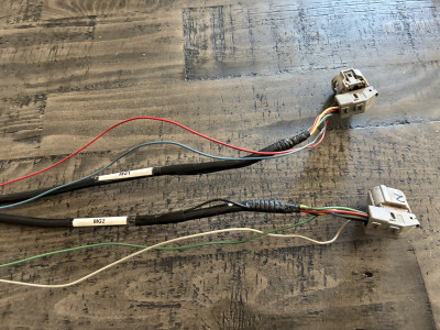

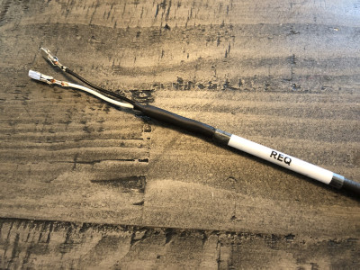

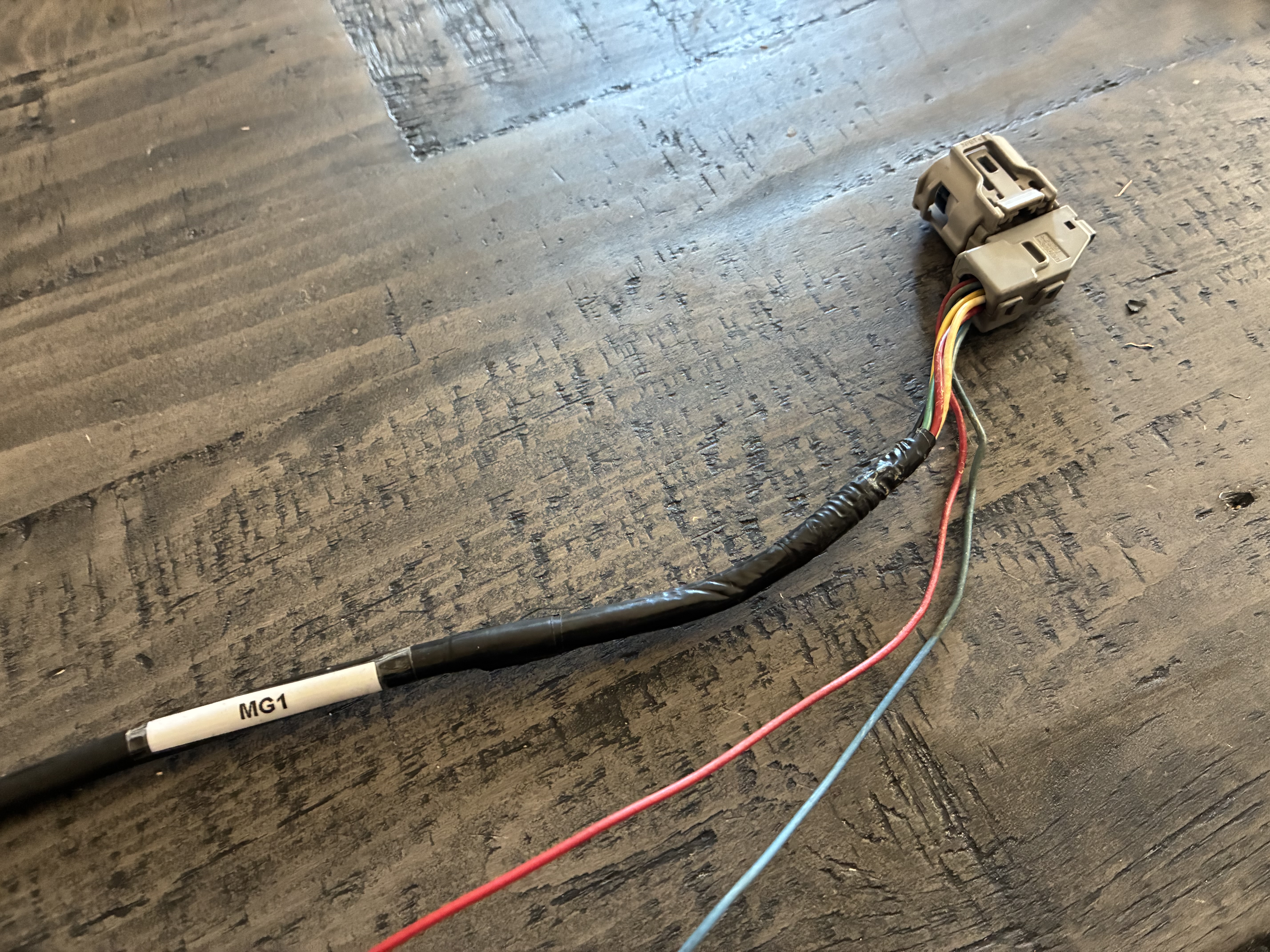

and these are the resolver cables extracted from the Transmission harness
and here's that white connector that runs to the matching white connected on the Inverter harness (that our inadvertently customer lopped off above)
