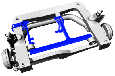

Designs for the driver's side engine mounting frame are now done after two month hiatus. Have built in a mix of steel and 3D printed parts to confirm fit. Current plan for the offside front mount is to bolt a clamp around the subframe to avoid having to weld anything on, finalising the design for that this week then will get all the parts laser cut.
Given the constraints of the existing subframe and motor mount positions, the i3 motor only just fits, but it does fit.
Will post the CAD files on here once I've built the mounts and confirmed fit.

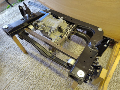

Started welding the motor mounting frames this weekend. The main crossbar that picks up the two existing rear engine mounts is complete, and the driver's side frame that picks up the front engine mount and bolts to the right hand side of the i3 drive unit is almost done. Just a couple of corner plates to add for reinforcement, then onto the offside frame.
Have ordered a couple of rear wheel bearings so will then fit those and get the Smart's CV outer sockets in place in order to size up the CV axles and see what the options might be for connecting to the i3 CV outer sockets.

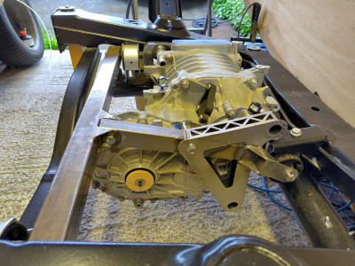

Offside frame done and everything fits reasonably well, though some of the bolts are a bit tight bringing it all together. Going to make a few tweaks to the CAD a mm here and there to improve the fit in case anyone else decides to build one.
Removed the skateboard that the drive unit's been sitting on so it's fully supported by the motor mounts and took a few photos. Position seems good and the mounts are supporting the weight well, while allowing some movement via the polymer bushings.
Just the offside front clamp left to do now.

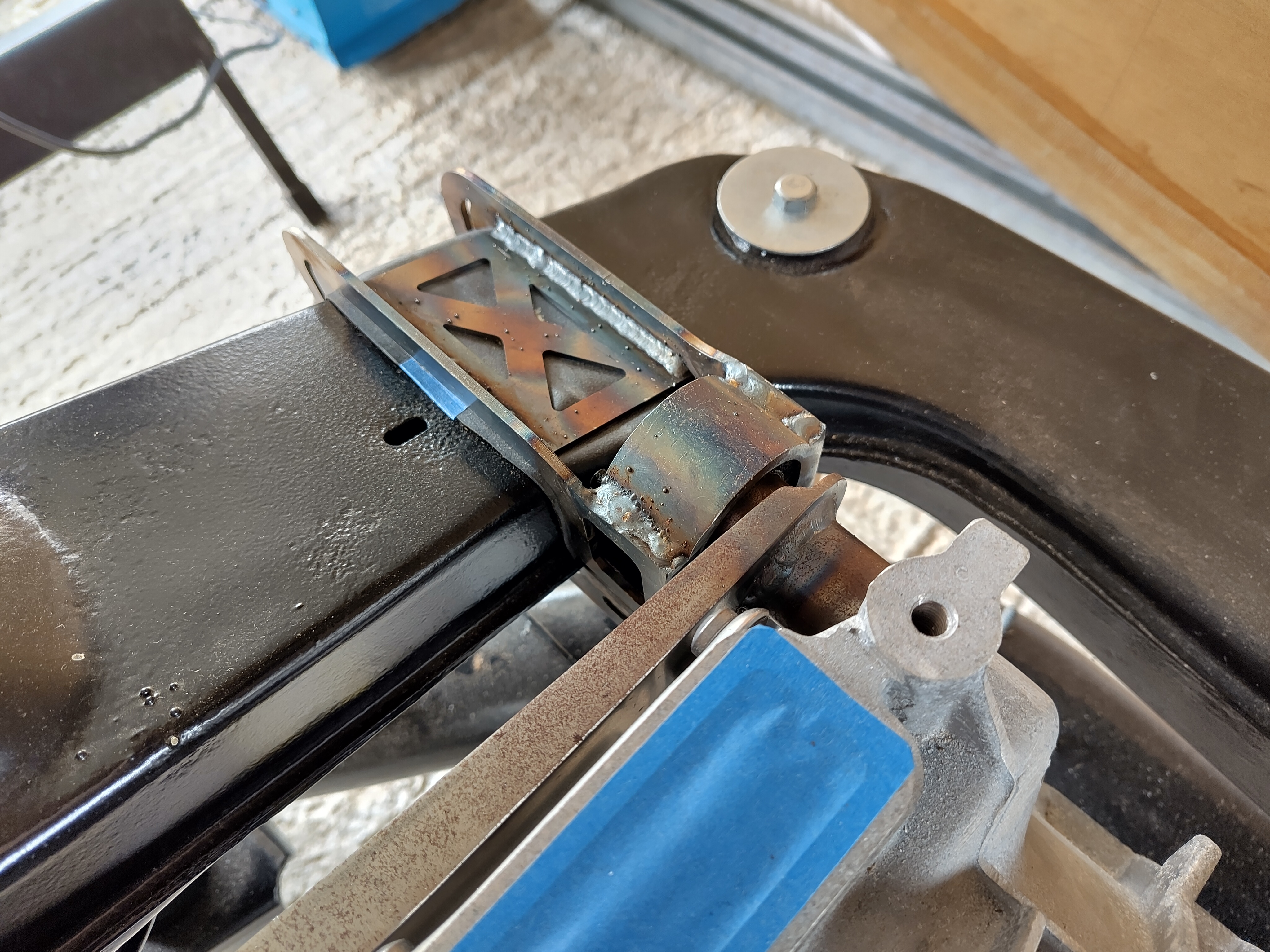

Offside front subframe clamp now complete and motor fully supported. The tube coming off the motor mount ended up 15mm lower than expected so had to modify the top half of the mount to move the bushing carrier down. The base of the mount is also a bit close to the subframe seam.
Have since realised that the design can be improved to make it easier to fit/change bushings so will build another top half from scratch, with the bushing carrier 15mm lower and another 1mm of clearance between the bottom of the mount and the subframe seam. Planning to use a custom 3D printed TPU bushing (half of a test printed one is currently in the lower half of the bushing carrier).
The current top half of the clamp is good enough to support the motor for test fitting to the car, and also for measuring up the CV axles, which are next on the list.
