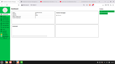

Hi guys, stupid question time and hopefully something silly I'm doing.
I'm testing my newly received Zombieverter by replacing the Leaf VCU in the car.
I think I have the parameters similar to Damiens from the Grey Goose but I'm not seeing any LS ouputs from any of the Pins 31 to 34 so no precharge, Inverter or negative contactor.
I've been able to calibrate the throttle without issues so am able to communicate with the VCU.
I don't have the HV connected as I wanted to see the outputs working correctly before connecting HV.
Is this possible?
I could do this with the Leaf VCU as it immediately sent the precharge output when T15 was turned on.
I have 12V on T15 through a switch and Start through another momentary switch.
Any suggestions?

There are no errors but also no voltage showing on UDC even though I had a 20V battery connected to the ISA which was working fine with the Leaf VCU. This screenshot was taken while the VCU was powered off but I don't think it has changed.
I put a meter on the outputs but didn't get a GND on any of them.

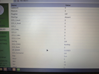

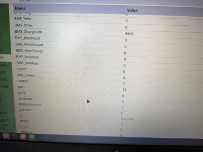

Re: New Zombie user not getting LS outputs.
Any errors in the spot values?
Please post all your spot values.
You double check all your inputs are showing up as they should?
No errors but I see T15 status changing as I flick the switch on and off
And you giving it a start 12V signal?
You can use the print function to save as pdf, or atleast you can for windows, easier to save.

I was trying various parameters to see what would prevent the VCU going into Run mode and sending Gnd to the Neg contactor. I just wanted to get my head around how it worked before installing it in the car and leaving Potmin and Max as default was one of the causes.Jacobsmess wrote: ↑Sun Jun 08, 2025 3:58 pm Is this correct? I'd have thought pot min/max2 and pot min/max will depend on the pedal you're using and thus ranges will vary pedal to pedal. As I understand, calibration should occur for each setup on both pot1 and po2 min and max using the pot and pot2 value in the spot values with the throttle unpressed (min with additional 200) and pressed (max with 200 or s subtracted).
