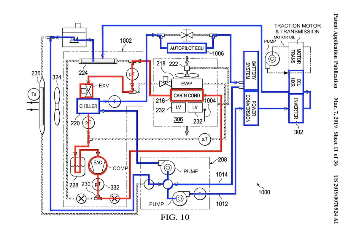

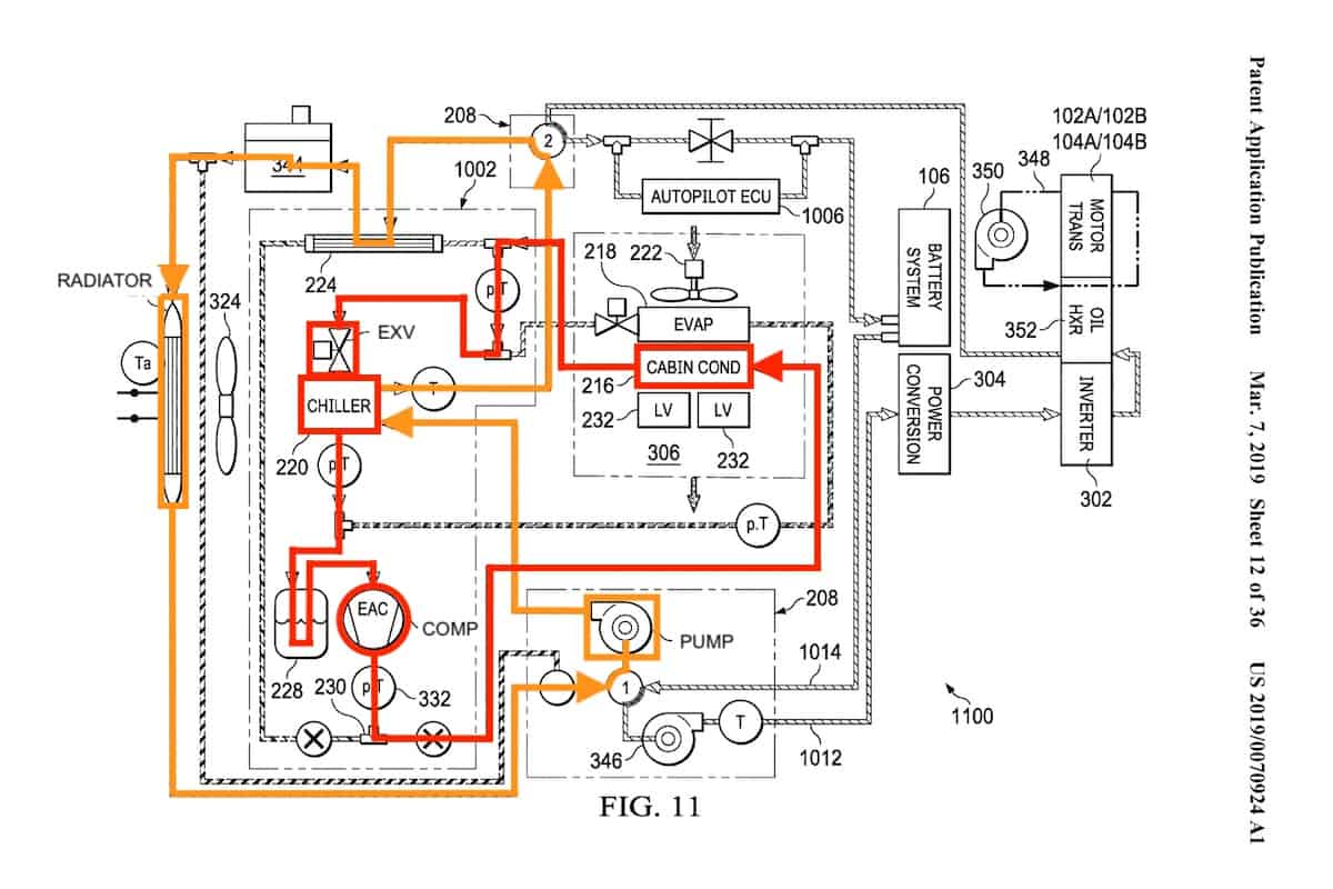

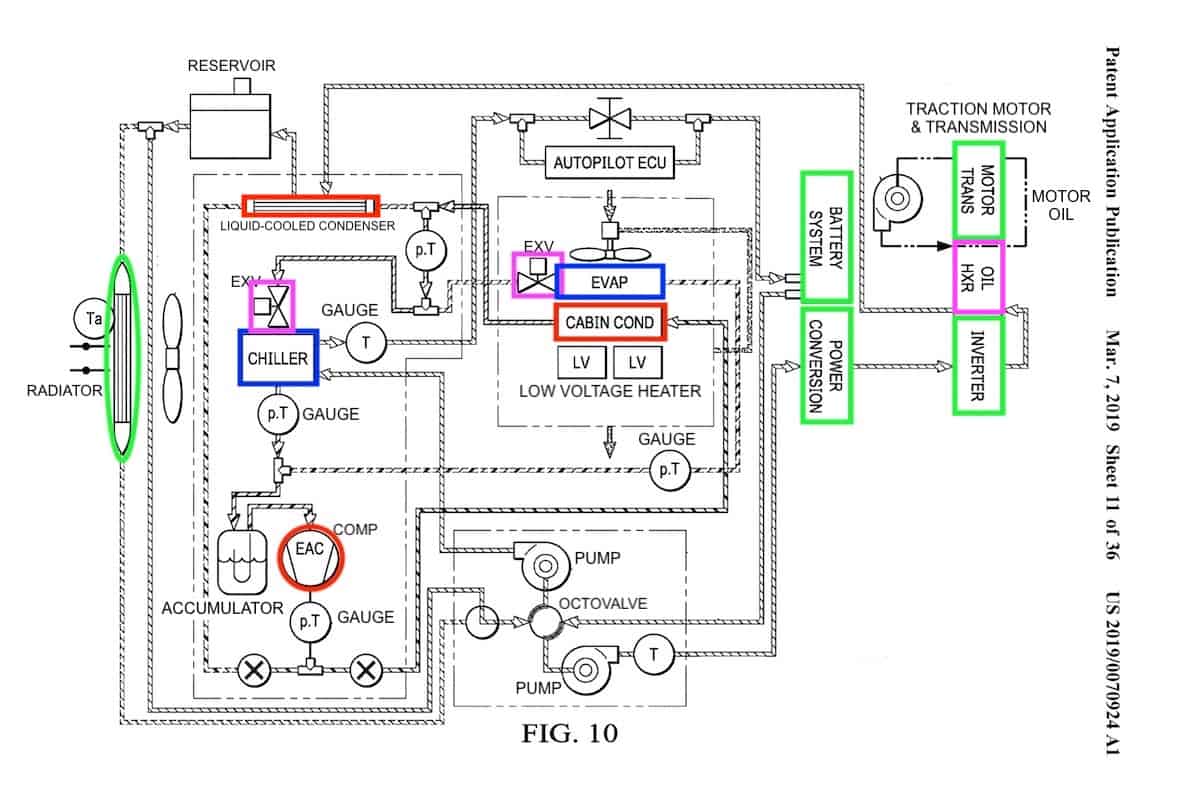

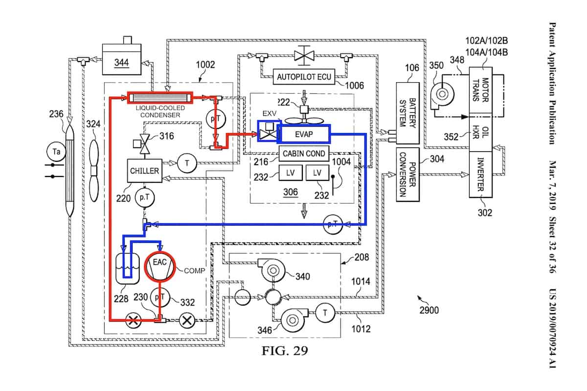

First, I will show the main operating modes of the system.
Component introduction
Compressor as a heater
Water cooled cooling
Ambient air source heating
Battery system drive train energy recovery
Posts: 2390
Location: Bristol
Has thanked: 206 times
Been thanked: 562 times
Re: Tesla Heat Pump System Hacking
Sure but that is the patent diagram.
This your source? https://aircondlounge.com/how-tesla-heat-pump-works/

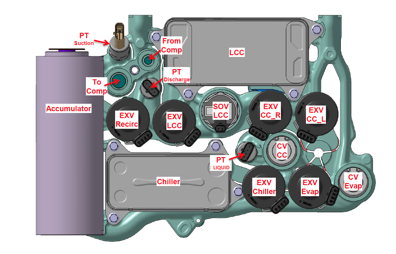

A little googling revealed that EXV control is fairly simple, but it need to figure out how much to open the valve. As I understand, the amount of passage is calculated based on feedback from the pressure sensor.

AMP3R wrote: Tue Jun 03, 2025 6:09 pm passage is calculated based on feedback from the pressure sensor.
EXVs are steppers, 4 pole I believe.
Correct you are looking to hit delta P's across the EXVs with various targets based on cooling demands. Which ofcourse depends on the target temperatures of the Heat exchangers, cabin evaporators or condensors.

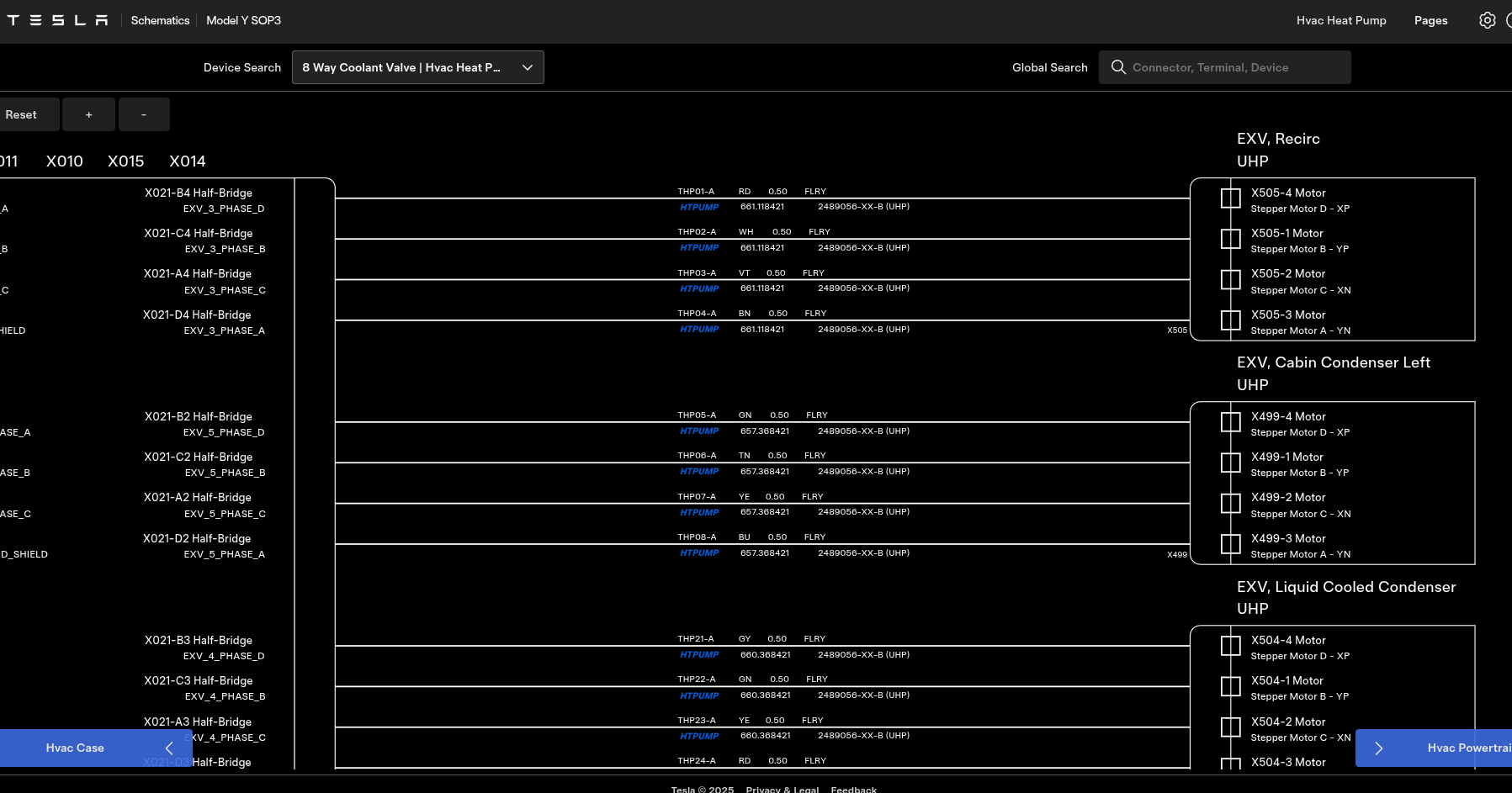

tom91 wrote: Tue Jun 03, 2025 6:17 pm EXVs are steppers, 4 pole I believe.
Yes

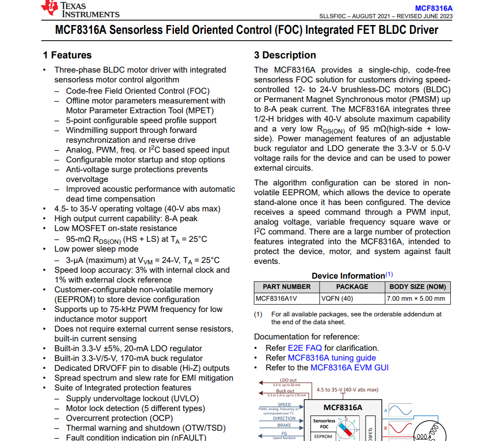

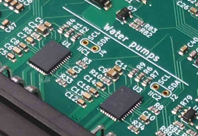

After another googling and studying the Wim Boone's controller, I got some valuable information.

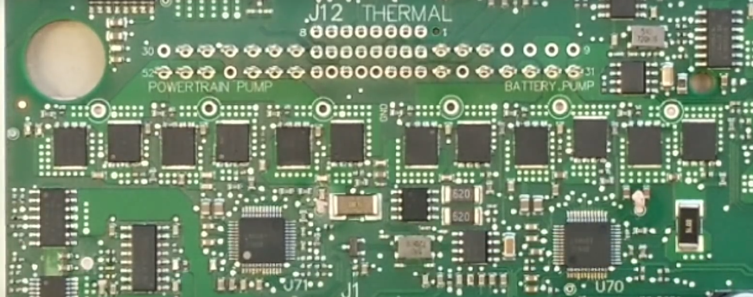

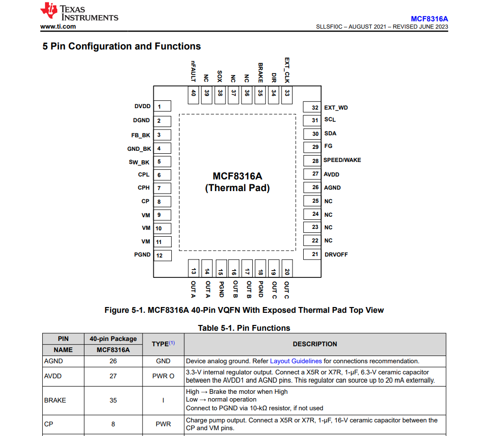

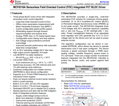

For water pumps, he uses bldc drivers with integrated FETs MCF8316 series with the peak current up to 8A, which seems insufficient if compared with what the professor claims (15A peak for each pump at max 6000 rpm)
Tesla uses drivers with external FETs, and apparently this is done for a reason. I know it's in the old VCFRONT from M3, but most likely they didn't change anything in further versions.
It's understand that a driver with integrated FETs looks more elegant and I like this solution more, but it's unknown how long they will handle the pumps.
Most likely I'll have to buy VCFRONT from fresh M3/Y, tear down it and then reassemble on a custom circuit board taking only what is responsible for the heat pump controls 😁

You can always cobble together something like a VSEC or other hobby bldc controllers to run the pumps. Those TI chips do look mighty fancy though and would yield alot finer control.
Key thing to make sure in the repurposing is to ensure you do not end up with alot higher flow restrictions compared to a tesla setup. Also the radiator sizing will be key to this setup to be able to reject the heat from doing cabin AC.

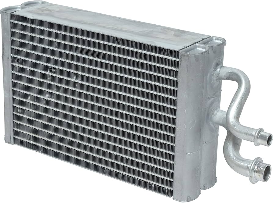

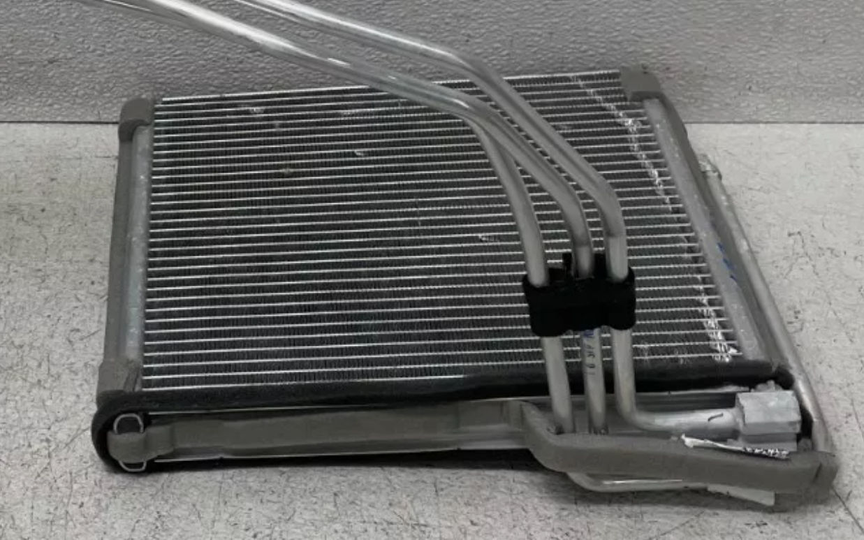

tom91 wrote: Thu Jun 05, 2025 11:51 am What are you looking to use as condensor, one from an EV?
An evaporator from GMC cars. It's designed as a two-section one, like Tesla's, only smaller.
I don’t have the opportunity to make a dual-zone climate control, so I don’t need one as huge as in Tesla.

AMP3R wrote: Thu Jun 05, 2025 12:15 pm An evaporator from GMC cars
I do not know if I would trust an evaporator to run as an condensor.
R134a pressure loop
https://www.hvacbrain.com/blog/examinin ... -pressure/

tom91 wrote: Thu Jun 05, 2025 4:14 pm I do not know if I would trust an evaporator to run as an condensor.
What's the danger? Will it burst? By the way, I found almost brand new VCFRONT from 2023 MY for $100. Maybe I'll take a chance and buy it.
Posts: 2390
Location: Bristol
Re: Tesla M3/Y Heat Pump System Hacking
AMP3R wrote: Thu Jun 05, 2025 4:31 pm What's the danger? Will it burst
Explode as its a gas, it will rupture and shred the lot and send it flying. Strongly not suggested to risk. Note the running pressure of the condensor is atleast roughly 5x that of the condensor. I am looking for more detailed numbers at the minute.
Note how the TXV/expansion valve drop the pressure across it before it gets to the evaporator.

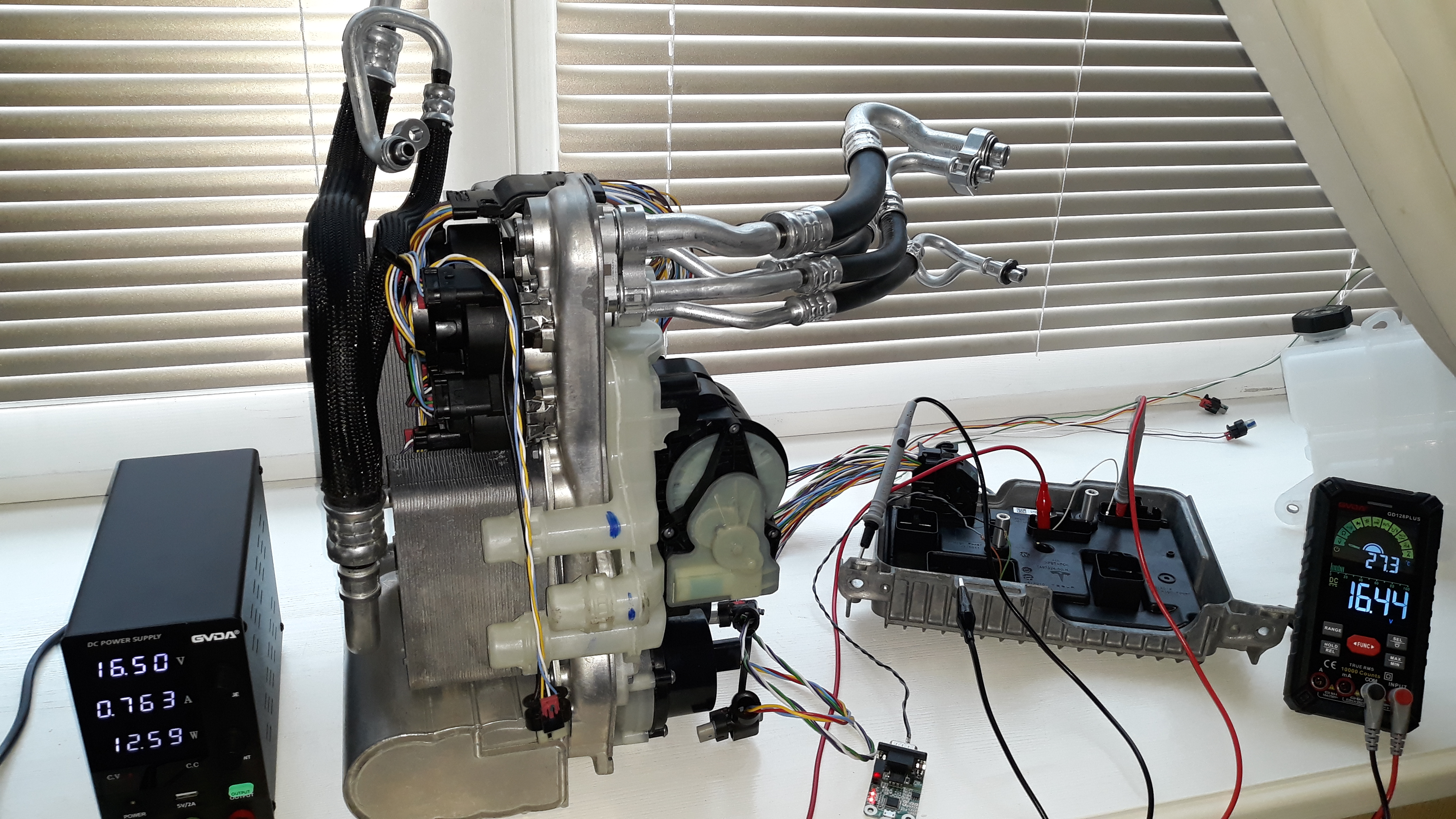

I think there is no point in making a custom controller when everything works on its own. But I'll play with the can for a while.
