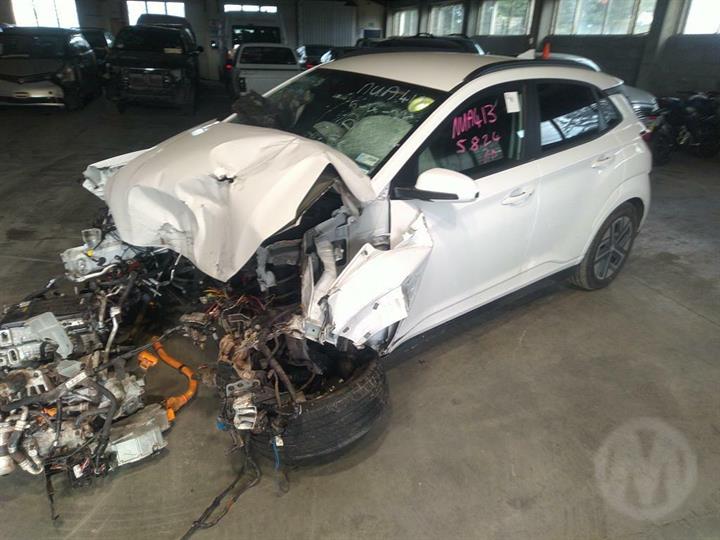

I bought a Hyundai Kona 2024 with damaged doors. But the car won't start just turns on but will not go on drive. The p can is off. Most modules wouldn't even communicate to the car.
I was wondering if someone could help me find the fault. I know I'm new to the forum and already asking a lot but i would be really grateful if someone could just even try to help.
Thank you

    Here is where it was damaged.
    I am not at the car right now that's why I have not measured the values of the resistance or the voltage yet.
    I will try to disconnect the TPMS module and see if that causing issues as it seems to be on the P can network.
    It would be of great help if you can point out where is the EPCU and IBU. A plan showing where the module are would be most welcome even if its not exactly for kona 2024.
    Would it be possible for anyone to simulate this particular fault on the table by disconnecting maybe a p can line

    We have dismantled the fuse box.
    and it has been changed. (it is written faulty on the sticker) :o :o :o
    The car came from the dealer and they have changed it there. It is written faulty on the box
    Now I don't know if that part number is that for the car or not and whether they have changed other parts in that car

    Mine is two doors plus fender that got hit. But the dealer I should say stole parts from that car. The fuse box when I opened it was made on 20 February 2025. So must have been used on a brand new car.
    Now makes me think the non start problem is not from the fuse box. There might be other things they touched. Because I heard the car was driveable after the accident.

    Would that be the A pillar? Passenger side? As indicated in this picture?

    You're on the right track with the VPN.
    Yes A piller as per your picture.
    The following photos show the wiring harnesses. You can just make out the block of connectors down by the door. The loom runs along beside the door and also branches across the car under the seats.
