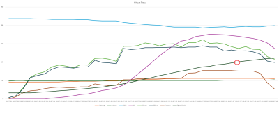

I tried to set Samples per line: too 1000 to get higher resolution but when I do the logging stops. Running 5.35.R.
Posts: 6743
Has thanked: 380 times
Been thanked: 1564 times
Re: SDU on 56S (204V nom)
Are you running CAN attached ESP? That doesn't work well with high burst rates.
When calculating fmax you must take slip into account, also it cuts back before actually reaching fmax
