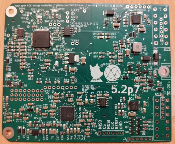

The firmware on the SPI flash should not be your issue. Even if you remove the SPI flash completely (or it is empty), the QCA will respond to the software version request with the response "Bootloader".

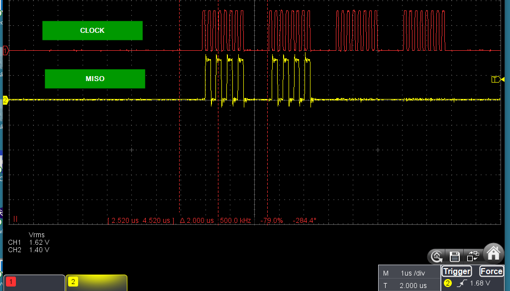

I just measured the MISO line on a Foccci. If the QCA does not see a homeplug coordinator for 30s, it does not send anything back on the MISO anymore, it is going to a kind of sleep mode. This is normal. It wakes as soon as a homeplug coordinator (e.g. an EVSE) is visible.
After a power-on, I see some responses on the MISO: But also I see a lot of clock packets without a response on the MISO: So it may be normal that you see not much on the response. You could trigger on the MISO line, this should reveal some data. If not, check the MOSI whether it sends the correct request message.
You could also give a try and connect the QCA as an SPI slave to a Raspberry and load the QCA driver which makes an ethernet interface from the QCA. I never tried this before, but think this should be a quite solid way to check whether the board runs in general.

Also make sure that you use the intended clock polarity. Here is an example of the C3 message (binary 11000011, means "read, internal, reg 3 RDBUF_BYTE_AVA"). The data is sampled on rising edge of the clock and prepared on falling edge.
Red is clock, yellow is MOSI.

Re: Develop a QCA7000 board?
Thank you for providing info and traces, that's above and beyond!
Unfortunately still stuck in SPI purgatory. Tried everything, even soldered up a new board and still no signs of life. Schematic seems solid and (mostly) as per the datasheet. Tried with burst mode disabled, no flash, checked my pins aren't being used on the dev kit board, reset high and low, all of the different spi modes. QCA just doesn't respond and MISO just stays high the entire time... very frustrating. Chips could be duds since I sourced them off AliExpress but the 1.2v rail, 1.6v tx and oscillator wouldn't be working if they were fake.
I did find a few things mentioned in the datasheet that isn't in Foccci that might be worth a review, I don't think any of the above is actually my problem or a problem in the foccci design though.
1. JTAG pins are supposed to use a 10k resistor to ground and 3.3k to ground for TDO (except for RTCK which is left open)
2. PLL_BYPASS should be connected to ground via 10k resistor
3. Datasheet calls for SPI Mode 3 and your trace/code seems to look like mode 1 (clock should be high on idle instead of low)
Datasheet link is here, it may be out of date - https://www.misuxin-en.com/Content/uplo ... df?rnd=780
I can keep progressing the code with ethernet powerline modules so its not the end of the world. The main thing I wanted to do is write a netif adaptor for the QCA so it can be interchangeable with the ethernet interface. It'll have to wait until the dev boards arrive, hopefully with a working comparison I can figure out where I've gone wrong.
Thanks again for your help

Good news regarding the transformerless Foccci boards: Just populated the QCAs on two of them, and they work like a charm. Even with additional 26dB attenuation of the RF signal, the demo charging with pyPLC as EVSE works perfect.
This means, if you order a Foccci in the shop, you could select now between the transformer variant (V5, V5.1) or the transformerless variant (V5.2p7).

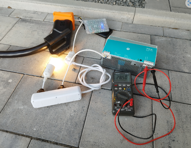

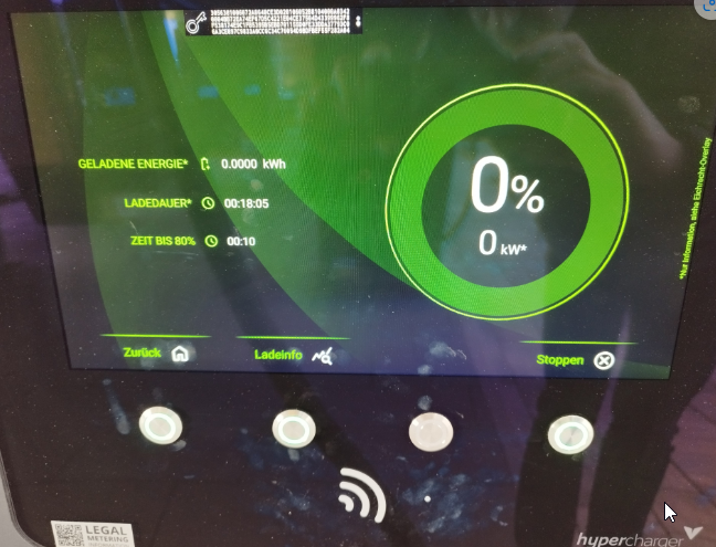

Good news: The transformerless Foccci works on the Alpitronic charger. Here driving a 230V bulb (just because it's nice) and a 24V/20A power supply (which will be the use case later).
Was running stable until I stopped after 18 minutes.

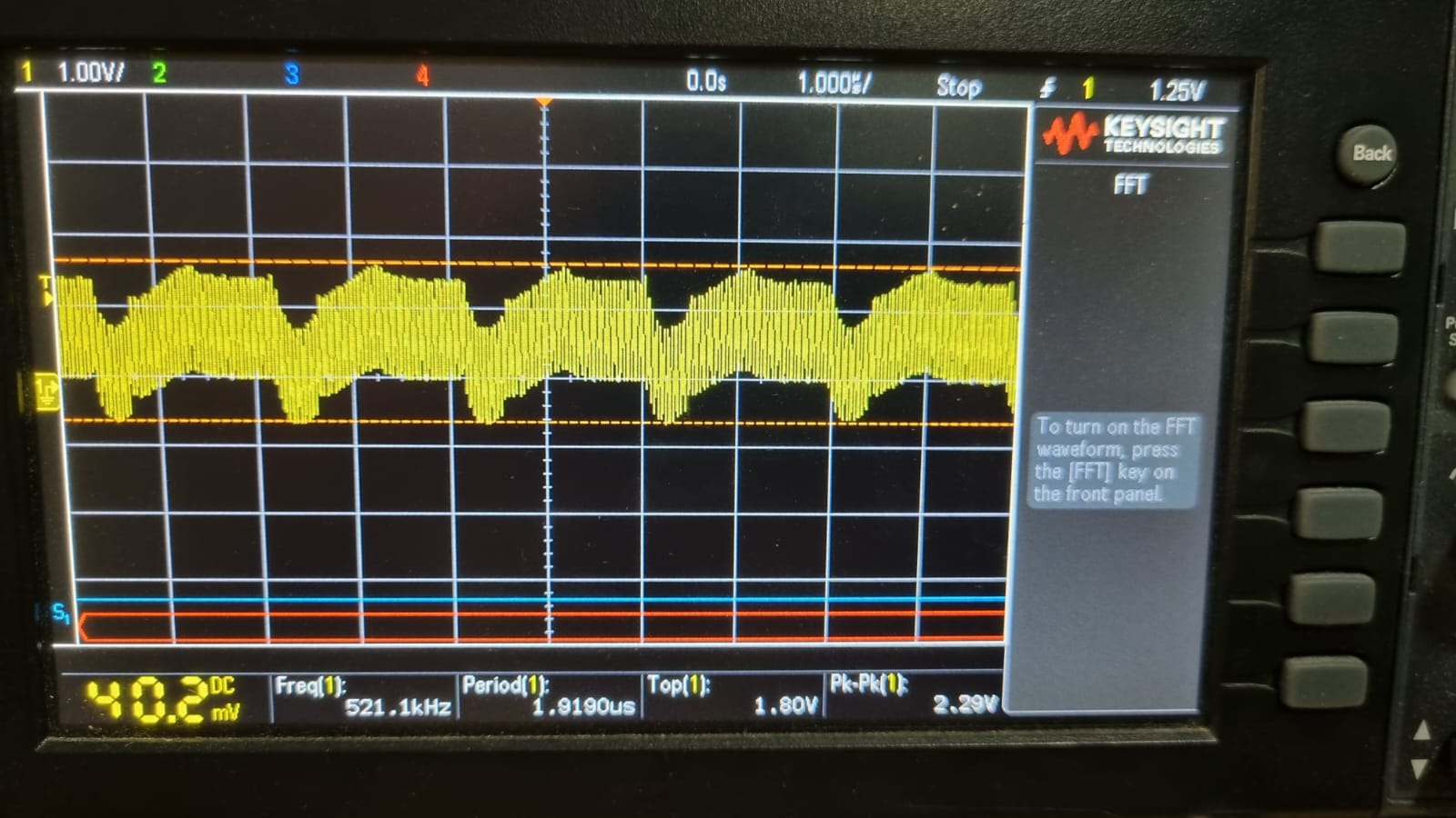

Hi everyone,
I'm working with the QCA7005 and noticed an unusual waveform on its oscillator. Has anyone encountered this kind of behavior?
Also, I observed that the internal 1.2 V regulator is not regulating properly — it's rising to around 1.6 V.
I'm not sure if this is causing the oscillator issue, or if it's the other way around, but I’m worried it could potentially damage the chip.
Despite this behavior, SPI communication works correctly, however, the TX signals do not send RF packet on the output.
I'm following the reference design of the v4.2 board.
Any insights would be appreciated.
- uhi22
- Posts: 1143
- Has thanked: 231 times
- Been thanked: 638 times
I also have seen cases where the 1.2V got higher then intended. These were solder issues, like missing ground on certain pins or missing ground on center pad. The good news is: all my QCAs survived these situations and work perfect after proper soldering .
Thanks, that's something good to hear!
I'll double-check the soldering, especially the center pad and ground pins — fingers crossed that's all it is!
Appreciate you sharing this!

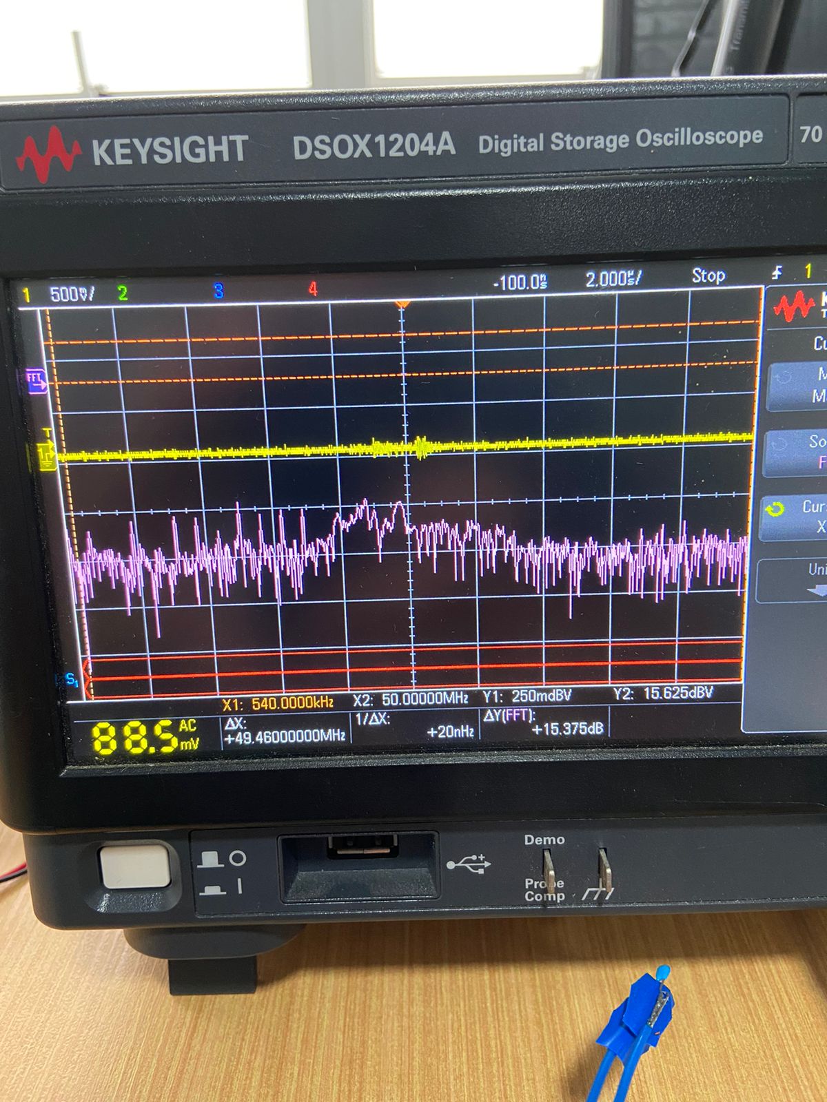

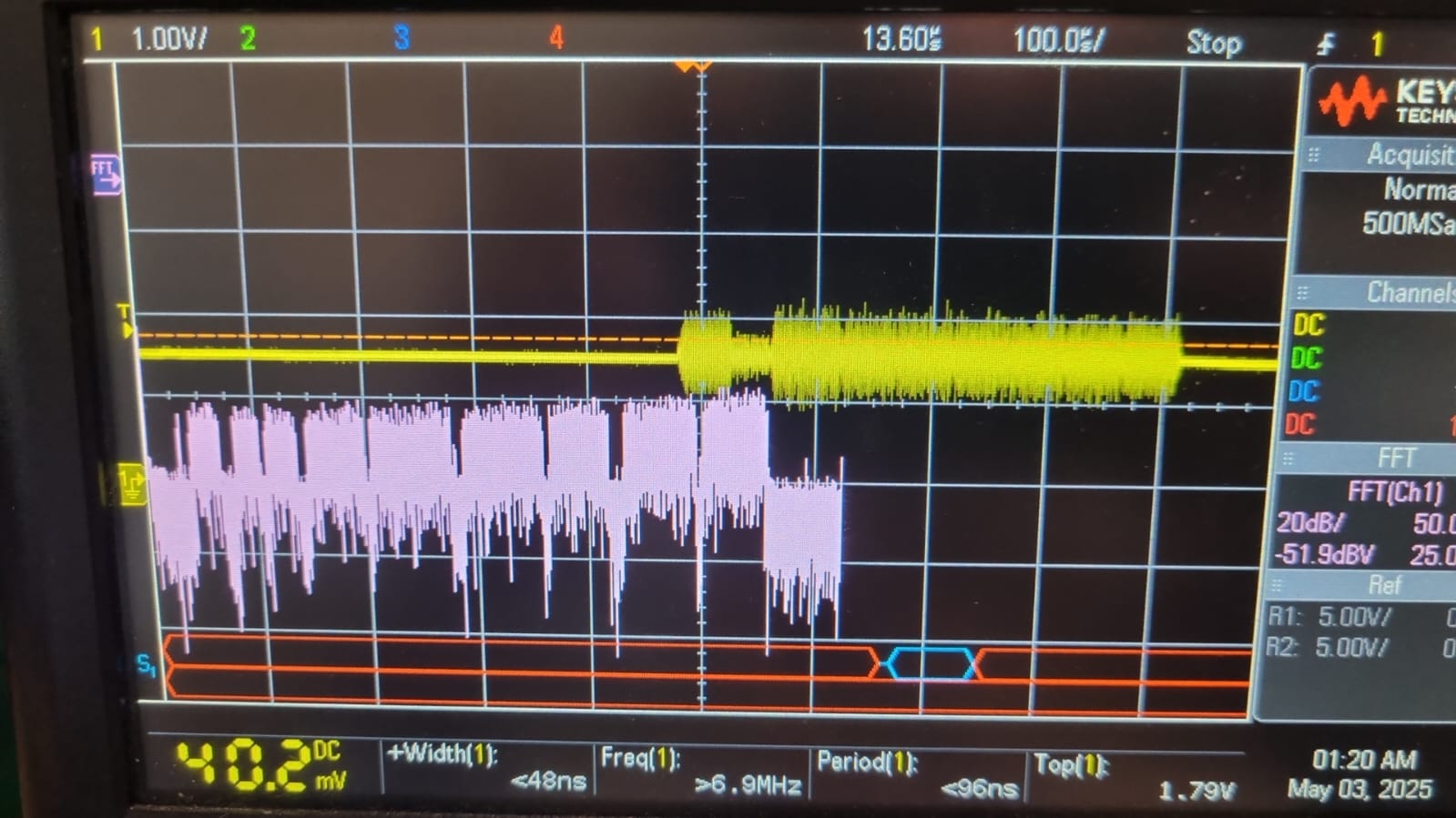

Guys. I'm having trouble getting my QCA7000 board to work, so I'm looking for documents and projects that might give me some clues about what to do. I found a git file with files that might help everybody with the QCA7000 design. Here's the link: https://gitcode.com/open-source-toolkit/3c2616 and the attached file.
My problem is that I can't generate the proper RF signal. The signal intensity is too low and I can barely read it with an oscilloscope. The oscillator is ok, the 1.2 V signal is ok. The board communicates with SPI.
I'm attaching photos of the poorly formed signal and a well-formed signal that I read on a REDBEET board.
Does anyone have any tips on what to try?

- uhi22
- Posts: 1143
Usually this is the result of soldering issues, like shortcut or open circuirt in the RF path. Some voltages and resistances to be checked are mentioned in the trouble shooting guide https://github.com/uhi22/foccci#no-comm ... r-possible
On some V5 boards we have seen shortcuts under the RF transformer.
Thanks. I'll check these points.
Anyway, I'm more suspicious of a systematic error, since I have 5 cards and they all behave the same way.
- Posts: 6969
- Has thanked: 455 times
- Been thanked: 1771 times
Yes, systematic soldering error - had these, too! Uhi fixed 5 of my boards.
- uhi22
- Posts: 1143
This could also point to wrong components, e.g. C10 with 220nF instead of 220pF or something similar. You could compare the signals directly on the TXOUT_P and TXOUT_N, with the signal on the C10 and the signal on the CP line. And if nothing helps, remove the D3, 4, 6, 7, and C10. The TXOUT_N and _P should provide inverted signals with >1V amplitude.
And important pitfall: The QCA will stop sending packets at ~30s from power-on, if it does not see a homeplug coordinator (EVSE). So it may be normal, that you do not see packets.
Wow, I hope I don't have the same soldering problem on the 5 boards! That would be quite frustrating, I always check the soldering on the side pads with a microscope and they seem ok.
Thanks, uhi22. I'm using the board with the FLASH memory firmware as EVSE. I checked and the C10 is at an adequate value.
I'm continuing to investigate and do new tests, if I make any progress I'll let everyone know here.
- uhi22
- Posts: 1143
Maybe the flash image contains a configuration with very small transmit power? Would it help that you share the image, so we can give a try with our boards?
I don't think it's related to the flash image. I got the .bin from: viewtopic.php?p=33730#p33730

Measured the transmit amplitudes using a Foccci 1.0 board, with the aliexpress EVSE_1 and 2, and the Ioniq configuration, which we use on Foccci normally.
The aliexpress configuration has lower transmit power, but still very well visible on oscilloscope.
Summary: each transmit line has 2V (peak-peak, in the preamble) for the Ioniq PEV, and 0.6V for the aliexpress EVSE.
Details here: https://github.com/uhi22/pyPLC/blob/mas ... of-the-qca

So far no progress. I will compare each part of the circuit and components with the REBBEET module. I am suspicious of the quality of the QCAs purchased from Aliexpress. Has anyone had a similar problem?
