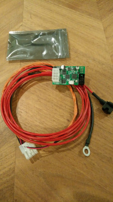

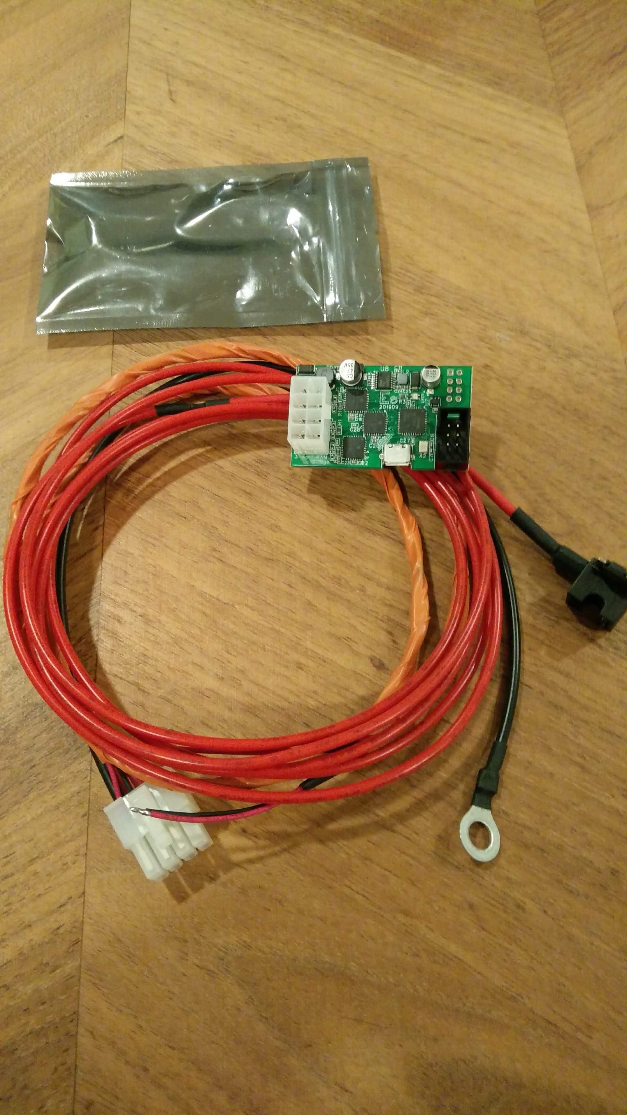

In any case, the kit as provided from them looks like this:

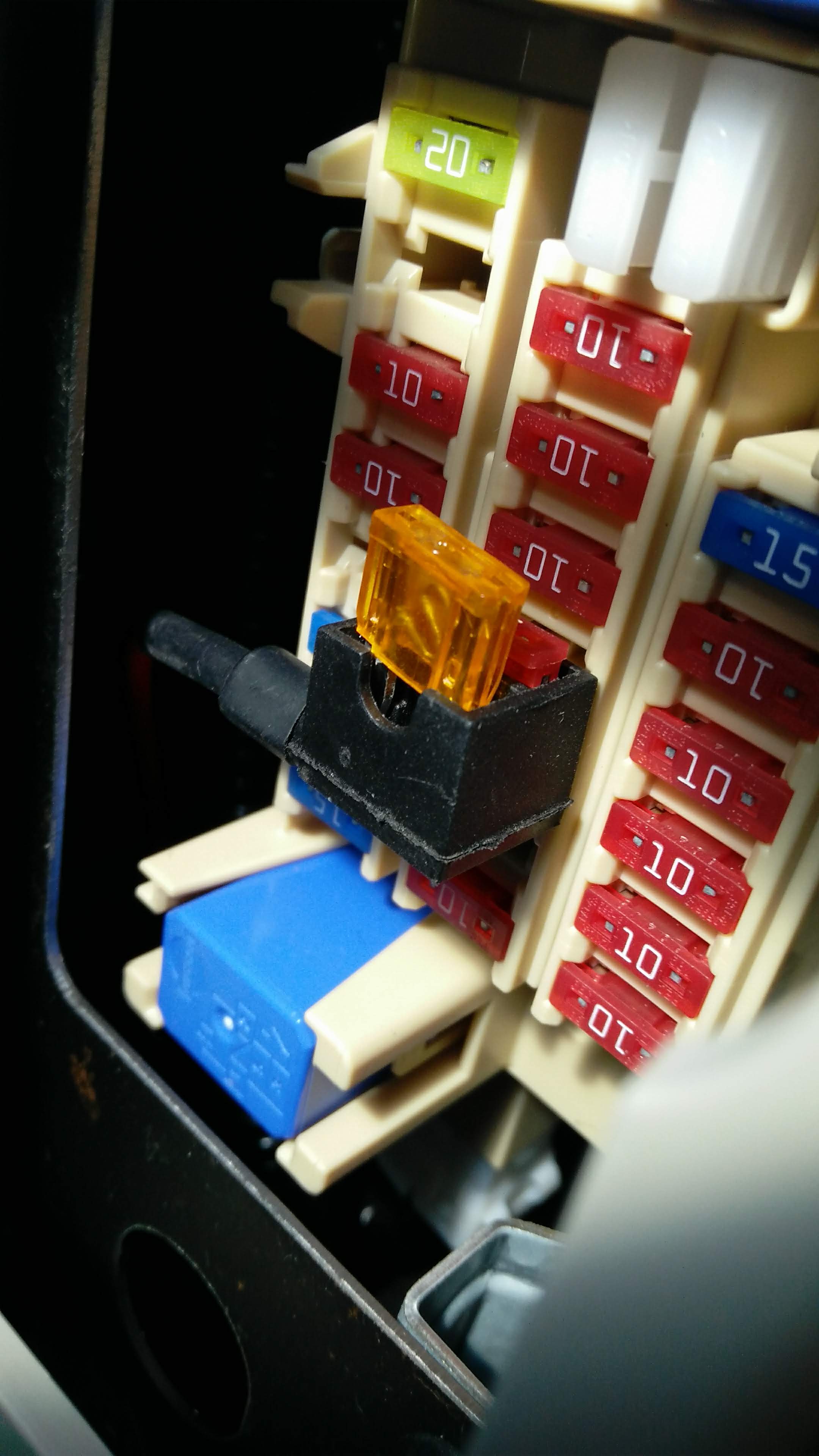

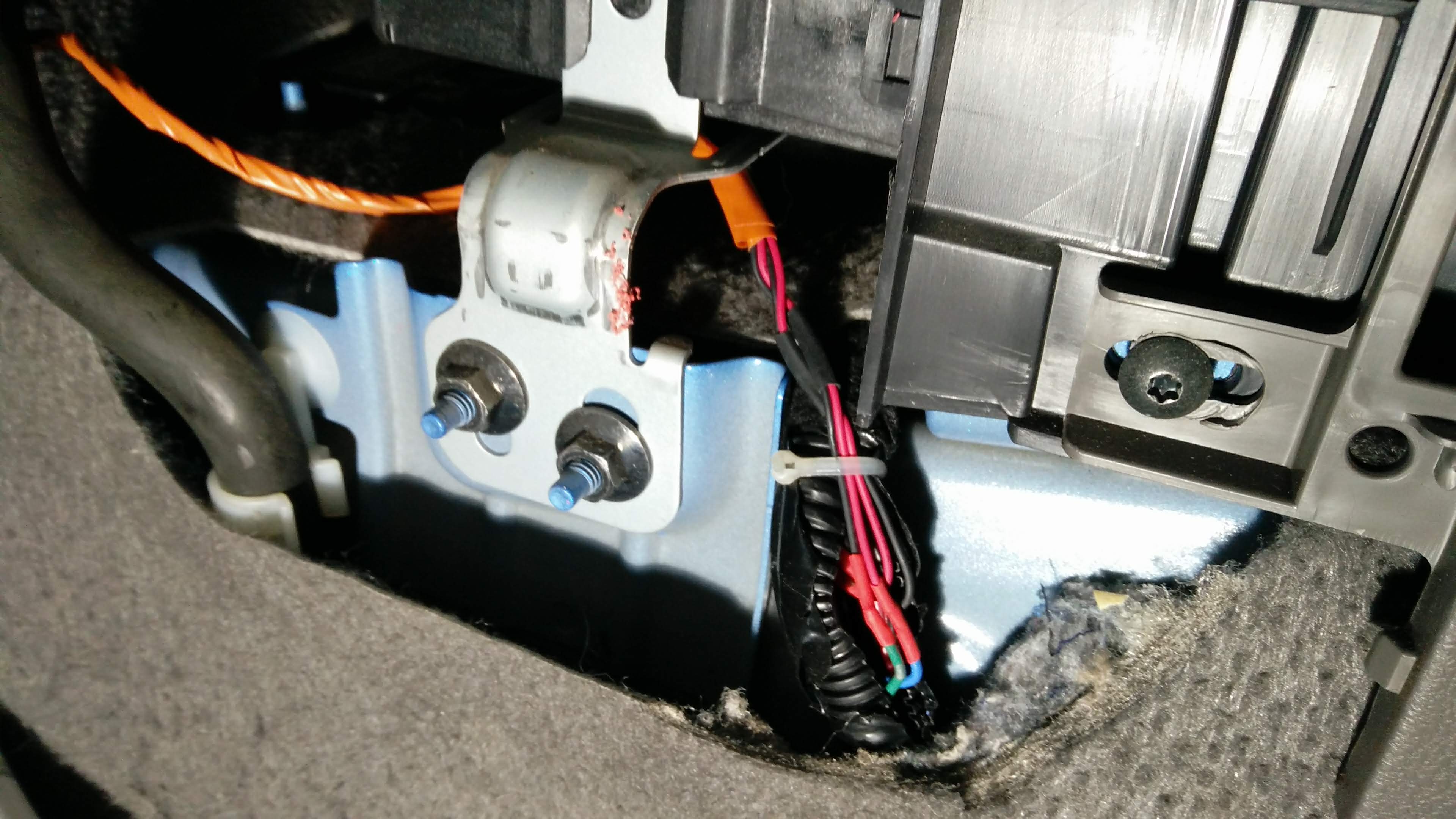

So it's very tidy. It's just a 6-wire hookup. Ground is just a ring terminal to any bolt stud on the VCM, 12V comes with a fuse splitter which can be routed to the board at the left side end of the dash and sits nicely into the cabin lighting socket, and then the remaining 4 wires are the CAN ports which get soldered.
Finally then I enclosed mine in a little plastic enclosure that I had lying around and tucked it up behind the glove box.

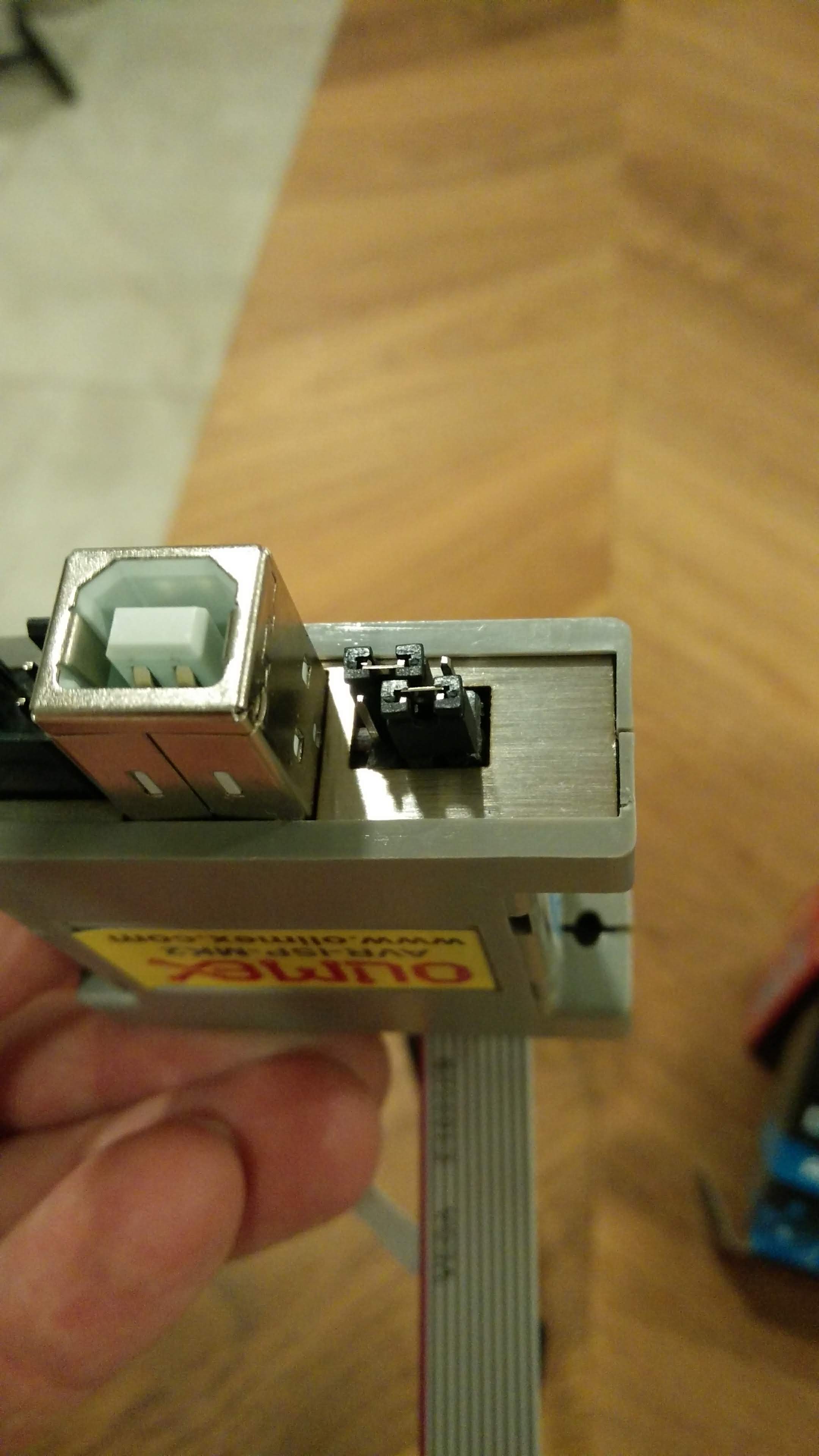

Naturally, the box will need programming. The traffic from the battery needs to be captured for the battery ID challenge-response details (see the usual canmsgs workbook for the addressing etc..). These have to be taken from the battery bus, they don't appear at the ODB port. I used an Arduino MKR1010 + CAN shield, but you can also use the board itself to do the job. Send the codes over to Muxsan and they send back the appropriately configured HEX file for your install. The board is built around an XMega AVR which is programmed using a PDI interface. I used the Olimex AVR-ISP-MK2, setup as shown below (3.3v power active), along with Atmel Studio 7.

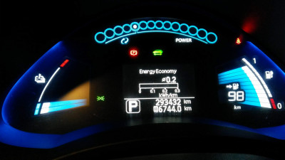

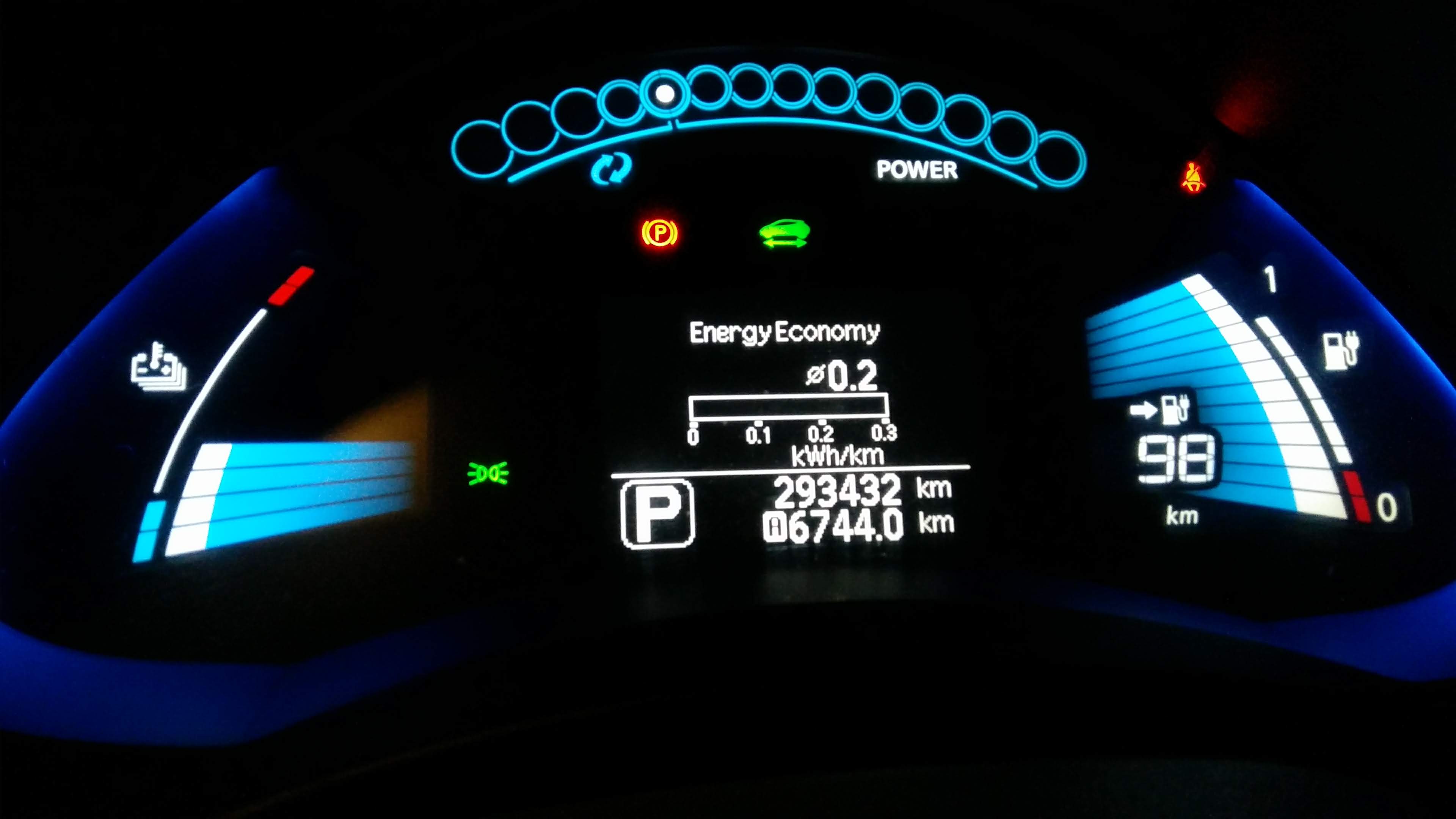

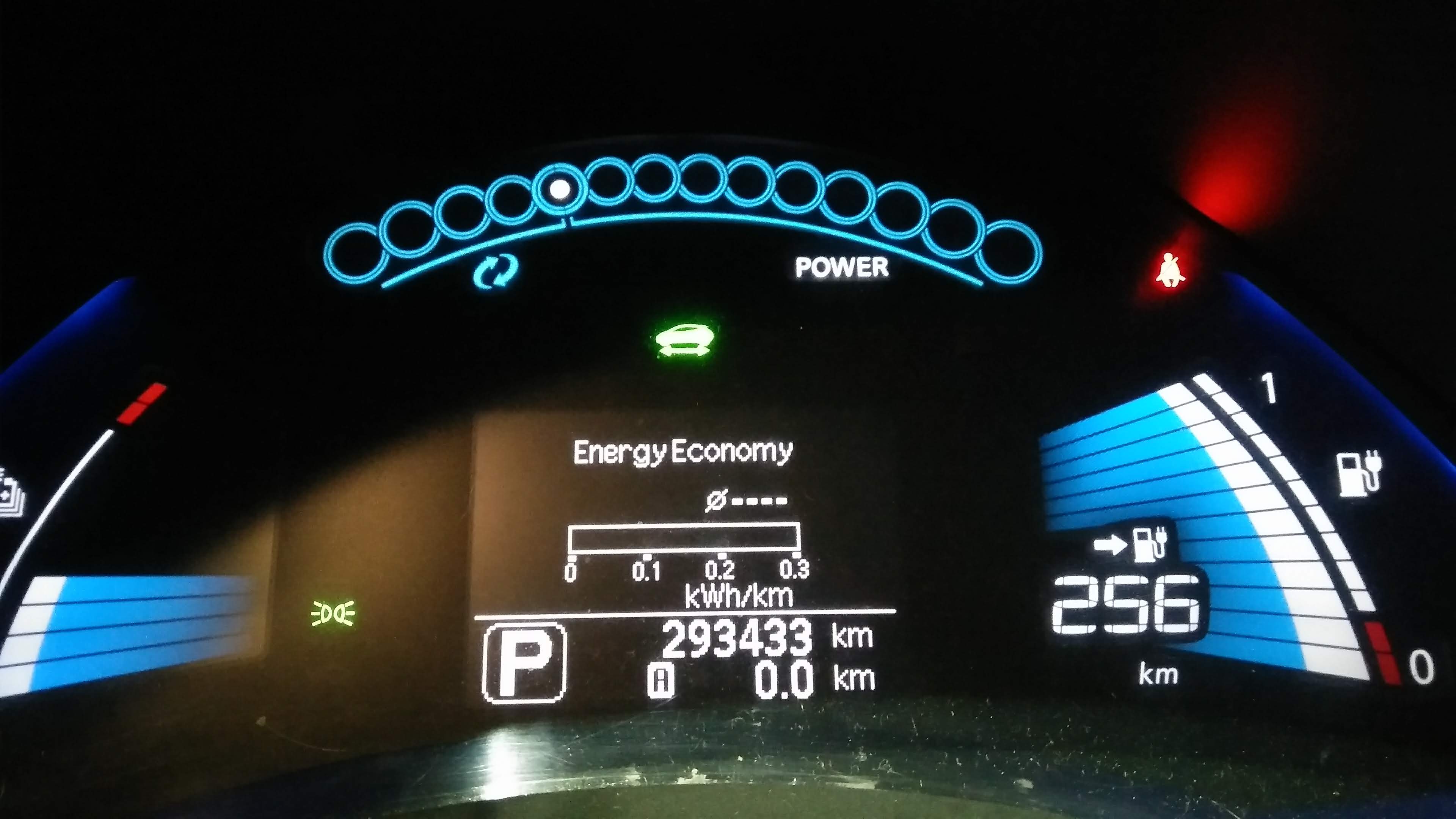

I did the CAN hardware install the evening before I did the battery swap, so my 24kWh pack was still in place. Dashboard before and after install is shown below:
Barring the regen and temperature readouts, it worked just fine - and I figured that if it wasn't compatible with the 24kWh battery I could just jumper the CANbus connectors to re-establish the original bus. Didn't need to in the end and the car never actually went into an immobilised or turtle state.

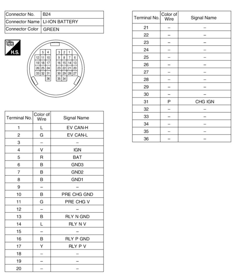

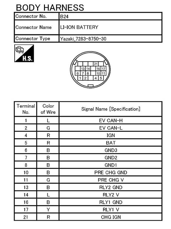

Everyone here is likely familiar with the battery swap procedure so no need to go into that bit, but the Yazaki connector is changed between the 11MY and 13MY+ cars, so that has to be revised. The respective pin outs are below, and it's almost exactly a pin-for-pin swap. If you've managed to get the newer yazaki connector from a Leaf and not an Evalia/NV200, it's very straightforward. The Evalia/NV200 has some redundant wires and the colour mappings are slightly more different. There are only one or two wire colour changes in the former case.
Once you've swapped over the Yazaki, it's just a case of plugging into the pack and taping up the redundant Heatpump port as shown below:
Body panels back on and car off the lift, the next startup looks like this:
and I can tell you - that's a feckin' great feeling to see those numbers on this chassis. :D

Dashboard - 24kWh pack pre instal
Dashboard - CITM fitted, 40kWh pack
12V power on fuseboard
CANbus Splice, just below passenger cup holder
Dashboard - CITM fitted, 24kWh pack
CITM Kit
CITM Kit
Olimex jumper settings
11MY Yazaki pinout
11MY Yazaki pinout
13MY+ Yazaki pinout
13MY+ Yazaki pinout
