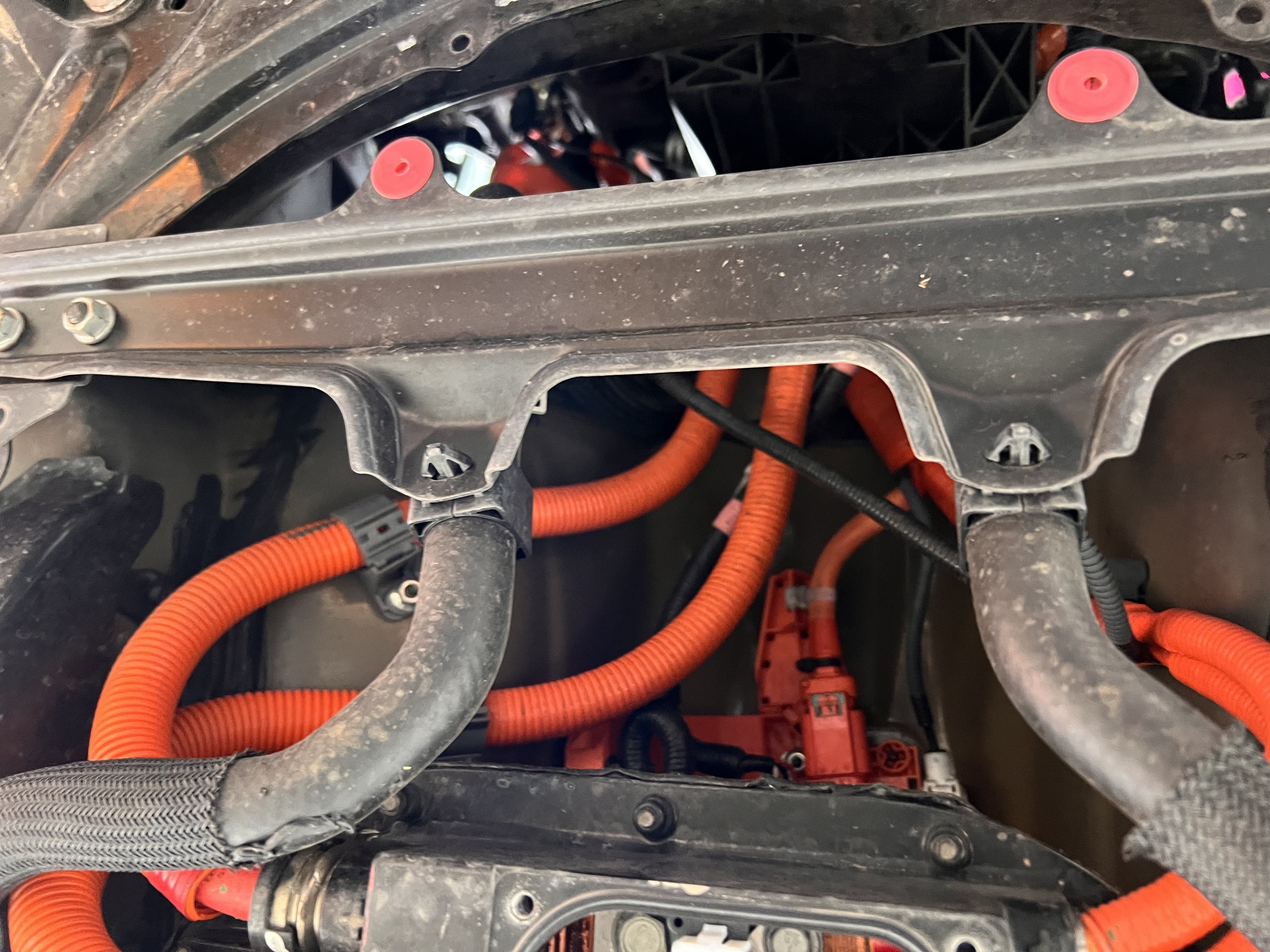

asavage wrote: Mon Jul 24, 2023 1:19 am
Install new DCFC leads (charge port to new HVJB)
  • Install new HVDC leads from charge port's leads to HVJB location
    • May involve dropping the HV battery (840 lbs) a few inches
    • Possibly, the leads may be run down the unused trans/driveshaft tunnel
I had the nearly-ubiquitous HV contactor failure to which so many early Tesla Model S/X and RAV4 EVs have succumbed, so I was forced to drop the battery pack to replace both of them, and my HV battery dehumidifier (yes, it has one) had a failed air pump only a couple of months before. Since the pack had to come down anyway, it was a good time to run the 50mm² shielded cabling from the area in front of the battery pack, to the rear bumper (storage for the excess, until the charge inlet is installed).
There's a cavernous space in the Gen2 RAV4 EV, in front of the HV battery and behind the LDU, above the steering rack, it's huge, so I'm leaving a couple slack feet of cable there, with sealed ends.
Looking rearward at the top of the HV battery:
Looking to the rear, HV battery installed
Looking straight up, HV battery at bottom of pic, plastic LDU wiring support at top of pic:
Looking straight up, in front of the HV battery

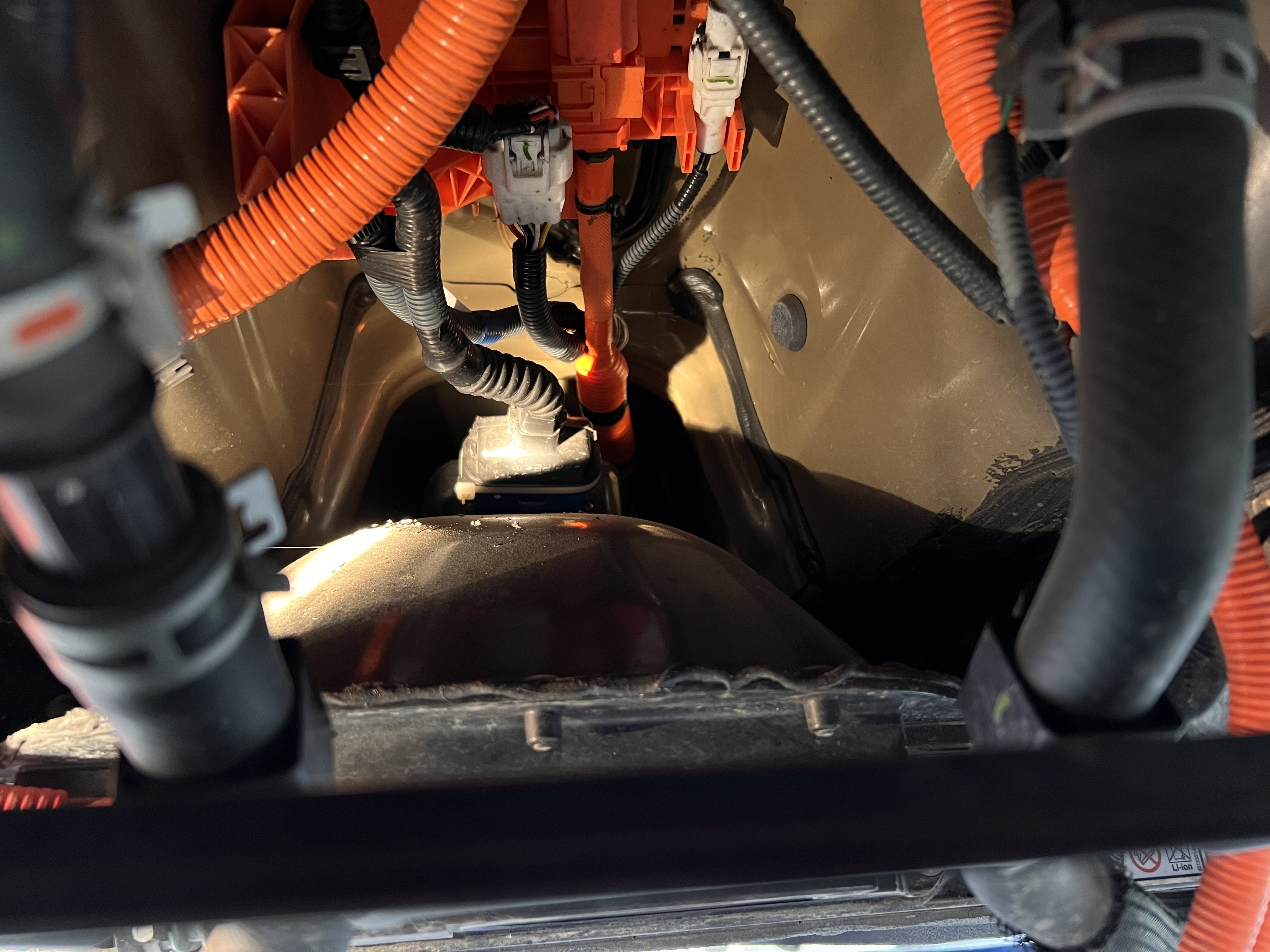

With the battery removed, looking forward:
Looking forward from where the HV ends, battery removed
That's bad lighting, but the space for a HVJB is there.

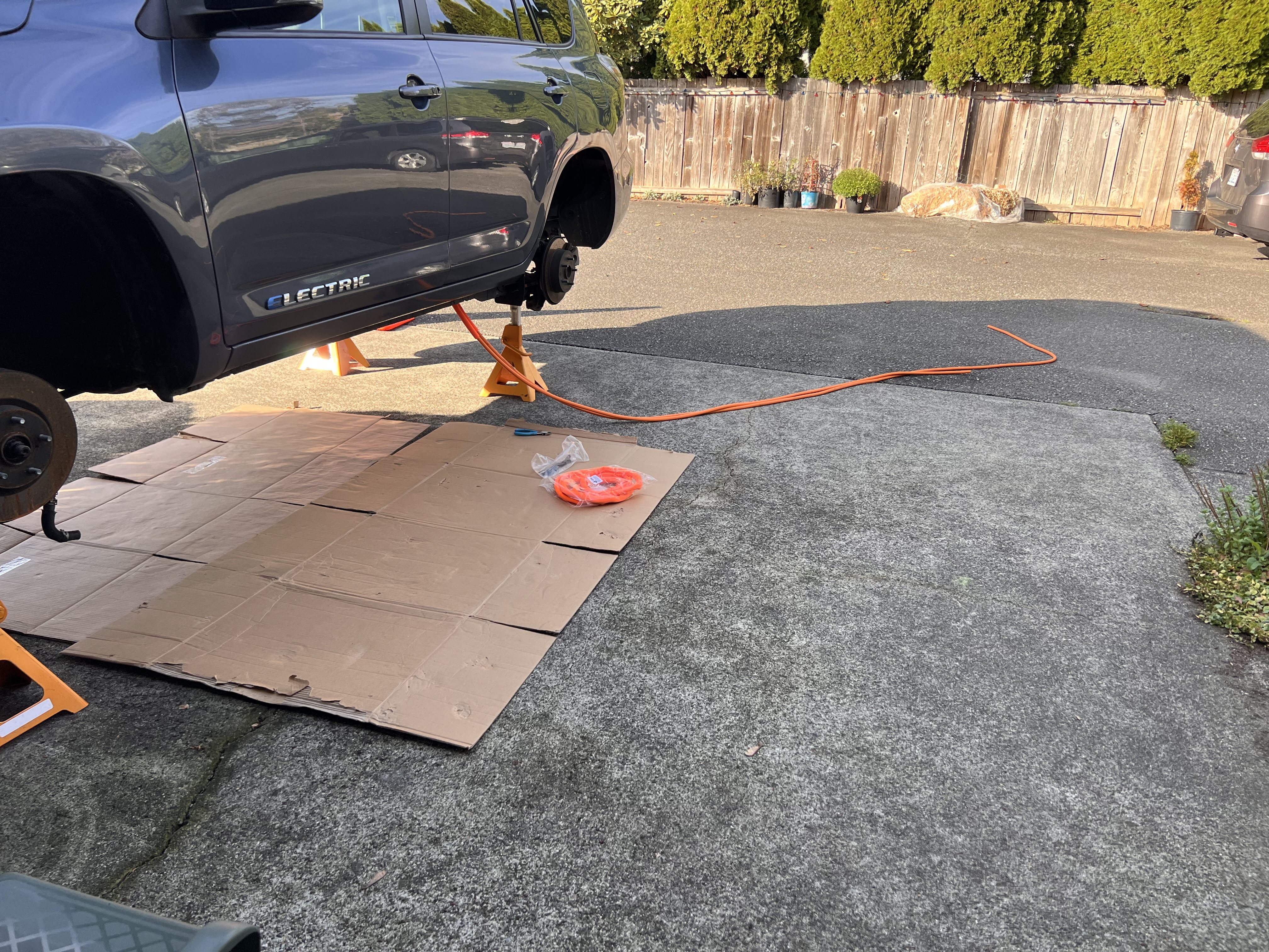

Here's a ten-second tour of the zip-tie job of the cables, from (future) HVJB to front or LR wheel well.
I'll get the HV battery reinstalled, and this excess rear cable mounted in the wheel well and down to the rear bumper, next week, when it stops raining.
