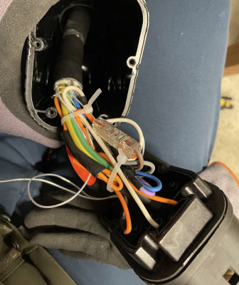

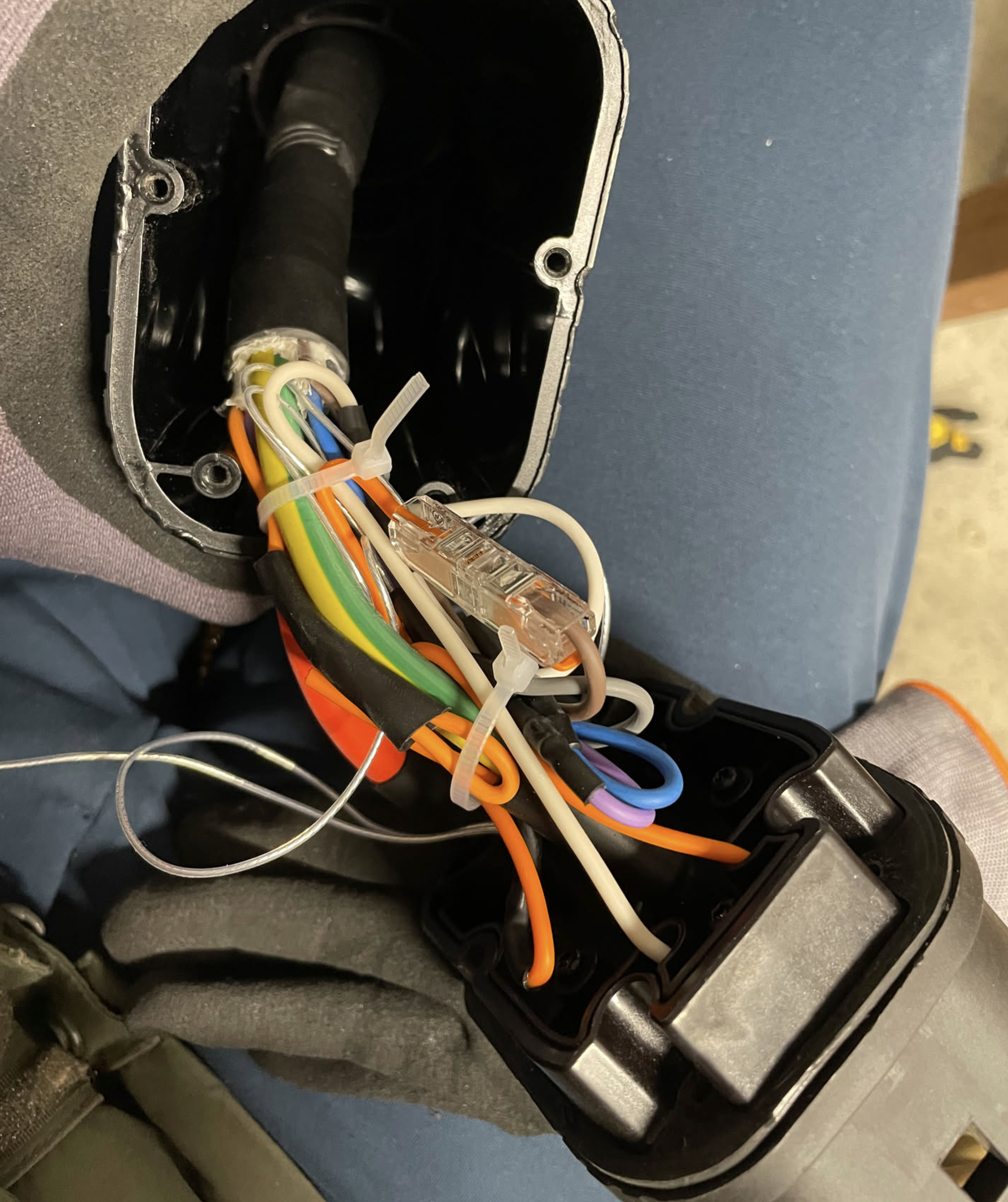

Update from my side: I managed to open the CCS enclosure without breaking it, and used on of the wires of PT1000 sensors to pipe PP back to the wallbox (I'm not using the temp sensors anyways, not going on much with 13A...). That means I have PP attached to a relay, and can simulate an "unplugging event". Cutting PP for a few seconds (together with CP, otherwise the car is not happy) is enough to clear the 15Ah limit. Also note: Really only do a few seconds, otherwise the car tries to close the lid, and that doesn't sound too nice when the CCS plug is still there... :)
In practice that means that when the 15Ah limit is hit, I have a 2min downtime (because I'm also restarting the Pi) and then everything is back to business, without me doing anything manual. wohoo! :mrgreen:

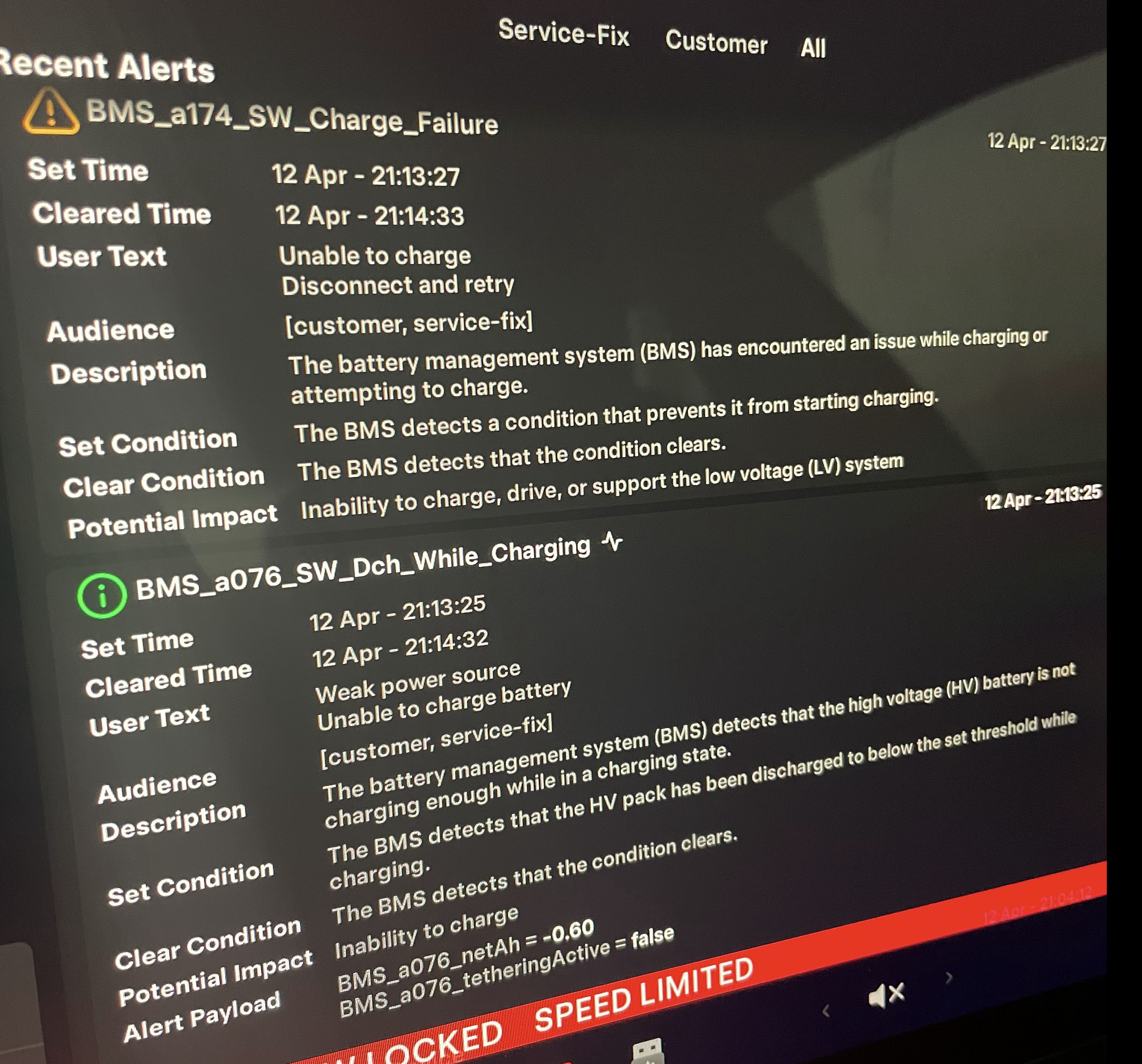

The not so great news is that I somehow summoned a new foe aka. the 0.6Ah limit. I haven't figured out yet how to summon it, but I get it 2-3 times a week. I started to think that I noticed a pattern, but that was invalided last week. By now I believe some Tesla engineer is just trolling me or so :D Alas the same trick as for clearing the 15Ah limit does not work. However if I get the car to sleep that does clear it, which is a bit of a convoluted Home Assistant automation and takes around 15min downtime. That is, stop charging and wait until I see via the Tesla API if the car is sleeping (~10min), let it sleep for a few minutes and then start charging again. Not great, not terrible :D

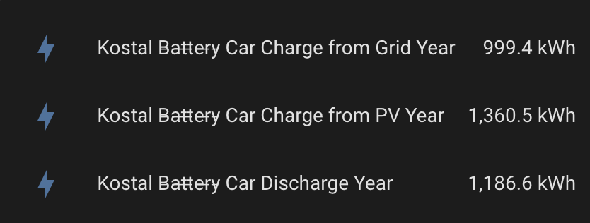

I haven't touched the AC charger since Feburary, stats so far:
