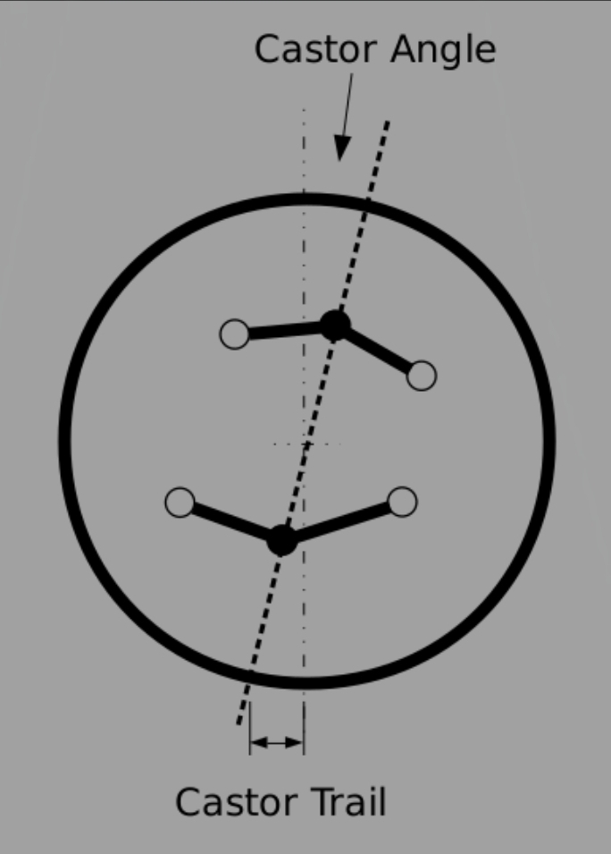

Re: electric power steering mini cooper (R56)
Caster trail is what really accomplishes steering centering. Most vehicles have the ball joints / struts / pivots in line with the wheel center so it's easy enough to just look at caster.
Is the strut / balljoints in line with the wheel bearing center? Does it have at least a few degrees of caster?
Also look at ball joints. When they get dry and crusty they can start to stick.
Could also be the rack is bound up or the assist is doing odd things.
- mane2
- Posts: 261
- Joined: Fri Jan 13, 2023 6:32 am
- Has thanked: 45 times
- Been thanked: 48 times
It has standard caster angle & trail, and on standard steering-box cars it returns to center very well. There is +8,14 degrees of caster, so that should not be the problem (ideal is 3-5). It's been aligned and adjusted many times, trying to find what's wrong. Not binding, struct bearings checked (all new). I'm going to install front sway bar back - it was removed when we thought the battery box wouldn't fit with that. Need to do another round of check if it's binding. If those don't not help, I'm going to switch to this Mini R56 rack and hope for the best. (That it was assist related)
But yeah, that's another topic. Let's keep this thread Mini Cooper R56 EPS related.
