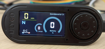

I've been working on a cut down interface for ZombieVerter that runs on a Lilygo T-Embed device. It also allows for setting of some parameters. More will be added.
This uses Can SDO to send and request values from ZombieVerter. To Edit a value, click the central button once, rotate the rotary clicker and double click once on the desired new value.
https://github.com/jamiejones85/ZombieVerterDisplay
You will need to add a can bus transceiver, I've designed a backpack board that will give the can bus and 12V input, I will update with the design files once tested.

This looks really smart, I was looking at the speed hut gauges, this looks like a more affordable option.
Look forward to updates

Nice! So this could be a neat way for selecting presets, with a range of parameters under each preset - eco, sport, etc with things like throttle response and currant limits different for each preset!

The can bus and power supply boards arrived and working. I can order another batch of there's any interest
