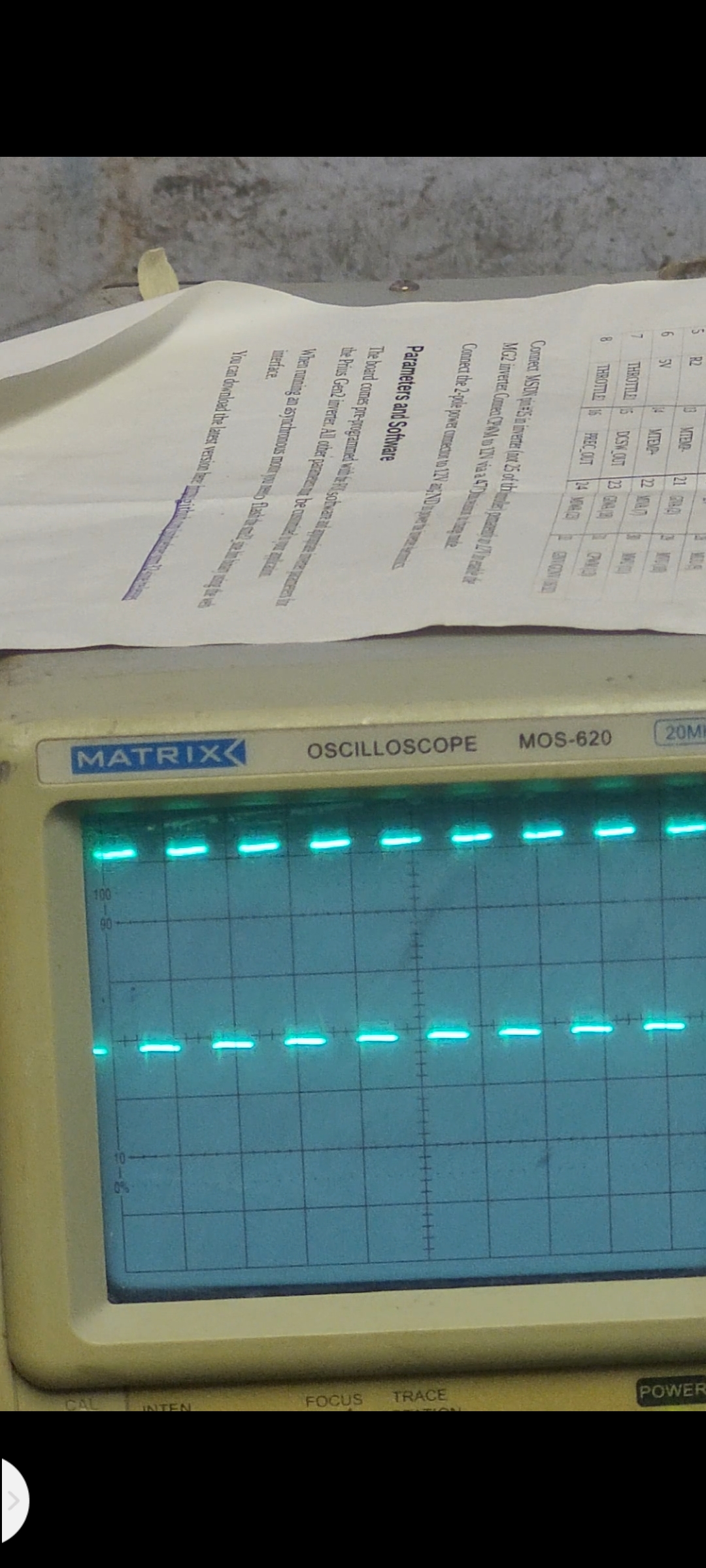

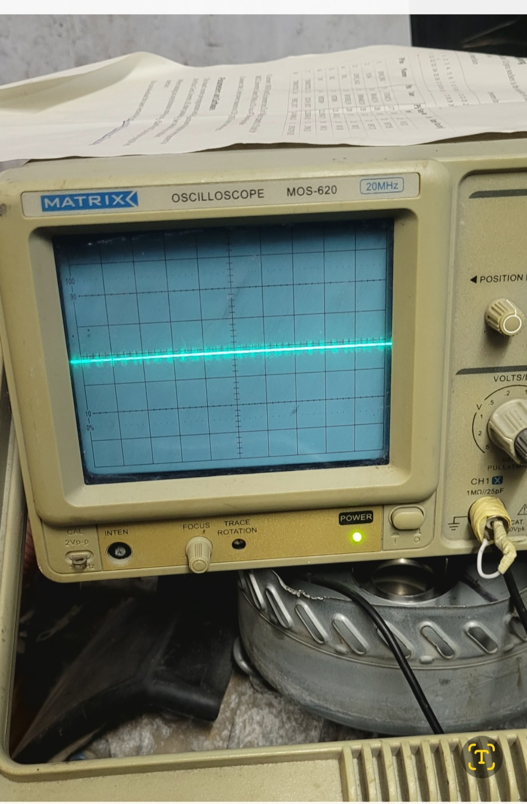

voti wrote: Sat Apr 05, 2025 11:56 am Then from there I logged in the web Interface, set ocurlim -1 ampnom 1 fslipspnt 1 selected manual mode and hit start inverter in manual mode. Went to spot values, refreshed and confirmed manualmode.
Then I first used my multimeter to test for voltage on the ic6 chip. First I tested pin 8 GND and pin 9 VCC and I found 14.57v which my power supply is supplying (15v) the I tested pins 5,6,7 against pin 8GND, the pins 5,6,7 and thr ones on the left side of the ic6 which are input that Johu said I should test, right?.
With the scope I couldn't barely find any readings as I got 0.01v on all this three pins. When I tested using the scope the horizontal green bar on the scope barely moved and it just shifted I think by 0. Something on the horizontal axes I had it on. I hope you understand what I mean. But in shot in barely moved because when I tested pins 8 and pin 9 of ic6, the green horizontal bar shot way up, so high that it couldn't read on the screen, way above 100%.
I just confirmed the tests again. Had my dirmode on DefaultForward, set ocurlim -1 ampnom 1 fslipspnt 1 selected manual mode and confirmed manualRun in opmode. The results were the same as the ones quoted above. I used my multimeter to confirm input voltage to the ULN2003 which is through pins 8 and 9, and I got 14.45v. I went on to test pins 5,6,7 against pin 8 which is our ground and all three pins gave a reading of 0.01v.
When using the oscilloscope to confirm this, I placed my positive probe to pin 9 which is + input. the green line on the scope shoot way above 100.
When placing the positive probe on pins 5,6,7 now the green line barely moved.

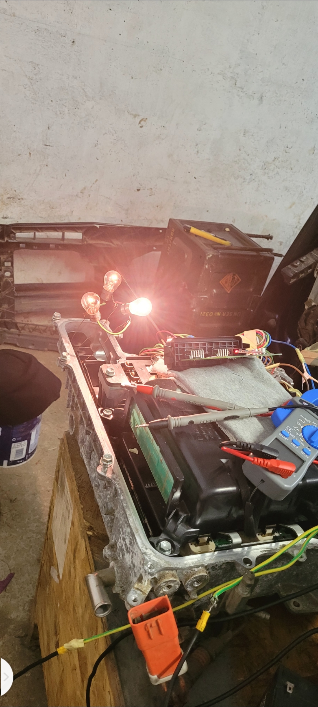

Had to do a bit more research in order to understand what I had to do for this work. I disconnected both pin 11 and 12 which were connected to my power supply "15v" input in order to turn them low. Then I put in the settings on the web Interface and started inverter in manual mode.
First thing I noticed is the whine pitch sound made by the controller suddenly changed and this was a first, it had my eyebrows raised. I confirmed pins 5,6,7 on the ic6 chip and I found that for the first time I got readings and they were 1.6v on each pin. I connected my oscilloscope and confirmed that a square waveform was visible, a bit noisy yes but I saw the square pattern.
I attached three pictures below. First one was before I put in the settings second one for testing the oscilloscope if it works thus we see a perfect square wave then the last one at the bottom is the waveform I got from pins 5,6 and 7
voti
Posts: 73
Joined: Wed Oct 02, 2024 12:35 pm
Has thanked: 13 times
Been thanked: 6 times
Re: EV Conversion using prius gen 2 inverter/transaxle
Post by voti »
WE HAVE FLASHING LIGHTS PEOPLE 😃😃😃😃😃😃😃😃😃😃😃😃😃😃😃😃😃😃😃😃😃😃😃😃😃😃😃😃.
I'm super excited to witness this. I couldn't have done it without all of your guys here. Thank you so much🫡.
Thank you for your consistent patience with me. When I started this project I didn't know anything about what I was doing, but you were patient with me. I still have a lot to learn from you guys so please don't give up on me.
Like MattsAwesomeStuff said before, I'm not out of the woods yet. I still need to learn more about the functions of all the other parameters and how to get them working for me. I've never done this in my life, and I've never been to any electronics class. Your assistance will be greatly appreciated 🫡

RetroZero wrote: Mon May 19, 2025 7:53 pm Did I understand you provided 12v to Pins 11 and 12?
Yes I did. I had connected this pins as per the connection diagram i found on the wiki, Please correct me if I had them wrong.
Check attached screenshot.

I did test with Boost at 20 000 and it didn't spin. RetroZero said he updated the wiki to boost 37 000.
I put 37 000 but still the motor didn't spin.
The video I uploaded above I jad my boost ay 37 000.
I think I saw the video of Damien testing the exact gen 2 motor. His test was done a bit different from Johannes'. Damien set fslipspnt to 3 and then he increased ampnom bit by bit I'll his motor spun.
If you noticed I also tried that on the video but it also didn't work

What was the light bulb that is connected in series on your High Voltage circuit doing? Does it light up brightly?
