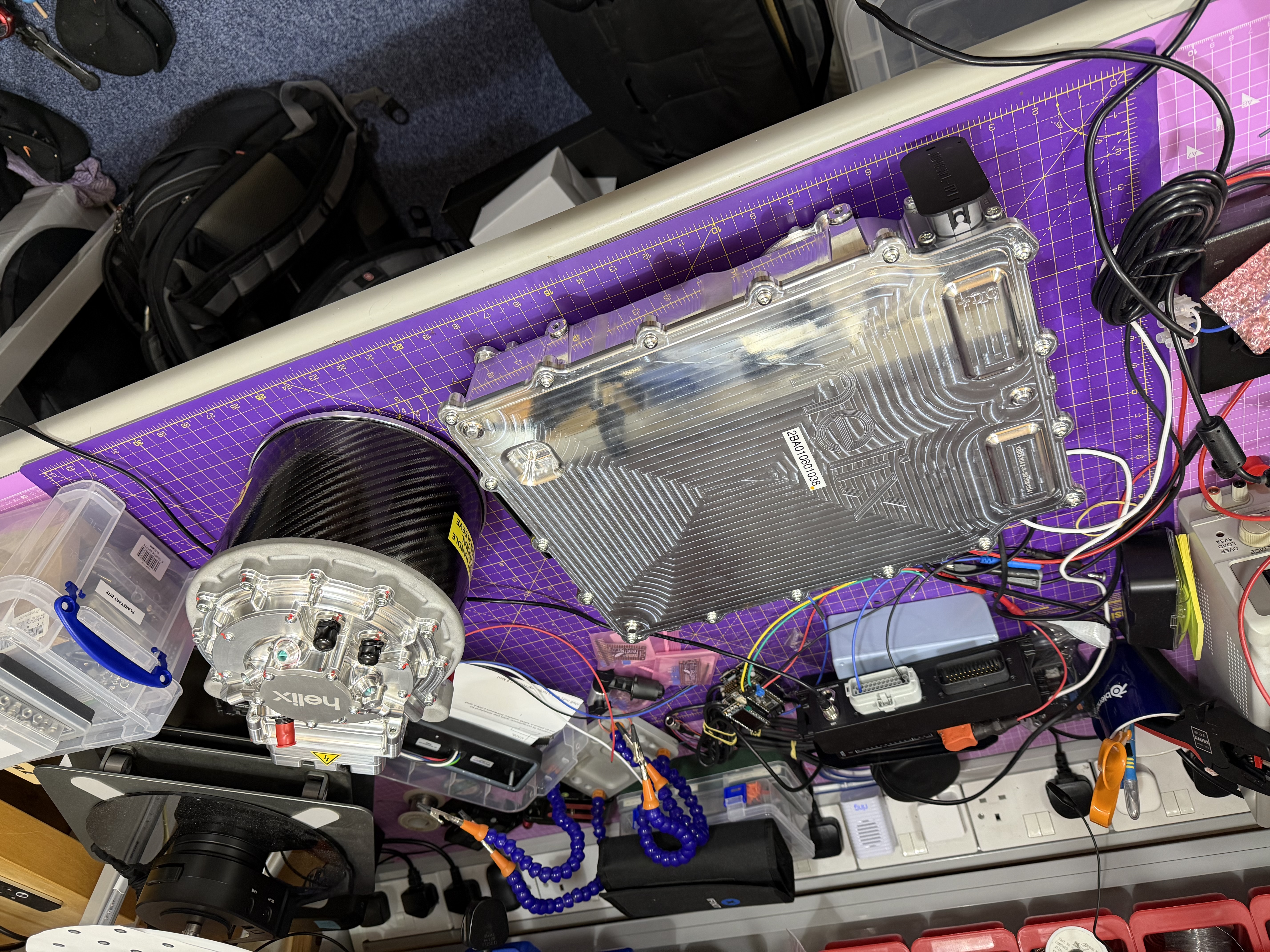

Hi all, I guess it’s time for an update…
So, I’ve been busy since my last post, but probably not a lot to show for it.
First up was to collect my motor and inverter from Helix. They’d had the pair on a dyno for a week or so doing the characterisation. All seems to be good, though I am waiting for a firmware update that should be with me soon. Here’s the two on my workbench. And because I now have them in my hands, I’ve been ordering lots of connectors, pipework, coolant pumps and test fixtures. Hopefully I’ll have a test rig set up soon.
Grrr… we all love iPhone inverted images. Hopefully you get the idea!

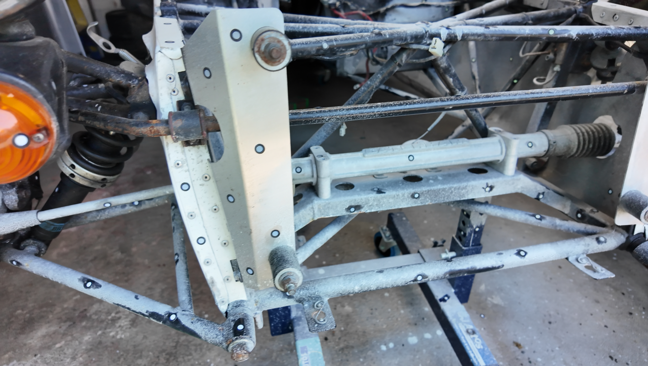

Next, I’m getting ready to rescan my project car. I did a scan a couple of years ago, but I’ve levelled up my scanning skills since then and I think I can do a better job now (I missed a few bits that I didn’t think I needed then, and I didn’t get the accuracy I hoped for, but I know how to do it right this time). So, I’ve added a few hundred scanning markers to my car and I’ll at least double that to cover the rest. I get much better results with my laser scanner, so markers are a must.
