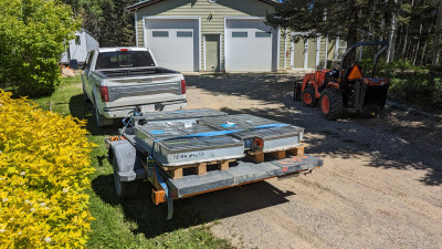

This is starting to get real.
qty 3, BMW i3 42kwh battery packs bought at auction with fees, taxes and delivered to my trailer, for around $3200 CAD (approx $2350 USD). Condition not yet known.
