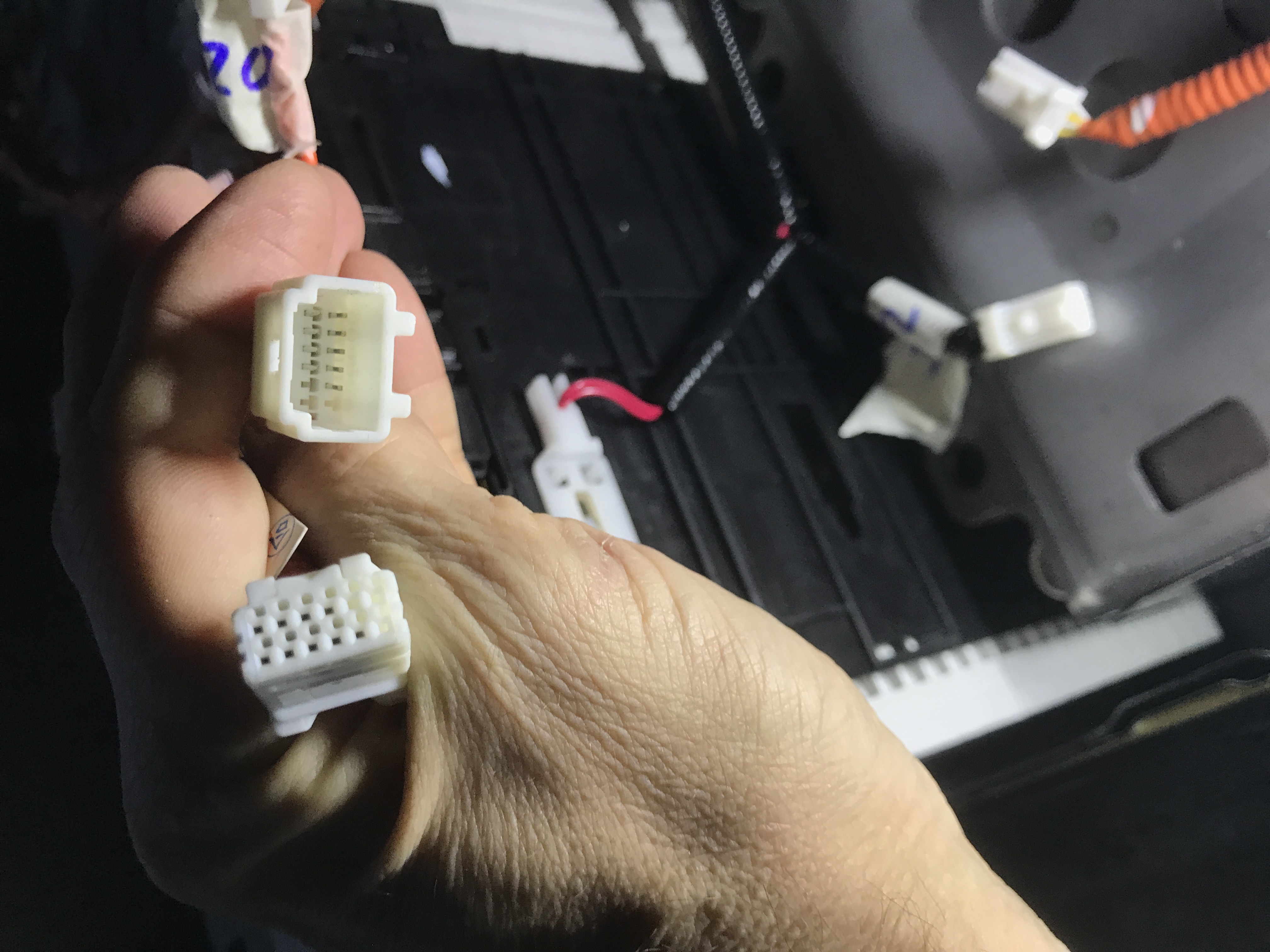

Re: [WIP] Leaf to VW Type 2 Campervan
Sanity check before I get into serious charging / balancing efforts.
In a classic leaf module you have access to both positive and negative terminals. Makes measuring and balancing if necessary pretty straight forward. Nice easy to use m8 bolts to connect with aswell. Unfortunately this no what I’m working with.
In my lovely 9s3p tall leaf module I only have access to each positive pin for each of the 9 series cells. Plus the main positive and negative terminals for the whole module. I can’t specifically see a separate negative pin for each cell.
Since I cannot see the internal wiring or construction within the module’s welded case I would appreciate thoughts on the safety of using the next positive pin from the cell in series after my weak cell as my negative point in order to only add volts to the one I’m interested in. There is no way to just deal with the weak cell in isolation from the rest of the series.
Someone will be along to confirm but as I'd understand. You'd use the positive of cell 55 and the positive of cell 56. This would create a circuit across cell 55 only and this bump its voltage up. You can use a multimeter to find those on the connector (using jump leads so you don't short out any cells accidently).
in general, the minus of cell 55 should be the plus of cell 54. why did you decide on 56??
As stated, the positive of the next cell is the negative of the previous. Or vice versa.
They are in SERIES.
Just remember, these modules can deliver infinite current, and I’m not sure the cell taps are fused, so any shorts will melt the cell taps pretty quick

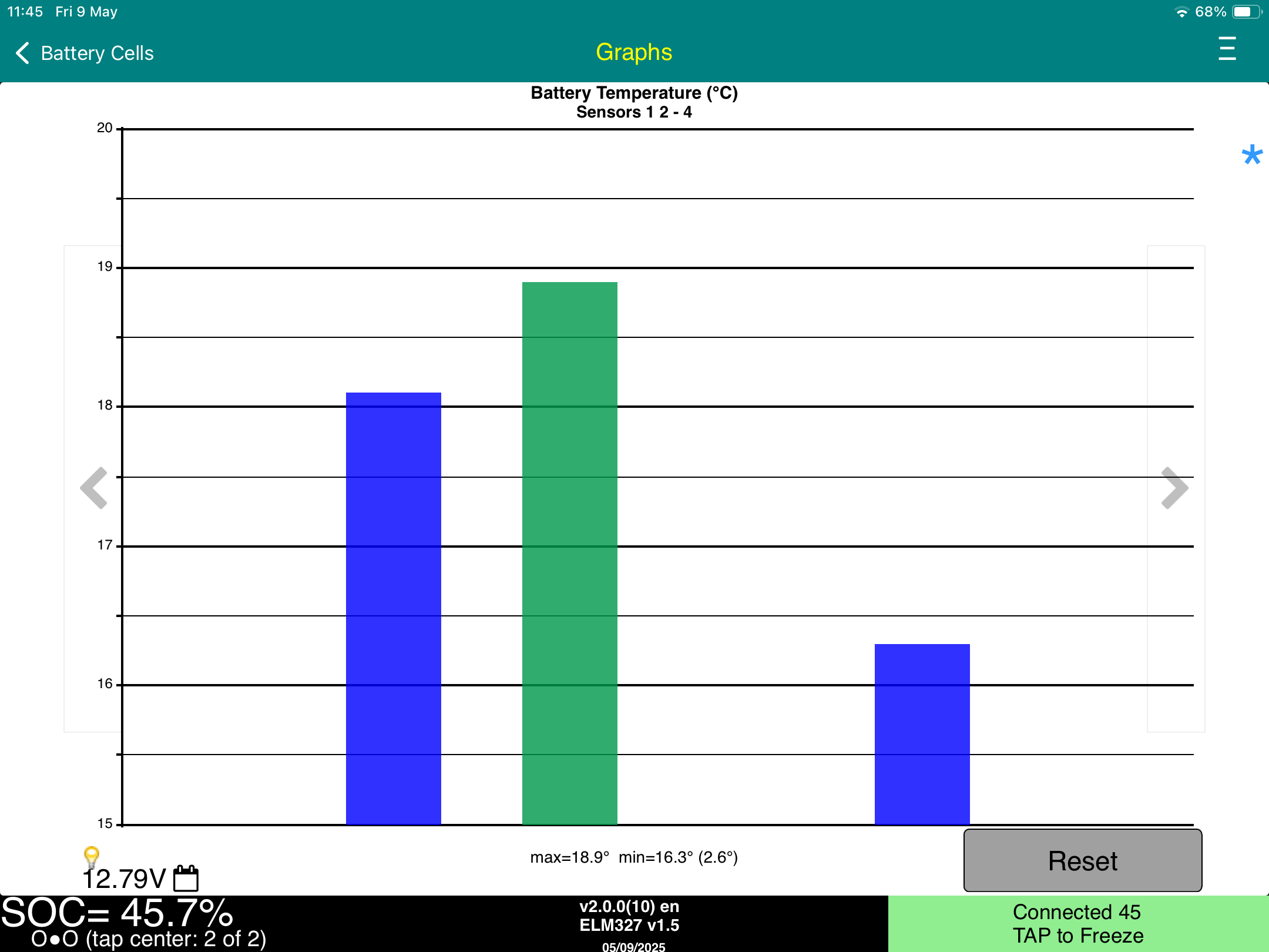

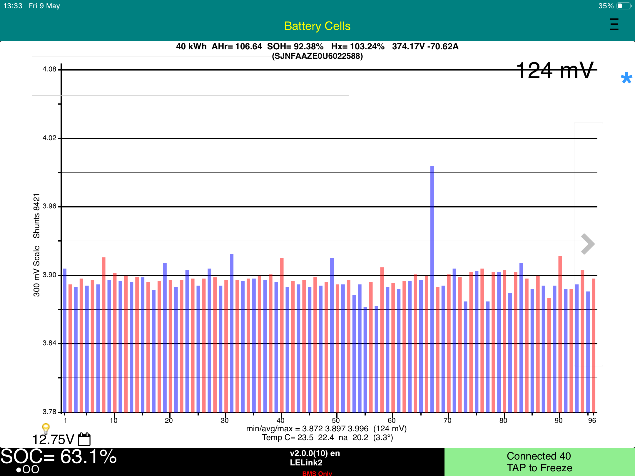

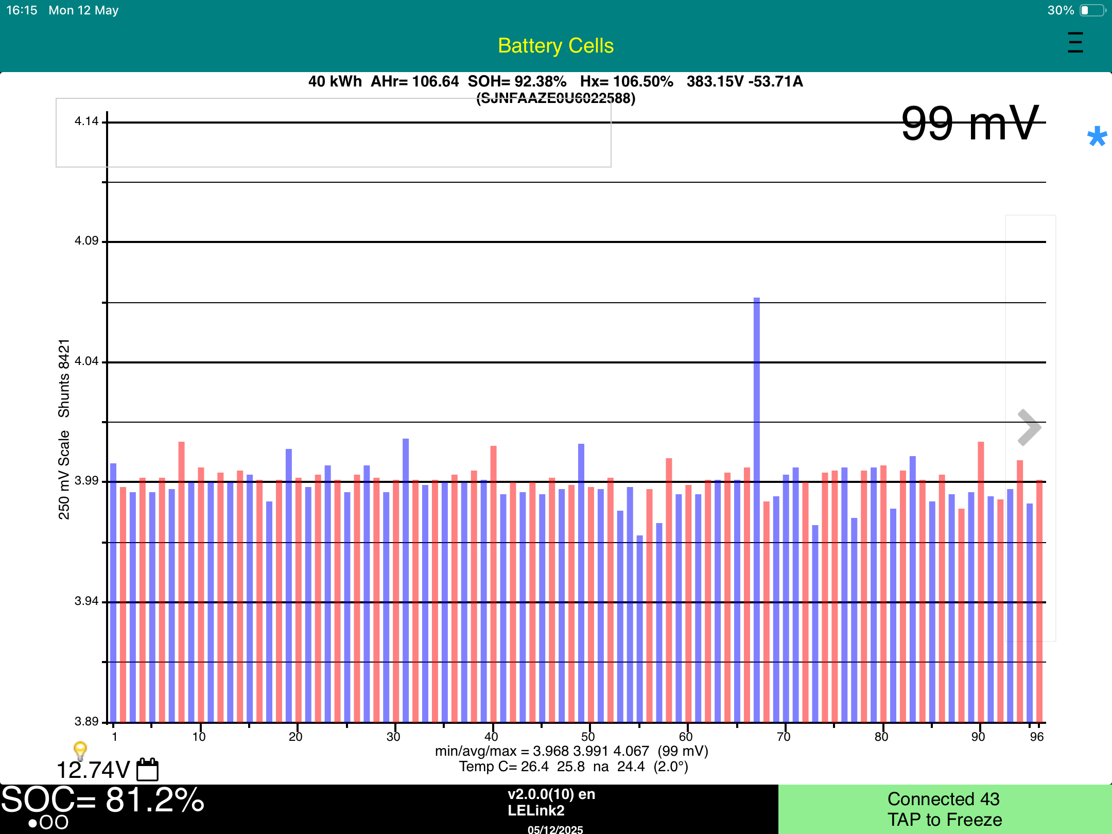

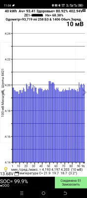

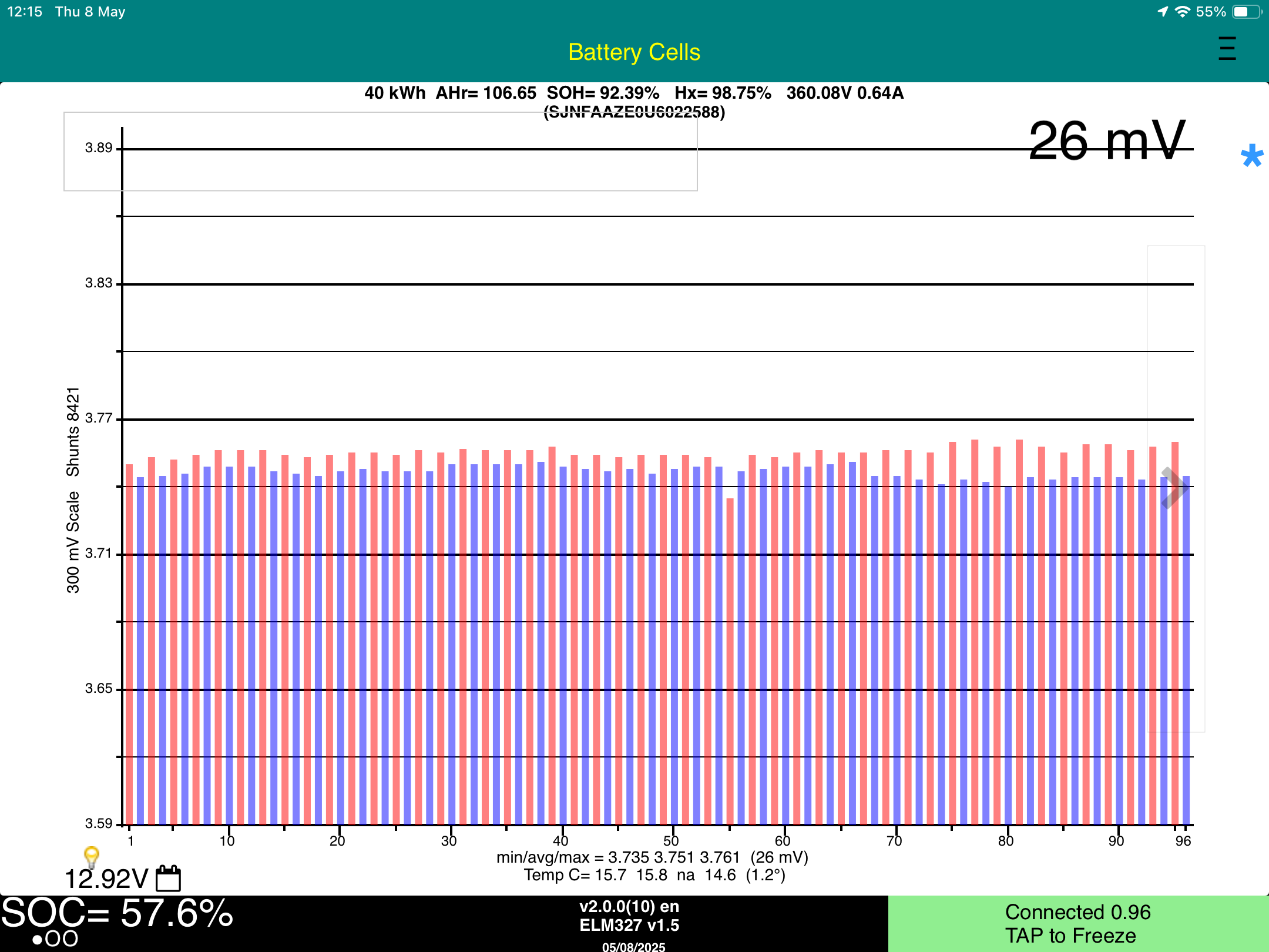

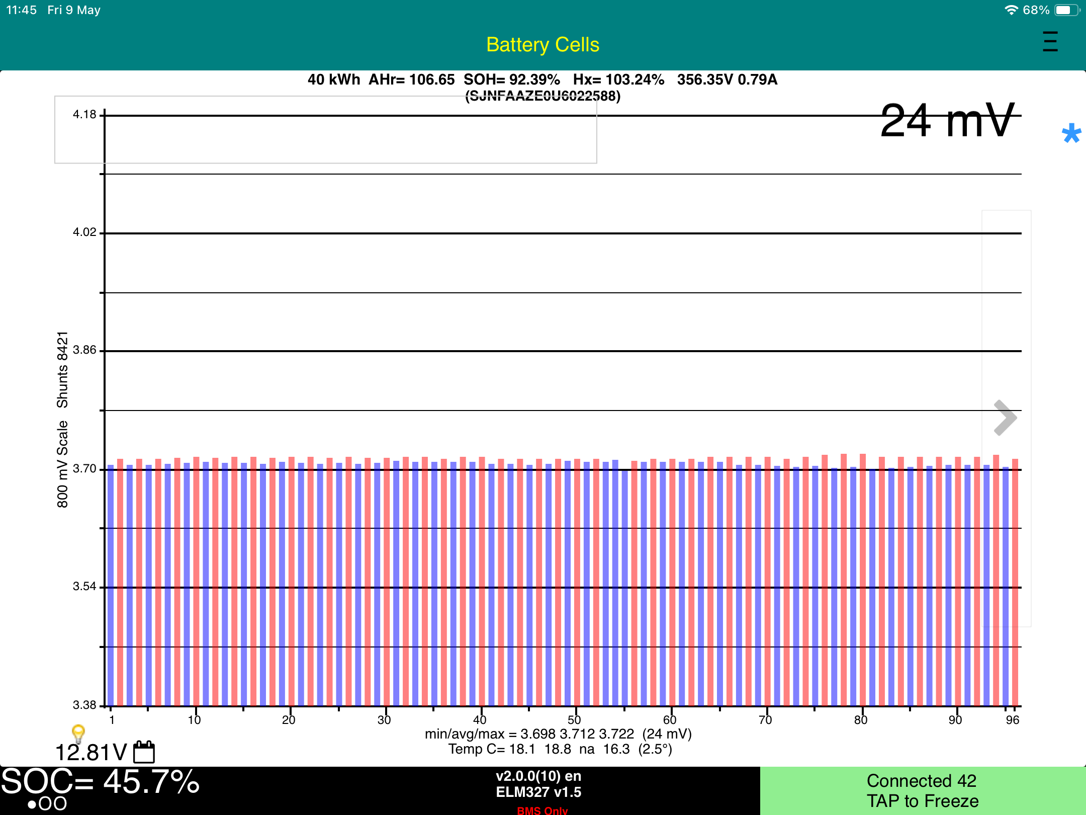

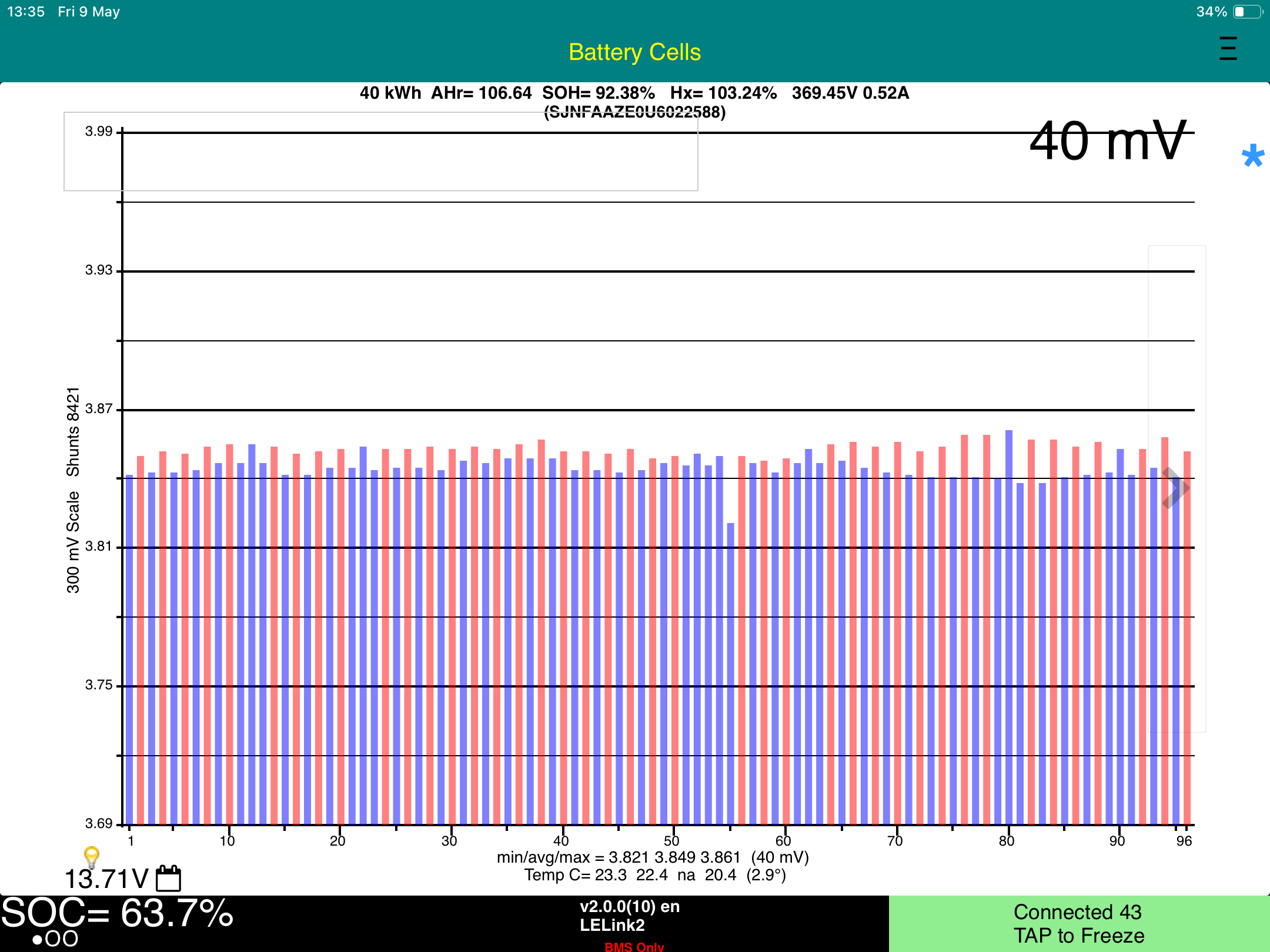

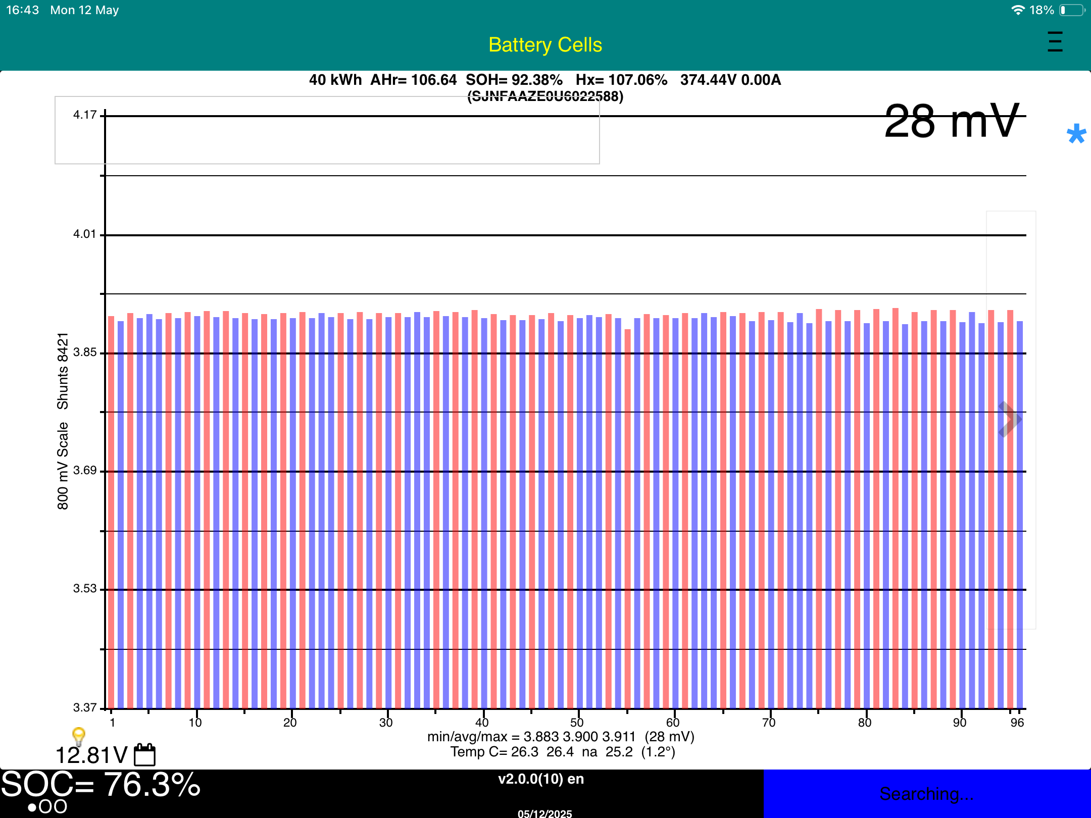

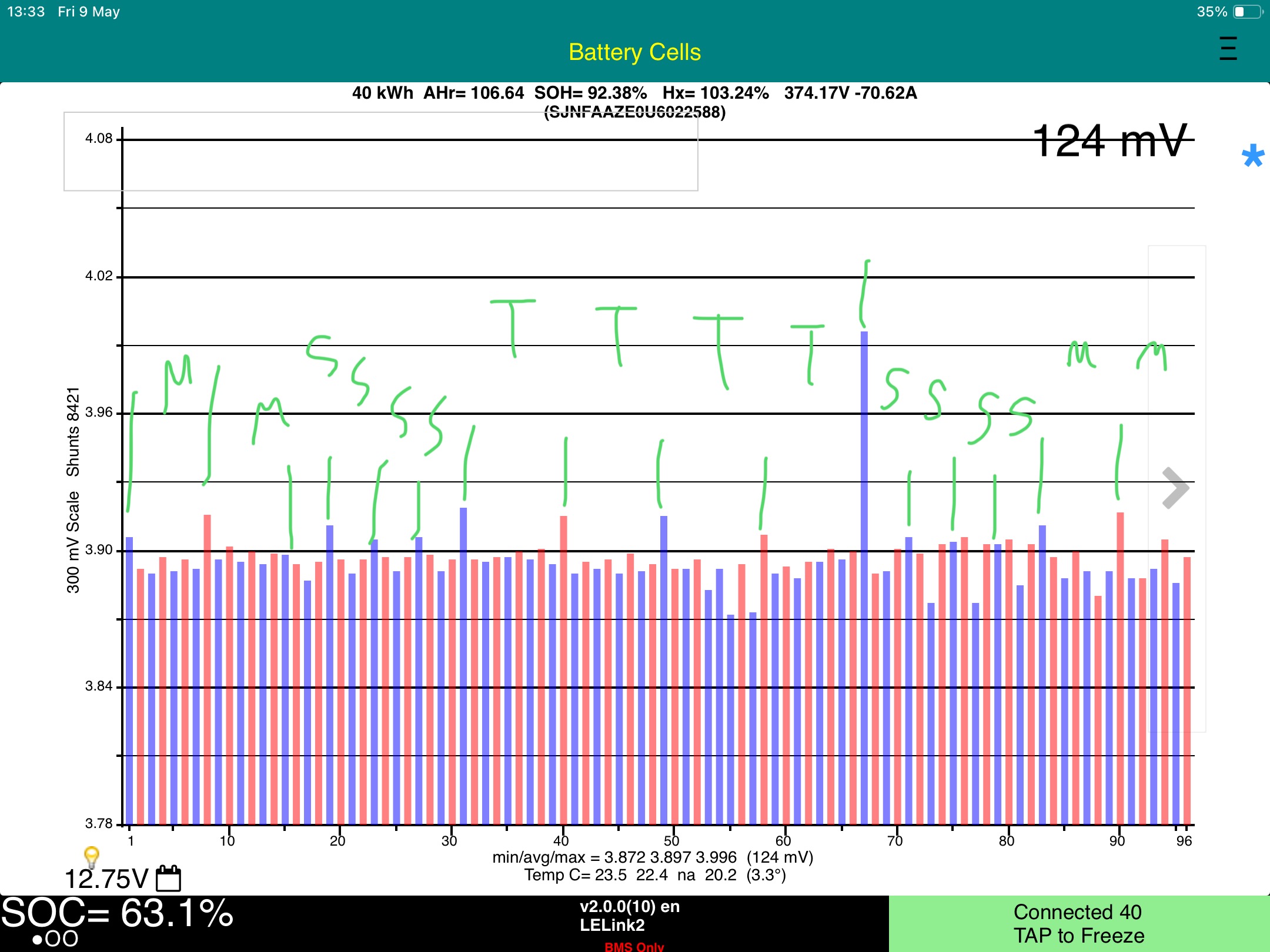

Manually charging / balancing.
Went ahead and bought a small battery charger / balancer for £30 - the ‘imax B6’. Only wanted to charge up the single weak cell, but thought maybe it’s other balancing features might be useful in the future.
So veeery slowly brought it up to match the rest over a few hours. Actually did it in 2 goes on 2 separate days as I didn’t want to leave it unattended.
Once it was matched, put things back together again and did a few goes around the block. That means 20 - 30mph, just to check everything still worked.
I could see the suspect cell was starting to drop a little compared to the others on Leaf Spy (range shown as 36mV) Nothing dramatic, but noticeable. So assumed this was an indication that the balancing was not going to work long term, which was kind of what I was expecting anyway.
But I’ve actually been pleasantly surprised since then. After some wiring tidying to get the 12V lights etc working with the VCU instead of the OEM mechanicals, went for a faster drive on a nearby main road. Variance dropped to 26mV…
Best I’ve seen it is 20mV, which is pretty amazing.
Following that, doing a slow AC charge, the spread has extended to 38mV, with the weak one lagging behind the others. But once driving, they equalise as the capacity is reduced.
I’ve just done a 30mile round trip, and this is how the battery is looking, according to Leaf Spy now…
And battery temp while I’m at it…
What does it mean long term? Who knows! I don’t intend to be delving into the battery to manually charge up every few weeks, so will have to see if the BMS can stay on top of this for me, but looks kind of promising so far.

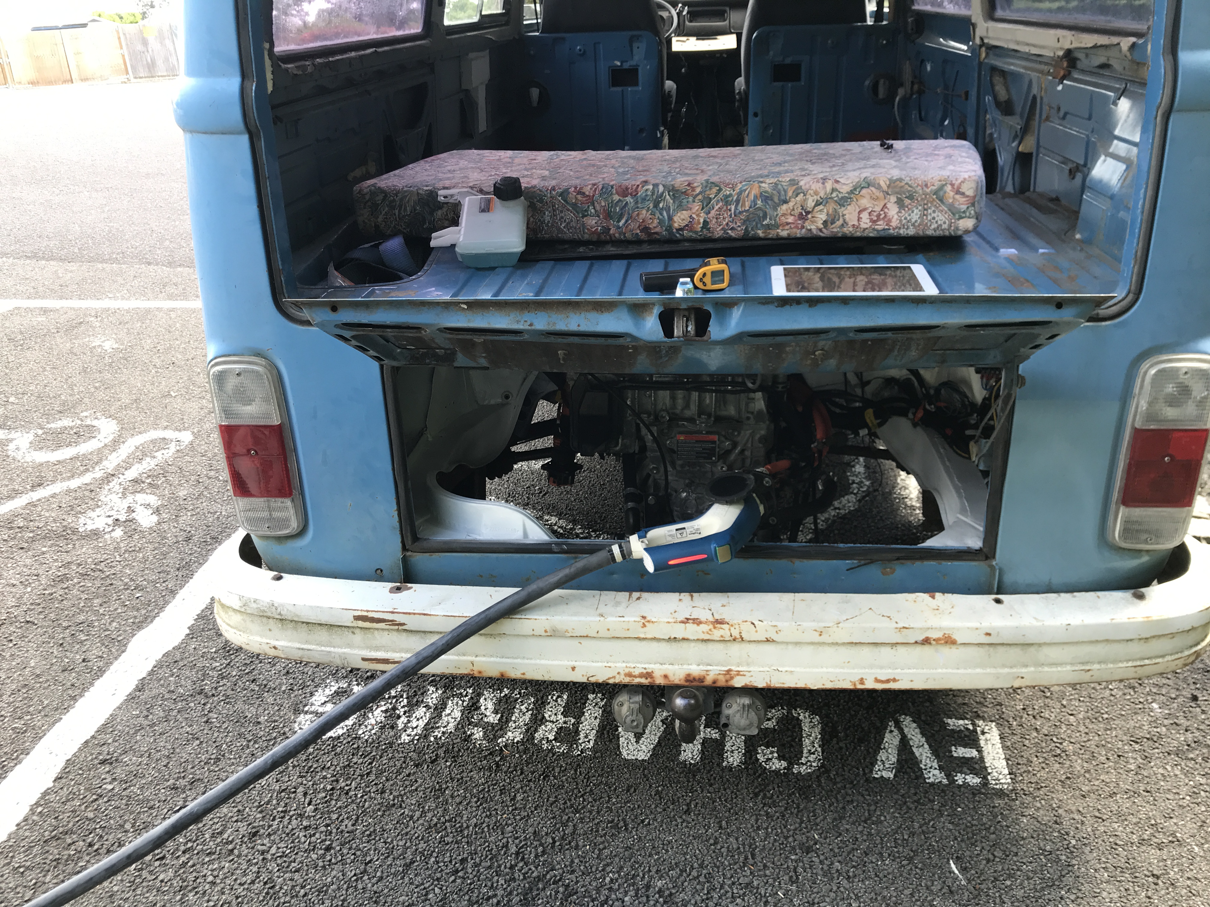

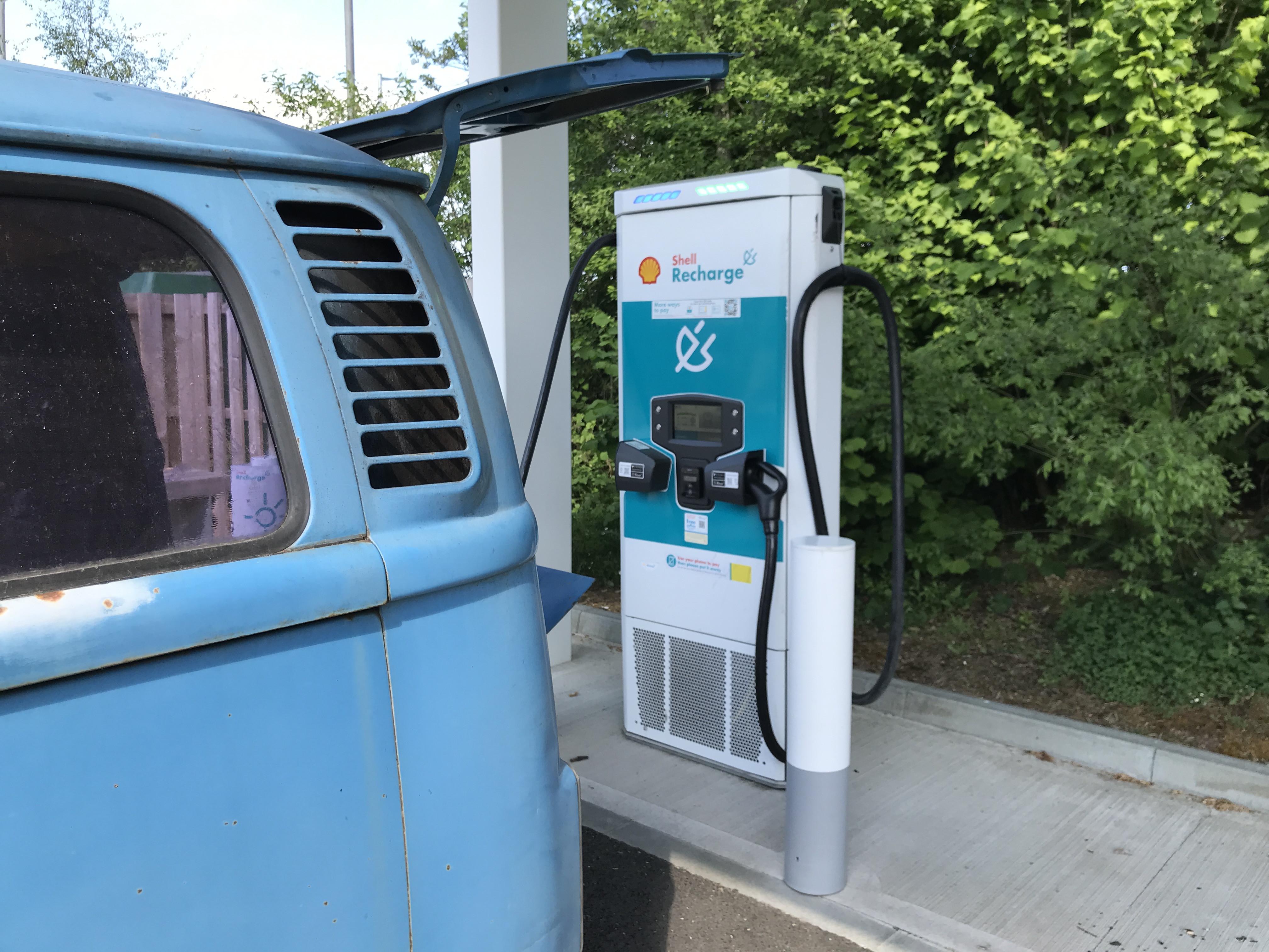

Next step
Only been playing with home AC charging so far, but soon will need to venture forth to find a chademo charger in the wild to see how that goes. Our local BP has one, but it’s also often the place where the local police get their snacks and I don’t want to invite attention just yet! The engine bay wiring isn’t bad now, but the cabin is a bit tangly.

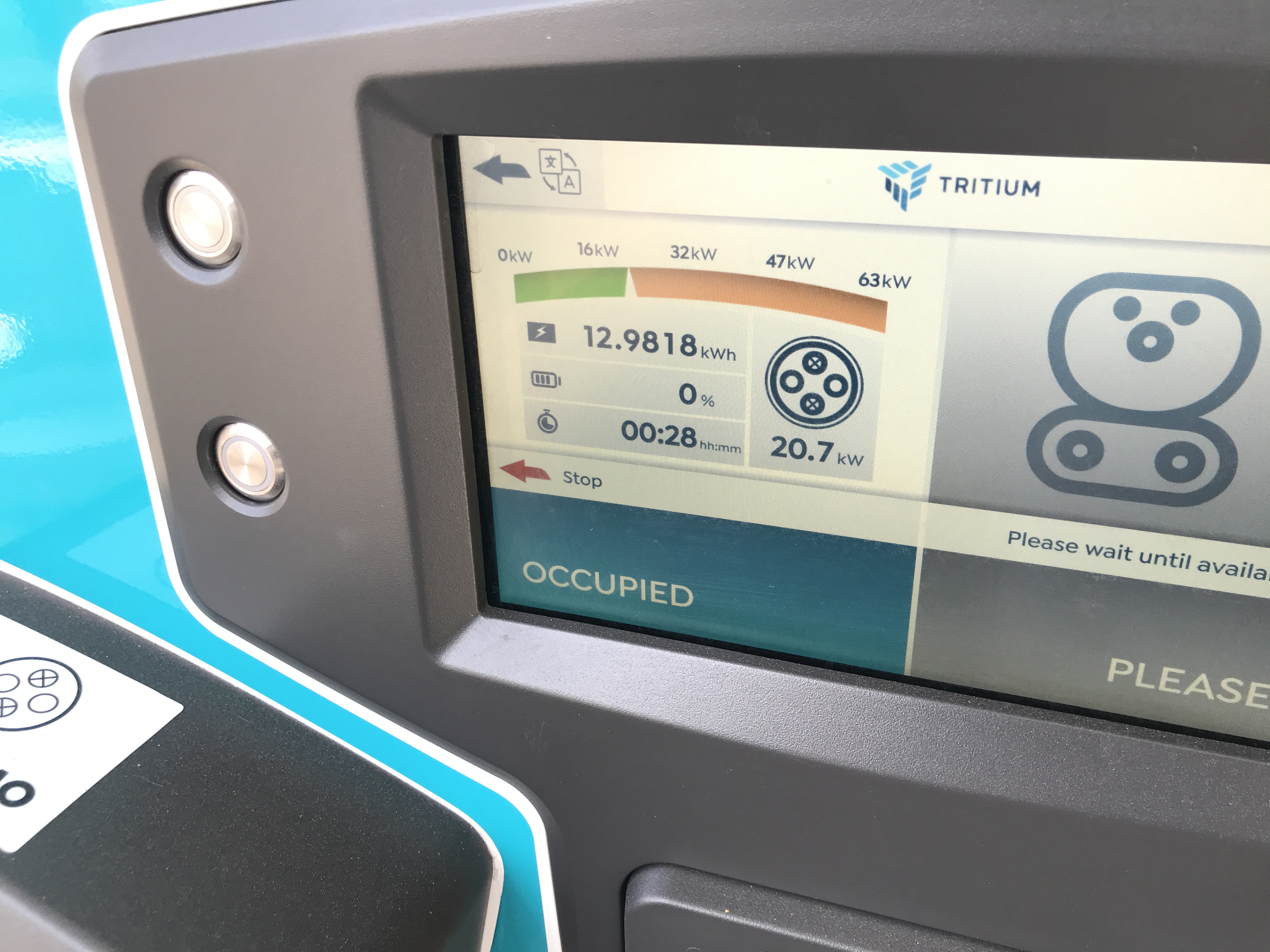

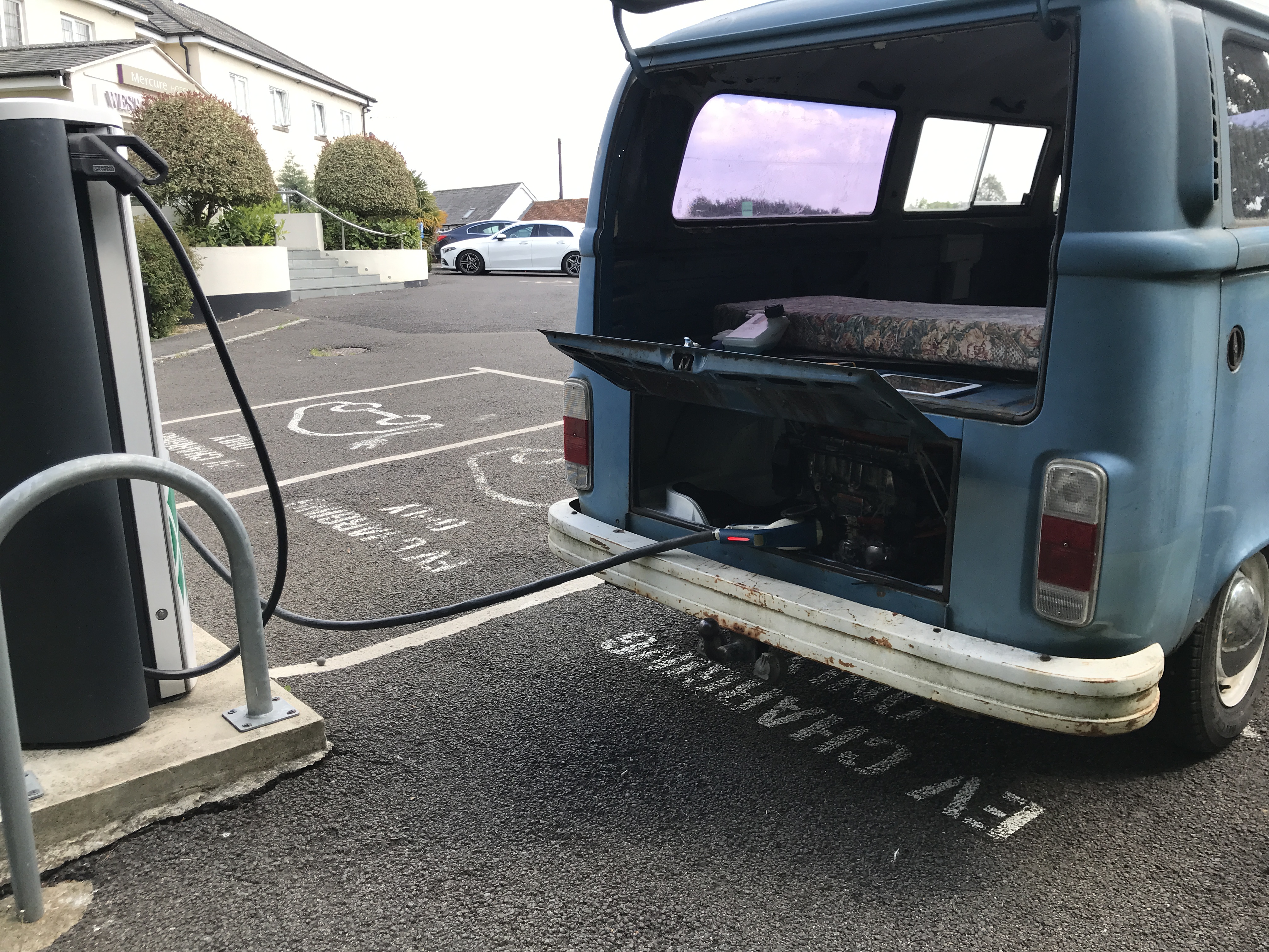

…so then I couldn’t resist when I realised a quiet local hotel had a Chademo, had to try it!
First attempt failed. Think it was because I plugged in with the car ignition off. At home with AC charging this works. It wakes the car up and charging commences. But with public Chademo, at least in this case, whatever handshaking goes on required the car to be ‘on’.
I managed to make the screen go to a black screen of death with a big Red Cross, with some message about voltage too low. It then went through a 5 minute reboot cycle, before letting me try again, which then worked.
You have to wonder if there can’t be a more elegant failure mode that doesn’t require a reboot of the charger. But then I’m not the software engineer.
I had my perverse fun of spending a few £££ for something I can get for free at home with sun and solar PV, and then drove home to use up some of what I’d just purchased.
In terms of Leaf Spy, mid charge, there’s 1 cell (67) that seems eager to charge up more quickly than the others. This peak disappears after the charge ends…
Warmest battery temperature was 23.5deg.
It was a pretty short charge, only 10 mins. But another useful step.
Once back home, things looked how I expected

…reverting back to my Leaf Spy image of in-progress Chademo charging yesterday, I’ve realised there’s a pattern in the peaks and troughs.
More or less all the taller peaks are from the first cell in a module. Here it is with green lines tagged to the start of each module. Also M(edium), S(hort, T(all) added to identify the different types of Leaf module.
So the extra long spike is module 11. This is the first module on extended cell tap wires and extended HV cable. All the modules to the right of that point also have similar length extended cell taps, but they don’t spike in the same way. All the HV from this point are short cable or original Leaf busbars.
I’m sure that’s not coincidence, just not sure what, if anything I should do with this revelation now I’ve seen it. I guess I’ll dive back into the battery box and double check the cell tap connections are good, at least on module 11.

Decided for my next test that if I was going to burn somewhere down with a battery fire I’d rather do the Shell garage than the local hotel (dear lawyers, this is just a poor taste joke and not a statement of intent).
All went ok.
I’ve moved on from focussing on my weak cell 55 as he doesn’t seem to be much of a problem. Still a slacker, but nothing serious.
All the attention now is cell 67. As mentioned this is the first cell of module 11 on a 2meter HV extension and the first of 30 cell tap extensions.
Just to be sure, Ive remade the BMS connections to all the cells in module 11. Rechecked the HV for a tight connection and retested around the block and then on to the Shell.
So this is what I get to watch when Chademo charging. Playing chicken with battery cell! That 99mV can bounce around of course, think up to 150 at one point.
I called it quits at 85% SOC and with cell 67 reaching about 4.08. That’s an upper limit I’m happy with. I’d prefer not to experiment with that cell hitting 4.10 and higher, although happy to hear anyone’s thoughts on safe voltages for a leaf 60kWh battery cell.
Edit - this is only a rapid charging problem as far as I know so far. Should I have the need, I ought to be able to go higher on my home 2kW charging.
Battery temp got up to 26.5deg
Chademo charging started at 30-something kW, but then was down in the 20s. Did about 30minutes.
Once I was done charging cell 67 rejoins the rest of the pack. Then 15 min drive home and final LeafSpy when at rest.
