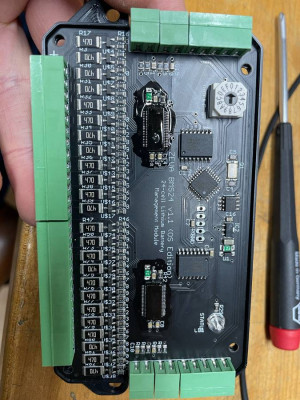

I got several 24S ZEVA BMS modules here and i decided to make modular battery 96S out of 4x 24S boxes. This ZEVA BMS will lend itself nicely to such use. https://www.zeva.com.au/index.php?product=143
I will document assembly and integration in this thread. Not to be confused those modules are primarily used for data gathering. Their mode of operation is for master VCU to send data request on the line and each module would respond with several packets where cell data will be stored. Temperature as well...
Balancing mode and cell level is commanded by master request in 2 byte telegram.
CAN bus instructions are in this manual which is made for 12S version BMS

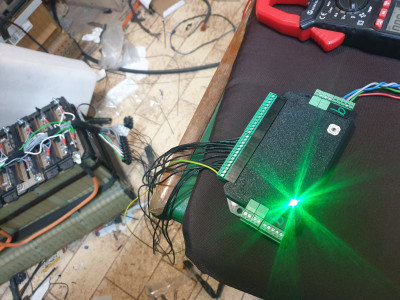

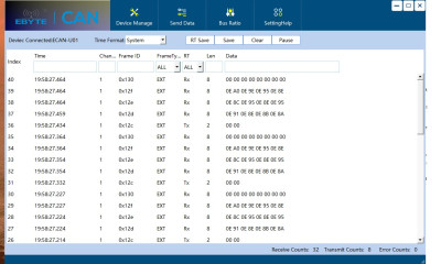

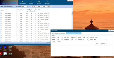

Re: ZEVA 24S BMS application

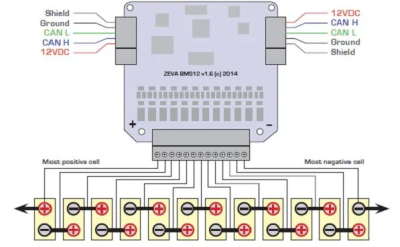

First i connected the cell connector for 12S, that is 13 positiuons to the battery... This battery was assembeled from 2x section of 12S Volt gen1 cells connected in parallel. I even connected each cell in parallel using 0.75mm2 cables. I will have to separate those paralleled cells.
Later on this will let me test full 24S BMS capability later. I then connected the 13s connector to my ZEVA BMS Check this manual before connecting... When i also connected the CAN and 12V power supply connector from the left side as on the upper photo system would not respond to IDx300 which it needs to get response from BMS modules. The error was two part.
First of course i needed to change the CAN input connector from master side to the right side Secondly IDx300 is not valid command. At least not in hex. 300 is the sum of ID number in hex, so IDx12C then...
I send IDx12C "extended" address with data in 2 bytes which should mean command for cell balancing value. For now i only send 00 00.
And CAN bus came to life! I used 250kbps signal with "extended" ID repeating at 100ms interval. Later on i tested the CAN lines from left to right connection to my CAN reader from CH1 and CH2.

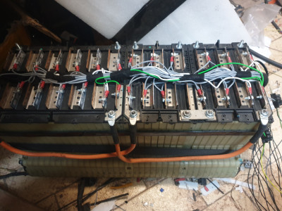

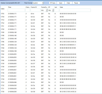

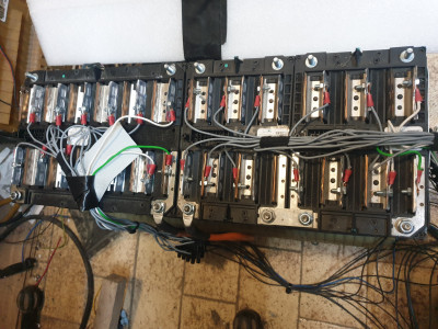

I have now separated two 12S cell packs and made 24S connections for BMS.
I connected them in series for 24S. BMS connected for 24S cells. Communicating with CAN bus. Each halfh of 12S of BMS module has a different address that is set by the selector on the top left on the module.
For position 0 the both adresses are 0x12c for the first 12S (rightmost) and 0x136 for the second 12S (leftmost).
When requesting cell report the 2byte content of the telegram refers to module balancing threshold in mV.
Commands to extract report from 24S module and impose 4.10V threshold for balancing are therefore:

telegrams 0x130 and 0x13a contain thermistor values for each side of the module. If connected to 100K NTC they give cell temperature, see example at 0x130 byte0 value is 39. That is 39hex = 57dec and according to design temp info is xx - 40 = 17deg C.

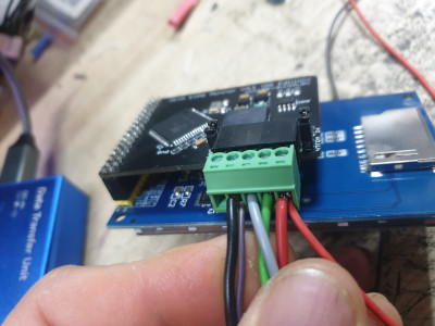

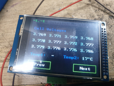

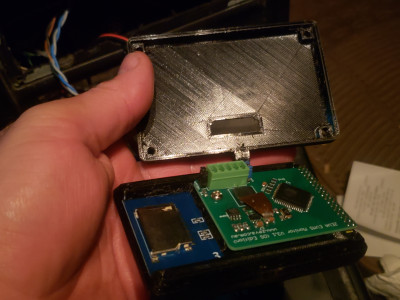

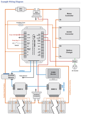

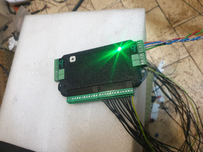

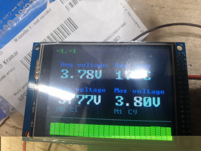

Next i connected the control board which is called EVMS V3.1
This controler is innitiating CAN transmission and provides 12V power for BMS 24S modules.
Later on when i will wire this EVMS into the car i will try to make more detailed post Next was the LCD. This LCD is touchscreen that can be obtained on Aliexpress
https://www.aliexpress.com/item/3288298 ... 1802JTpgQ3

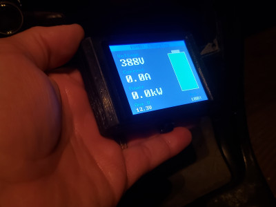

Surprisingly when i connected CAN bus and power to LCD it immediately started and got the first module cells. Since 24S module is made from two 12S parts i needed to enable number of modules and cells inside LCD. When i corrected settings i got good account of all cells. EDIT: I am really surprised how easy it was to connect everything together on CAN bus and LCD and it worked the first time!
I have to hand it to Ian he really made a good system. Next i will try to connect sevaral 24S modules together.

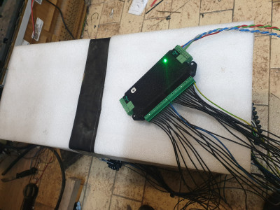

I bought some of them already built and flashed for 250kbps. Those i tested here.
I am now working on building one more 24S BMS with one EVMS control board and at least one current sensor board. All of them have chips i will need to flash.
I expect next post to be instruction on how to flash hex firmware or reflash complete system with different kbps.

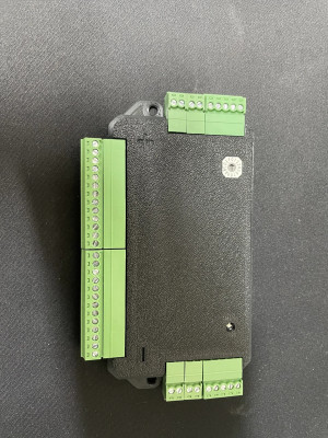

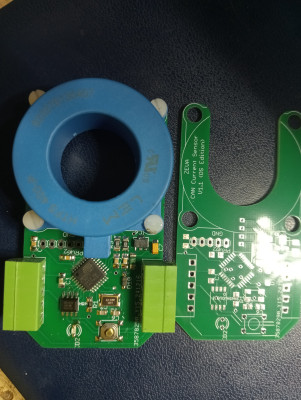

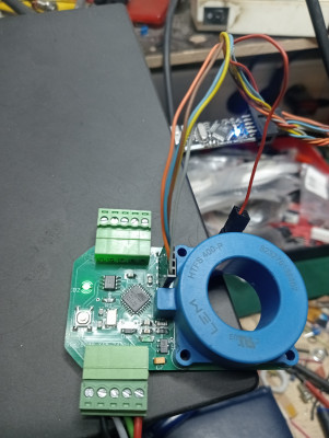

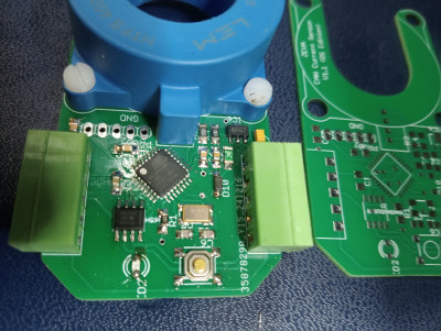

From JLPCB i got ZEVA Current sensor boards I ordered.
I soldered main chip ATMega16M and support components. For sensor i used LEM HTFS400 sensor.

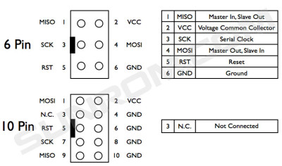

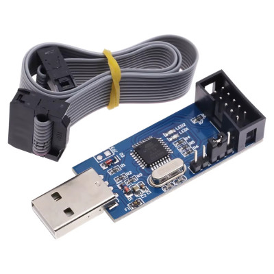

When i got it together i used my AT programmer.
For this i use just a simple AVR USBasp programmer with custom built cable.
https://hobbycomponents.com/usb-interfa ... er-adaptor
Program of choice is avrdude
https://github.com/mariusgreuel/avrdude ... me-ov-file
Because i struggle with using command line i found this GUI interface AVRdudess, it makes my life so much easier
https://blog.zakkemble.net/avrdudess-a-gui-for-avrdude/
Boards must be connected to 12V supply, just because wiring is done that way. If not programmer will not detect the chip.
I connected the board by hand and kept pins pressed together. Then i set the speed of communication to 8bit and tried to autodetect the chip.
I selected my hex file and set the fuses for programming. When i finished the LED lit up!
As hall sensor has trouble with centering i pressed the button and when LED stopped blinking sensor is centered.
I made 3d printed casing for this sensor so circuit is protected. Stil have to connect this sensor to CAN lines, but i think it will not be a problem as it is a through connector.
Will report back with some photos...

Ya...
I connected current sensor module and put one side of the DC rail through it to sense current.
Idea is to put sensor on the line between BMS modules and keep communication in one line. I used LCD to enter setup and prepared some parameters like max current and cell levels.
It seems i programmed that chip with 300A parameters code! That is starting sensor value.
My sensor is actually 400A. There is a multiplier parameter which takes care of larger sensors for the same code.
When i first connected current sensor LCD changed first page to show SOC%.
The reading error is shown in sensor reporting less current. You can see the difference in sensor from my EVdisplay. It seems sensor reads like 1/2 times so i think i will need to use multiplier 2L....
Also voltage reading is confused. While it reads battery values and makes the addition it also requires direct HV connection to main board. Later on i will make a secure fused connection for HV sensing.

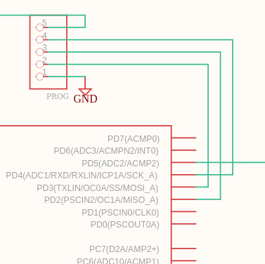

if you dont want to modify firmware or do a new compile You can modify hardware. See the lines 32 and 224 in the code:
#define SELECTOR1 (!(PIND & (1<<PD3)))
#define SELECTOR2 (!(PIND & (1<<PD2)))
#define SELECTOR3 (!(PIND & (1<<PD4)))
// Selector 2 and 1 used for current size.. 00 means 100A, 01 means 200A, 10 means 500A ? 11 means 50A?
if (!SELECTOR1 && !SELECTOR2) // 100A shunt
result *= 2L;
else if (SELECTOR1 && !SELECTOR2) // 200A shunt
result *= 4L;
else if (!SELECTOR1 && SELECTOR2) // 500A shunt
result *= 10L;
if (SELECTOR3) // 50mV shunt instead of 75mV, current will be 1.5x higher
result = result*3L/2L;
return result*102L/190L; // was result*10L/19L but needed to be 2% higher
______________
so to get 2L , you need apply SELECTOR1 and SELECTOR2 , so put PD3 and PD2 to earth in hardware ---> go to the scheme and see that PD3 and PD2 are pin2 and 3 of PROG block of 5 pins
result *= 2L;
result *= 4L;
result *= 10L;
______________
Hm... I Will go over my schematic but i use Hall sensor and it seems it doesnt have as much hardware odds and ends as shunt version. Will report back...
EDIT: Ian posted .hex file on AEVA Forum! I simply repost it for others. I will get to explaining programming later on when i resolve my issues.
EDIT2: Shoot! Didnt work! When i try to upload your 600A code process is completed but in the end i dont get LED lit. Chip just sits there and gives no CAN traffic either.... I use fuses FF DF and FA.
Also I managed to compile code and i setup for hall sensor
But there is no change when i finish programming... Its like the original code stays in... what did i do wrong?
EDIT3: Ian compiled the 600A code for ATmega64 chips thats why it wouldnt work on my ATmega16M1. Now he changed to ATMega16M1, Success!
#define SHUNT_VERSION 0 // 1 or 0, same code works for hall sensor or shunt interface types
#define HALL_MULTIPLIER 2L // Compared with 300A sensor, so 600A is 2, 1200A is 4
#define DEADBAND 80L // Tolerance for noise/offset around zero, 80L equates to about +/-0.2A with 300a sensor
#define CAN_BAUD_RATE 250 // Code knows how to do 125, 250, 500, 1000kbps
#define USE_29BIT_IDS 1
- EVMS3_Current_Sensor_600A.hex
- (6.11 KiB) Downloaded 837 times

@chentron.... I see another problem....
My 8x 12S modules are communicating and 384V voltage is correctly displayed.
BUT there is an intermadiate voltage of 123V being displayed at about 1s interval. Display alternates between "running" and "idle" state with "idle" being the state when 123V is displayed. How can i make this go away?
I tried to connect HV on the EVMS3 pins and that didnt change anything. I do have only opto circuit connected. Nothing of the 4W resistors or precharge command. I use my own precharge circuit with drive VCU.
This is the vide of me starting the car which provides 12V signal to RUN state.
My battery is 384Vdc 96S
BMS EVMS3 alternates between 123V and 384V and RUN and IDLE state!

How do you make your cables?chentron wrote: ↑Fri Apr 18, 2025 10:26 pm I am just follow the logic.
As you say if that happen in your bench with only one BMS12 , but also with other different BMS12 alone, look that the problem can be with the EVMS brain or the display.
I dont think software is the cause, because i have the same software working correctly.
I make a pair of twisted cables out of two 0,5mm2 blue and white ordinary soft wires twisted in a right hand way using my battery drill.
Then i make 12v power supply pair out of red and black 0.5mm2 and twist them in the same way (to help with any EMI). I dont use any shield wire.
Do you use shield wire? If so, how do you implement this? I mean do you just use one wire along with the rest or do you use anything special?
- Posts: 117
- Joined: Mon Feb 22, 2021 3:25 pm
- Location: Spain
- Has thanked: 42 times
- Been thanked: 10 times
in the stationary battery i am using cabling recycled from ethernet cable unshielded. my battery is about 342v (85s actually) , maximum of 15A but normally with very low amps so no problem with EMI.
in the car, still in construction and never run more than 200m around my home, have shielded ethernet cable comunicating the battery boxes(one pair for data other pair for 12v), but inside the batteries unshield ethernet cable for the cells. the slave BMS24 are inside the battery boxes
ZEVA BMS programming
https://hobbycomponents.com/usb-interfa ... er-adaptor LC-01 USBASP AVR download cable / AVR programmer / 51 ISP the downline lines programming /AVR ISP / / USB ISP - AliExpress 502
AVR ISP 10 pin for programming : Sunrom Electronics Program of choice is avrdude
https://github.com/mariusgreuel/avrdude … me-ov-file Because i struggle with using command line i found this GUI interface AVRdudess, it makes my life so much easier
https://blog.zakkemble.net/avrdudess-a-gui-for-avrdude/ Boards must be connected to 12V supply, just because wiring is done that way. If not programmer will not detect the chip. I connected the board by hand and kept pins pressed together. Then i set the speed of communication to 8bit and tried to autodetect the chip. It seems like some chips cant talk really fast, but some can...
I just got the other LCD monitor circuit from Chentron and i tested it it worked perfectly the first time. I found out my firmware obviously didnt have the correct switches set. I corrected that and voila! It works now seamlesly. Fuses that need to be selected…
LOW HIGH EXTENDED FUSES:
BMS24 ff df fa ff
CAN Shunt Interface ff df fa ff
EVMS monitor: ce d9 ff ff
EVMS3: df df fa ff
