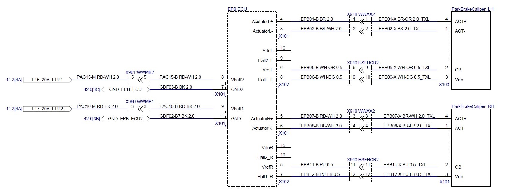

Looks like you installed a model s clip, the parking brake which has 4 connections opposed to the model 3 which just has 2.
There is a epb controller available https://pantera-electronics.com/epbcontroller.htm
Zombieverter won’t be able to do it as it dose not have a high current output drivers capable of powerkng the motor

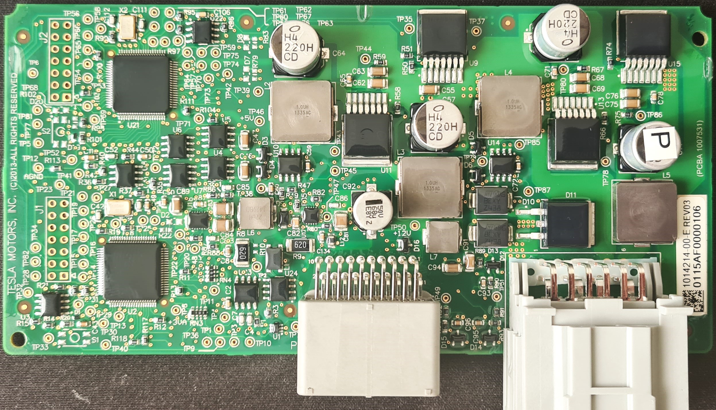

Unfortunately, I don't know how the Tesla EPB controller receives its signals to potentially integrate it. Arduino is too insecure and prone to failure for me.

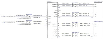

According to the schematic above the four wires contain two for a DC motor and two for a hall sensor.

uhi22 wrote: Sat Mar 22, 2025 6:37 am According to the schematic above the four wires contain two for a DC motor and two for a hall sensor.
I completely missed that schematic..
