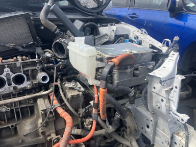

PICK-n-PULL
here's how they look in the wild

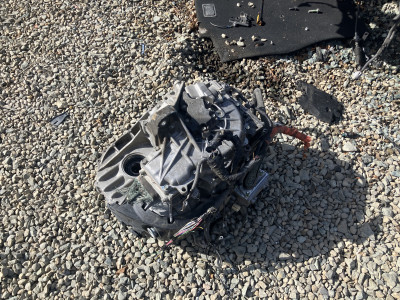

How I pulled a full length 6th Generation (2007-11) Toyota Camry inverter plug and synchronous cables wire harness (full home run from inverter to the Hybrid Vehicle ECU)
TOOLS
  • a pair of very sharp dykes aka wire snips
  • a very sharp box cutter (to cut electrical tape length wise with the wire harness grain)
  • 10mm deep socket (to remove fuse block from inner fender)
  • 100mm open end wrench (to remove brake line fittings to free up wire harness)
  • a flat screw driver
  • another pair of very sharp dykes aka wire snips, lol

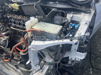

Top Tip: find a vehicle at the junkyard with it's engine and transaxle already removed (hopefully with a grenade like so)
When standing facing the vehicle the inverter lives in the South East quadrant of the engine compartment aka the front corner just behind the headlight on the US driver side.
It is wise to first check if the inverter plug is:
  • Present
  • Uncut
the inverter plug harness traverses behind the bulky black plastic fuse box housing (held to the driver side inner fender with 3 bolts) before re emerging in the corner below the Medusa like master brake cylinder
it then makes it's way all the way across the firewall from the US driver side to the furthest North West corner of the firewall
where it plugs in to the Hybrid Vehicle ECU)
There is no need to keep this large black rectangular plug with that gray lift handle that goes into this Hybrid Vehicle ECU, what you are really after is the four black synchronous cables, comprised of two wires each, a thin black wire and and a thin white wire, so just snip them here, they will later plug right in to the ZombieVerter VCU
