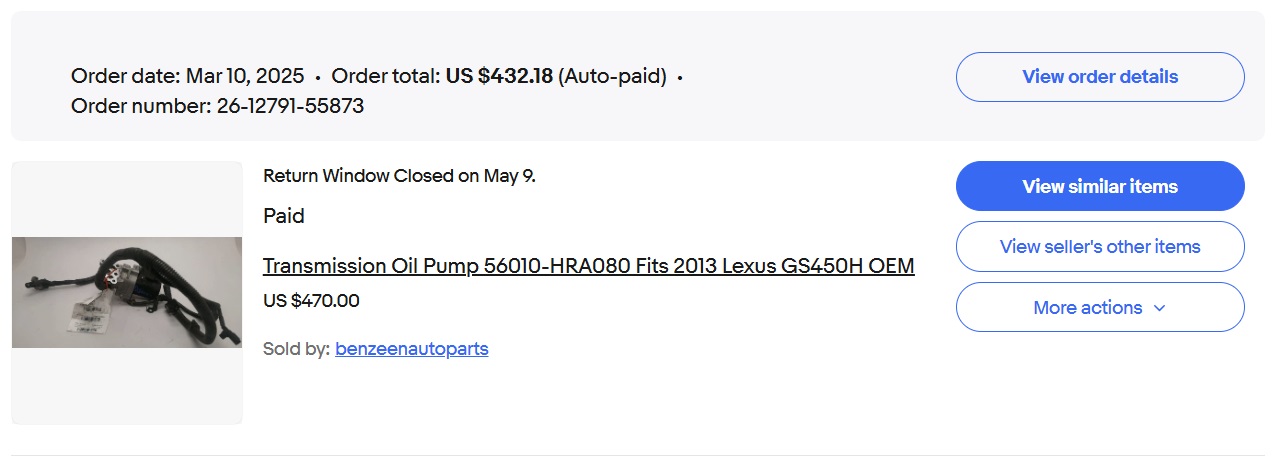

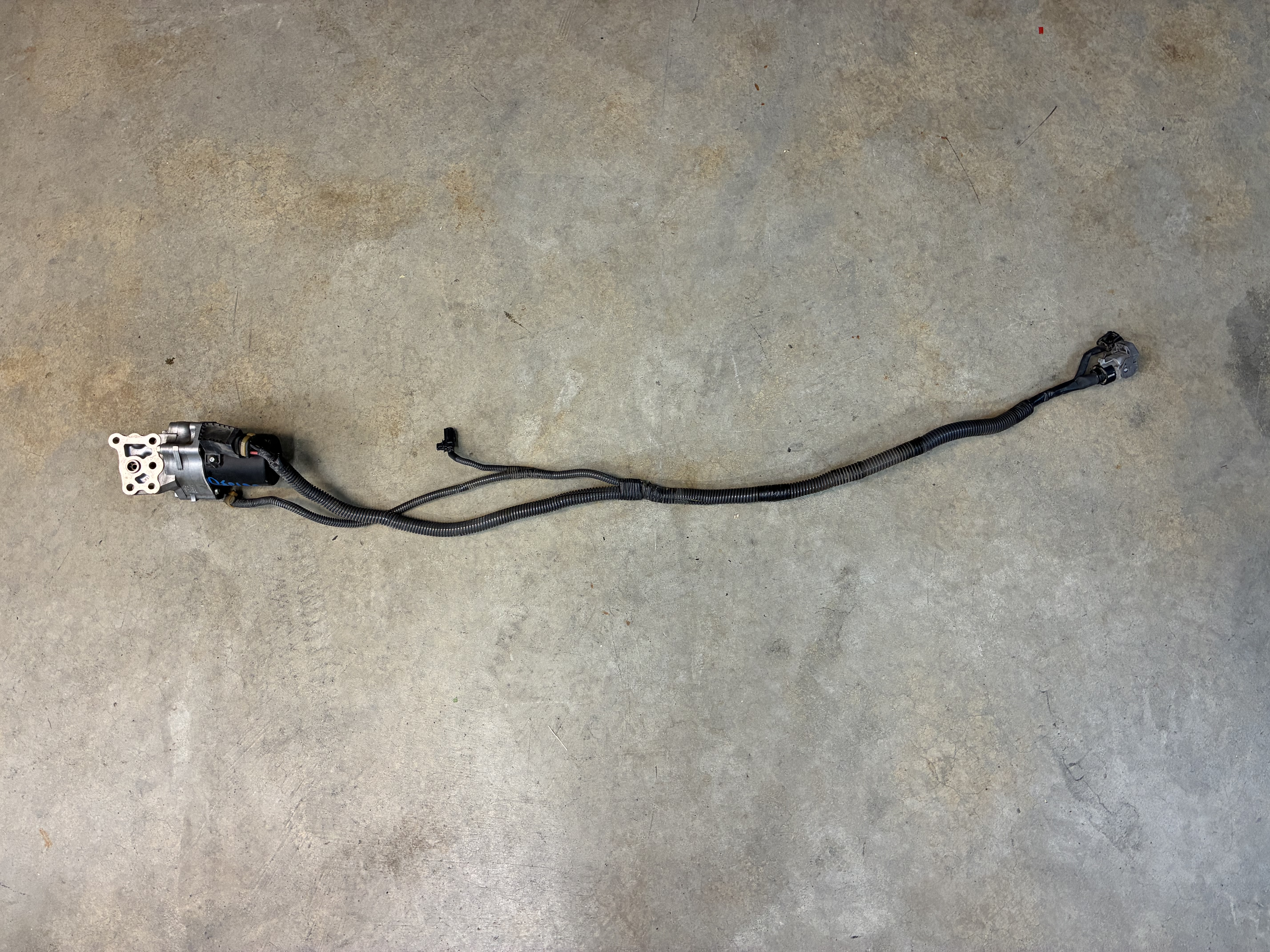

Re: I just bought a 4th Gen Lexus GS450h Powertrain. - Now What?
TABLE OF PRICES
* prices includes taxes and shipping where applicable
| PART | PRICE | PART # | SOURCE | SELLER | COMMENT |
| transmission/oil pump/HV cables | $435 | 30910-30110 | eBay | benzeenautoparts | local pickup |
| inverter | $131 | eBay | benzeenautoparts | local pickup | |
| oil pump controller | $98 | eBay | jettasworld | free shipping | |
| transmission wire harness | $136 | eBay | benzeenautoparts | local pickup | |
| inverter wire harness | still needed | ||||
| drive shaft | still needed | ||||
| clutch plate | still needed | ||||
| TOTAL | $800 |

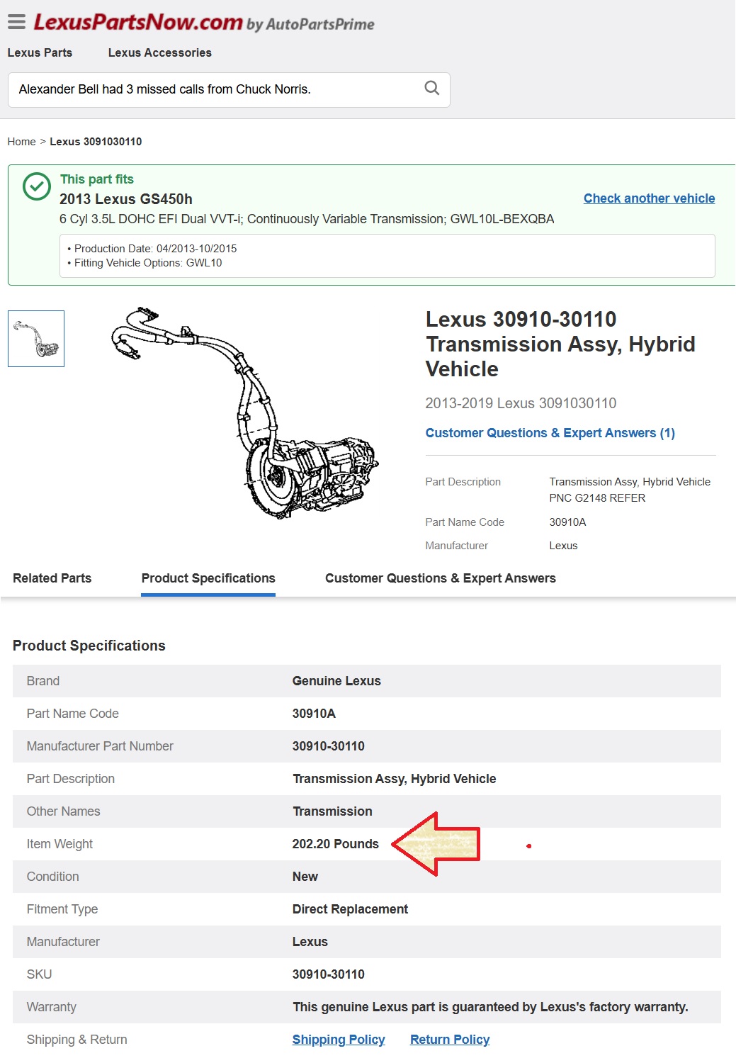

- How much does this Lexus GS450h transmission weigh?

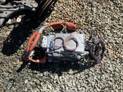

when you buy the transmission make sure it has the two fat orange HV cables attached to it and they are not cut off on one end, they can cost a $100 bucks a piece by themselves
when buying the inverter look for and be willing to spend a bit more money on one that comes with the black low voltage plug/connector and a bit of a pig tail, that inverter plug is part of the biggest harness in the vehicle and runs through the firewall and is a bear to remove from the car and can cost upwards of $500 duckets itself

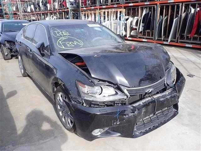

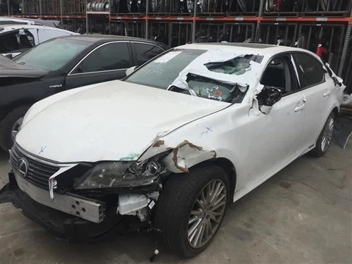

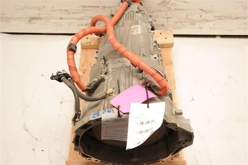

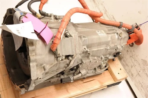

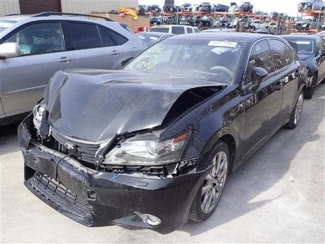

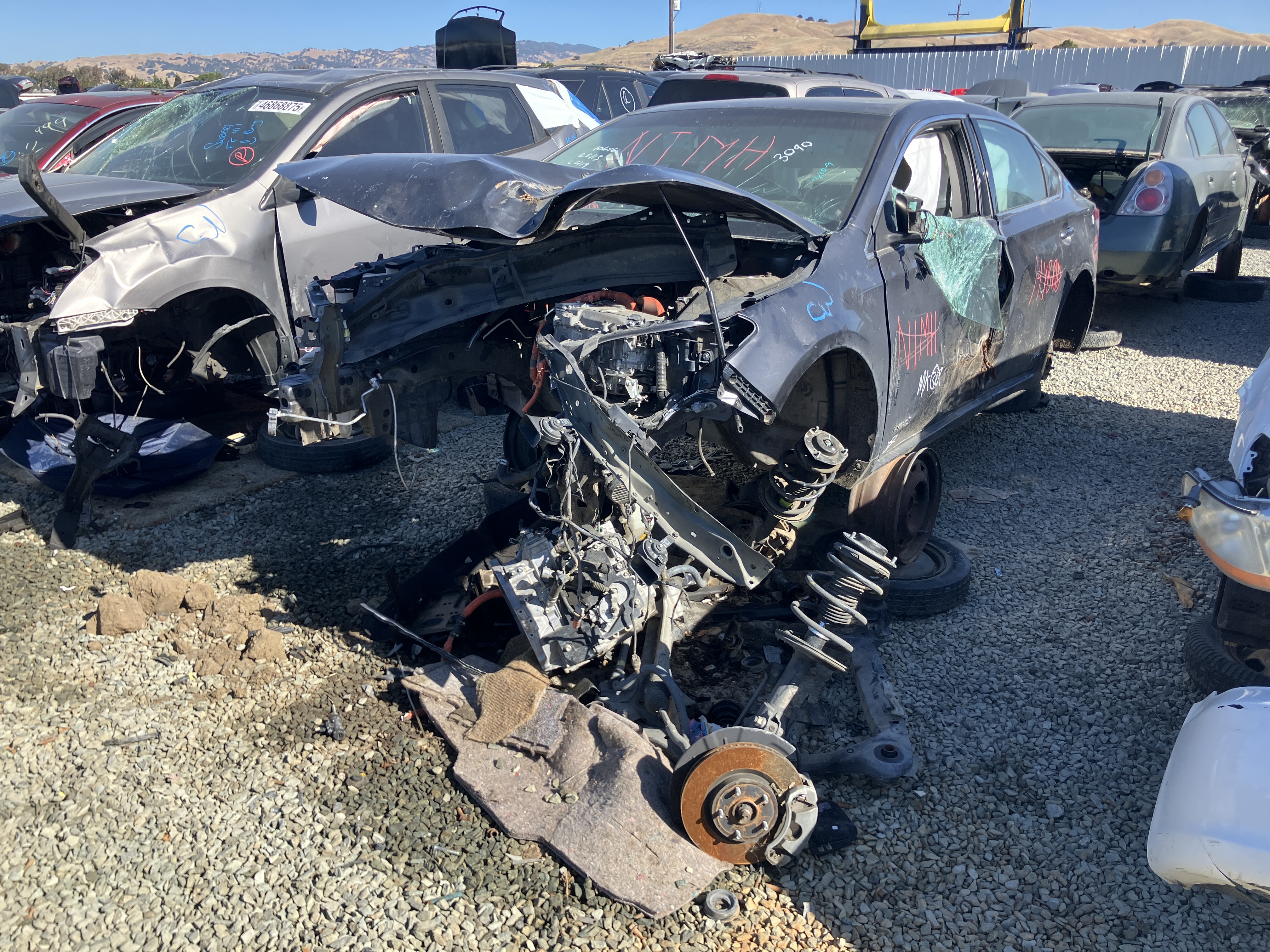

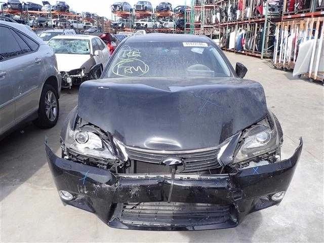

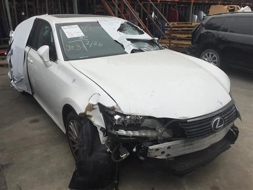

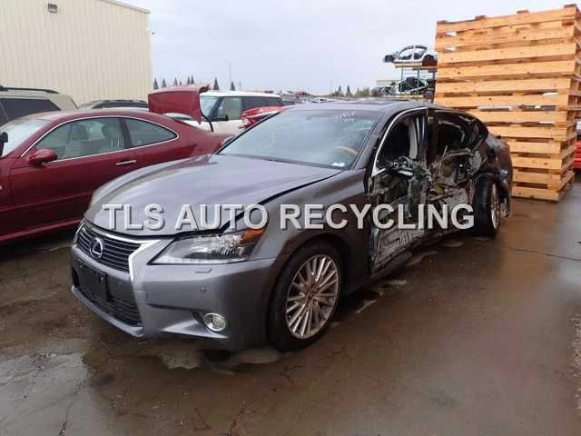

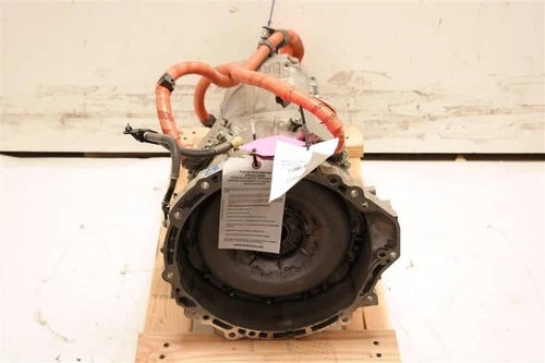

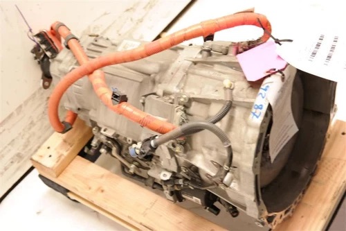

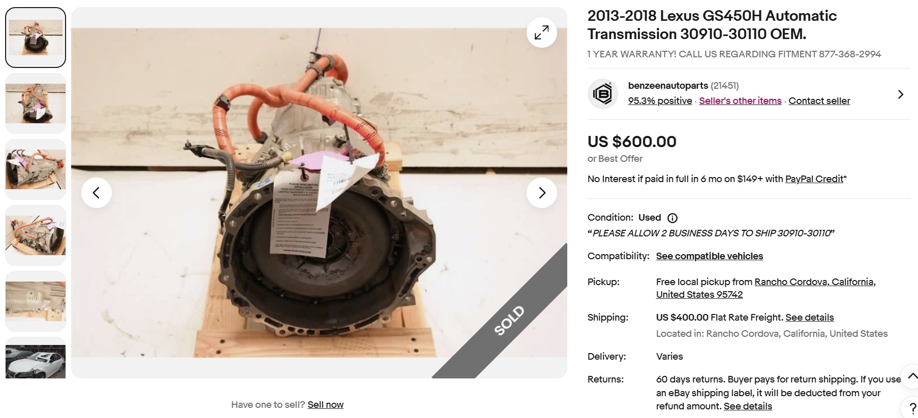

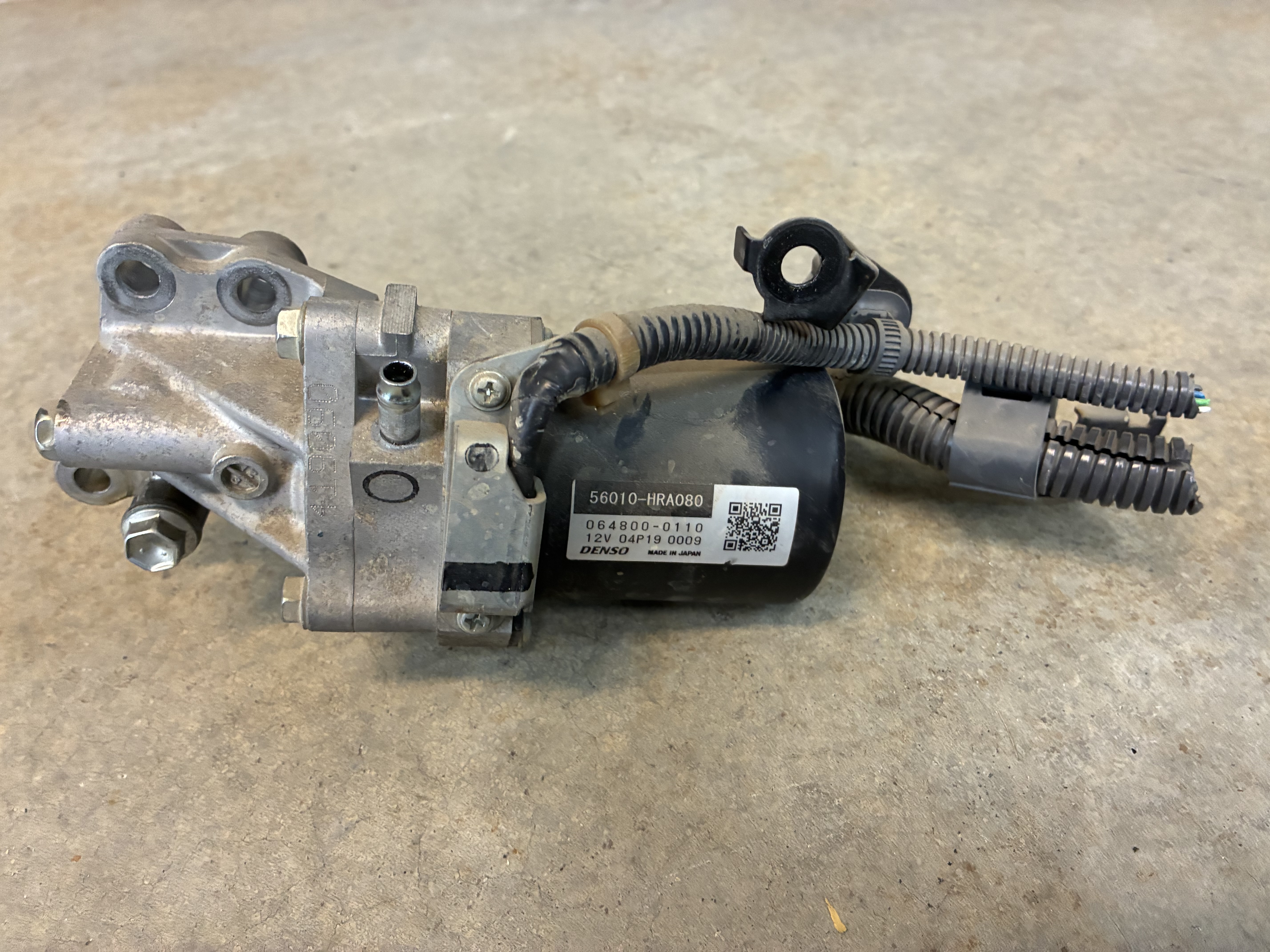

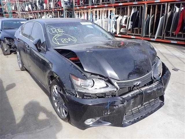

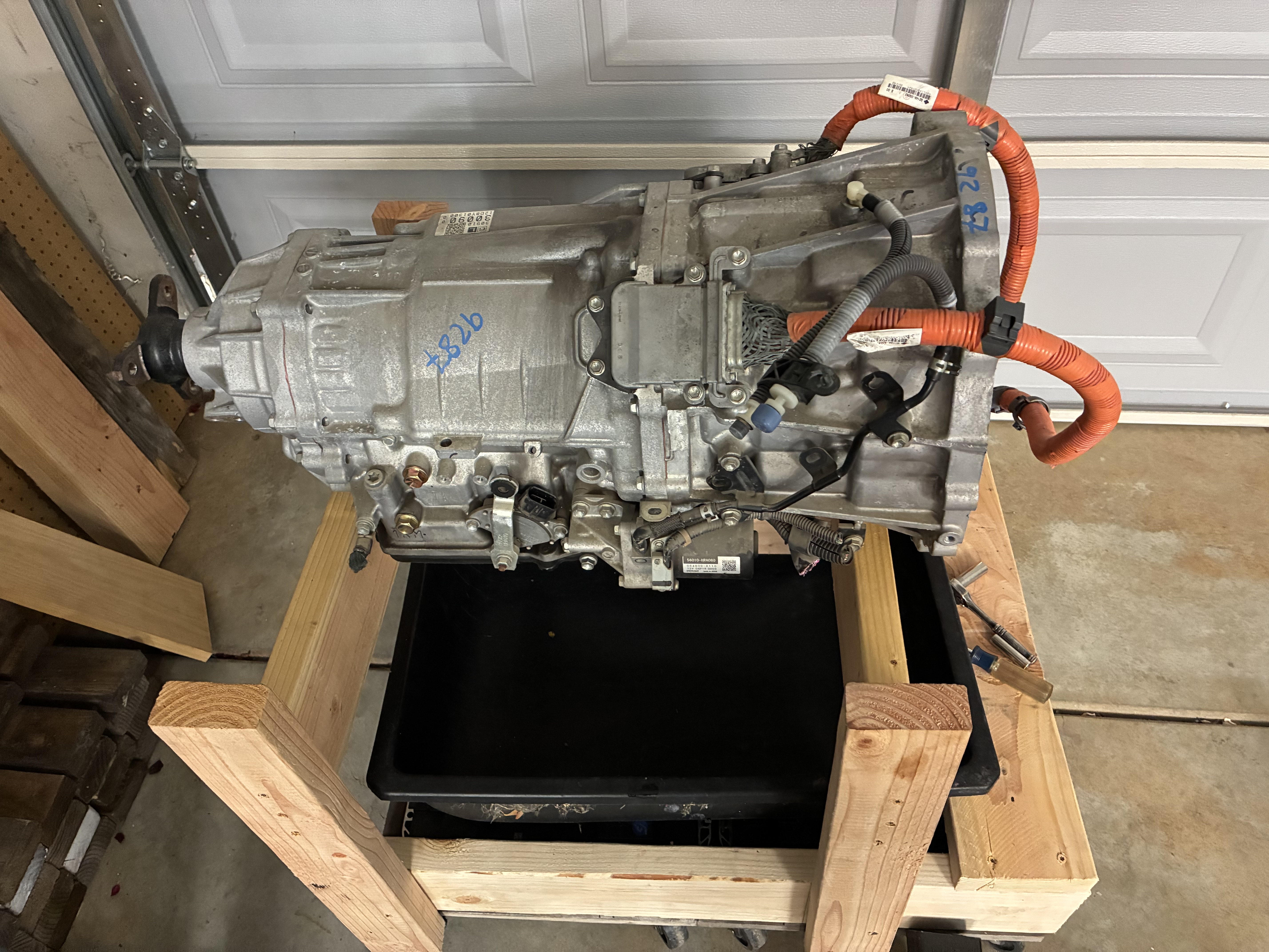

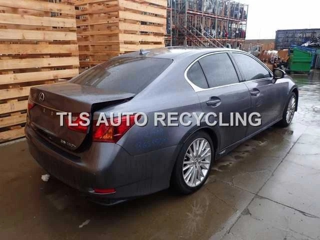

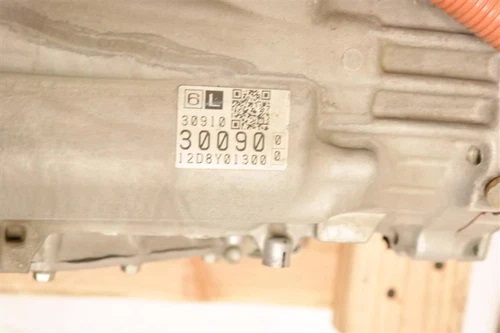

transmission listing as seen on eBay
Orange Cables - ✔
Electric Oil Pump - ✔

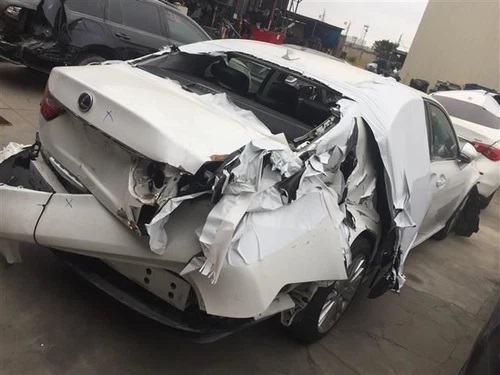

It's always nice to see the vehicle it came out of, and seeing it being immobilized because it was wrecked, otherwise it may have mechanical issues
Orange Cables - ✔

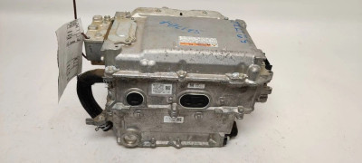

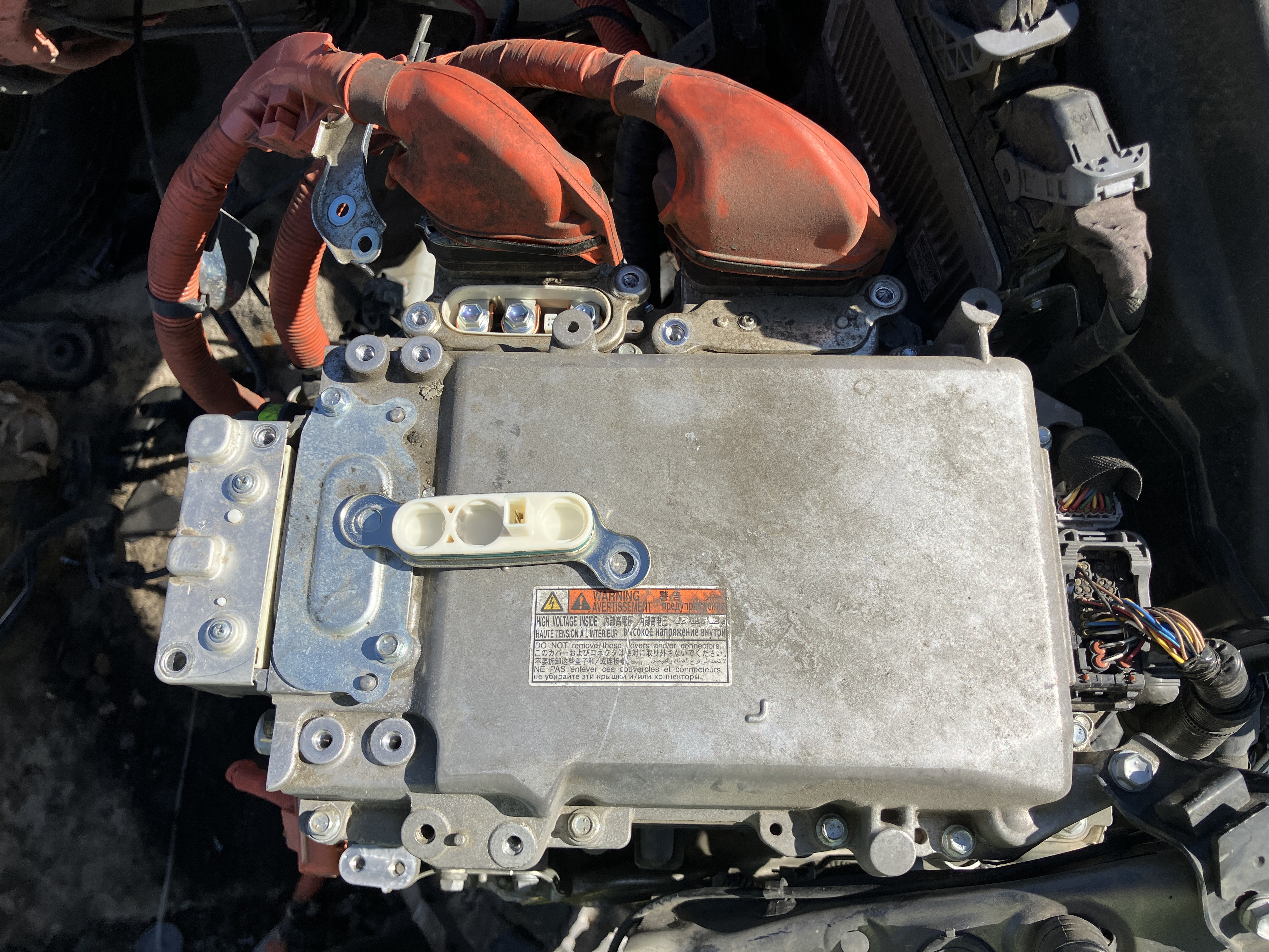

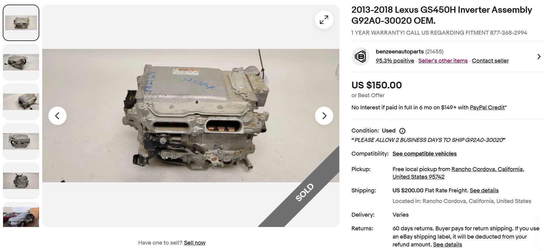

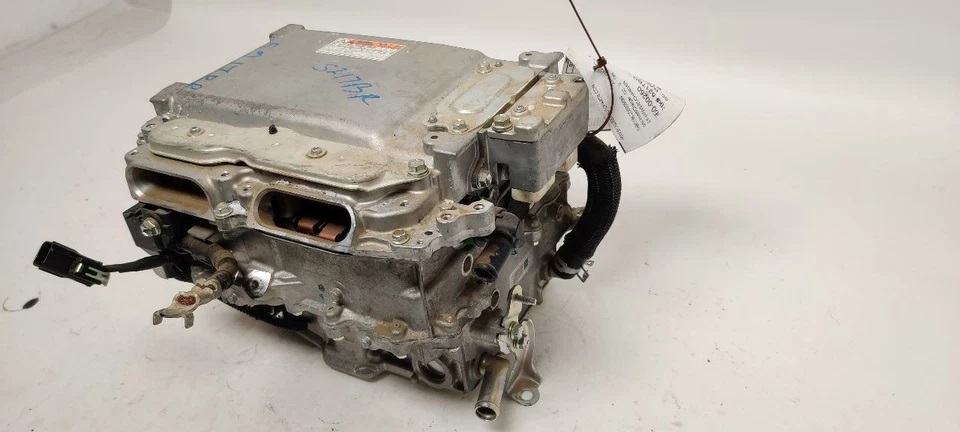

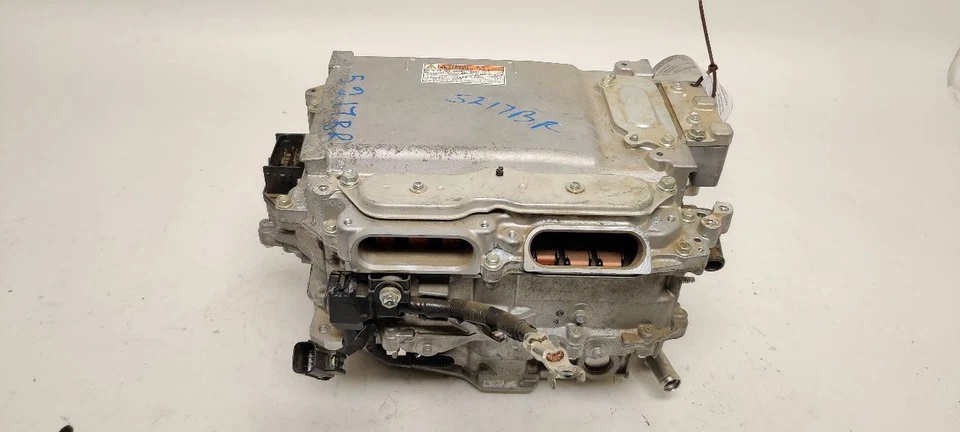

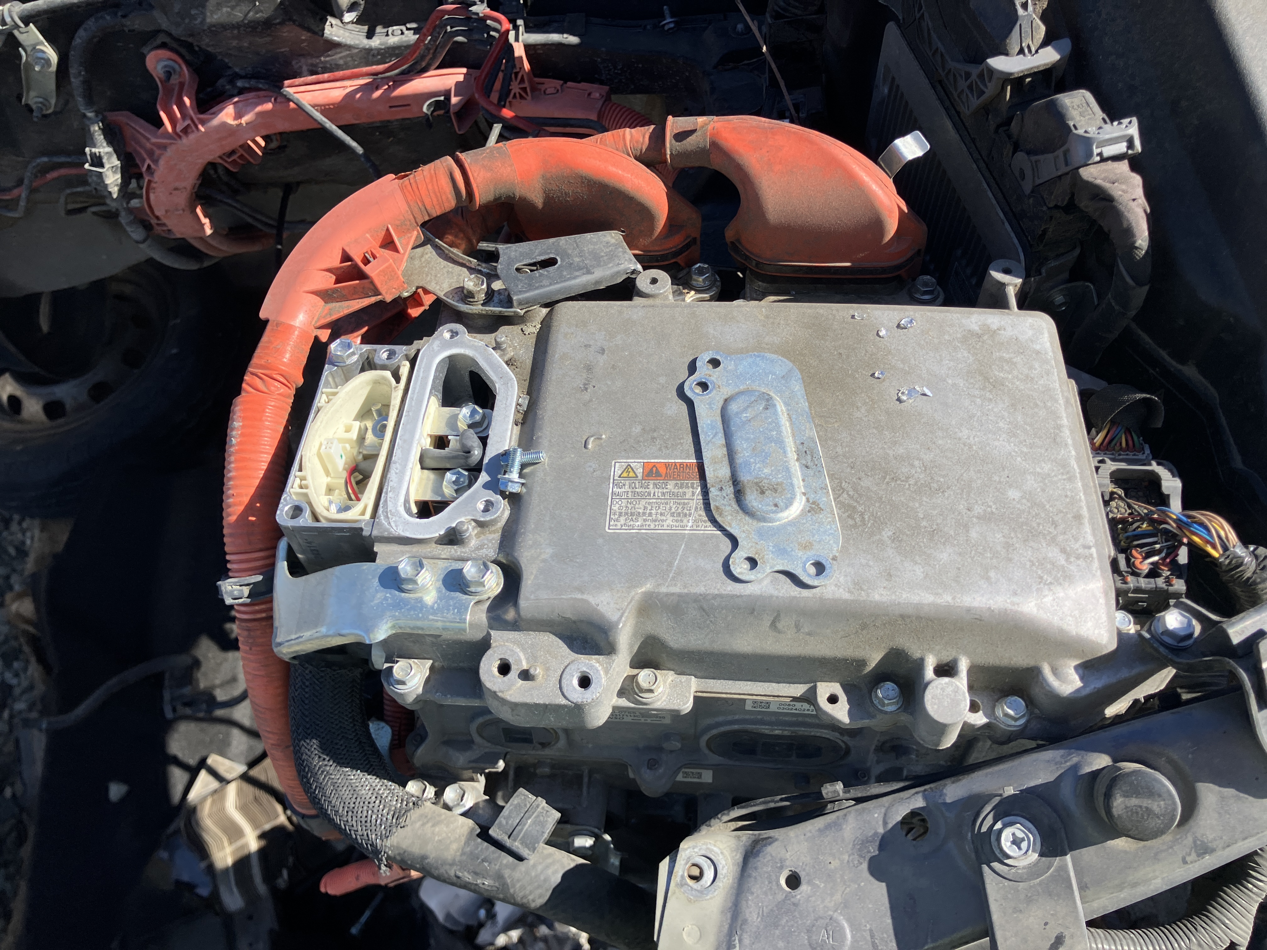

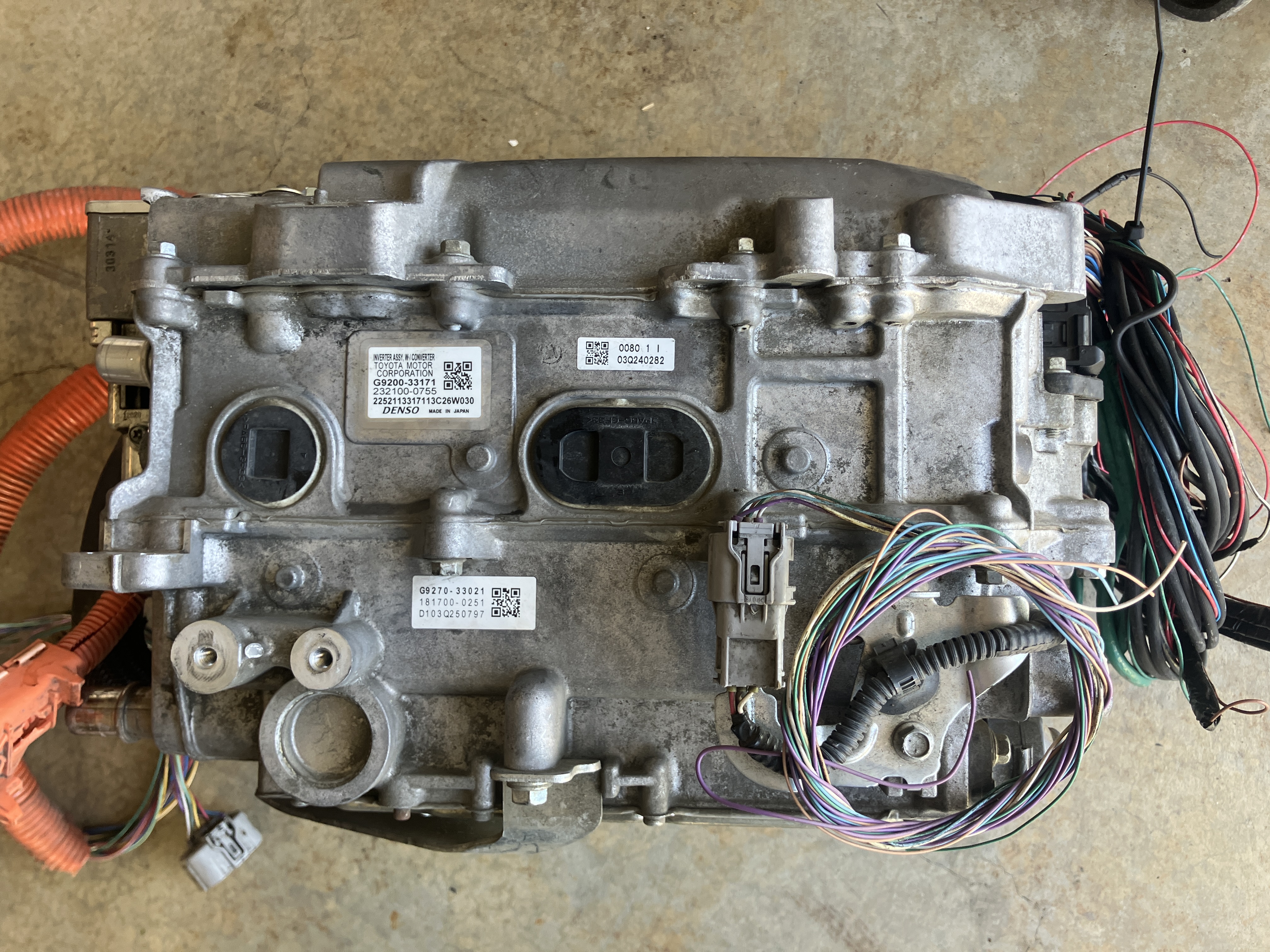

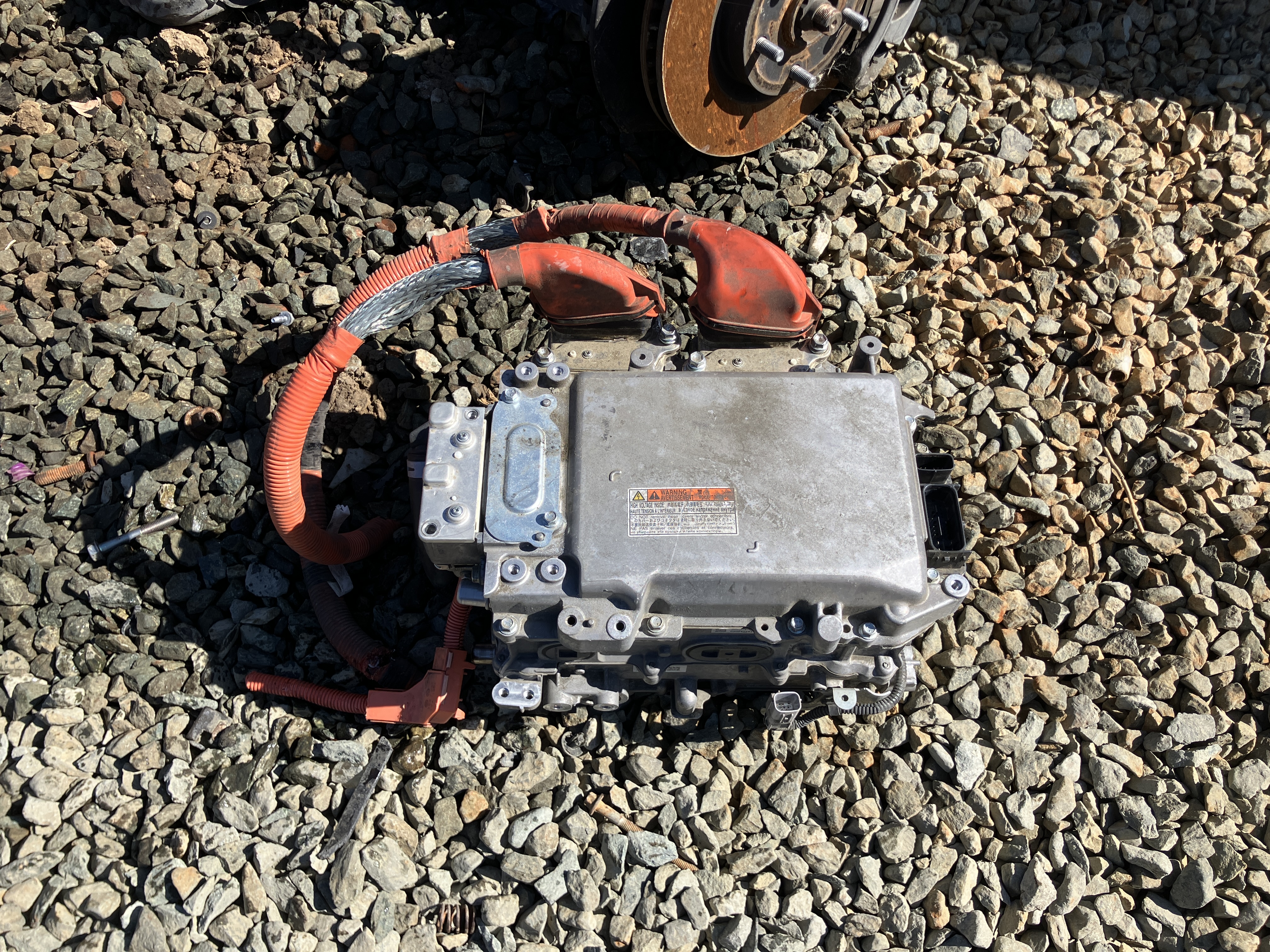

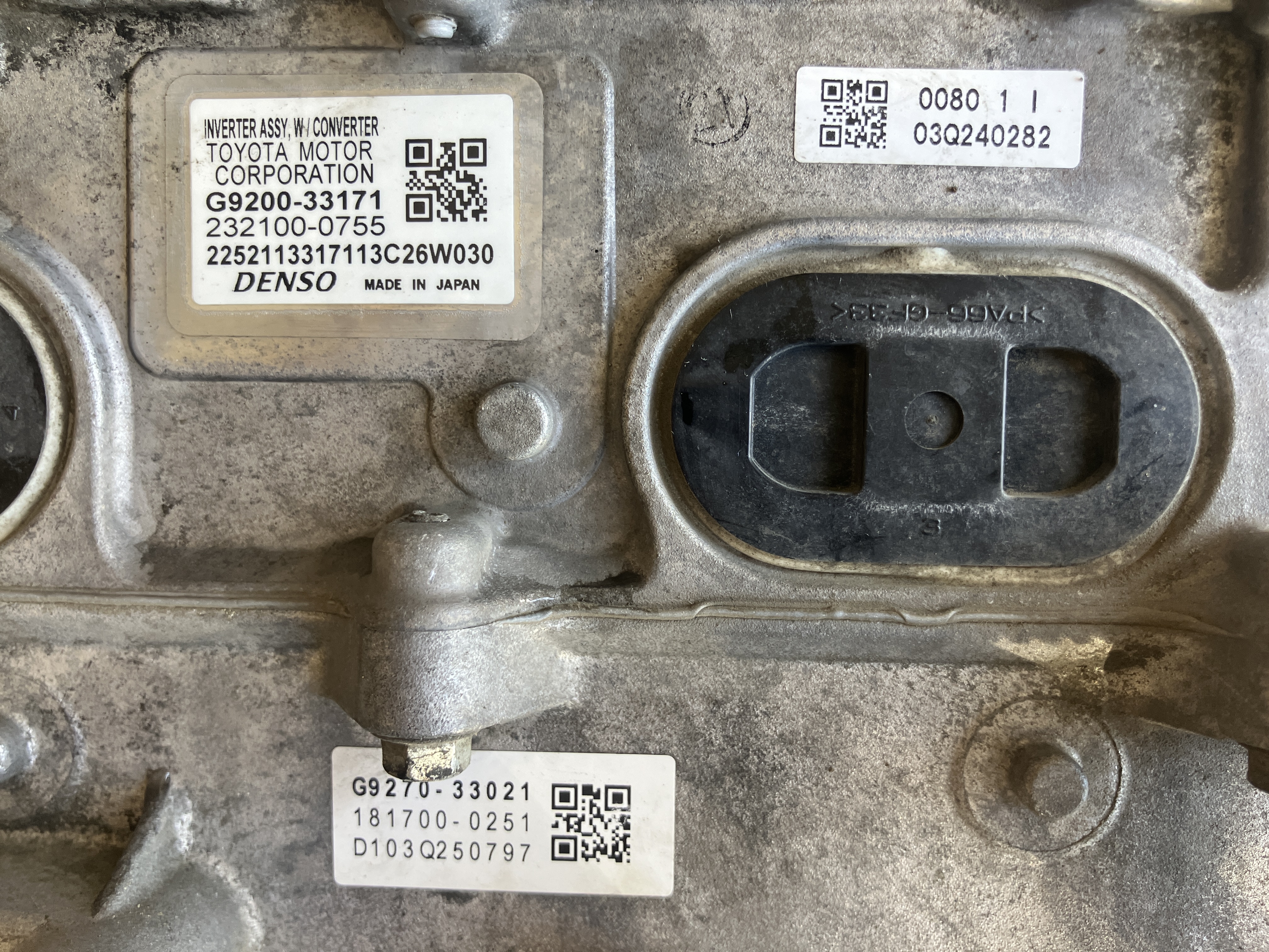

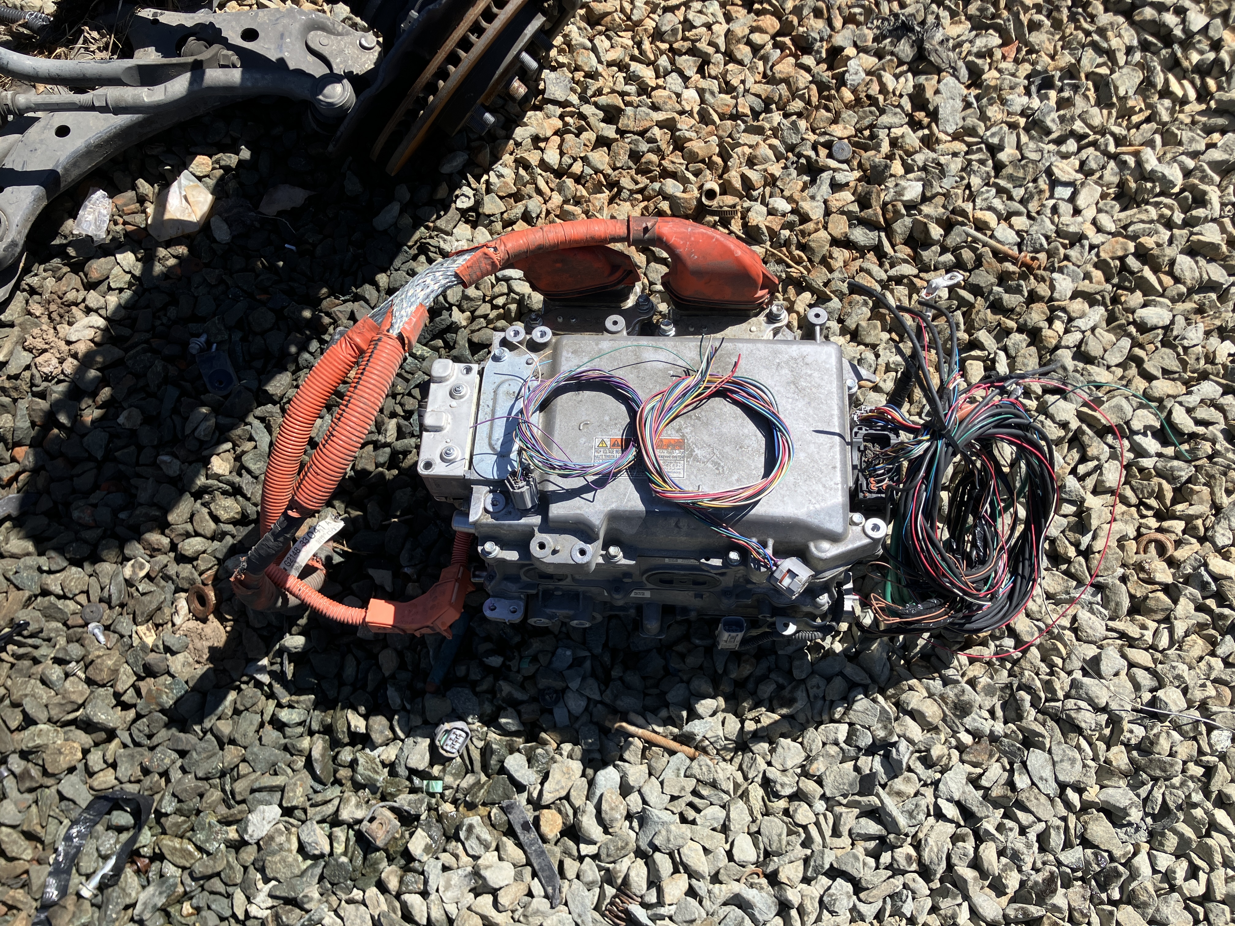

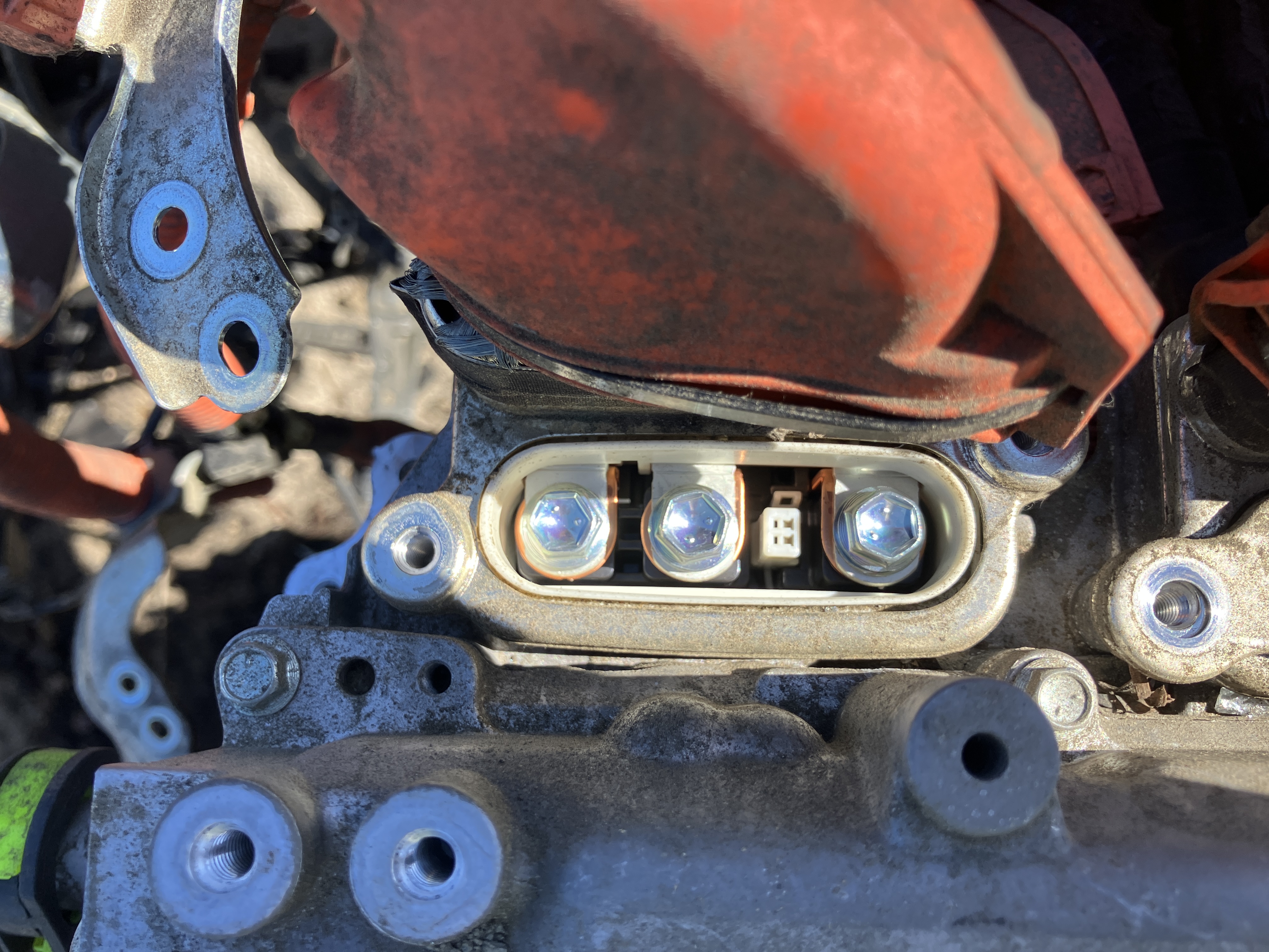

inverter listing as seen on eBay

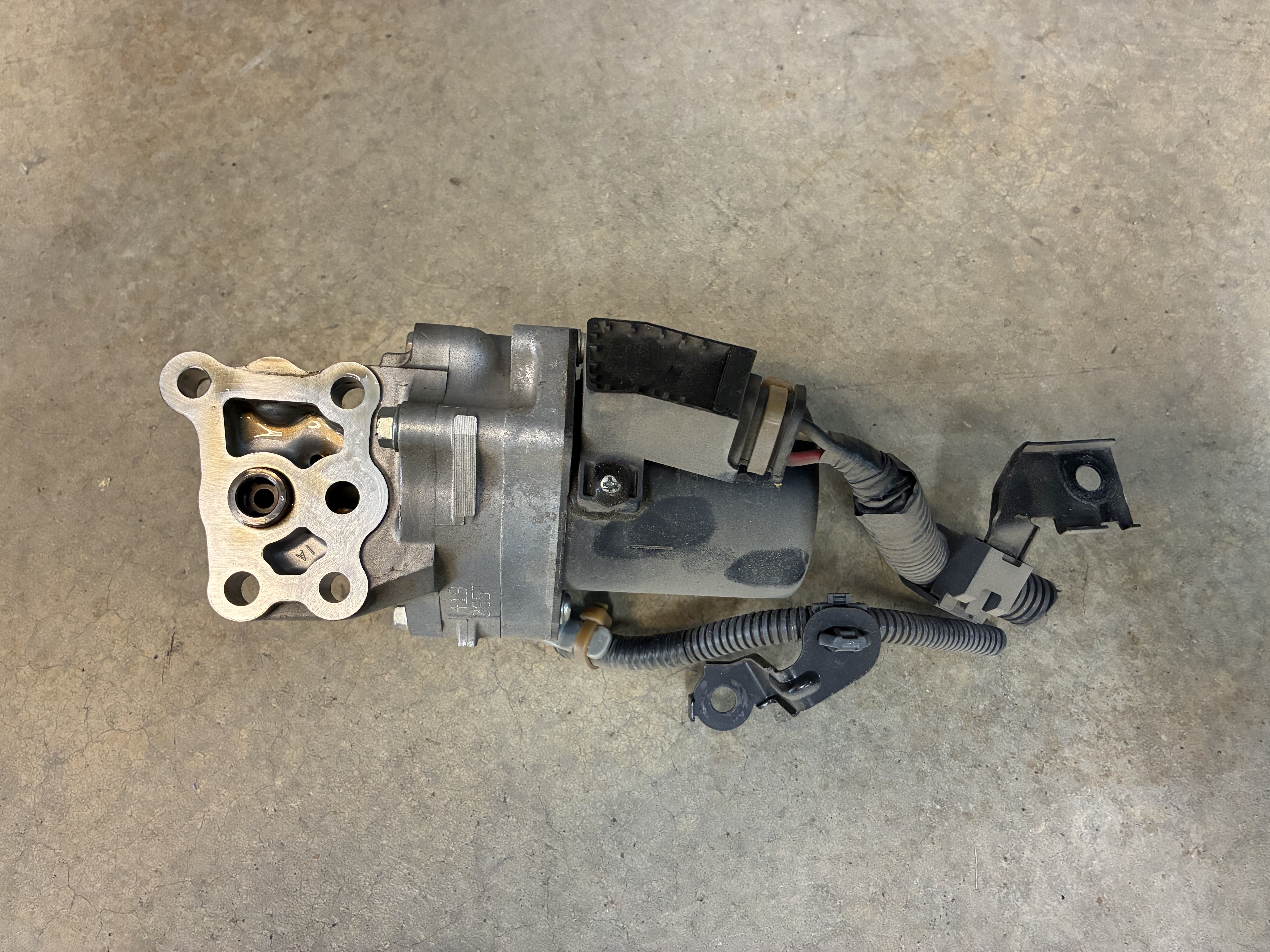

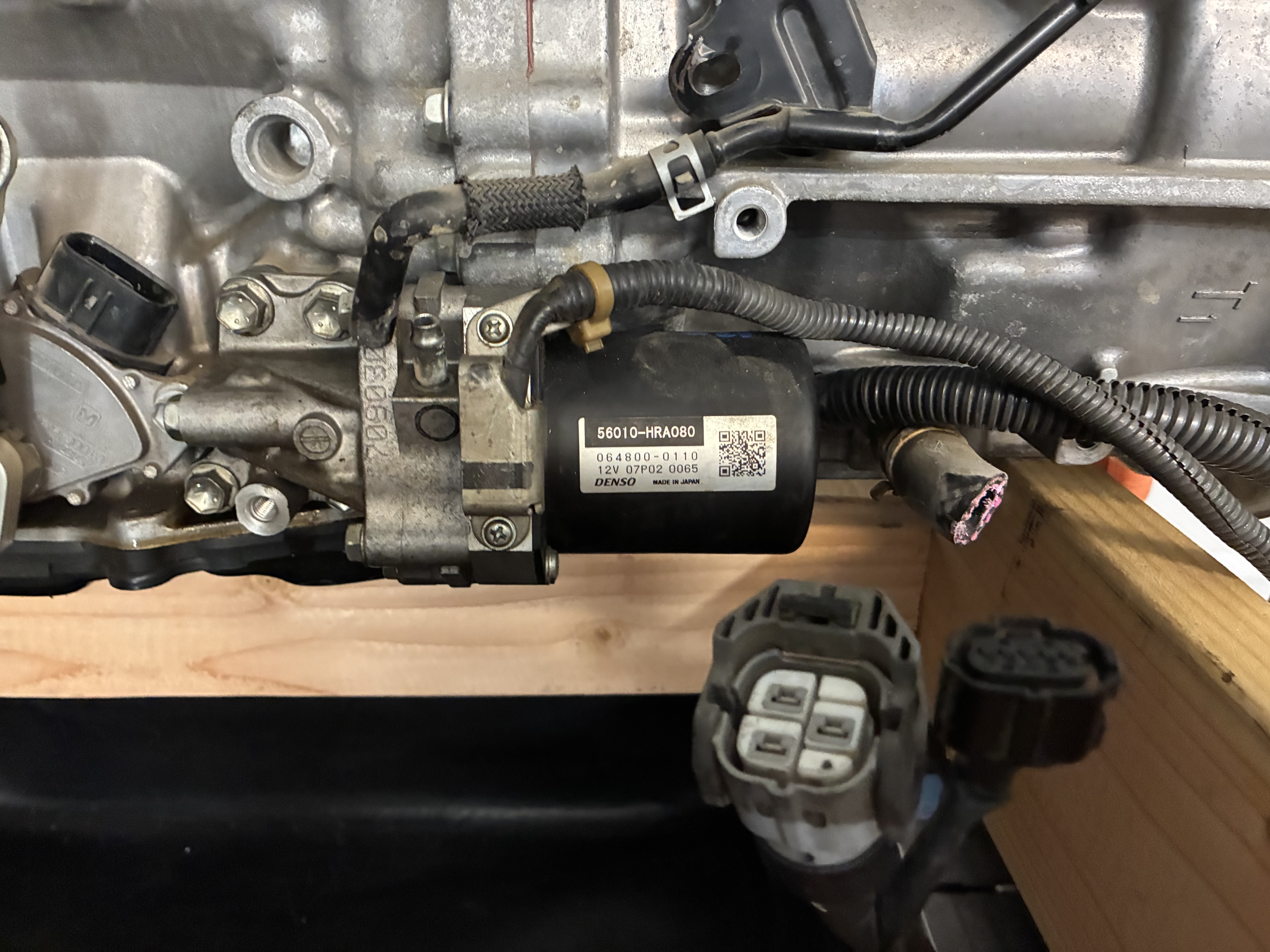

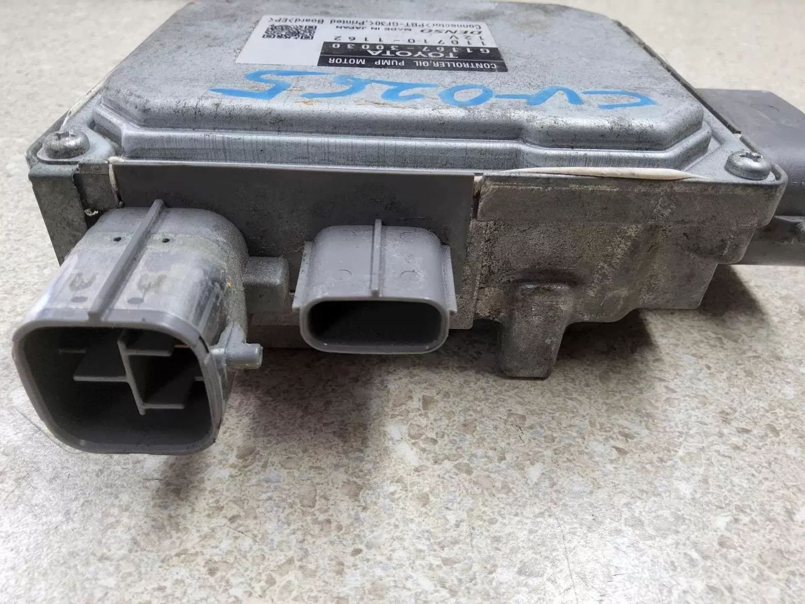

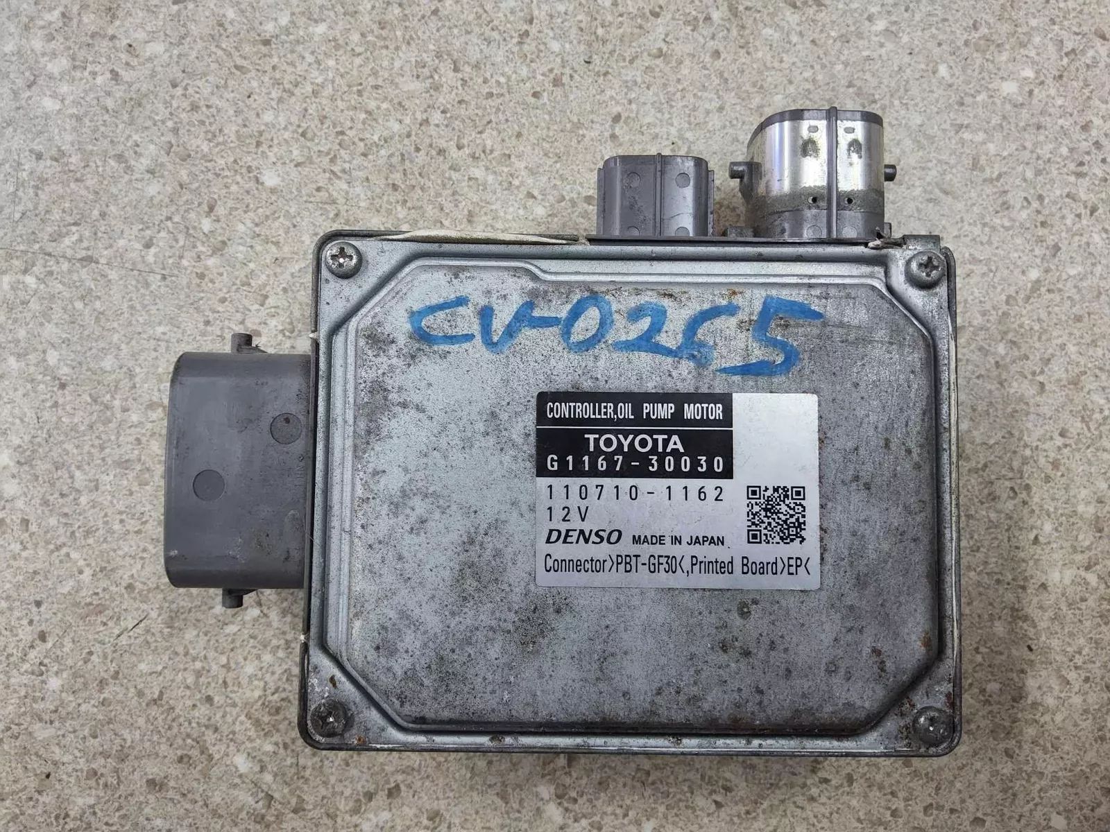

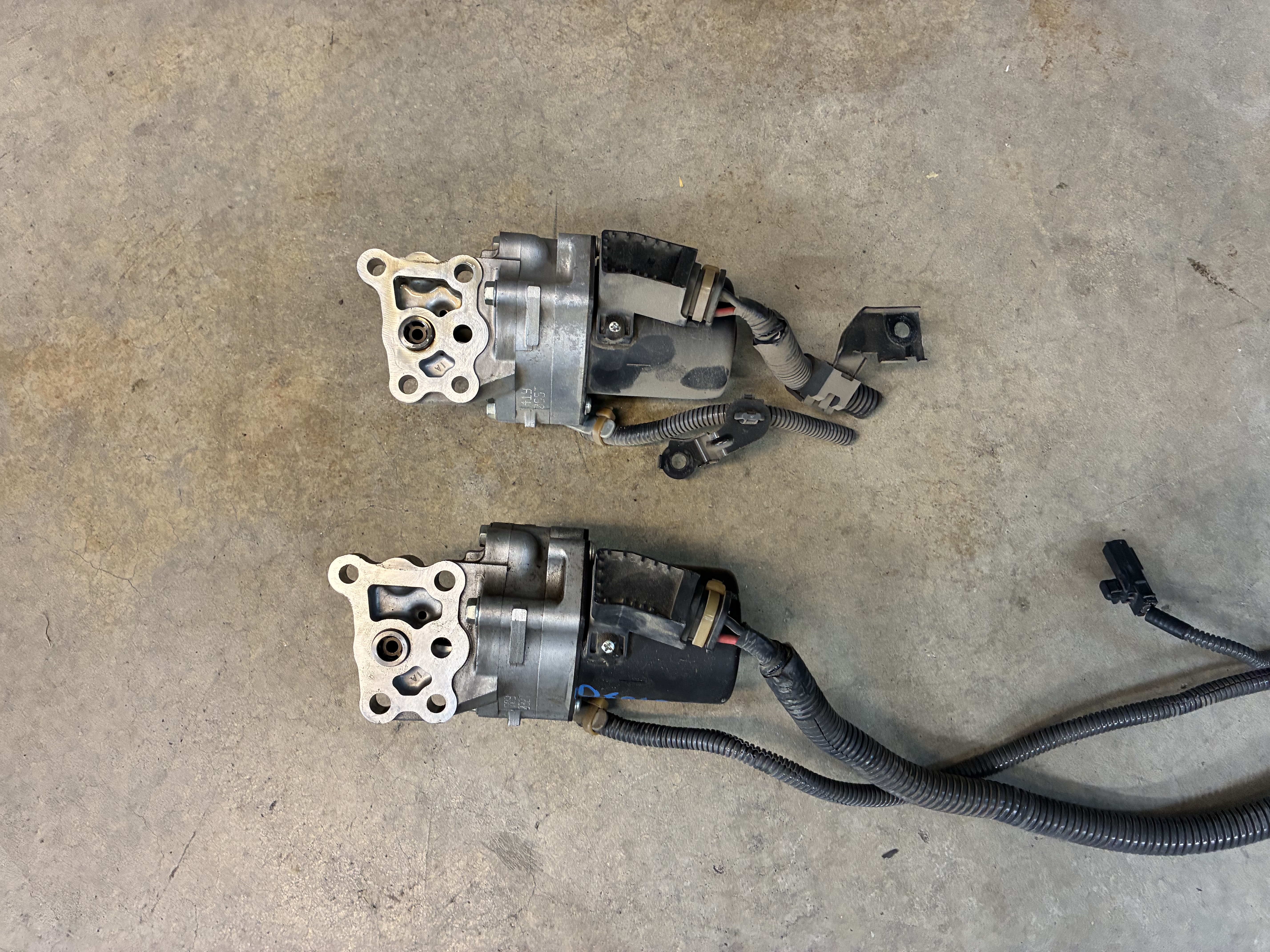

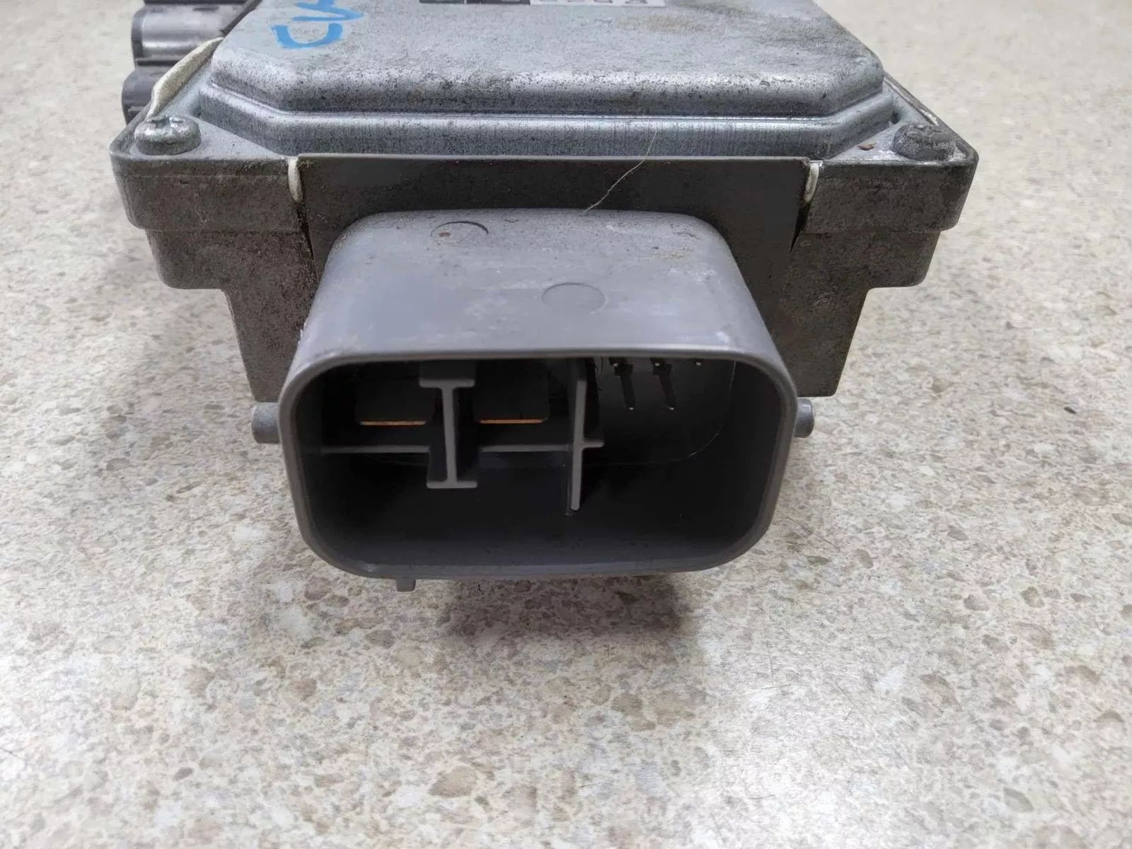

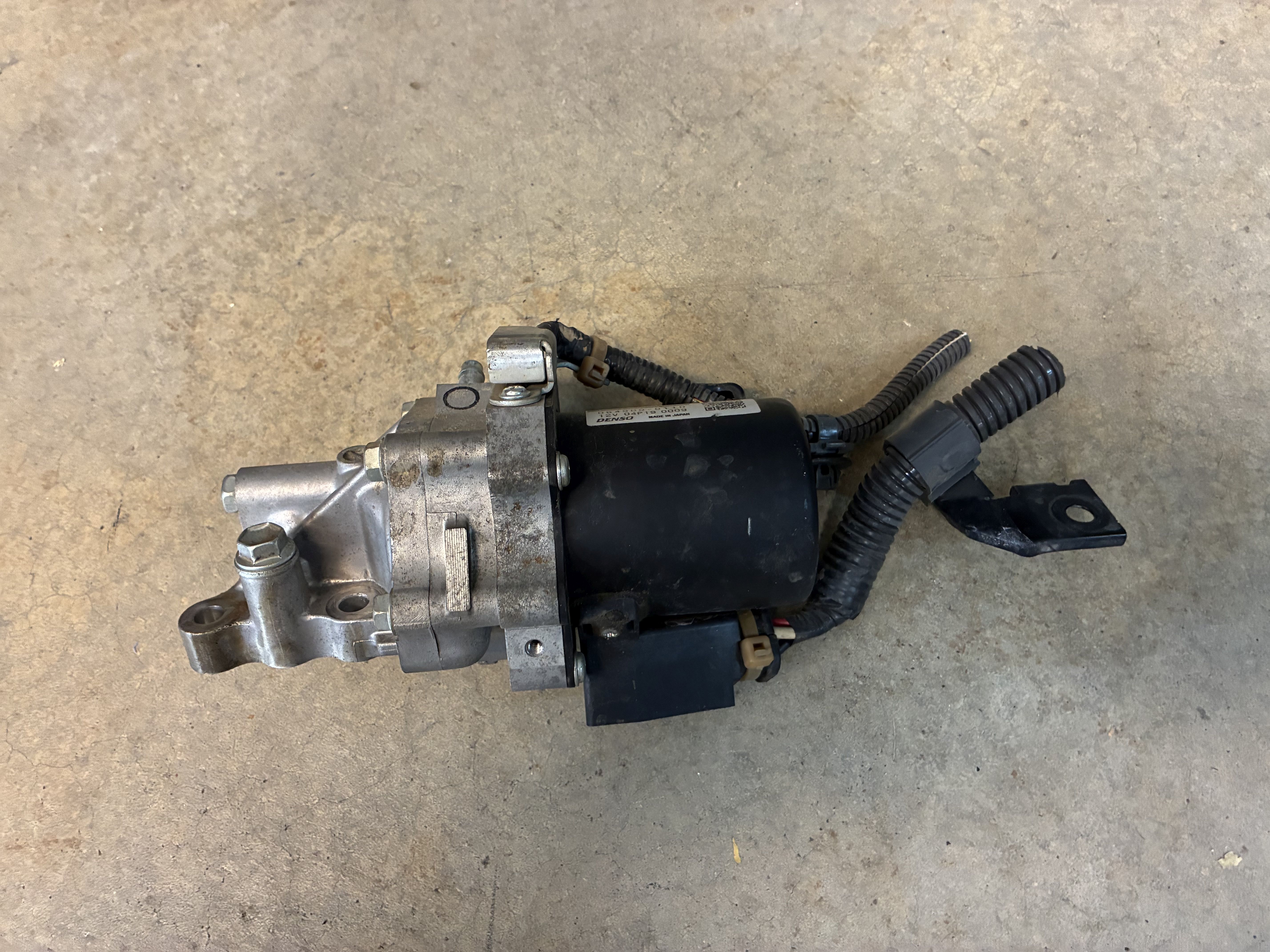

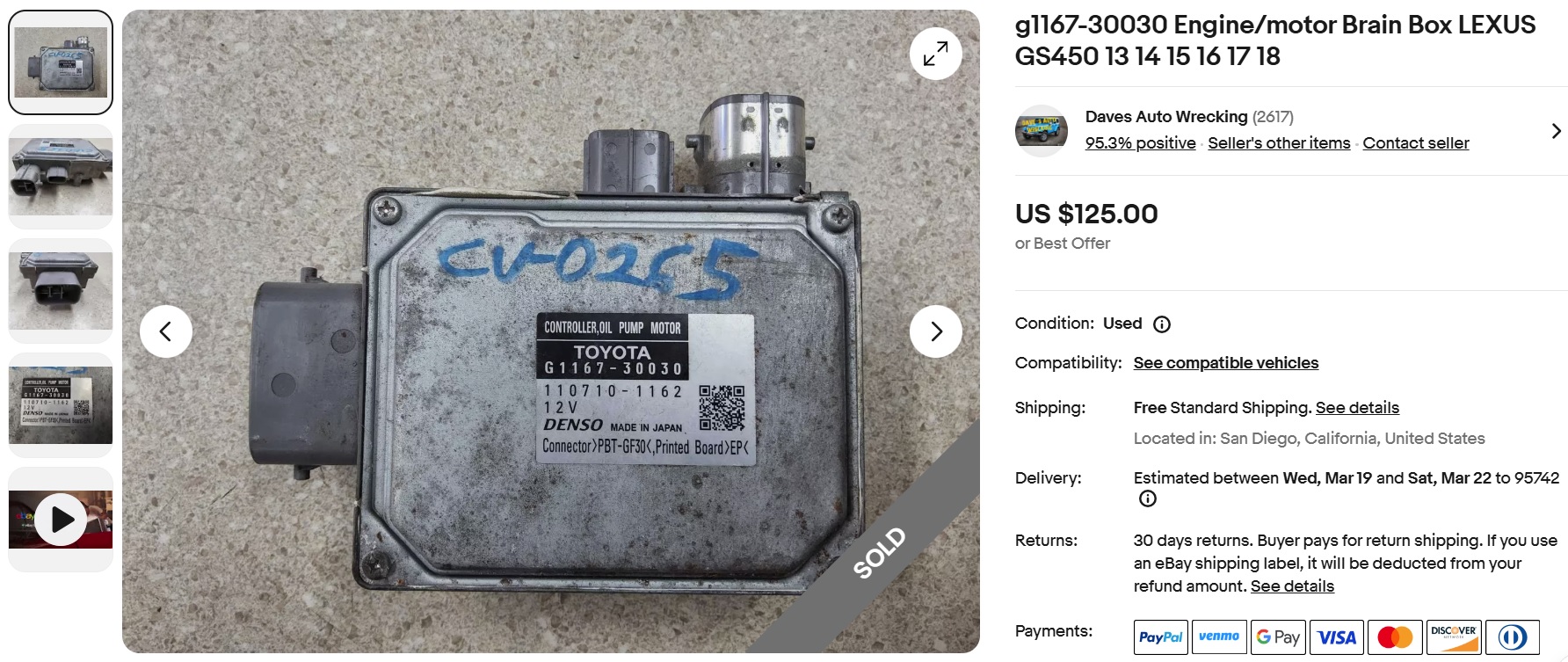

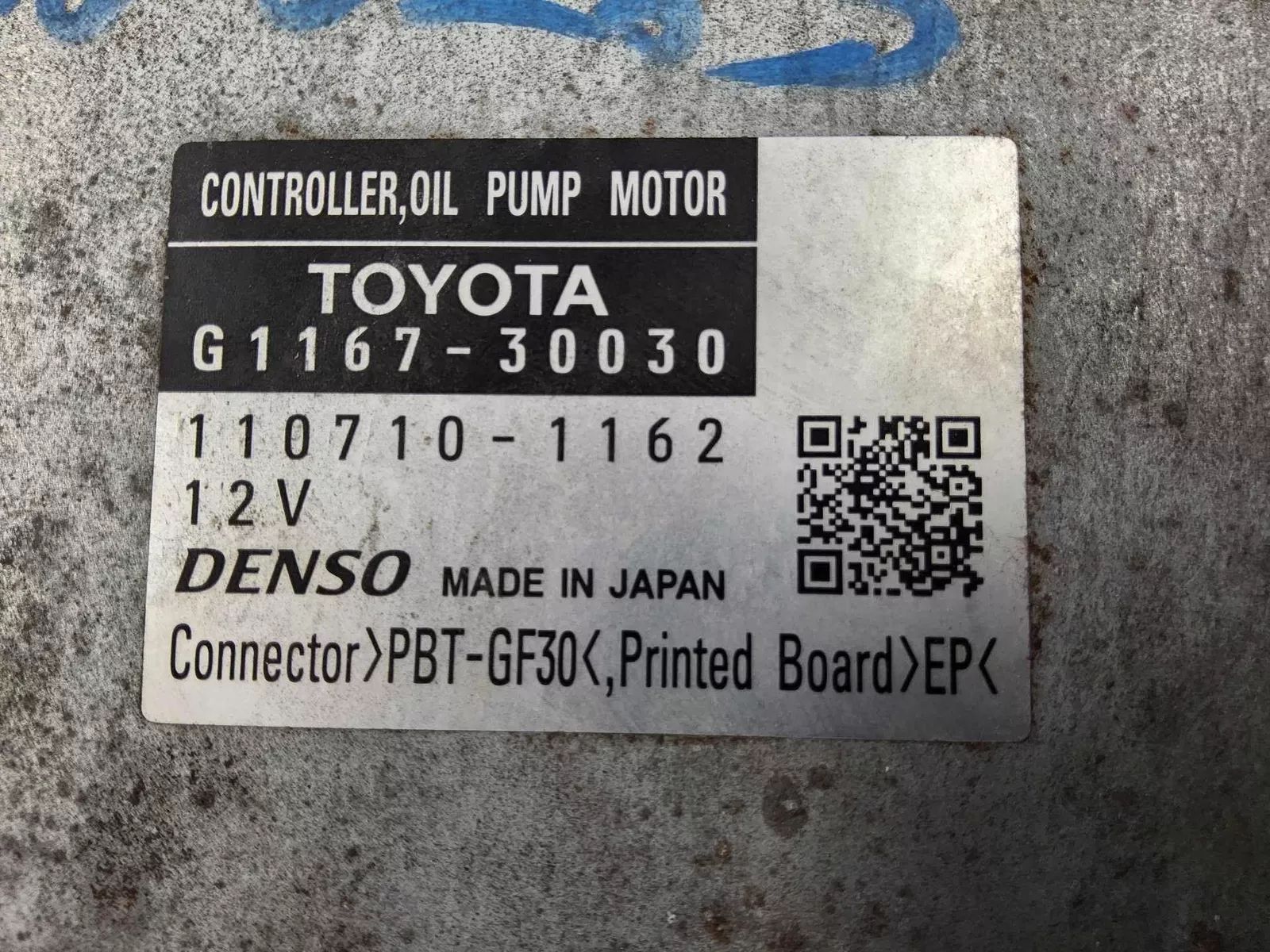

4th Gen oil pump controller as seen on eBay
Part Number is G116730030 and fits 2013-2019

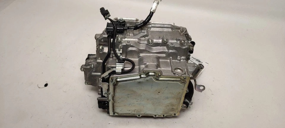

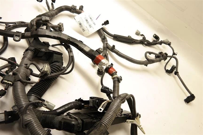

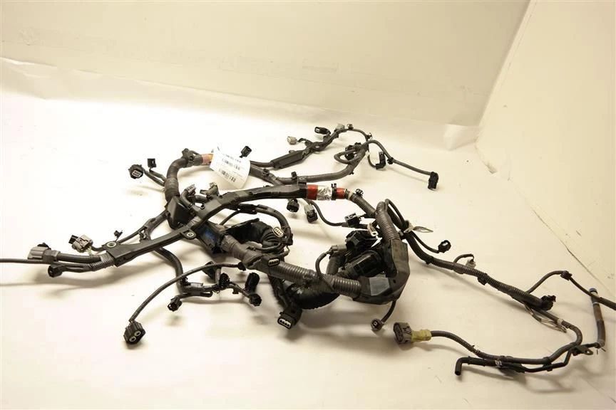

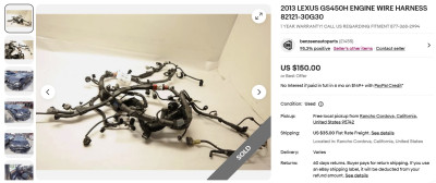

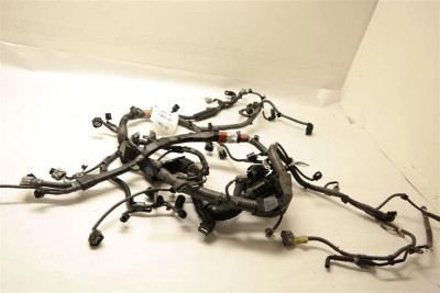

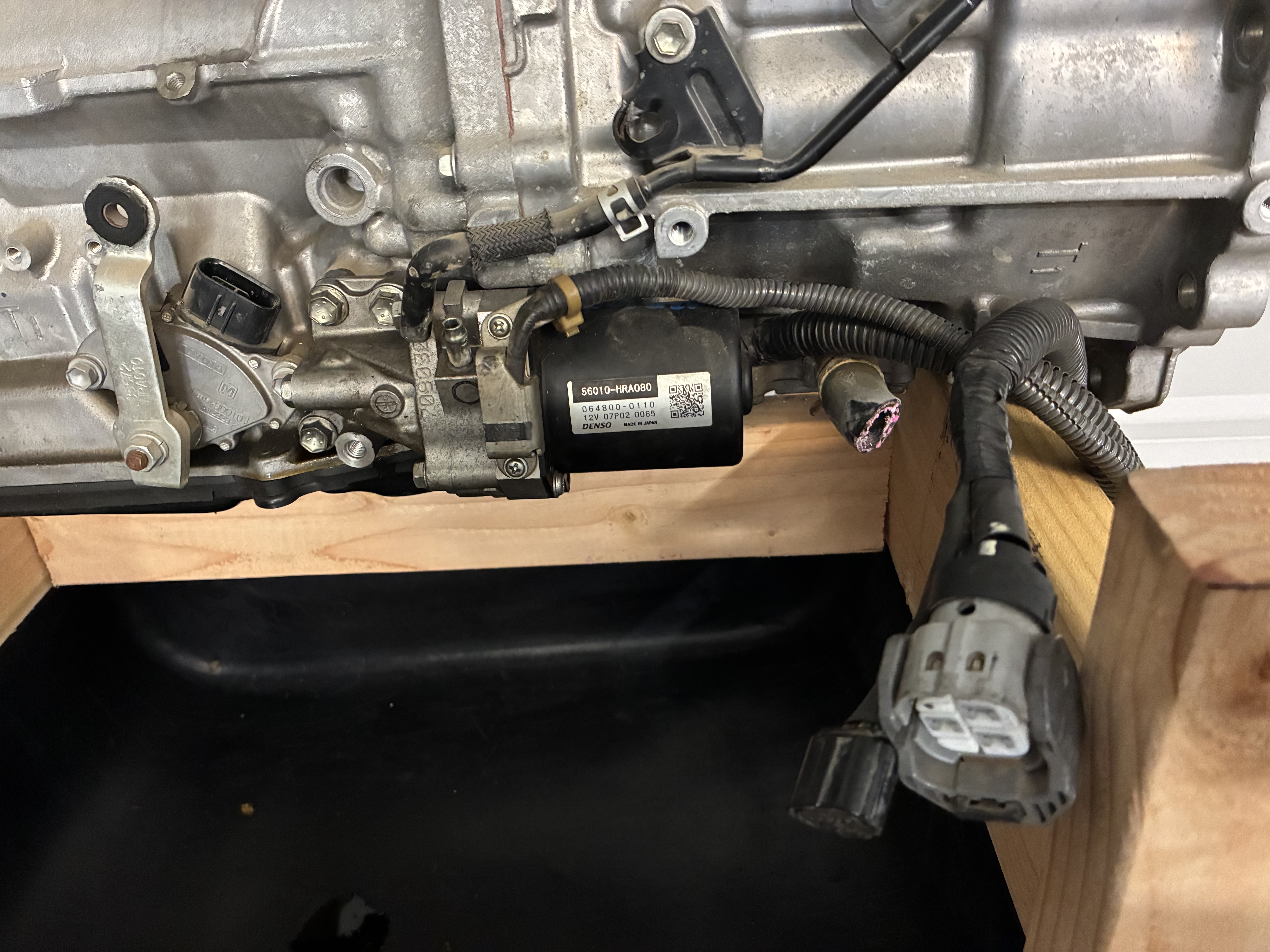

transmission wire harness as seen on eBay
4th Gen transmission wire harness Part # 82121-30G30 is for 2013-2016 this one has the resolver cables but not the inverter connector/plug

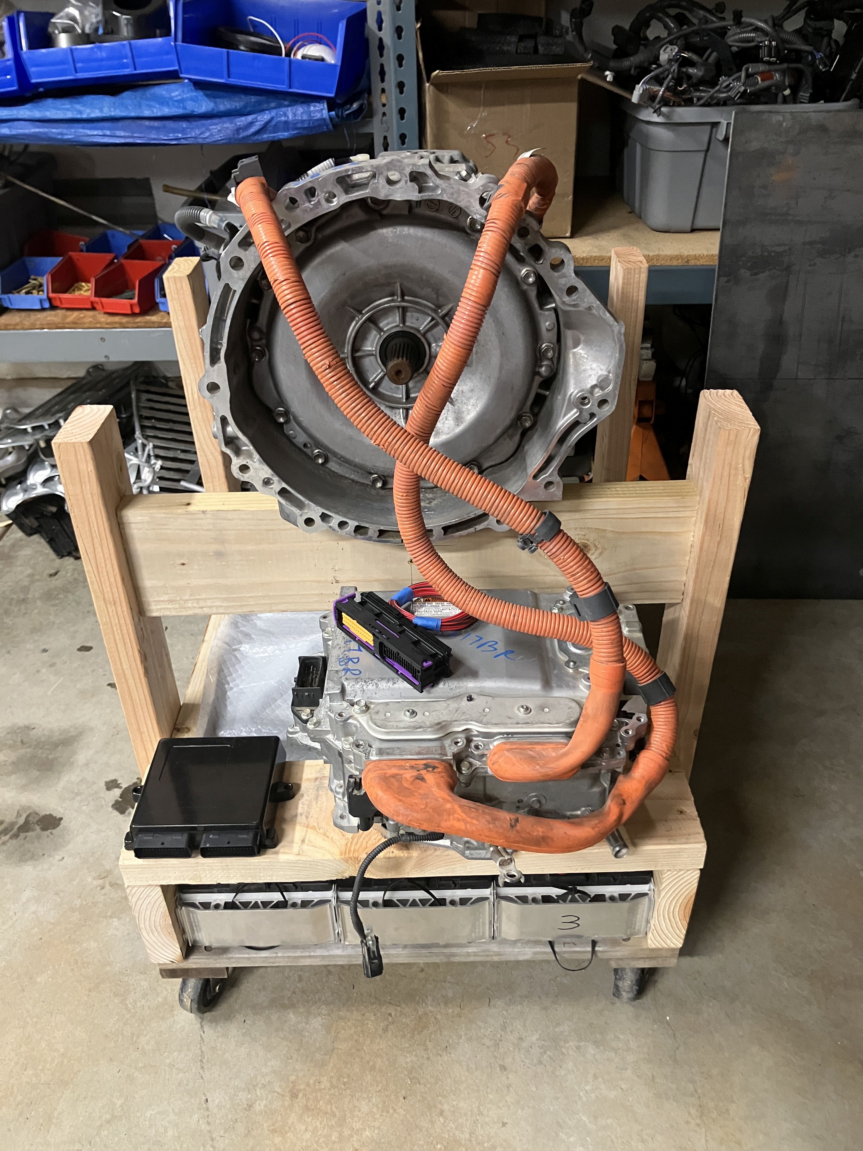

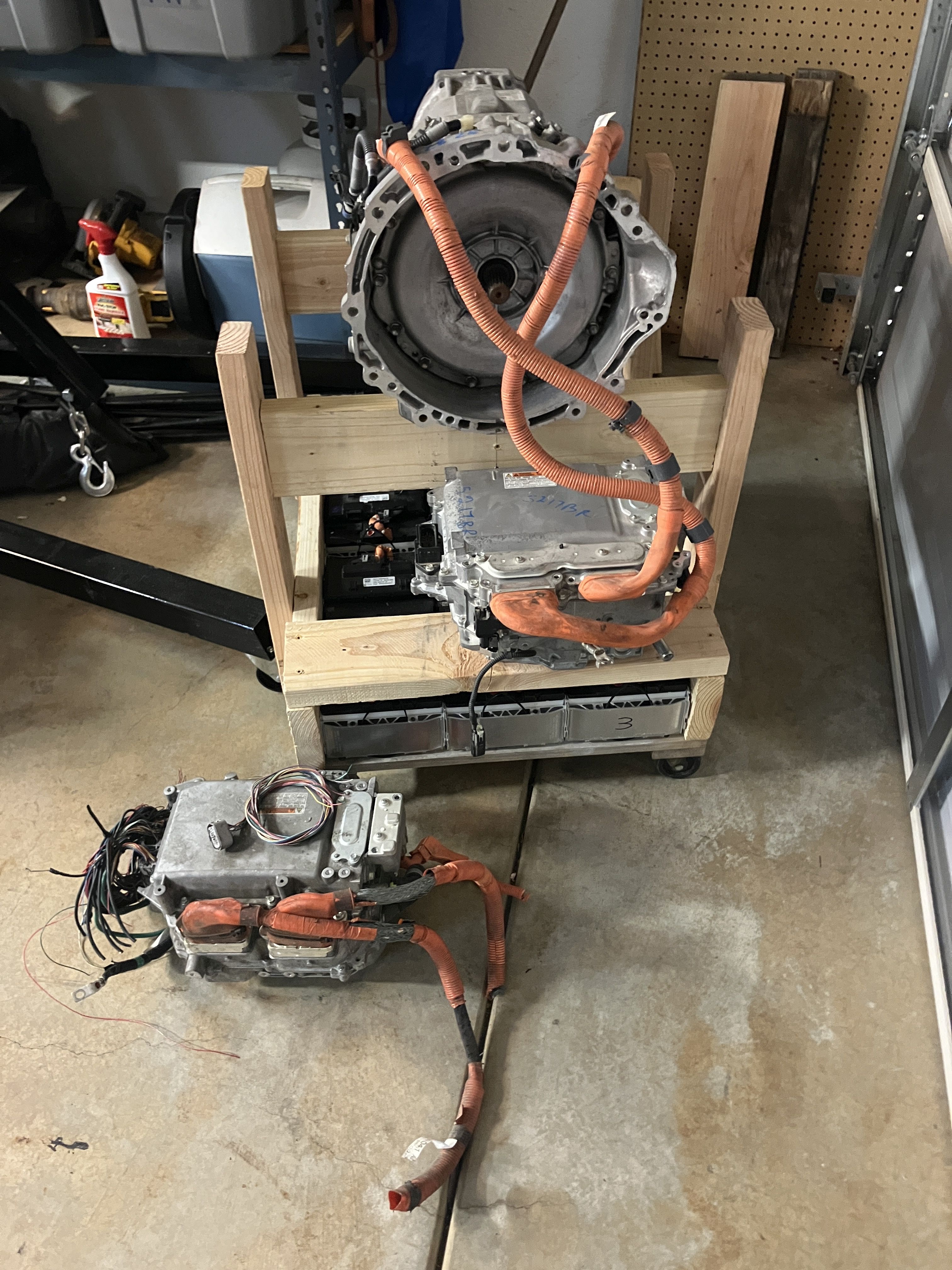

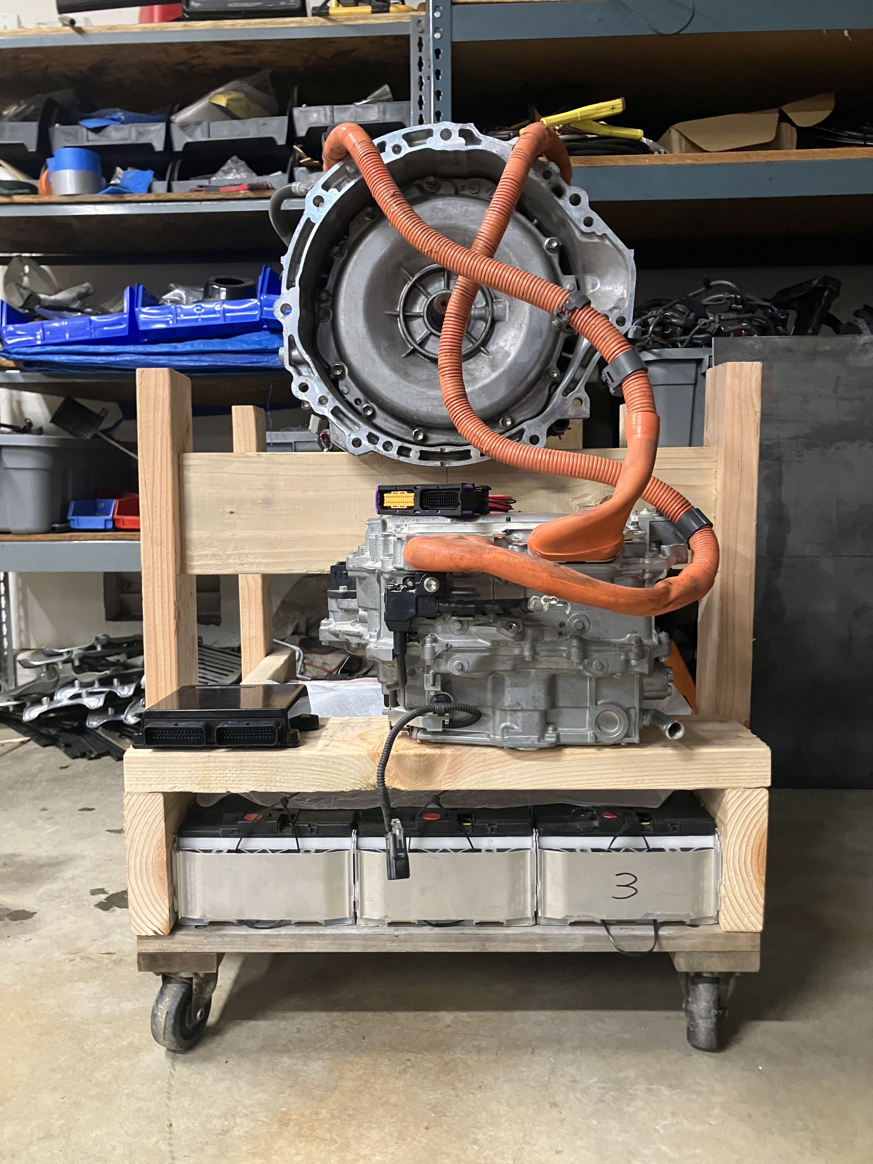

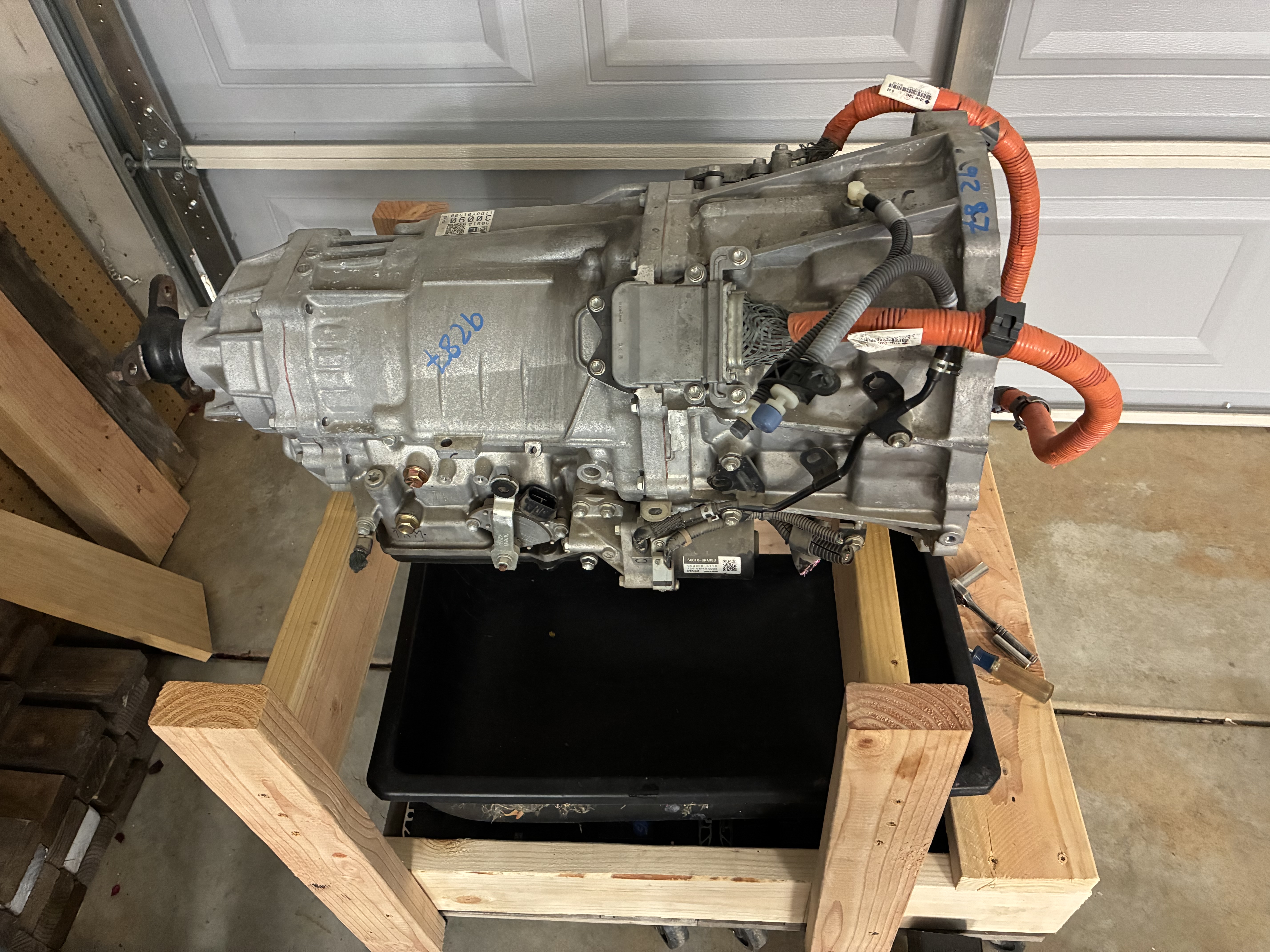

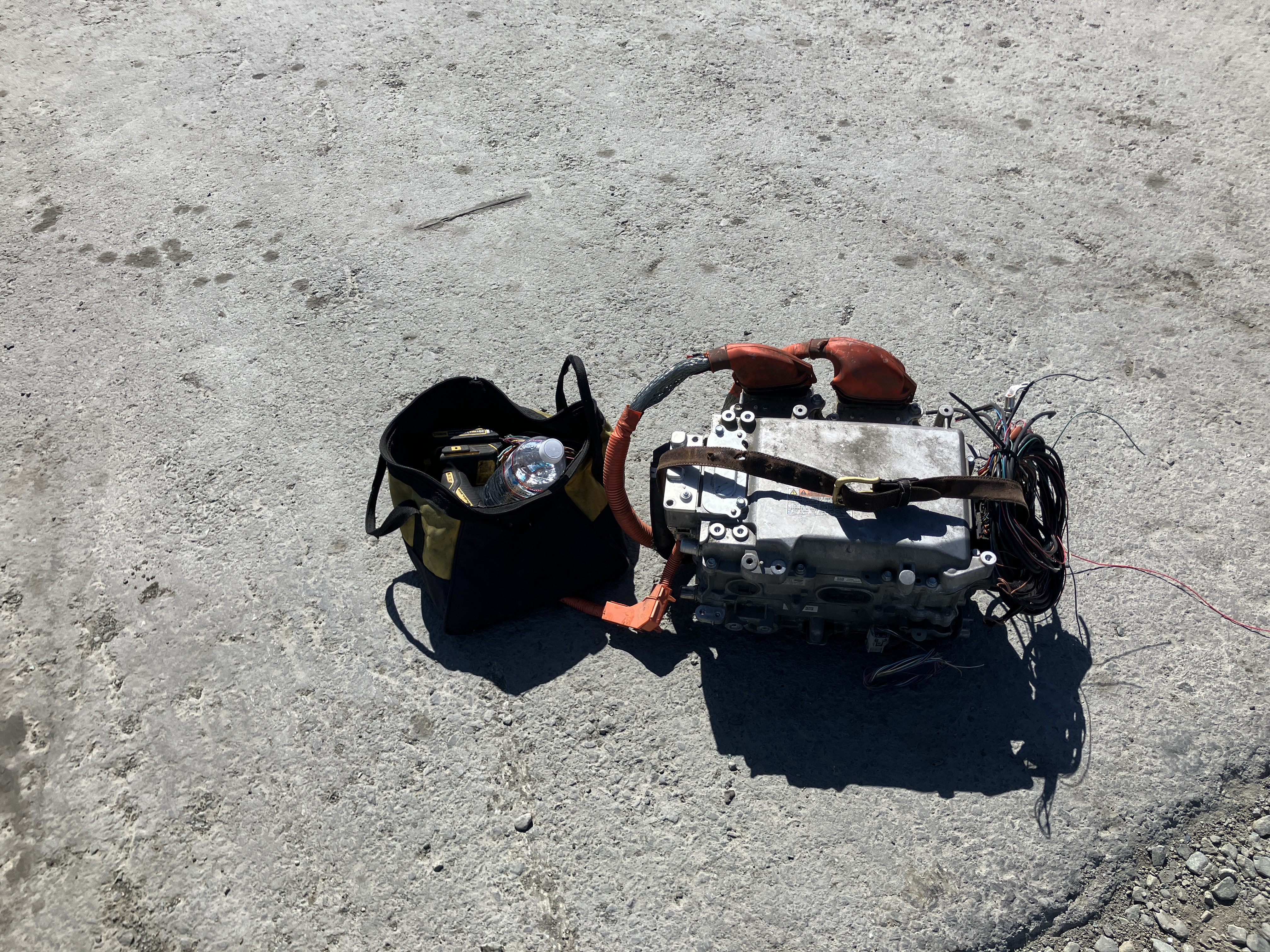

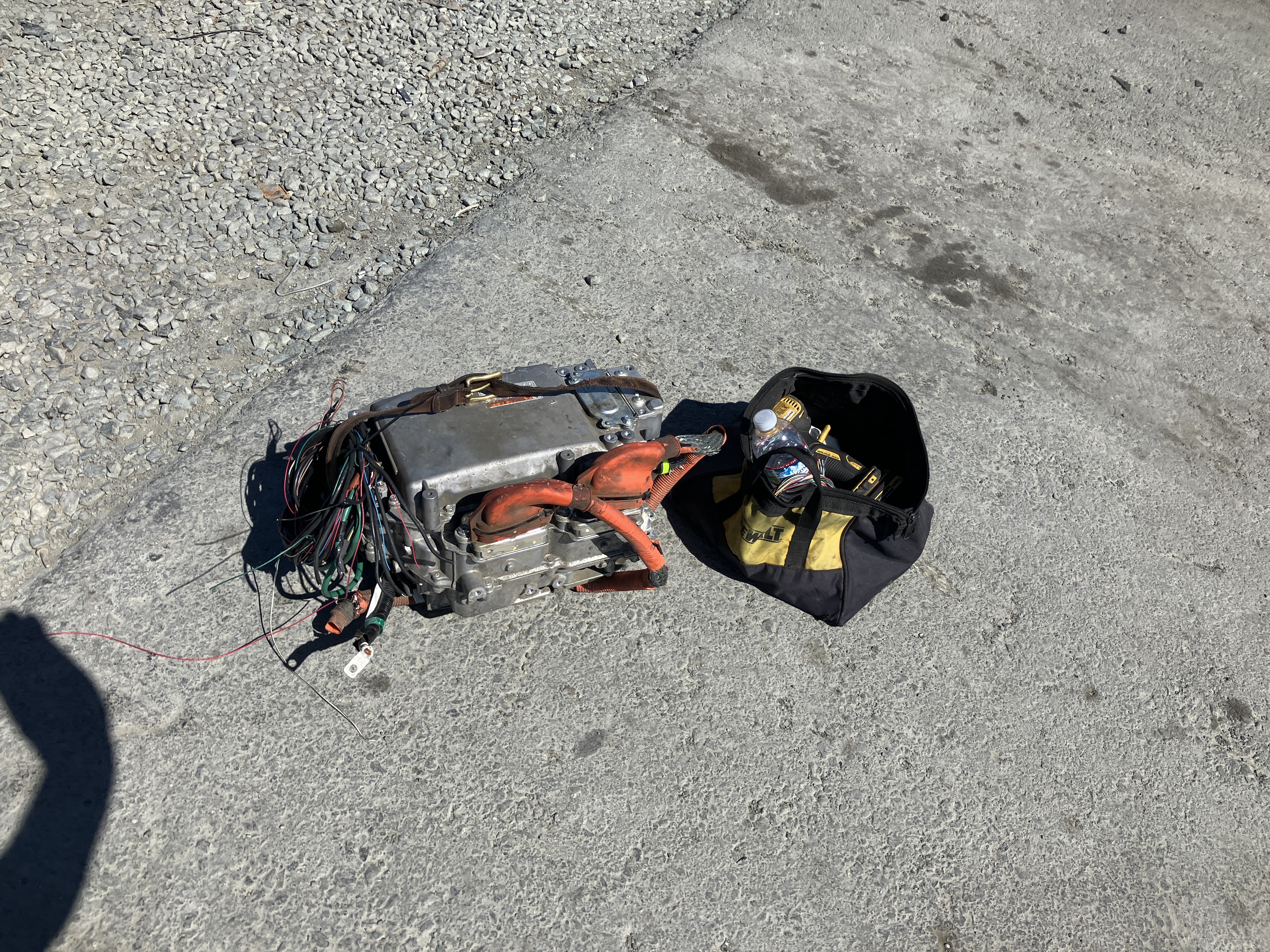

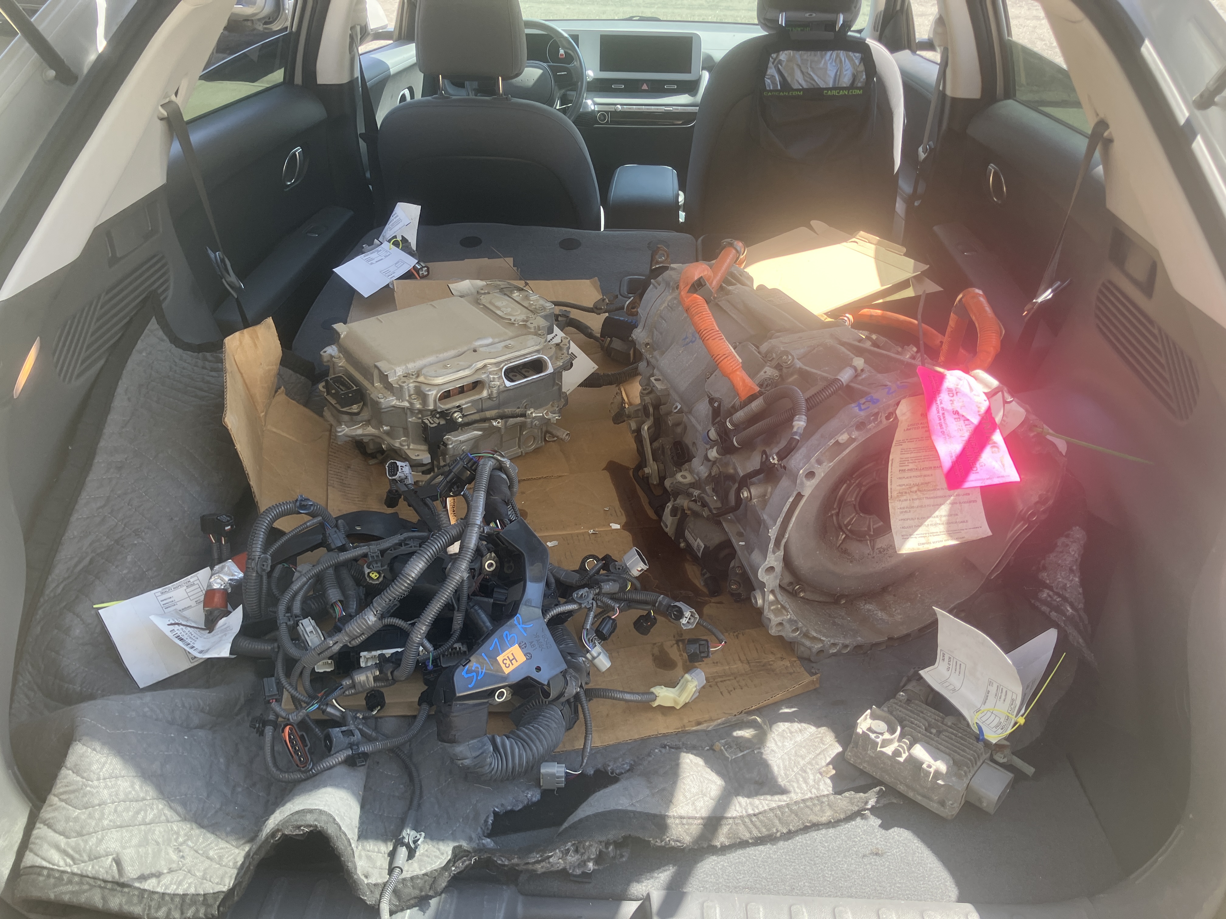

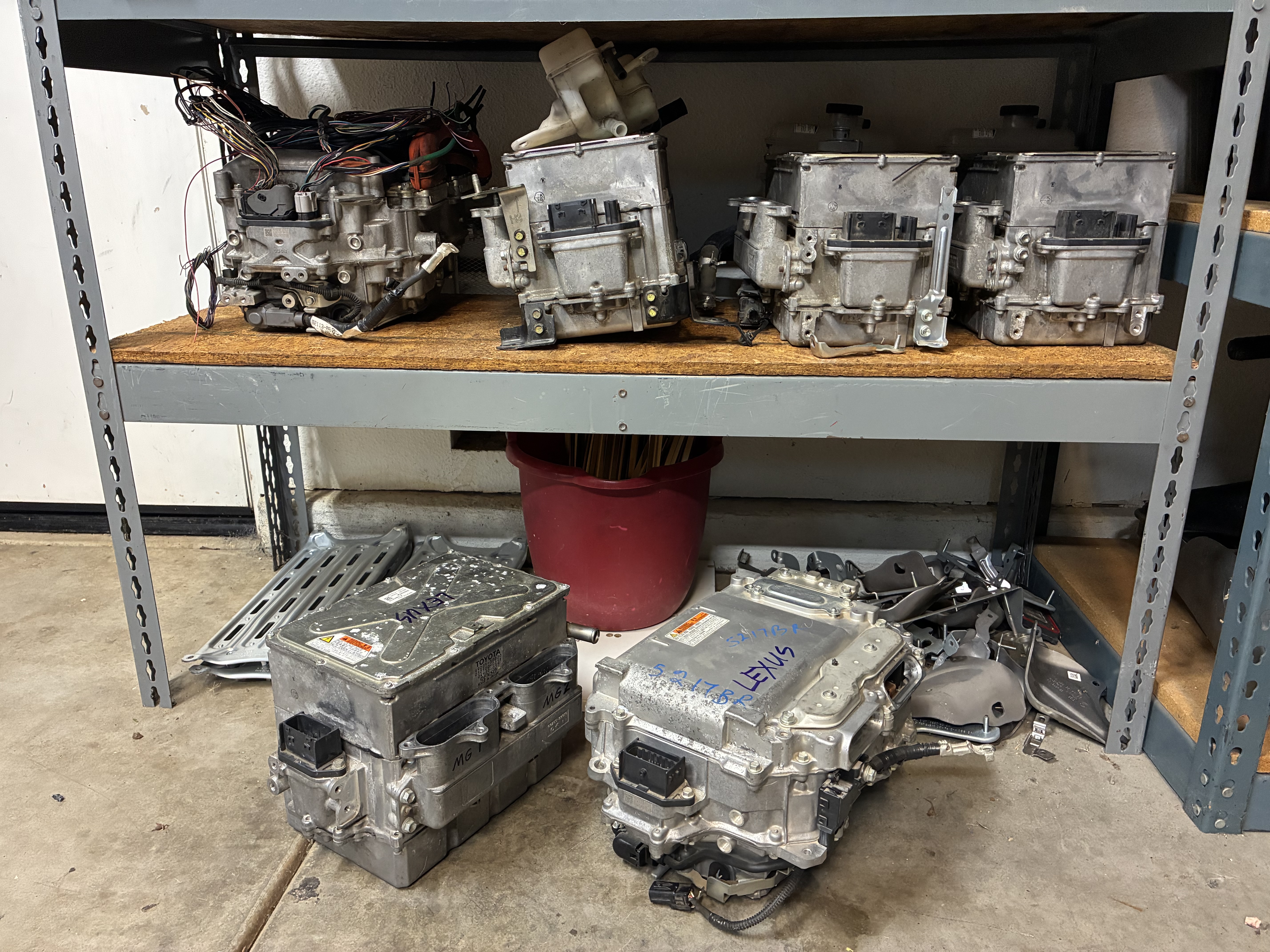

and so it begins...

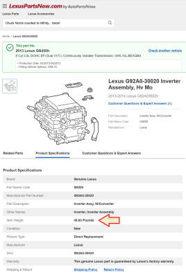

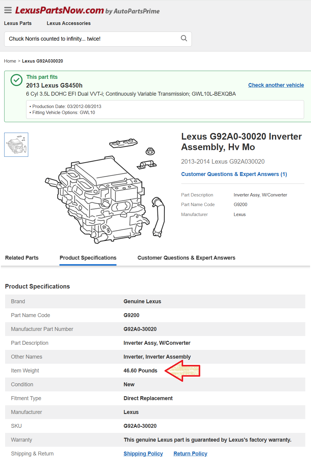

I believe on the Gen 3s the weight was 289 lbs and 40lbs for the inverter. Just for comparison's sake.
Brother Matt, did you just look at my watch and told me what time it was, LoL, how very consultant of you! JKMattsAwesomeStuff wrote: ↑Sat Mar 15, 2025 10:29 pm I believe on the Gen 3s the weight was 289 lbs and 40lbs for the inverter. Just for comparison's sake.
Lexus 30910-30110 Transmission Assy, Hybrid Vehicle
Lexus G92A0-30020 Inverter Assembly, Hv Mo

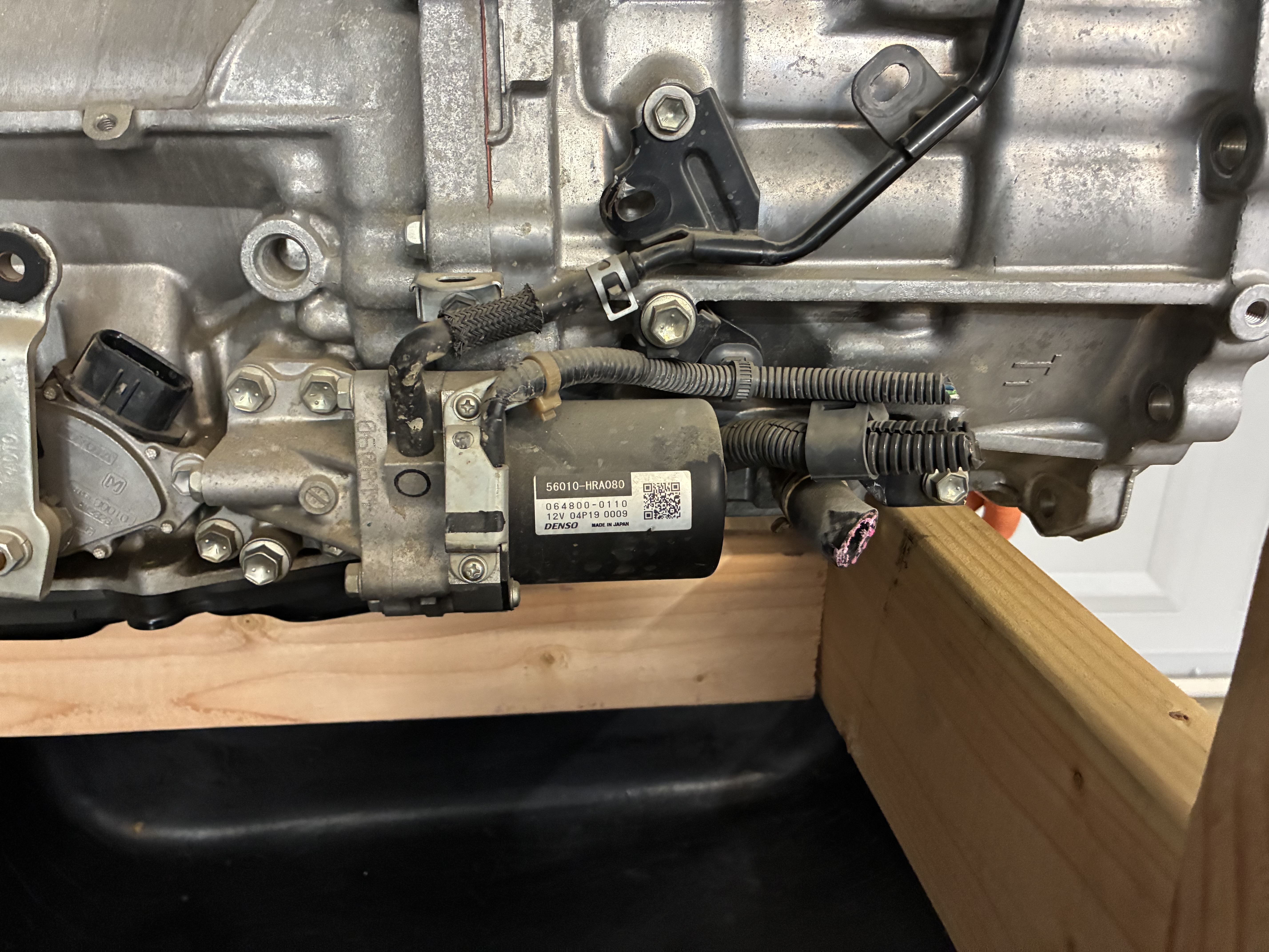

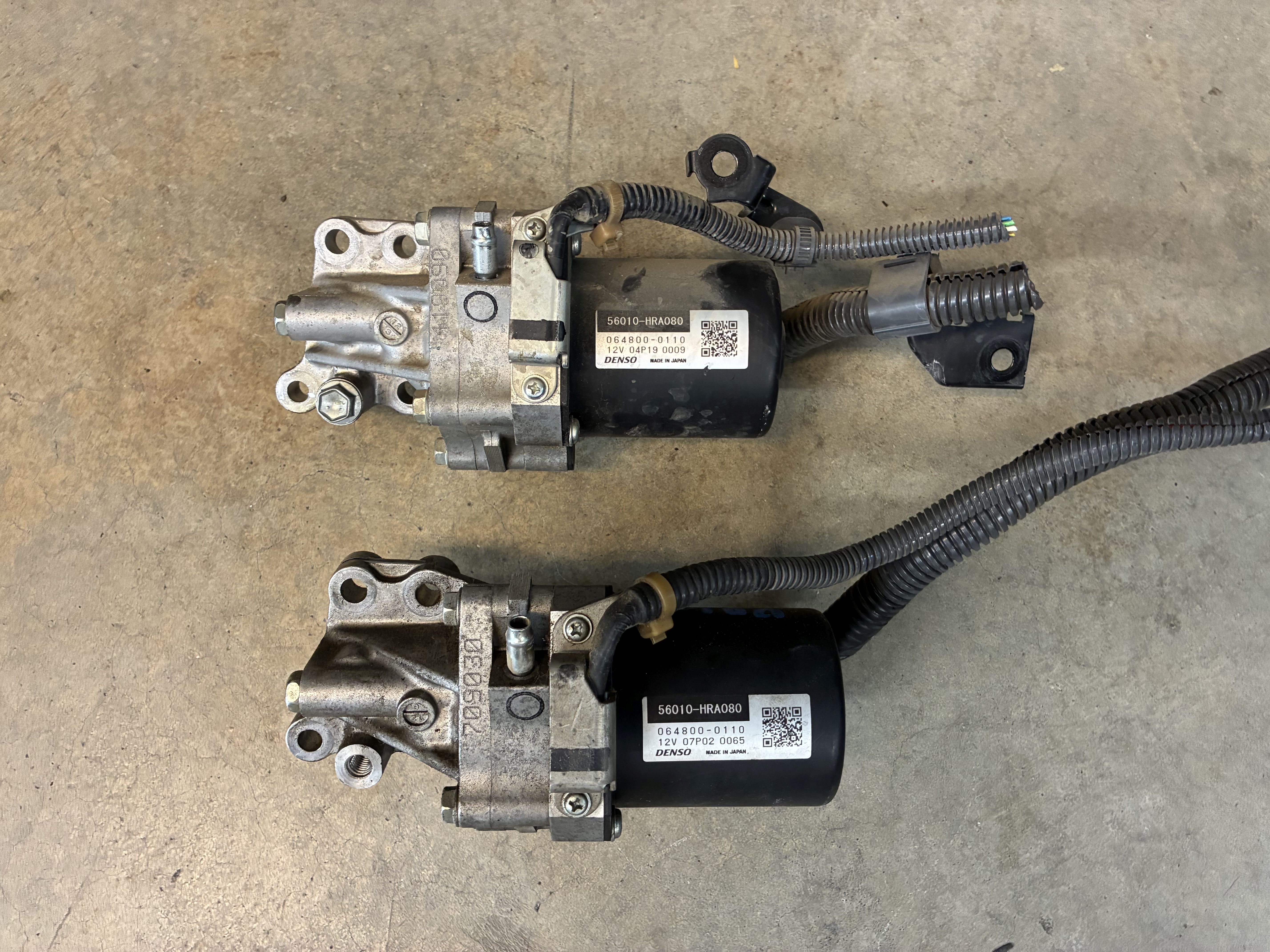

Well, on the clutch plate, I have this one which fits the splines and has a nice solid centre with (I think) 16mm holes that would bolt up nicely to a locking bar. https://www.ebay.co.uk/itm/404811804324Gregski wrote: ↑Wed Mar 12, 2025 12:56 pm QUESTIONS

scored an inverter and wire harness from the Fourth Generation 2013 Toyota Avalon Hybrid (model years: 2013-18) which looks awfully the sameish as the Lexus one, let's hope the inverter plug is interchangeable
looks like somebody already snagged the fuselator
here I am attempting to remove the already severed orange high voltage motor cables (but I end up giving up on removing them as it appears 6 bolts need to be undone and I have a strict 3 bolts or less per component policy, ha ha )
- Gregski
- Posts: 3157
- Has thanked: 628 times
- Been thanked: 1606 times
and here she is all extracted an hour and fifteen minutes later
snagged all the wire harnai
note the handsum carrying handle (hey it's the pants or the inverter, you decide)
I can take apart 92% of all imports with what's in that Pick N Pull tool bag!
and back in the lair
Lexus gearbox tethered to the Lexus inverter, and the Toyota inverter on the floor
so a little progress update, I managed to find a 4th Gen oil pump on eBay ($432) so I snagged it just so that I can have a nice proper uncut OEM oil pump wiring harness to test with
- Gregski
- Posts: 3157
and immediately after allowing it to sit on my garage floor for 6 months I decided to swap it
so out with the circumcised one!
