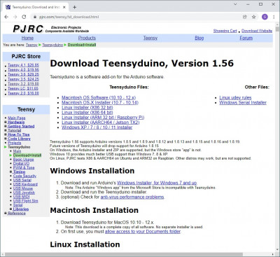

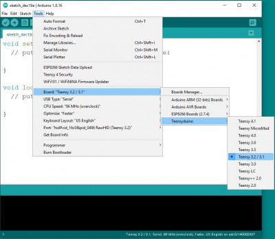

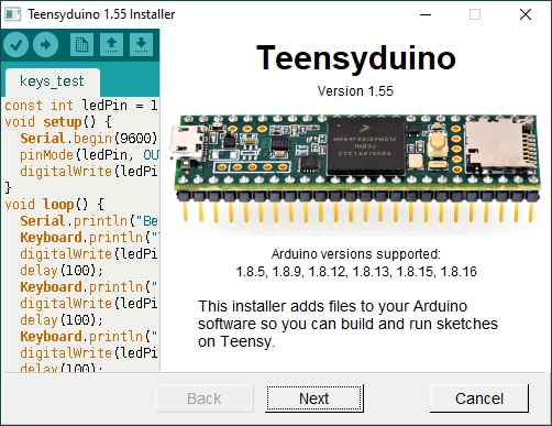

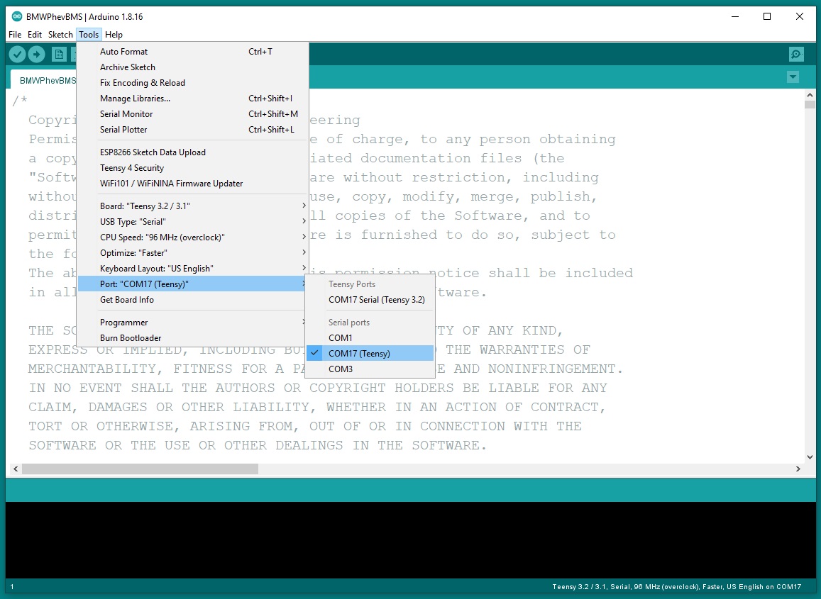

Just a thought, have you got Teensyduino installed? (The Arduino IDE that's been "teensyfied")

mjc506 wrote: Fri Mar 18, 2022 2:15 pm Just a thought, have you got Teensyduino installed? (The Arduino IDE that's been "teensyfied")
yes and got it working with Tom de Bree's SimpBMS

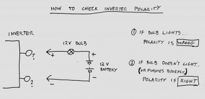

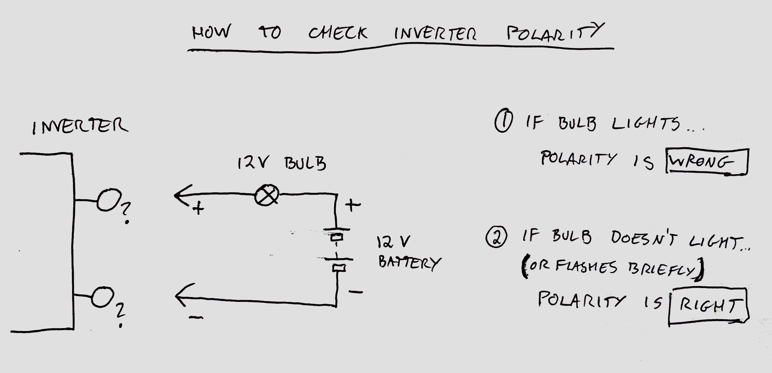

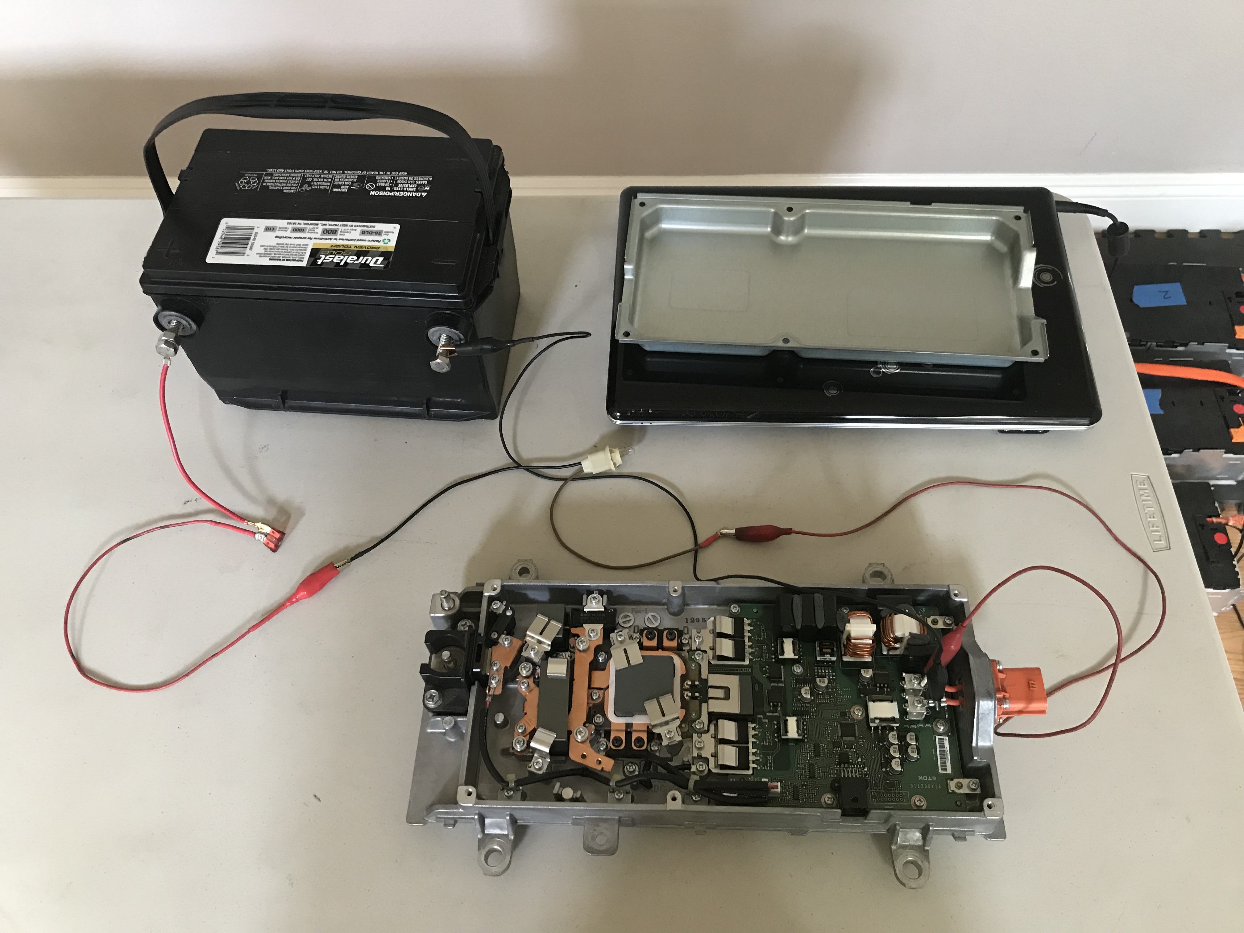

so I've been beating up on the Chevy Volt first gen DC-DC converter in a companion thread called: I think I CAN, I think I CAN... but I want to share some highlights in here as well from what I learned

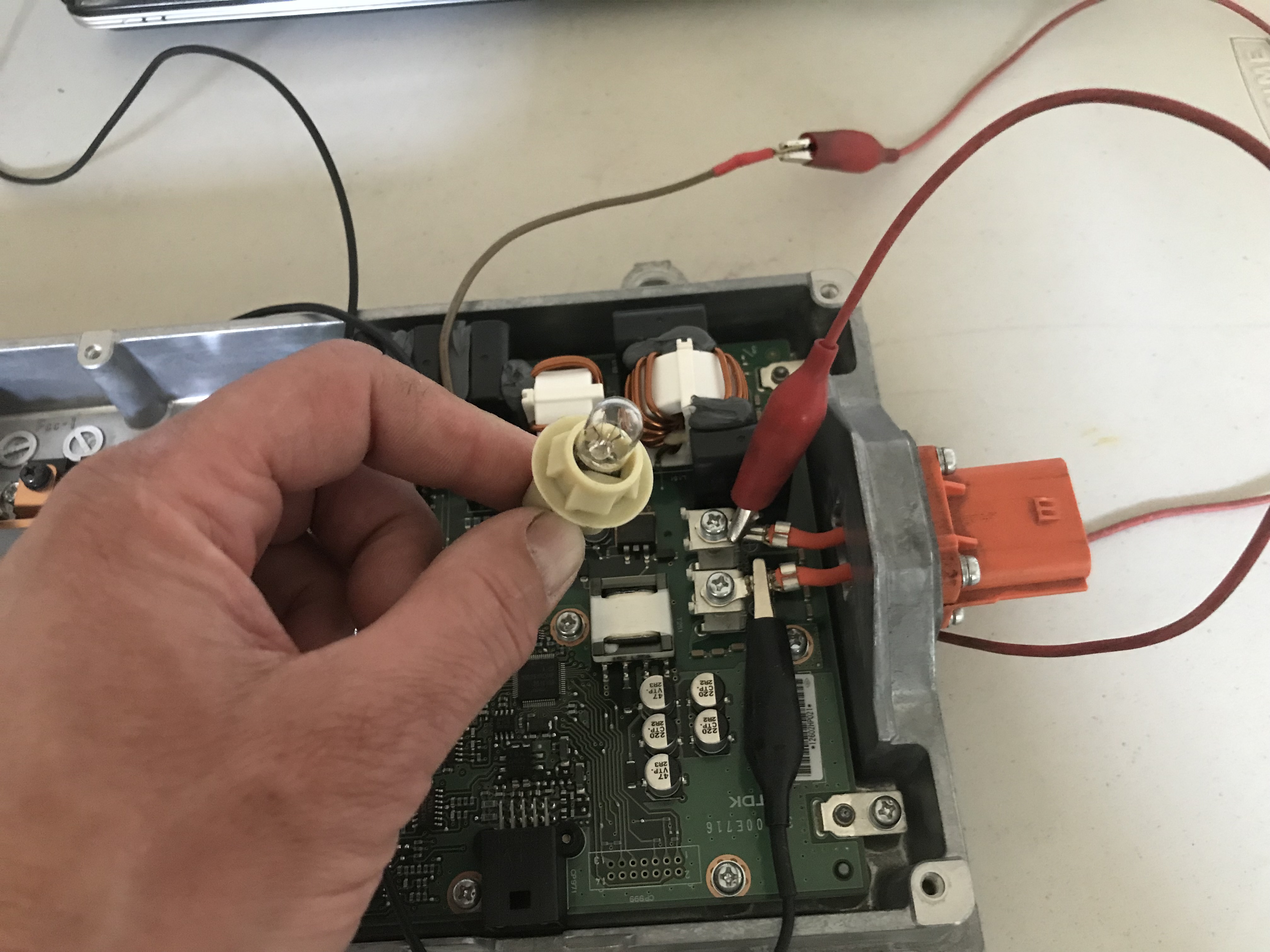

first here is how to check the polarity ie figure out which wire is positive which one is negative
no light so polarity is correct

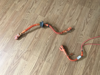

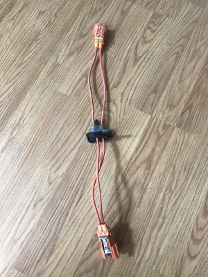

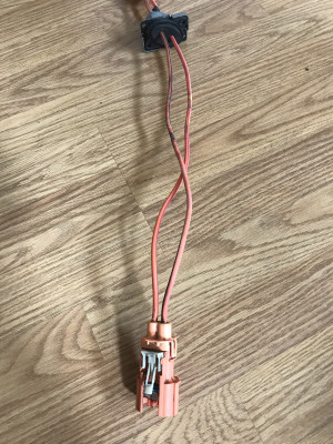

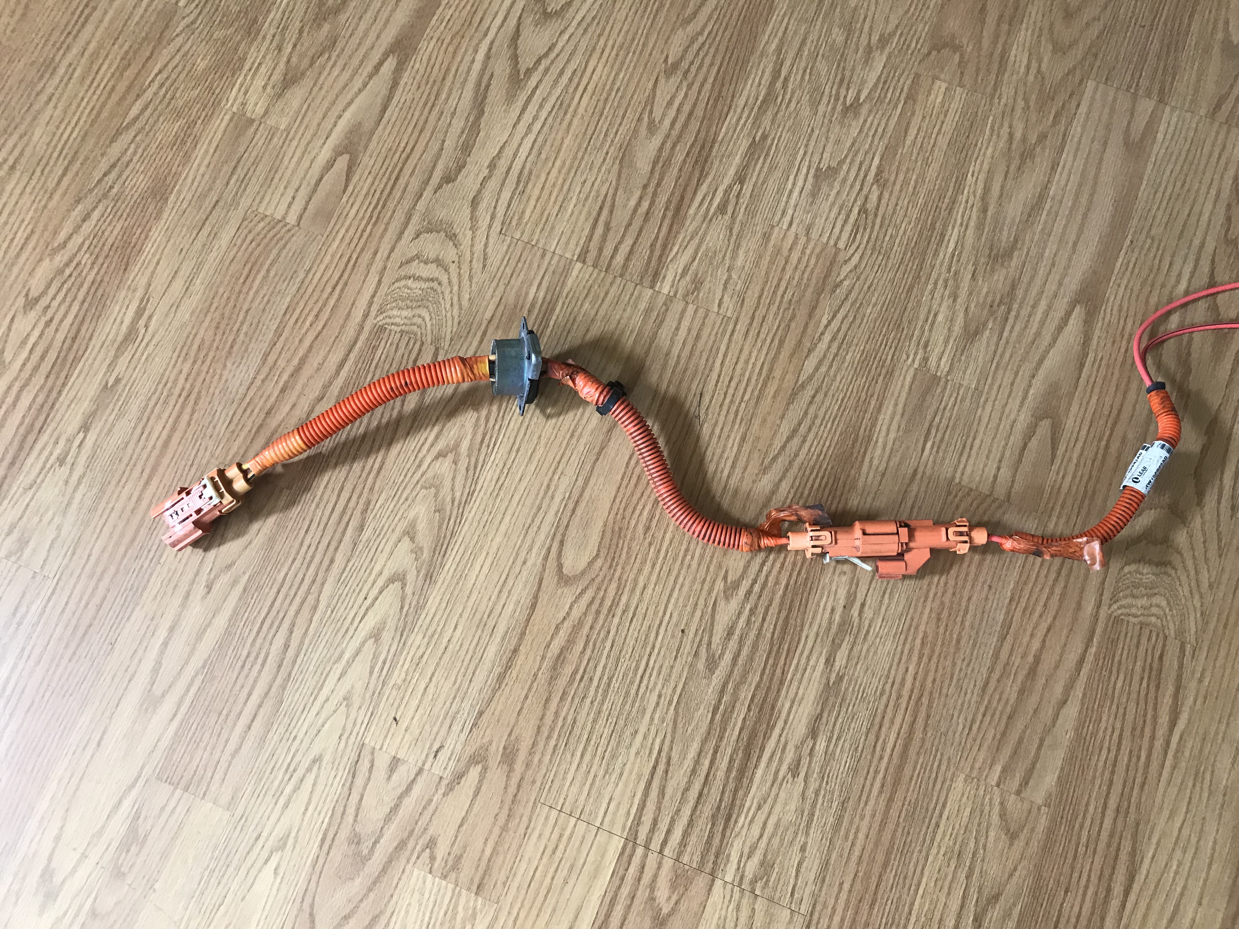

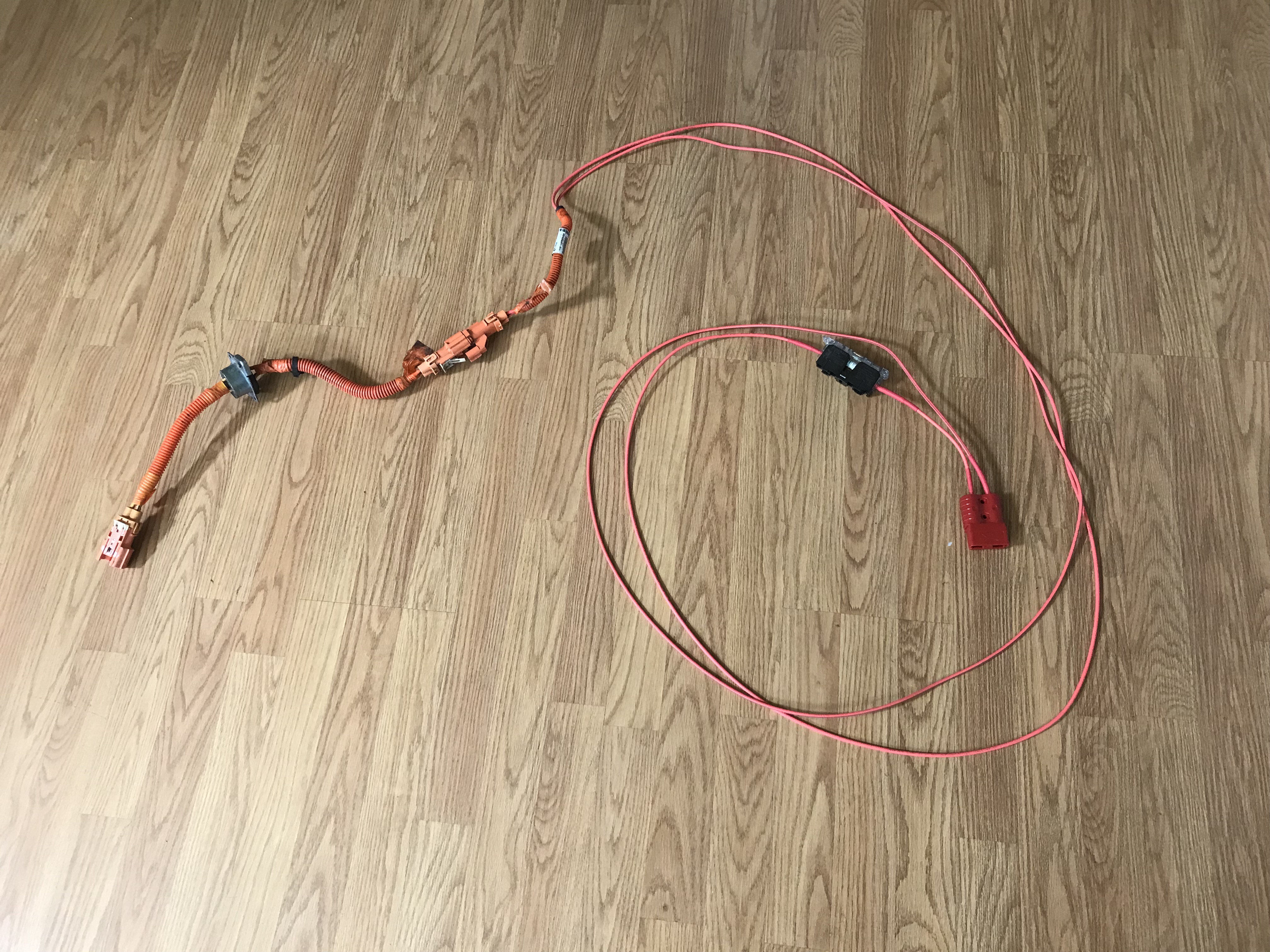

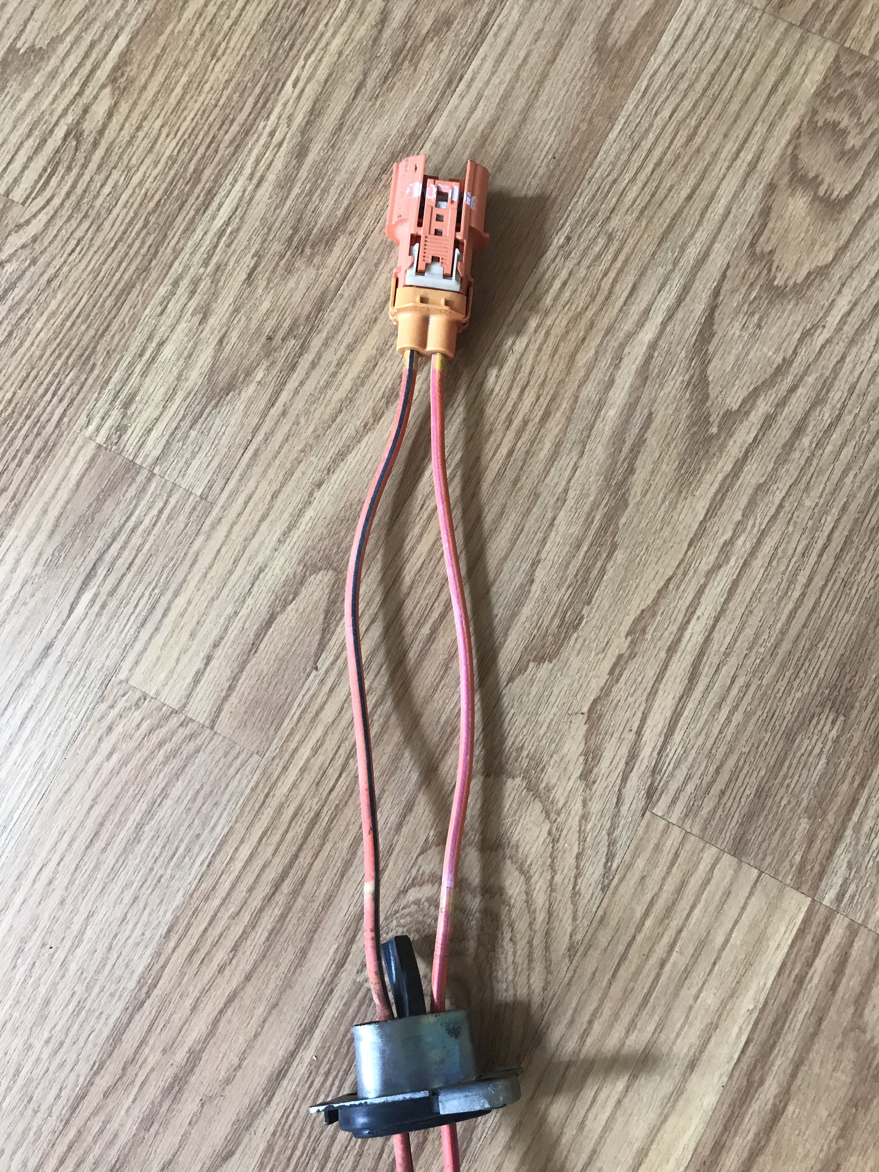

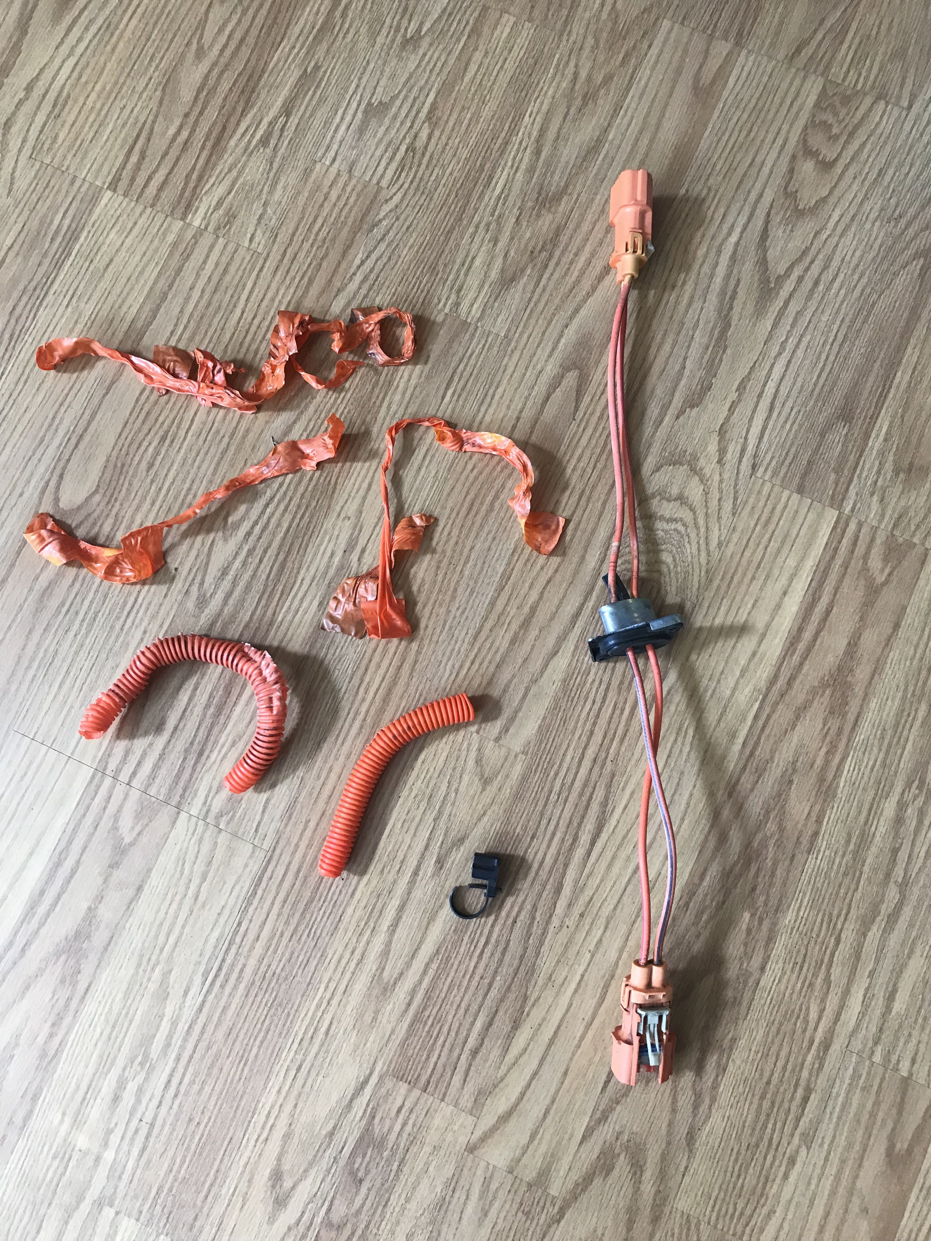

and here is something I learned, GM crossed the wires in the intermediate cable running from the converter to the battery pack
Gregski
Posts: 2743
Has thanked: 500 times
Been thanked: 946 times
Re: I bought a Chevy Volt Gen1 DC-DC Converter - Now What?
Post by Gregski »
here's a close up

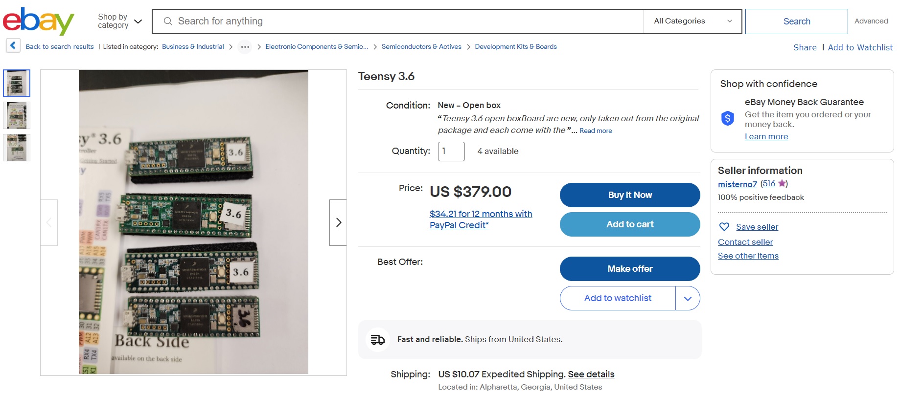

well it's been forever and a day since I played with this stuff, but I am finally ready to hook up the DC DC converter on my truck and was wondering if anyone has gotten it to work with a Teensy in a real world example, and since so much time has passed did they ever come out with a Teensy with a built in CAN Bus transceiver on it for compactability
and I know I have been out of the Teesnyduino game for a minute, but tell me this is wrong and they just forgot a decimal
