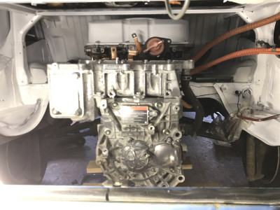

Out with the old, in with the new…
That’s the motor in place with a nice fit on the coupler (ignore yesterday’s panic attack!)
PDM does fit, despite what I thought early on in the build. The challenge is the cables, but they can be adjusted to avoid hitting the inverter. I’ve modified the way they are held by brackets.
One of the tight points is the coolant hose, which isn’t visible but runs from the top right corner of the inverter and is fed from the right hand side of the PDM (im flowing back to front through the PDM in my arrangement). Tight, but ok.
Need to tighten up bolts on the Brat adaptor plates once I’m happy with it all. I also need to create a top box to manage the HV between inverter and PDM now they are separated.
Then the original support bar that held the back of the vw engine goes back, but now with lovely new rubber mounts to replace the decrepit old ones. Then need to create a bracket to go between motor and support bar. Then, then, then….etc.

Re: [WIP] Leaf to VW Type 2 Campervan
I’m confused, the pdm dose not fit? Dose it collide with the shelf?
- ianlighting
- Posts: 173
- Location: Uk
- Has thanked: 152 times
- Been thanked: 59 times
You might have misread. I said is DOES fit. I was clarifying because early on in the build I was not sure there was enough space for the PDM in the fuel tank space once the motor and inverter were mounted aswell. In my disaster bus I ran the PDM from the passenger compartment.
- Bratitude
- Posts: 990
- Location: Canada
- Has thanked: 168 times
- Been thanked: 349 times
Fit on the leaf motor stack? So a full leaf stack will bolt in as is in the back of the bus (with my adapter plate)ianlighting wrote: ↑Sat Mar 15, 2025 7:18 am You might have misread. I said is DOES fit. I was clarifying because early on in the build I was not sure there was enough space for the PDM in the fuel tank space once the motor and inverter were mounted aswell. In my disaster bus I ran the PDM from the passenger compartment.
- ianlighting
- Posts: 173
- Location: Uk
No. That’s not what I’m saying.
The PDM is separate from the inverter/motor.
The PDM physically fits into the fuel tank space. It is orientated 90deg to normal.
But the height of the top of the inverter, when mounted with the motor, using your adaptor plates is very close.
The closeness is not due to the PDM ‘box’ itself, but there’s a potential for the cables that exit the PDM to clash with the top edge of the inverter.
Early on in my build I’d commented about this. The post yesterday was confirming my plan is possible.
But it requires some ‘tweaking’. All the cables still exit from the PDM standard locations, but I have adjusted the Nissan brackets and cable management to make them avoid the inverter with the way I’ve arranged it.
I’ll do a side photo soon, maybe later that should clarify.

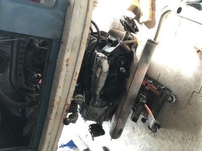

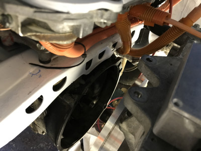

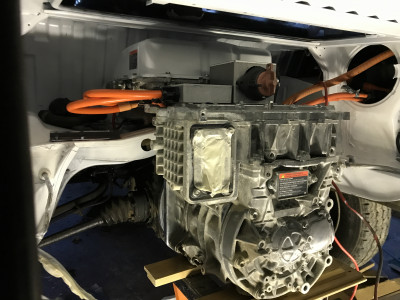

Some more images to better explain what’s what…
(Still WIP, some loose ends)
Slight side angle. Shows the PDM sat on the shelf where the fuel tank was. Top view through the engine hatch that later T2s have…
Photos above are with motor mounted to vw transmission, and all is fine. But this next one shows how close it is with a small gap before final mounting…
I’ll do more down below images once things are a bit tidier, but here’s one from the right hand side. Bottom 2 cables are heading off to the battery. Top 3 are the AC and DC charge cables. (Enlarge image if it’s showing the wrong way round)
Last one. Is it just me, or does this beasty look a bit ominous?
but dose the pdm fit on top in it original position on top of the inverter regardless of cables?
also why is your hv disconnect ontop of the motor?
- ianlighting
- Posts: 173
- Location: Uk
No the PDM does not fit on top of the inverter. If that was possible I wouldn’t have been doing all this juggling. The only way that I could come up with is what I’ve shown. By being placed in the fuel tank space it is actually slightly lower than if it was on top of the inverter.
The main service disconnect is still mid way in the battery pack. But it’s about as accessible as it is in a Leaf - not easy to get to in a hurry. In the event of a problem, I want something easy for me or emergency workers to break the circuit. That switch breaks the HV on the way to the battery from the PDM.
