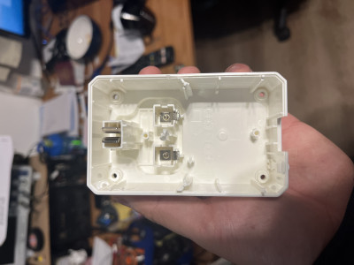

Sorry for asking very basics questions, have been reading up on the GitHub repo about modifying the modem.
Currently i have got a TP-Link PA4010P v5.0 (UK plug), the live and neutral pin on the PCB seems to be injection moulded into the plastic housing, preventing me from disassembling it.
I see from the pictures from the repo the mains part has been removed, was it just cut off from the PCB with a dremel? I'm worried the layers of PCB would short together and interfere with the communication and wanting to know how you modified it.
Thanks a lot in advance.
- uhi22
- Posts: 1116
- Has thanked: 204 times
- Been thanked: 611 times
Re: charging station / wallbox hardware basics
Could you share a photo of this situation? I would assume cutting the PCB is not necessary. Either desoldering the connection from the PCB, or cutting the metal beside the PCB with a dremel should be fine.
[Edit] If your PCB is the same as here: https://github.com/uhi22/pyPLC/blob/mas ... a4010p-v50 it is safe to cut the PCB with a dremel, too, at the same positions to not destroy too much.

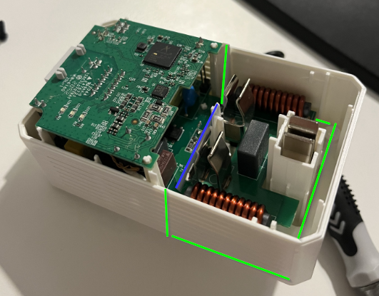

- Posts: 596
- Has thanked: 213 times
- Been thanked: 173 times
They assembled it somehow. It doesn't look like a mold in place situation from the picture at all.
The shrouded one needs better pictures. They connected it / trapped it in there somehow. It's it soldered?
Maybe a small torch to heat the terminal from the top to melt the solder of it is?

- uhi22
- Posts: 1116
If you do not need the plastic housing anymore, just dremel it away (e.g. at the green lines), maybe this reveals some snap-in thingies below the PCB.
If nothing helps, you can dremel the housing and PCB on the blue line.

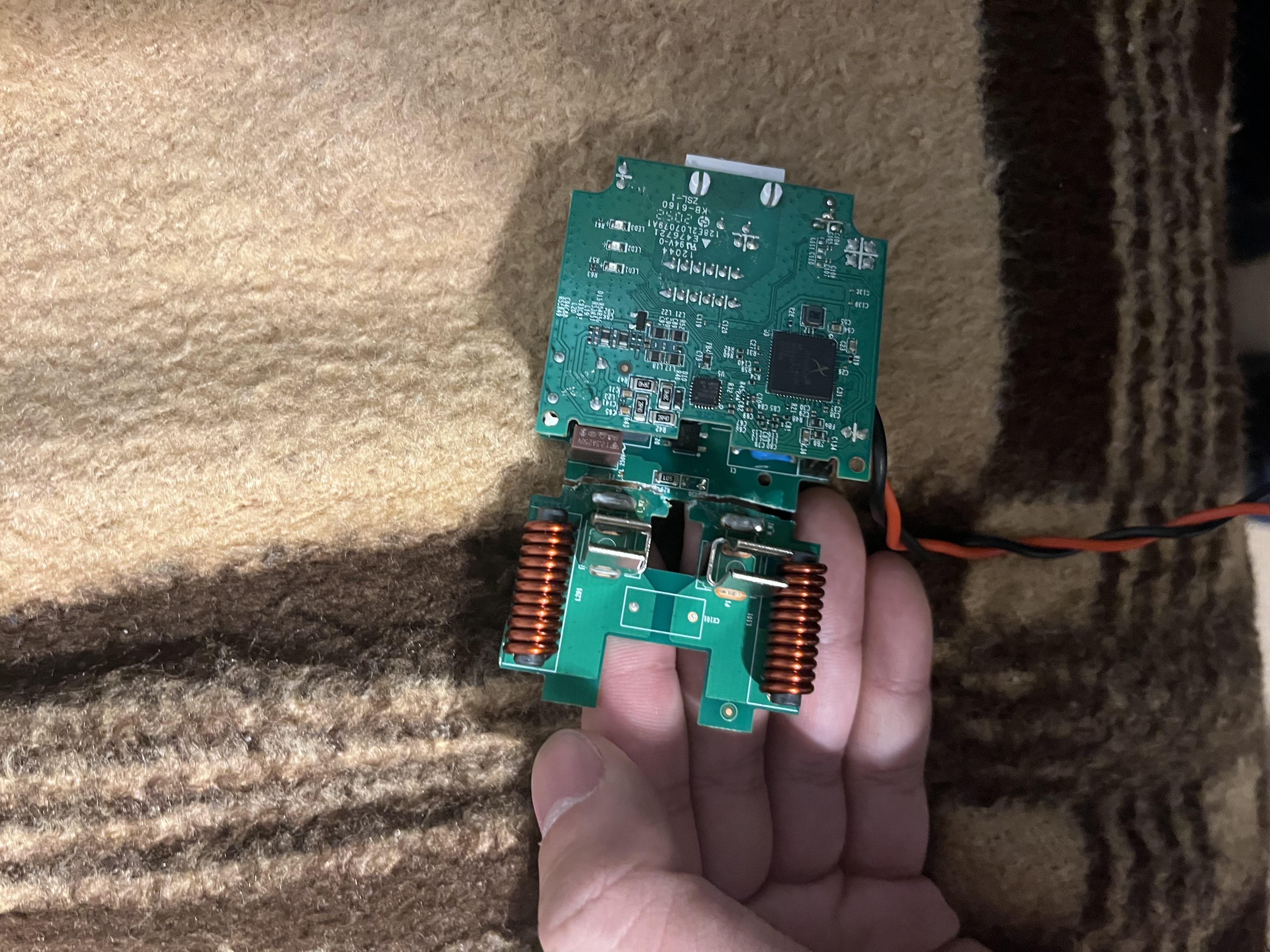

- Posts: 11
- Joined: Sun Dec 29, 2024 6:38 pm
- Has thanked: 2 times
- Been thanked: 3 times
To provide an update on how to disassemble the UK version of the PA4010P, desolder the two solder join below the live and neutral connection. The bottom socket is injection molded into the bottom case, the solder joint connects it to the PCB.

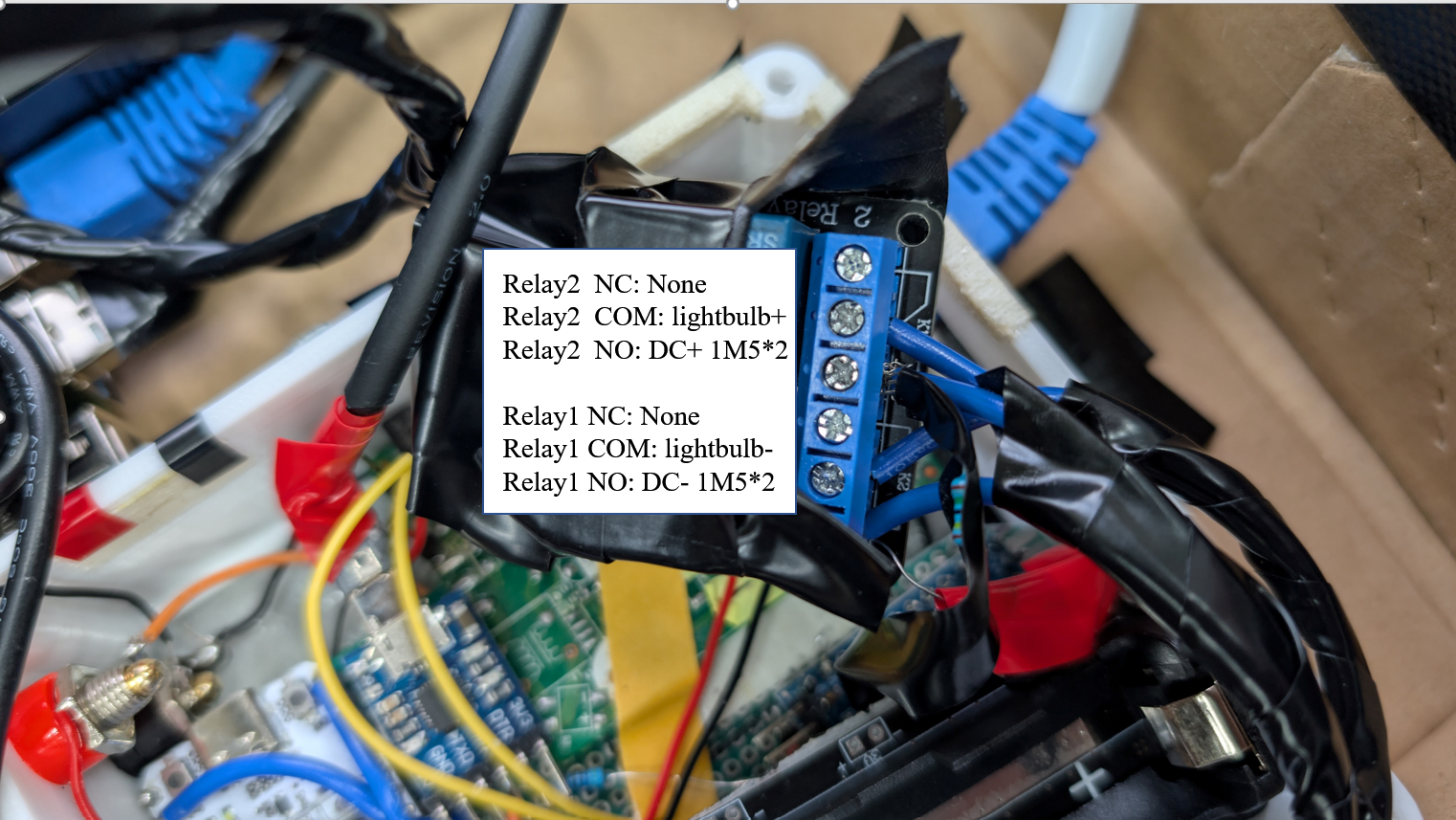

Hello, I am now building the miniPEV to perform normal PEV charging. After I try 2 different charging stations. It always stops at cable check. EVSE send back a cable check response with failed. Check below for log.
At the same time, the multimeter shows an 8.87V. I think is the resistor that I use NPN (BC547) to switch is not working. What do you use to switch/attach the resistor?
And After I attach a diode to it. Its resistor become 0.372M. Is it normal?
Thanks for the time.
Circuit: Log:
Circuit: Log:
Thank you for helping.
As I this is finally resolved. When I plugged into CCS1. It still shows an error when cable checks. Is it because the isolation check failed? How do you wire your 2 relay drivers? Mine is like this.
Relay1 NC: None
Relay1 COM: lightbulb-
Relay1 NO: DC- 1M5*2
Relay2 NC: None
Relay2 COM: lightbulb+
Relay2 NO: DC+ 1M5*2 LOGs:
Today, I finally let NPN start working. It turns out that when I removed the 10k resistor between LV's pin 12 and BC547's base pin, it just worked. Would that be normal, or does it need to be running with 10k resistor to behave normally?
Relay1 NC: None
Relay2 NC: None
