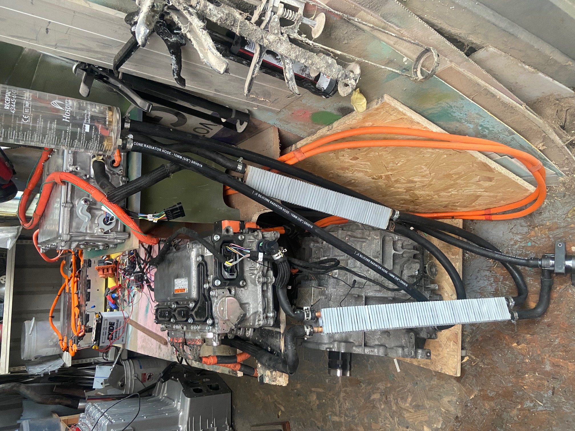

Hi, in my shed is;
ZombieVerter VCU, software V2.15A running the following;
Toyota Prius gen 3 drive train and inverter
Mitsubishi Outlander onboard charger and DC/DC converter
BMW hybrid 330e 7.6 kWh gen 1 battery pack
Toyota Yaris accelerator pedal
Tesla model S water pump connected to skirting board radiators

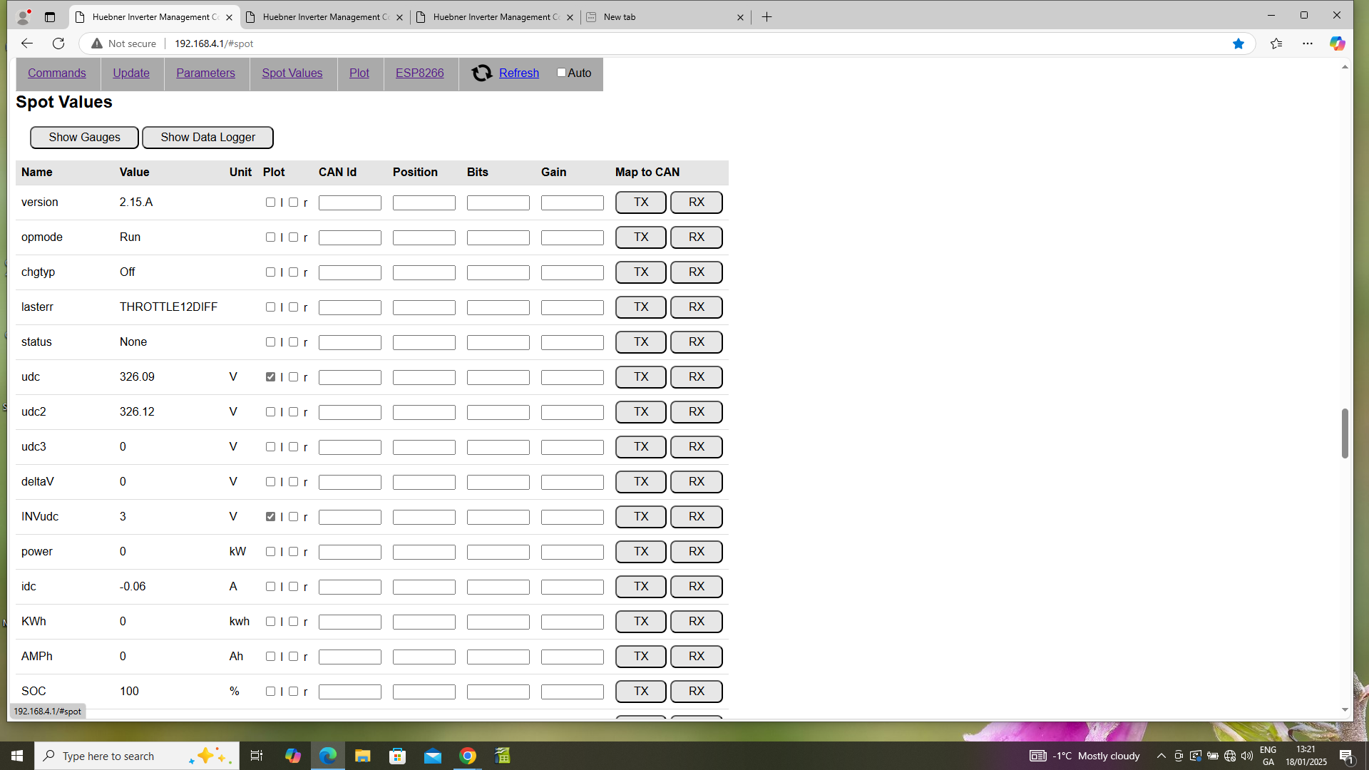

Logs (speed, torque). Spot values screenshot. Params attached
Possible to unlock power/torque of the Prius gen 3 drive train?

So at the moment there seems to be a firmware limited power limit on using MG2 only. As found in testing by greg viewtopic.php?p=73007#p73007 with the support of myself.
Your speed limit is likely due to the revlim of 6000, please raise this to 8000 and see if it will reach that.

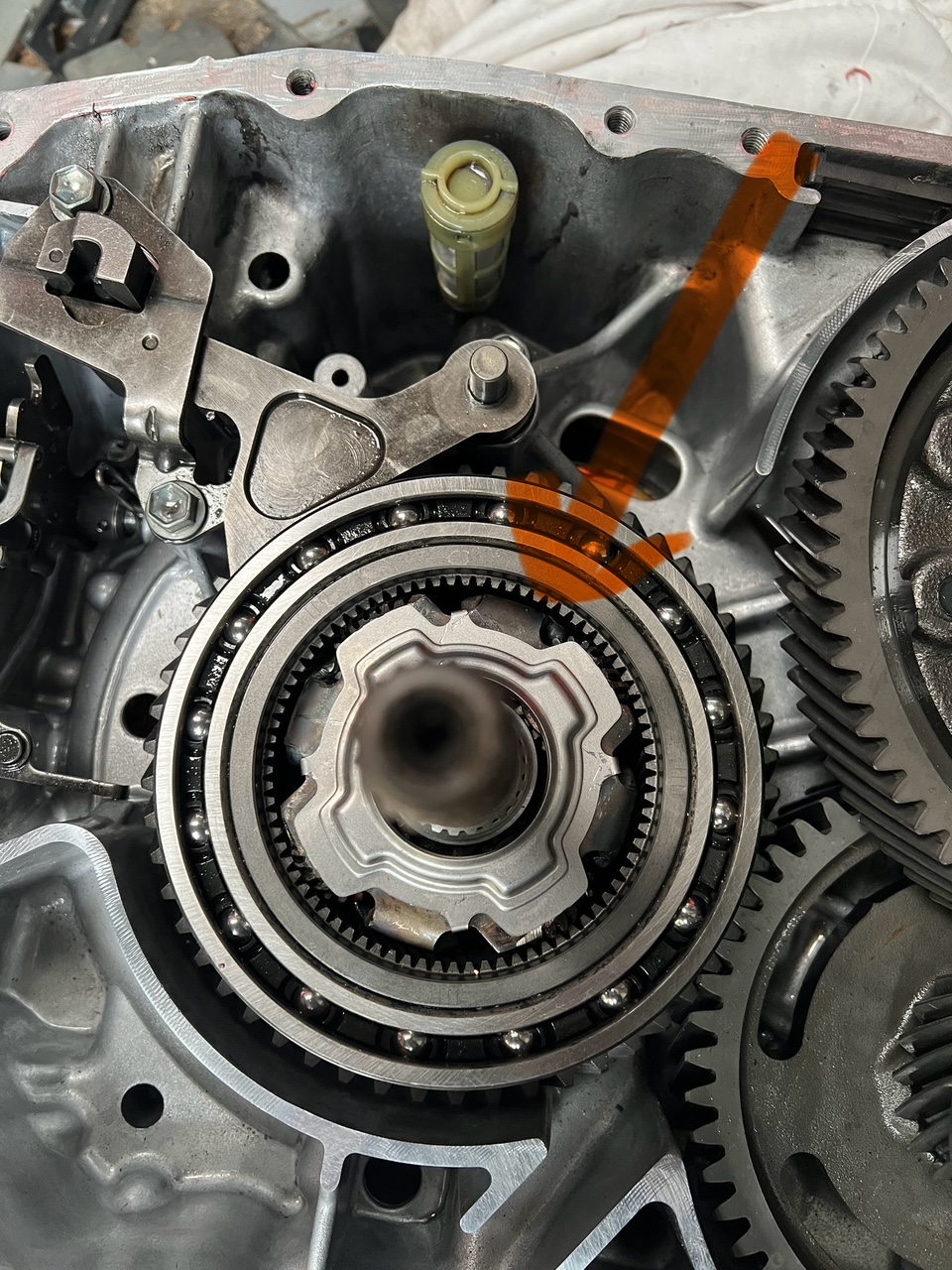

I would strongly recommend welding the power split and seeing what changes, since there can be a limit due to only sending torque requests for 1 motor.

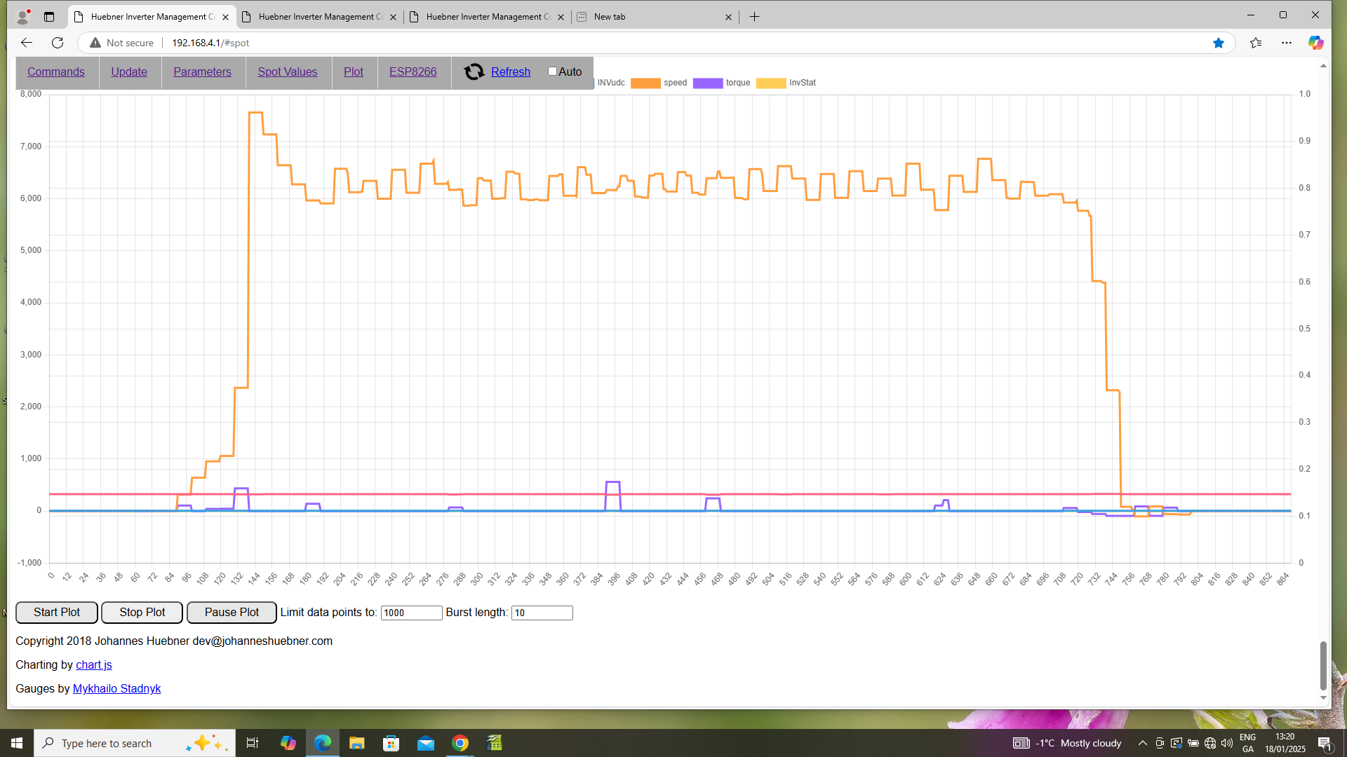

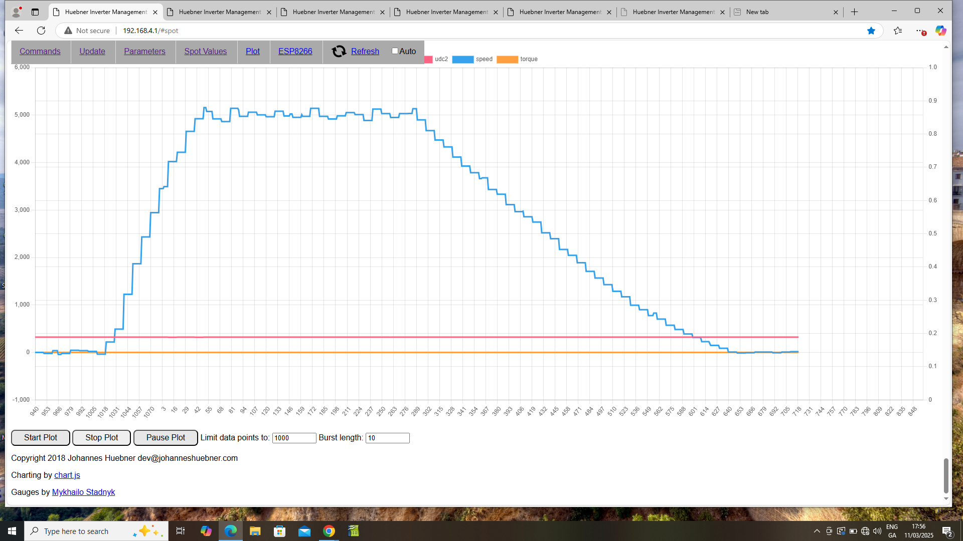

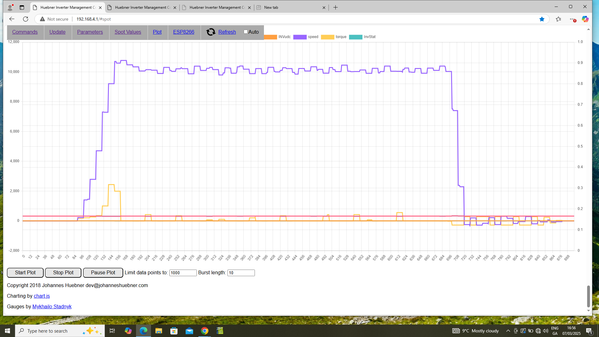

Re: Unlocking the power/torque of Prius gen 3 drive train?

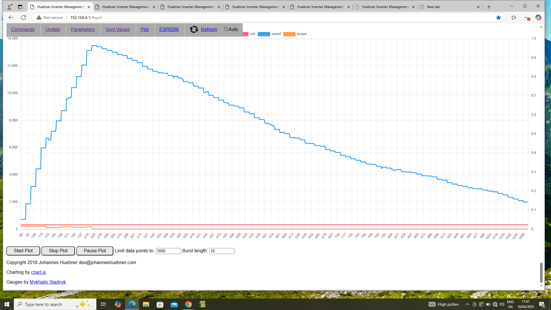

Set revlim to 8000...see log
set revlim to 10000...see log
- Posts: 2962
- Has thanked: 328 times
- Been thanked: 847 times
So this is not the limit right now. Best get this into a vehicle with a welded PSD and then start tweaking things.

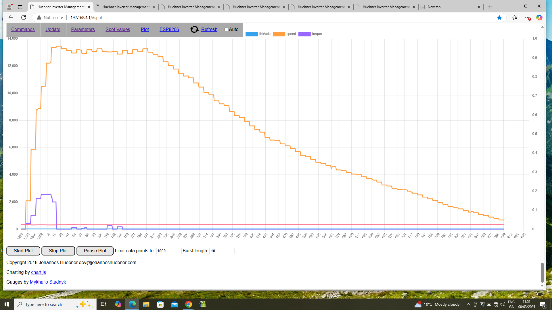

Just had to chance my arm with a revlim 13000 run before the teardown!
REVLIM 13000.ods- (14.32 KiB) Downloaded 481 times

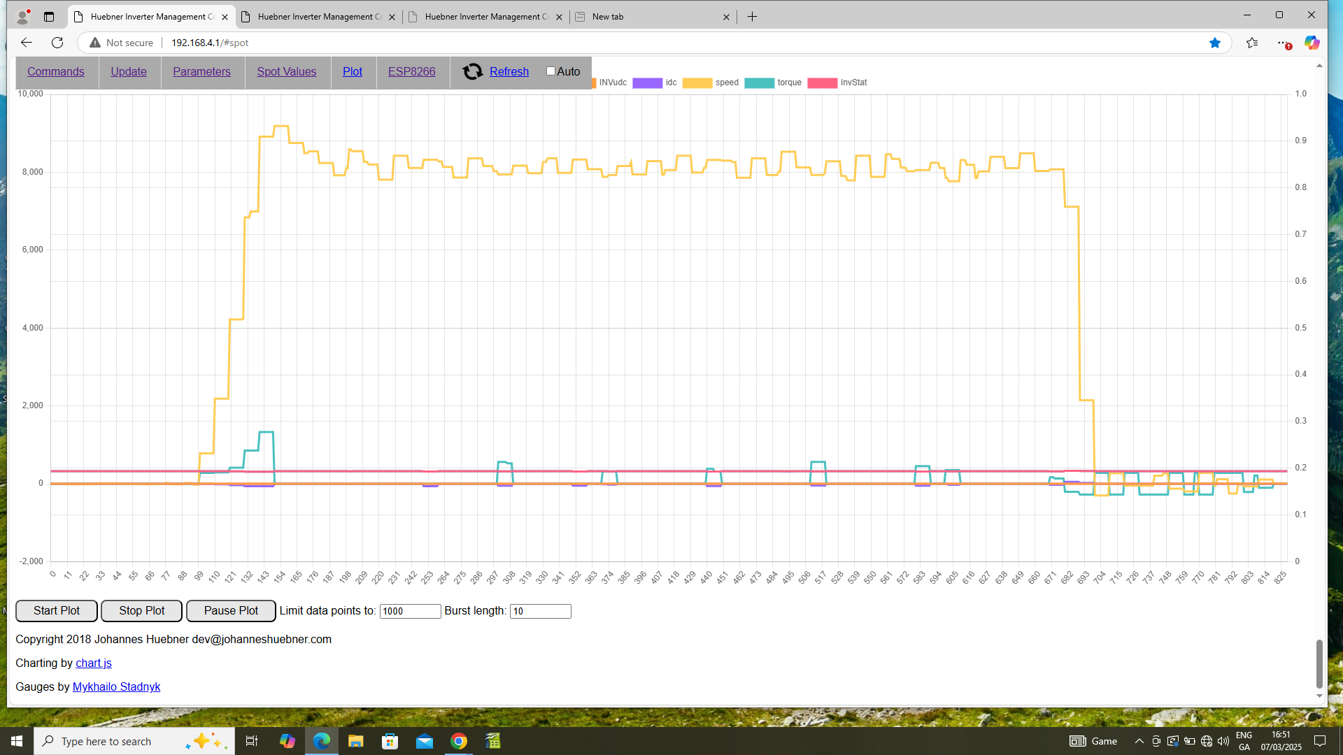

Have just welded the Prius Power split device and reassembled.
Did a quick test using MG2 only with revlim set to 13000
Is there anything else I can do?

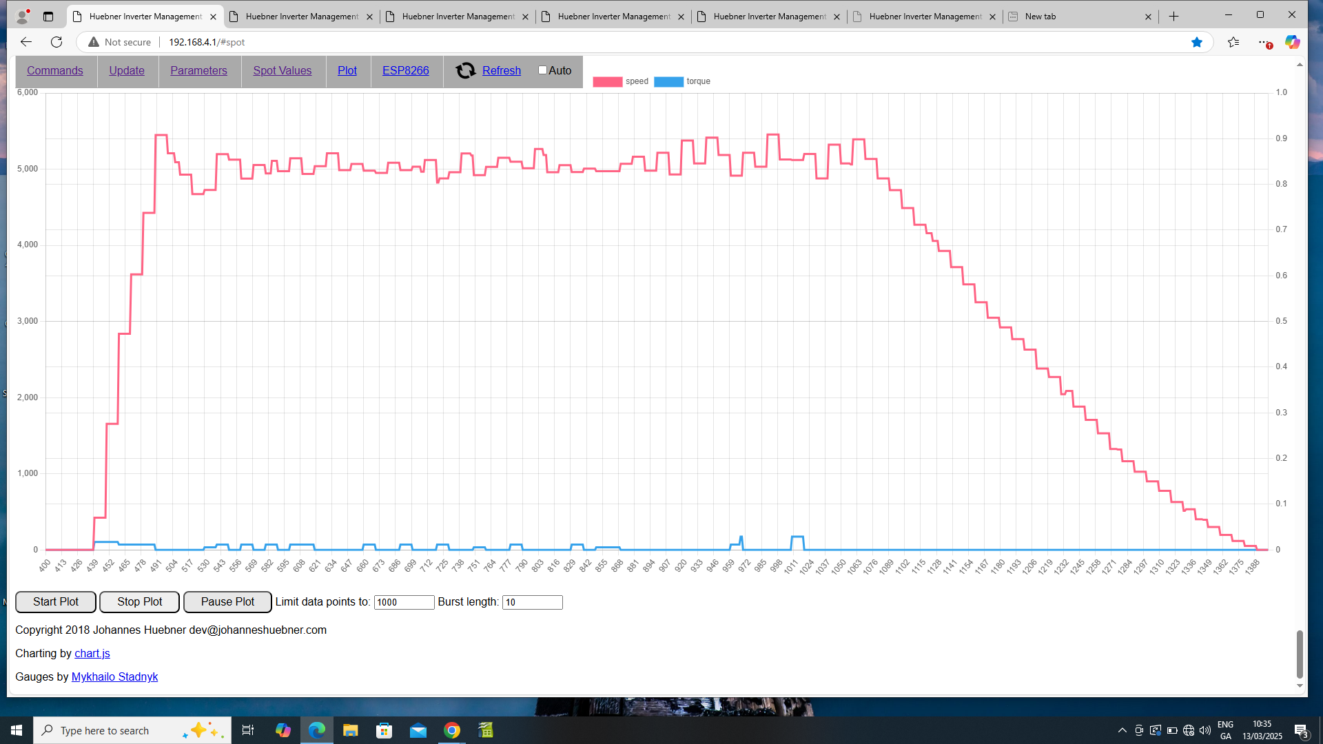

Oil in and MG1 running on revlim5000 no unusual noises.
Runs forward and reverse with output shaft matching.

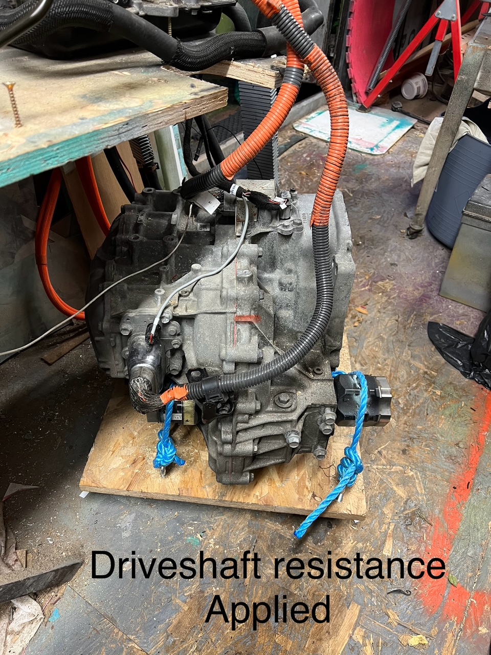

I have a crude resistance rope setup on each drive hub that I could use to increase the load.
Any point in trying MG1 & MG2 together for a spin?
I am currently fabricating the drivetrain mounts to fit on the Ghia pan.
No the limit Greg's rabit hit was 20kW, this is not something to simply absorb in a "DIY" setup.

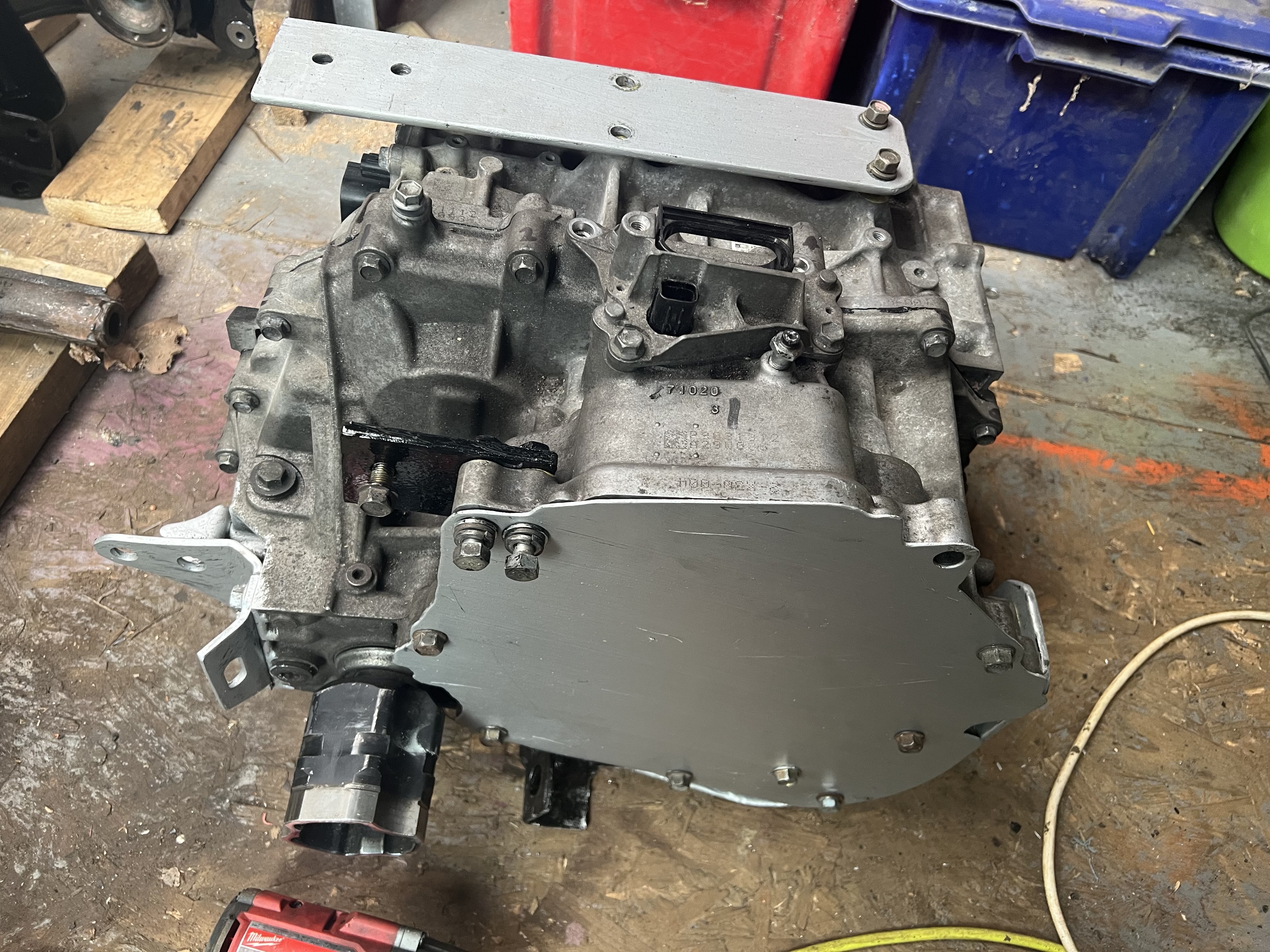

The mounts are sorted on my test chassis so now to the next challenge…the driveshafts!

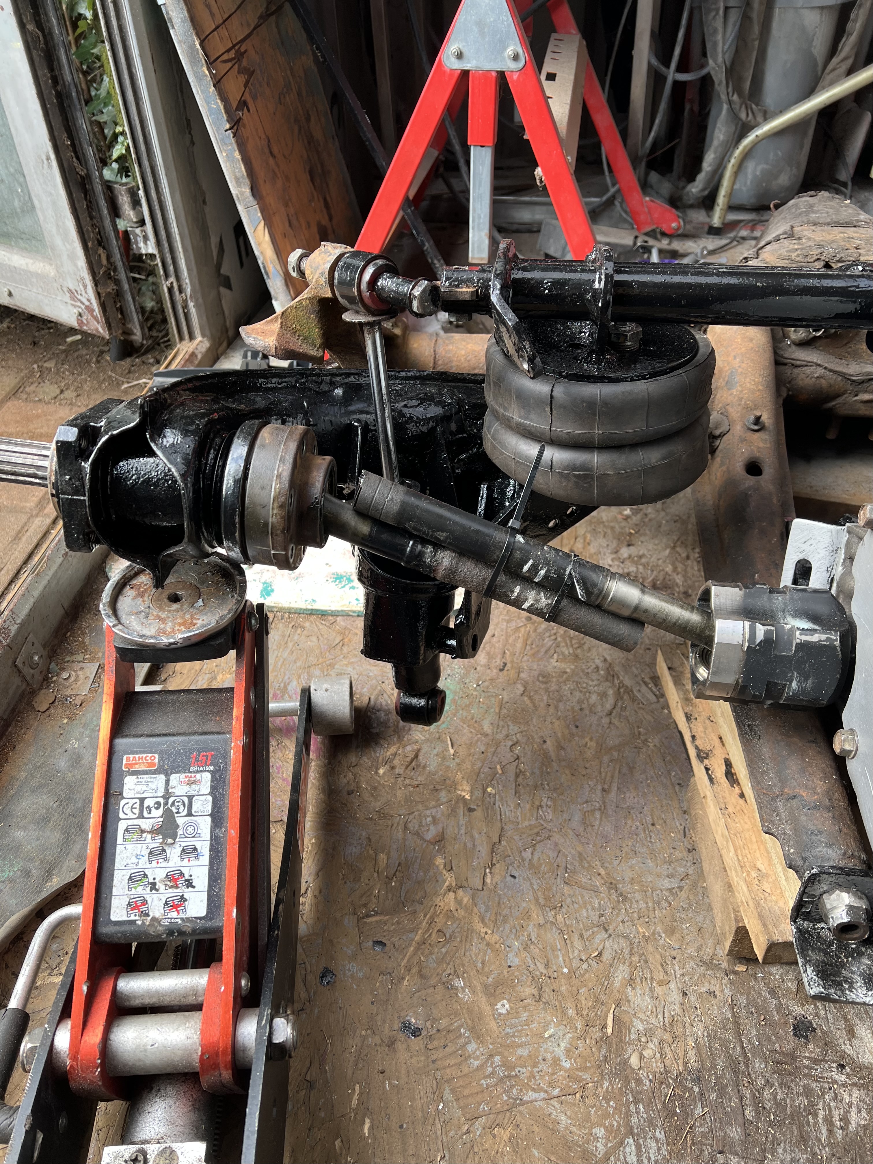

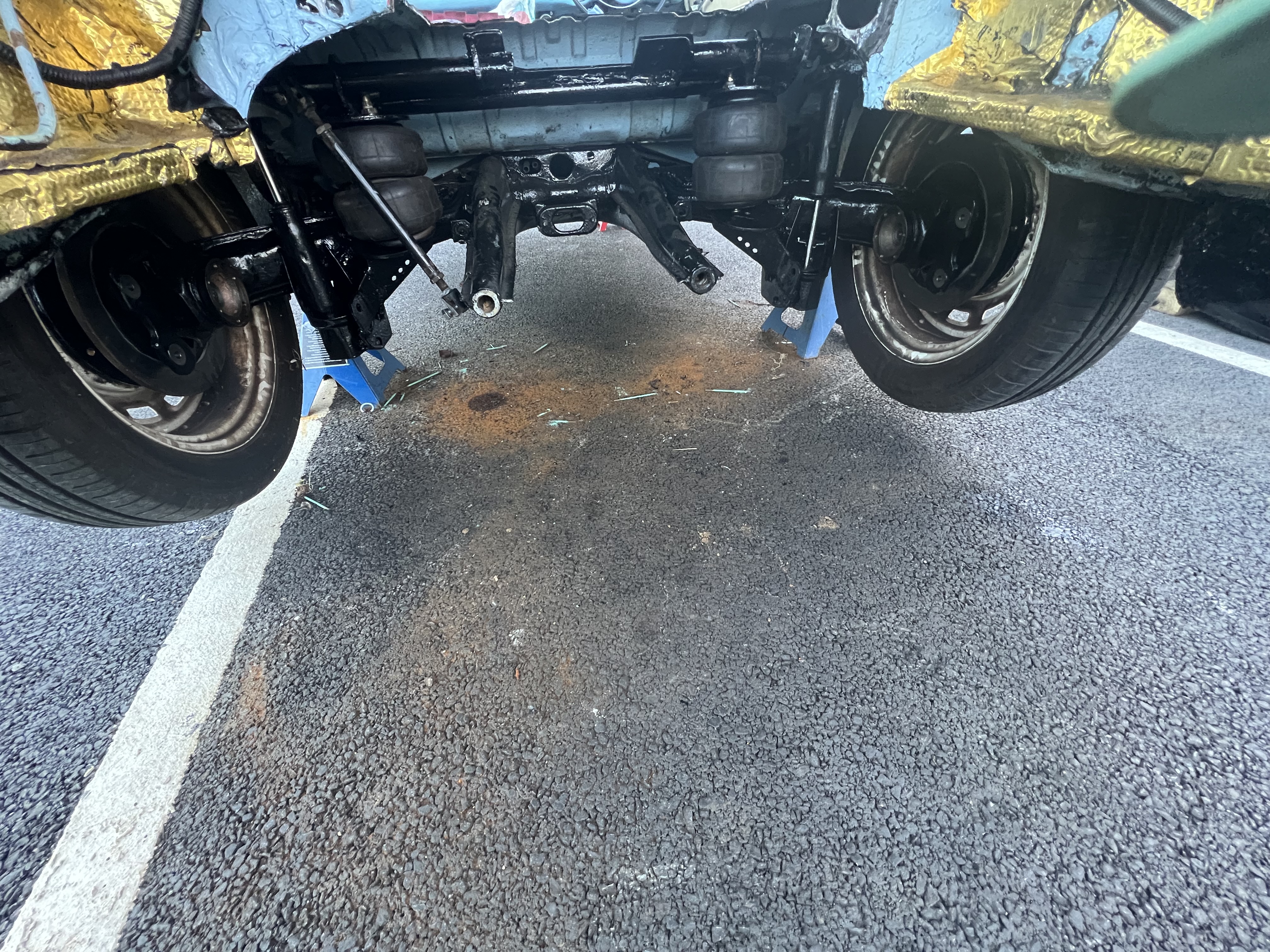

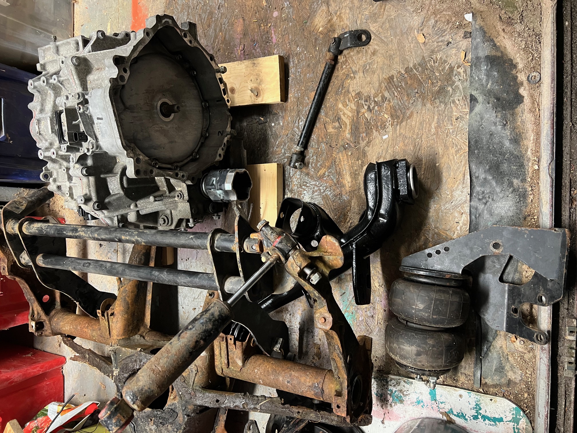

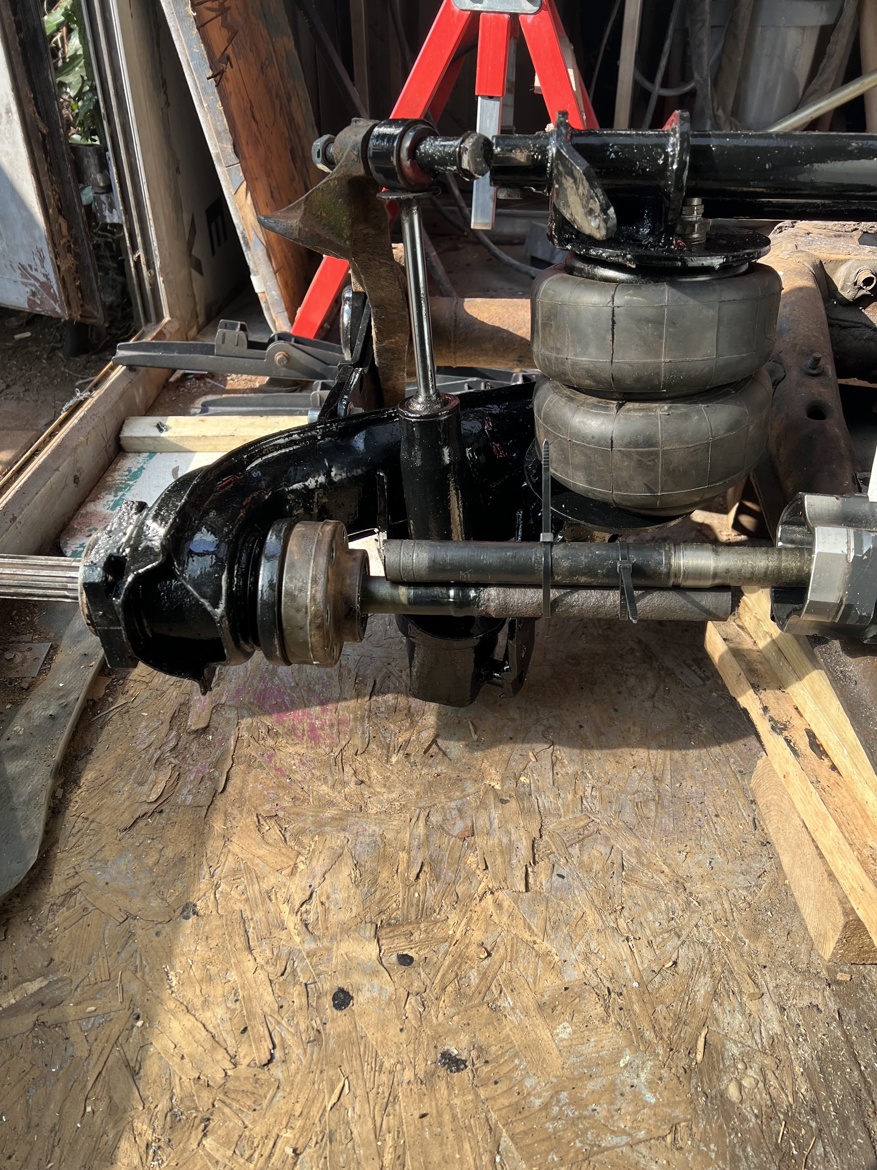

New Independent rear suspension and air bags are in
Engine mounts fitted to drive train
Drive shafts measured and sent off to the machine shop
Planning locations

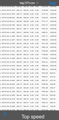

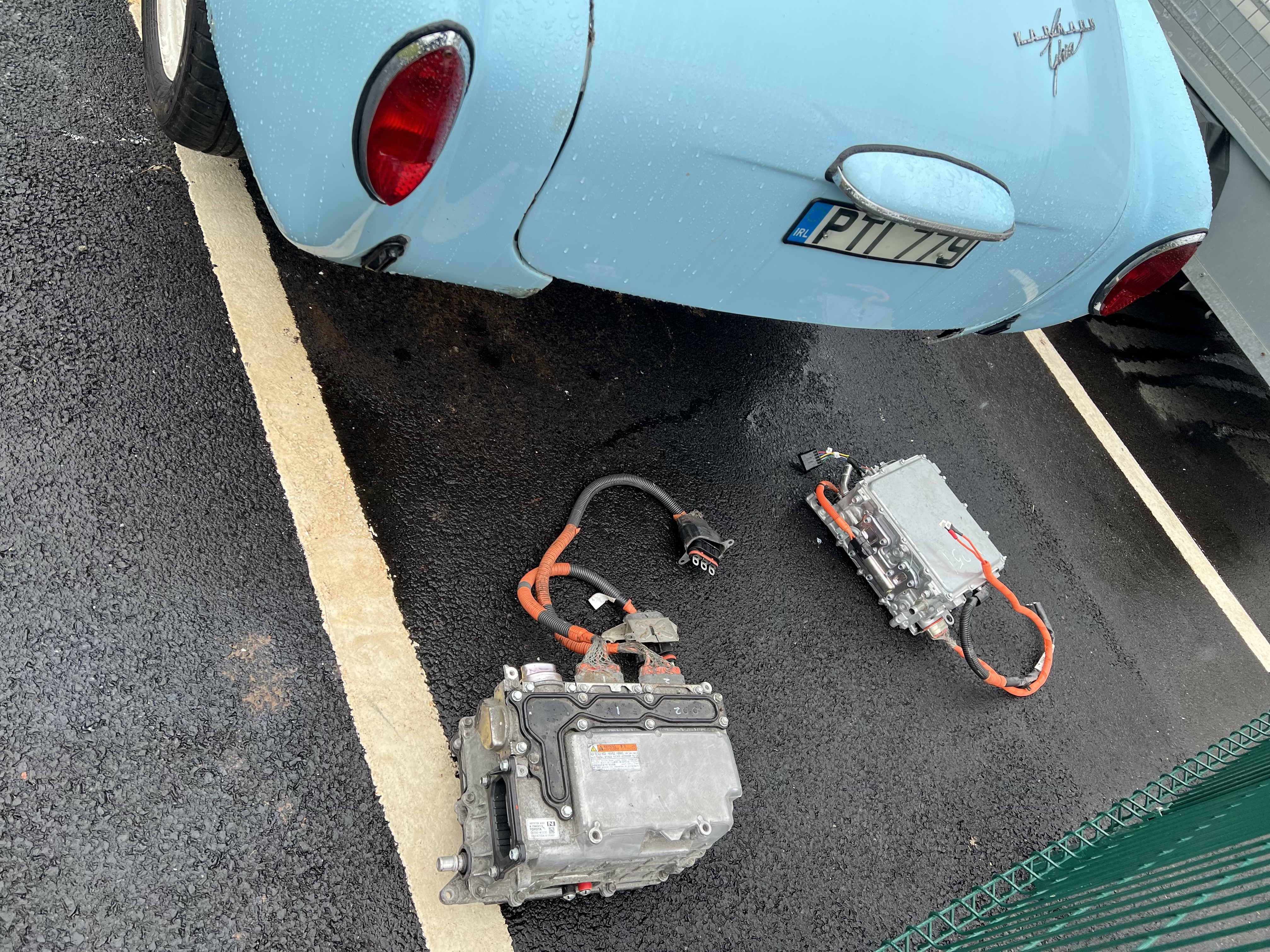

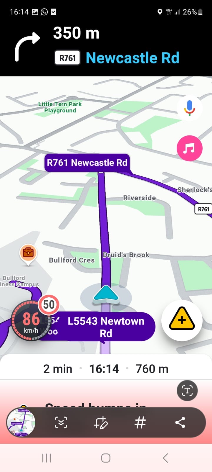

So I hit 86 kph on my third test run in the Karmann Ghia.
I reckon it will go faster when I have enough open road and have corrected the massive toe in on the rear wheels…so maybe the 52 mph Rabbit limit will be broken
Toyota Prius gen 3 motor and inverter welded power split device
BMW hybrid 530e 12kWh gen2 battery pack
BMW Safety box
What do I need to try now?
BMW Safety box
- Posts: 2962
Can you get a log showing, speed? A log showing udc and idc would be useful too so see how much power she draws.
Be good to go out to a strech of road where you can do 60mph and see how fast it goes.
How does the acceleration feel?

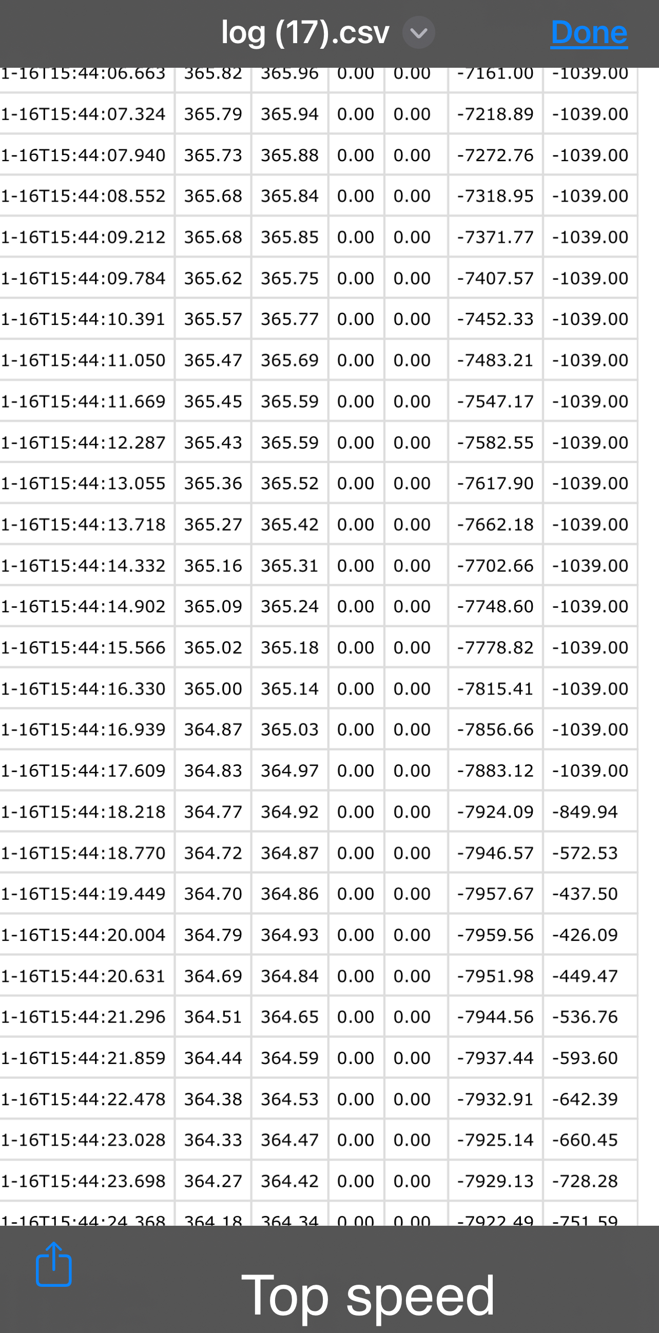

Whet for a test run in the Ghia and reached 103kph (64mph) but no faster. So the 52mph barrier has been passed!
It drives smoothly but the throttle needs to be pushed down a long way to get really motoring.
It spun up to 7959 rpm should I do a test run with revlim set to 13000 now?
Any suggestions would be most appreciated.
- Posts: 2962
Can you please next time add
"idc" and "potnom" instead or "KWh" or "AMPh"
Please post your params.

Thanks Tom, will do.
Worth trying 13000 rev lim?
