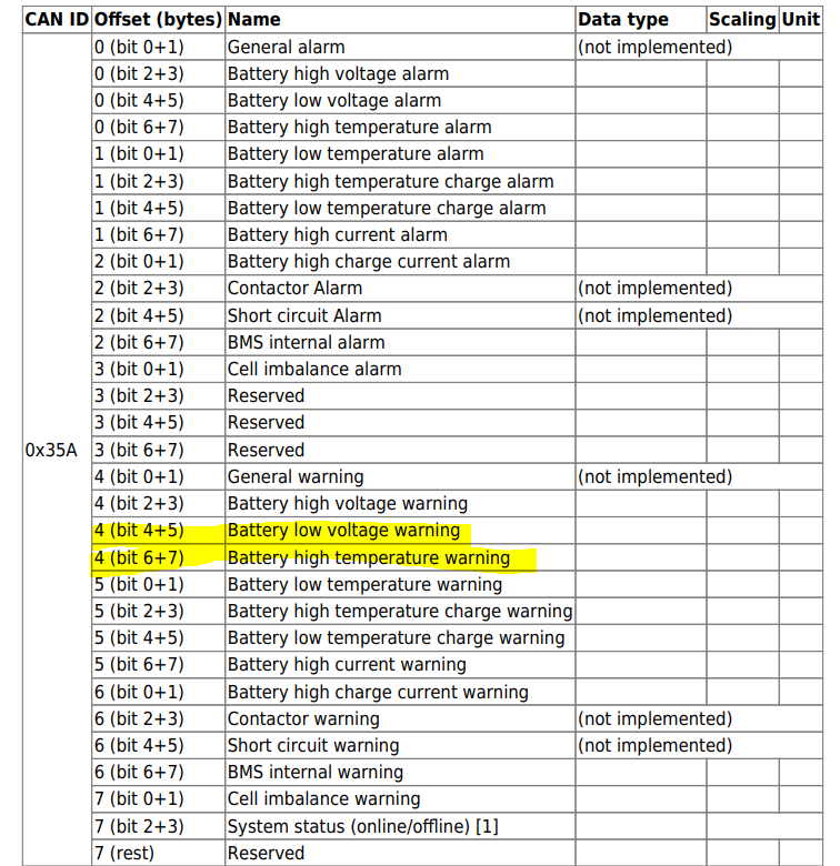

I'm interpreting CANbus data from my SimpBMS. The manual says that 0x35A Warning should send these Datas:
But in the TESLABMSV2.ino project I found a more complex definition, that maybe is related to a Victron system I didn't use:
msg.id = 0x35A;
msg.len = 8;
msg.buf[0] = alarm[0];//High temp Low Voltage | High Voltage
msg.buf[1] = alarm[1]; // High Discharge Current | Low Temperature
msg.buf[2] = alarm[2]; //Internal Failure | High Charge current
msg.buf[3] = alarm[3];// Cell Imbalance
msg.buf[4] = warning[0];//High temp Low Voltage | High Voltage
msg.buf[5] = warning[1];// High Discharge Current | Low Temperature
msg.buf[6] = warning[2];//Internal Failure | High Charge current
msg.buf[7] = warning[3];// Cell Imbalance
Can0.write(msg);
What do I want to do? My Controller expects a LIMIT signal to reduce the output of the system if the BMS signals it has to reduce the discharge output.
My interpretation is that 'Undervoltage' and 'Overtemp' would be the correct Warning Signals to introduce a LIMIT mode of my motor controller. The difference between manual (0.29) and Code TESLABMSV2.ino makes me wonder if I'm correct. Can you answer this, please?

X19e wrote: Tue Feb 25, 2025 9:53 am My interpretation is that 'Undervoltage' and 'Overtemp' would be the correct Warning Signals
Yes if you use the warning ones and not the alarm ones.
///warnings///
  warning[0] = 0;
  if (bms.getHighCellVolt() > (settings.OverVSetpoint - settings.WarnOff))
    warning[0] = 0x04;
  if (bms.getLowCellVolt() < (settings.UnderVSetpoint + settings.WarnOff))
    warning[0] |= 0x10;
  if (bms.getHighTemperature() > (settings.OverTSetpoint - settings.WarnToff))
    warning[0] |= 0x40;
  warning[1] = 0;
  if (bms.getLowTemperature() < (settings.UnderTSetpoint + settings.WarnToff))
    warning[1] = 0x01;

tom91 wrote: Tue Feb 25, 2025 11:34 am Yes if you use the warning ones and not the alarm ones.
That was my approach. Maybe I should add LowTemperature for the Limit specification. But first: TEST.
Thank's a lot for your fast response, the complete definition for 0x35A and the corresponding code snippet.
