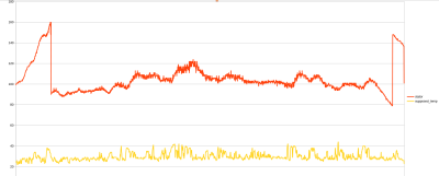

I've a problem with the tempm (motor temp sensor) return, when I start my trip the value is lower than the outside temp (output 6°c, inverter 6°c, motor -12°c) , after the temp growth progressively (as the motor warm) to 155°c and then go down to 85°C and continue to growth.
When the motor is cooling I've the same step : go down to 85°C go to 155°C and continue to going down.
As the stator temp is the most critical point for my vehicle ( 19T motorhome ) I don't know what to believe.
I had the same result with 3 different stator, and 2 different logic board, and it's the same on CAN and WiFi .
Is it a known problem ?
Any ideas to solve it ?

So finally, I burn a stator again, maybe the first temp is the good one, because I'm pretty sure that 110 degrees is not that much for this stator ?
Or maybe it's due to too high Amp in the AC side, I only check the DC side power and I never exceed 300A 120kW
How to be sure of the temp reading ?
With the graph of my last trip, when my stator die, we can see that the temp output go 155 and fall down 90 to stay all the trip between 95 and 120 degrees. But I suppose that it's just a step error in the reading and I add 70 degrees to the value following the fall the curve seems to be logical as at the end the curve is linear.
So really the temp was between 160 and 190 degrees that is really high .

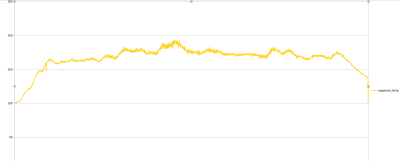

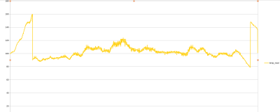

We are talking about the stators sensor, they are inside the winding, so no I can't take it out, and I can't put another sensor in.
Sorry, I don't understand what you want to check by this way ?
The main problem is that the temp returned by the logic board has a step in the rise and in the fall, whatever the accuracy is.
During the rising temp, while I'm driving, so it's not possible that the temp fall, at 155° the returned value fall of 70° so the returned value is 85°, and this value continue to rise to something between 95° and 115° during my trip.
During the falling temp, while I'm not driving, so real temp in the stator don't have to rise, at 85° the returned value rise of 70° so the returned value is 155° and continue to fall to something +- close of the ambiant temp.
So I think that is the returned value that have a mistake, because if at the rise step I add 70° and at the fall step I remove 70°, the curve seems to be logic
I sent the graph of the reading value and the supposed real value. it's an extract so it doesn't start at 0, but it's easier to understand the steps
I'm sorry, I think I should have sent the 2 curves separately
As you can see during the falling, it's linear.
thanks for your help.

The sharp changes in the graph remain odd, but I'd also agree with the point that +150C is not something that others have seen. I've hit a thermal derate, but only from the inverter running a bit too hot.
Two related questions:
- Are you running the drive unit in it's original packaging/configuration? i.e. the inverter still in the case, with coolant fed from the motor side?
- if so, can you graph motor and inverter temps together?

No badly I didn't yet . This could be the best way to figure how the sensor react.
I'll search for an oven.
I already try with 3 stators (so 6 sensors) and I never seen 165° , so I don't think it's a sensor failure as it seems to be able to go up to 200°.

This the inverter and stator temp, but I fed coolant by inverter side, next week I'll send the graph in the other way.P.S.Mangelsdorf wrote: ↑Mon Feb 17, 2025 1:18 pm if so, can you graph motor and inverter temps together?
- Posts: 1076
- Location: Raleigh, NC, USA
- Has thanked: 234 times
- Been thanked: 267 times
Re: LDU temp reading problem (not logic)
I'd try running coolant from the motor side as it's designed to do, then graph again.
