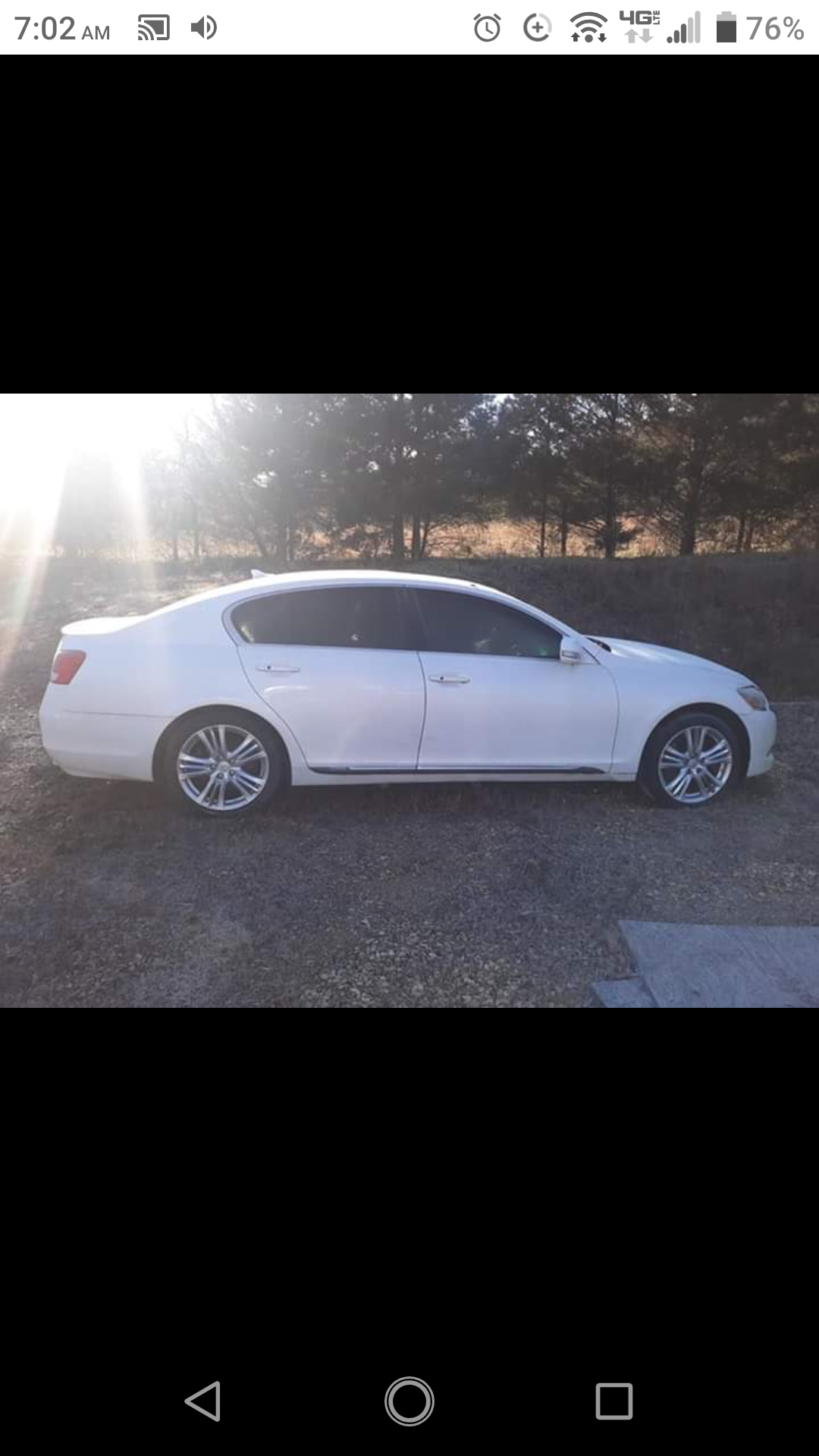

Here's what I hope it's the beginning of a fairly quick conversion of my recently purchased 08 Lexus GS450H with a dead hybrid battery for $1500. I'll get it home today and start pulling the engine immediately. I have ordered the VCU so that will be my first part in waiting on, I already have a 13 Chevy Volt battery from a previous project (Nissan Leaf powered grasshopper mower) that I'll use initially until I get the funds together to purchase around 40 kWh of batteries to fit in this car. The plan is majority of the batteries to go in the front with a few mounted in the place of the hybrid battery.

Ok, biggest problem now is the car won't start/drive because of major hybrid faults. I have a Toyota interface cable that has given me hybrid module faults and battery faults. So I don't know if I'll be able to get anything useful out of the can system unless I can spoof it into working with the mentioned systems. What do you think?

Well, the faults won't clear and I'm wondering now if there aren't multiple modules out. I'm almost thinking of taking on an easier project and just pulling the motor and inverter out of this thing. The car is in ok shape, but there are missing parts that will be fairly expensive. Needs a hood, back seat, and steering wheel airbag. Not many of these around that I can nab parts from cheaply. I think a simple donor car would be better. Maybe a smaller 4 seater rwd car from the 90s would be best. This may be beyond my capabilities and budget to get swapped and be reliable.
My last ditch effort is to take the bus bars off the batteries and clean them. Pack is getting 0VDC but has at least 5V on every cell.

Wires from the pack show 0v going into the relay module with the disconnect installed. That's why I think it's corrosion or something. I'll find out today.

That's the first thing I checked, there's continuity inside the service plug. I'm still investigating. The hybrid pack has many batteries below 6v. I'm wondering if I can recharge them to get this thing working again. I have a charger that I can set to pack voltage. What voltage and current should I set it to do I can slowly charge this thing up to full voltage? I plan on reassembling the busbars today and hooking it up to the charger for the weekend to sort of trickle charge it. Then I'll try reinstalling the pack.

I'd charge it with 288V at a suitable rating for Ni-MH. It's a 1.9kwH battery, so each cell is rated to 6.6A, I don't know the recommended charge current for Ni-MH so would go with 1C, so set it to 6.6A.
