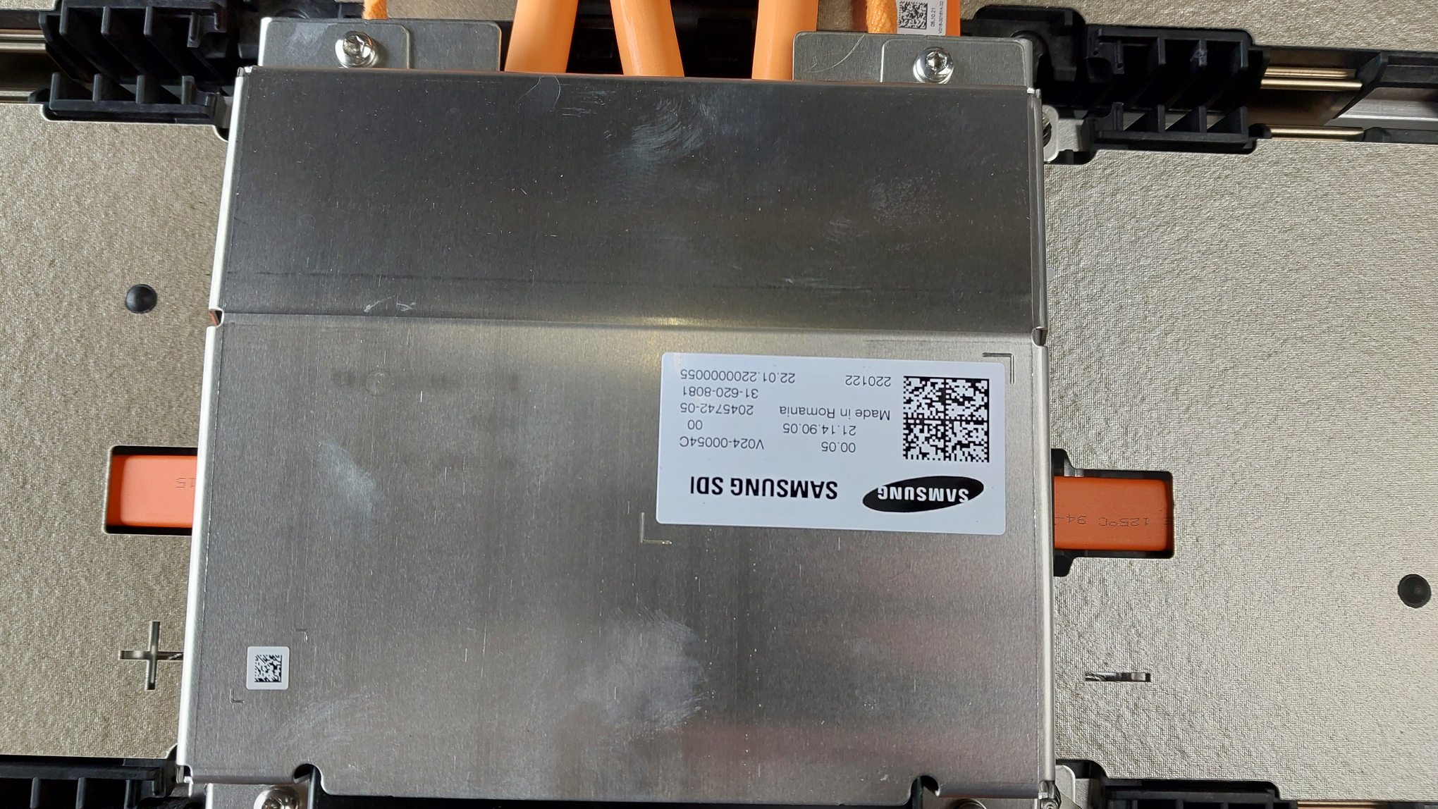

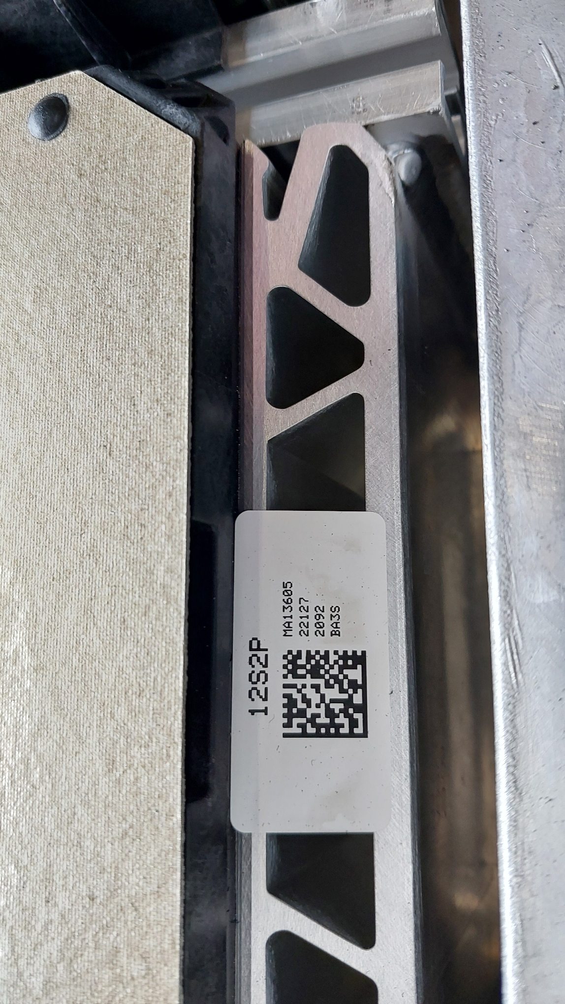

I read here and there it would be LFP, but the numbers don't add up...I think it's normal NMC (Samsung)
12s and 8s modules, works with:
https://wdrautomatisering.nl/product/cm ... 1-gateway/
Fiat 500e - 42 kWh (LFP) NMC pack

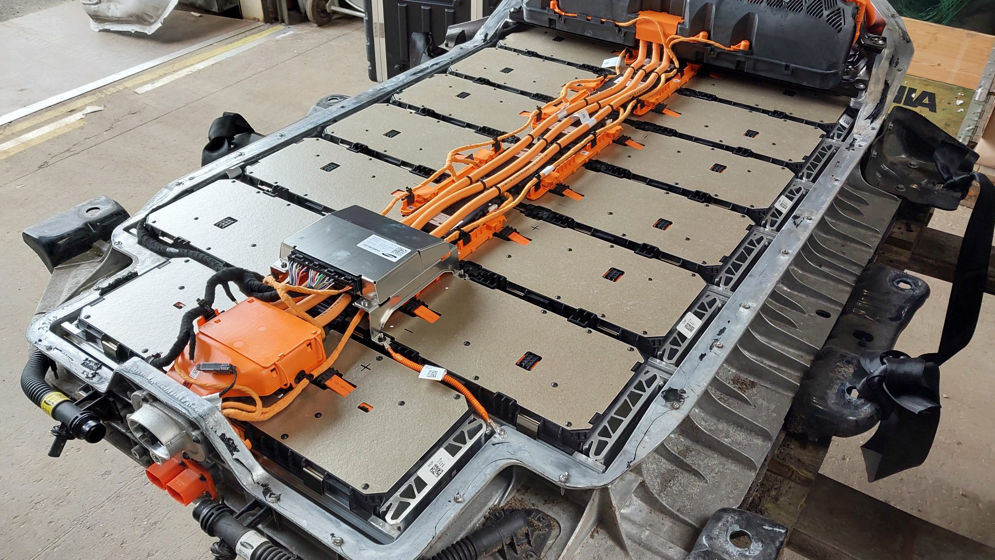

Ok some disappointment...
The modules are glued into the battery housing!
hoping for some safe way to dismount them..
(or someone that can use it as is)

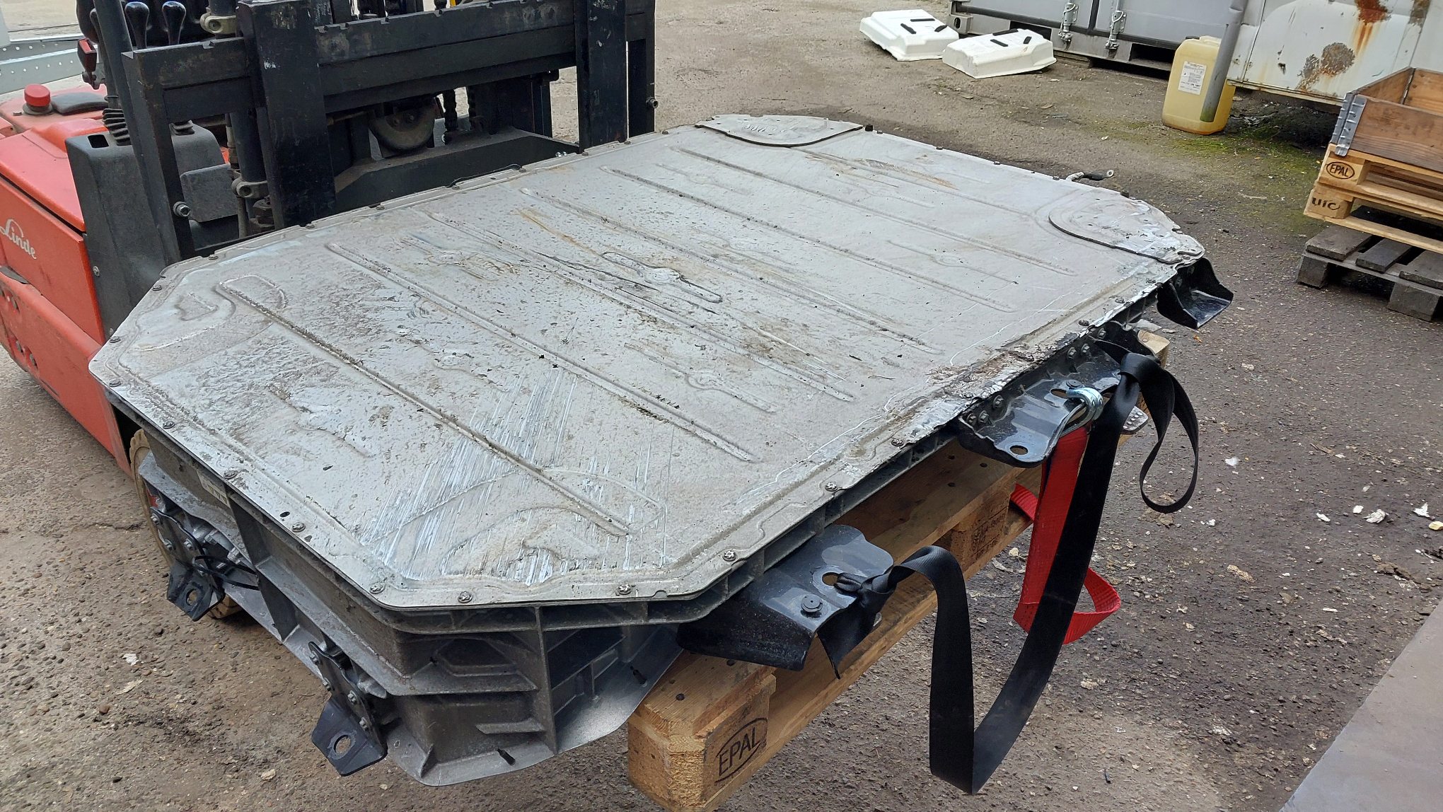

Re: Fiat 500e - 42 kWh (LFP) NMC pack
Taking it further apart: you actually need to be on the underside!
So I made a sandwich and flipped the battery, first there is a cover plate, with a 'sharpened' E16 bit I was able to remove the security / one way screws.
the cover plate is also glued quite well to the modules, putting pulling force on it and cutting the glue was the way. (Also for freeing the modules from each other)
