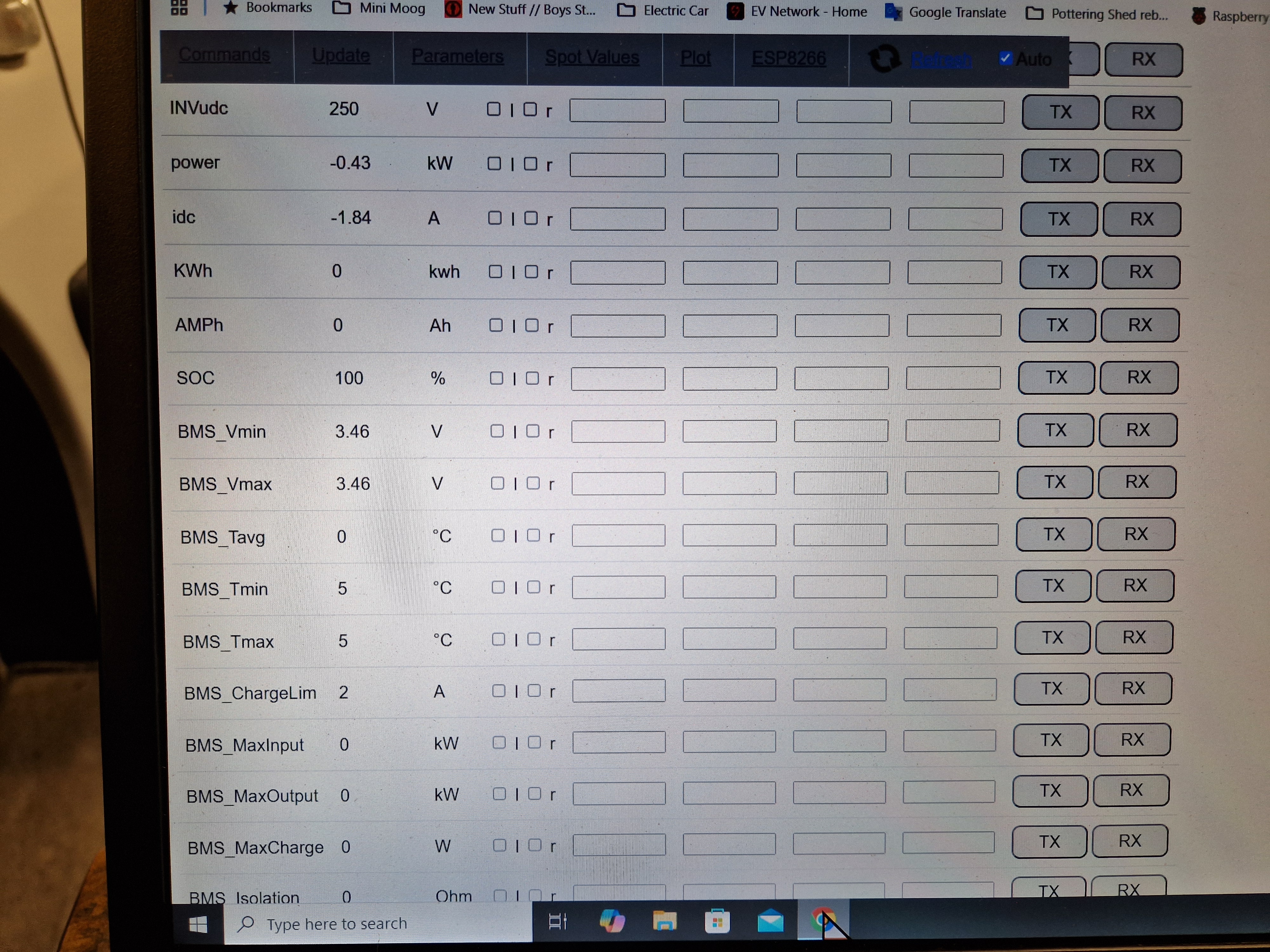

When using the Leaf PDM in charge mode with a Zombi controller, the charger is limited to 2A (0,7kW)as can be seen on Spot values for BMS_ChargeLim

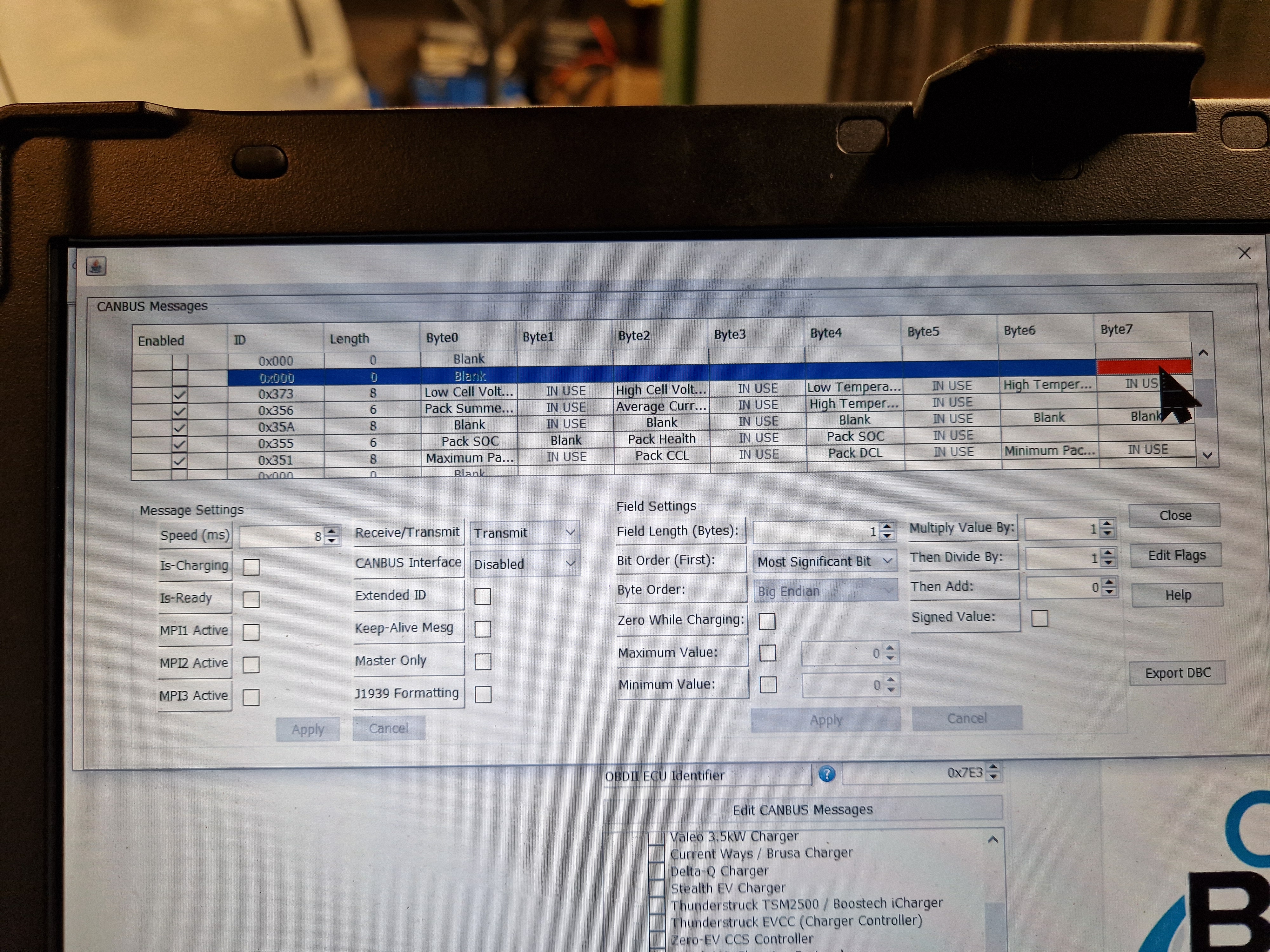

Looking at the SimpBMS CAN messages, I cannot see where the BMS limit is being sent.
Is a CAN message missing?
Also concerned that the SOC is always 100% on Spot Values which is not correct. Is this used at all as I guess the BMS_Vmin and BMS_Vmax are used during charging.
Have attached a pic of the Spot Values and SimpBMS messages on the Orion.

Rustybkts wrote: Sat Jan 25, 2025 5:52 pm SOC is always 100% on Spot Values
Does not get taken, you can MAP it via the spotvalue interface to CAN. It does not get used by anything.
Please note the current implementation of Current limit assumes its 0.001A/unit. So modify the message accordingly. https://github.com/damienmaguire/Stm32-vcu/issues/77
Will get resolved to the correct scale soon.

Ok got it. I mistook the abbreviations in Orion messages and have the SimpBMS message list now so will sort.
