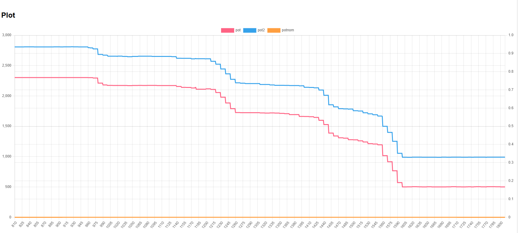

However when depressing the throttle, Potnom = 0 (same for torque)
RX450
Potmin = 504 so using 515
Potmax = 2303 so using 2290
Pot2min = 988 so using 1000
Pot2max = 2808 so using 2790
I tried single pot with signal 1 also, but same result. Is this still a throttle issue?

IS300h has a known bug with a fix now to restore the IS300h functionality.
However the issue you are seeing is due to:
UDC being 0. this is the value used for the limits. Set udcmin to 0.
This was not an issue before as the voltage limits did not function this has been fixed in this release.
There will be a release soon to fix the two bugs in the 2.20A release: IS300h inverter and LIN bus
