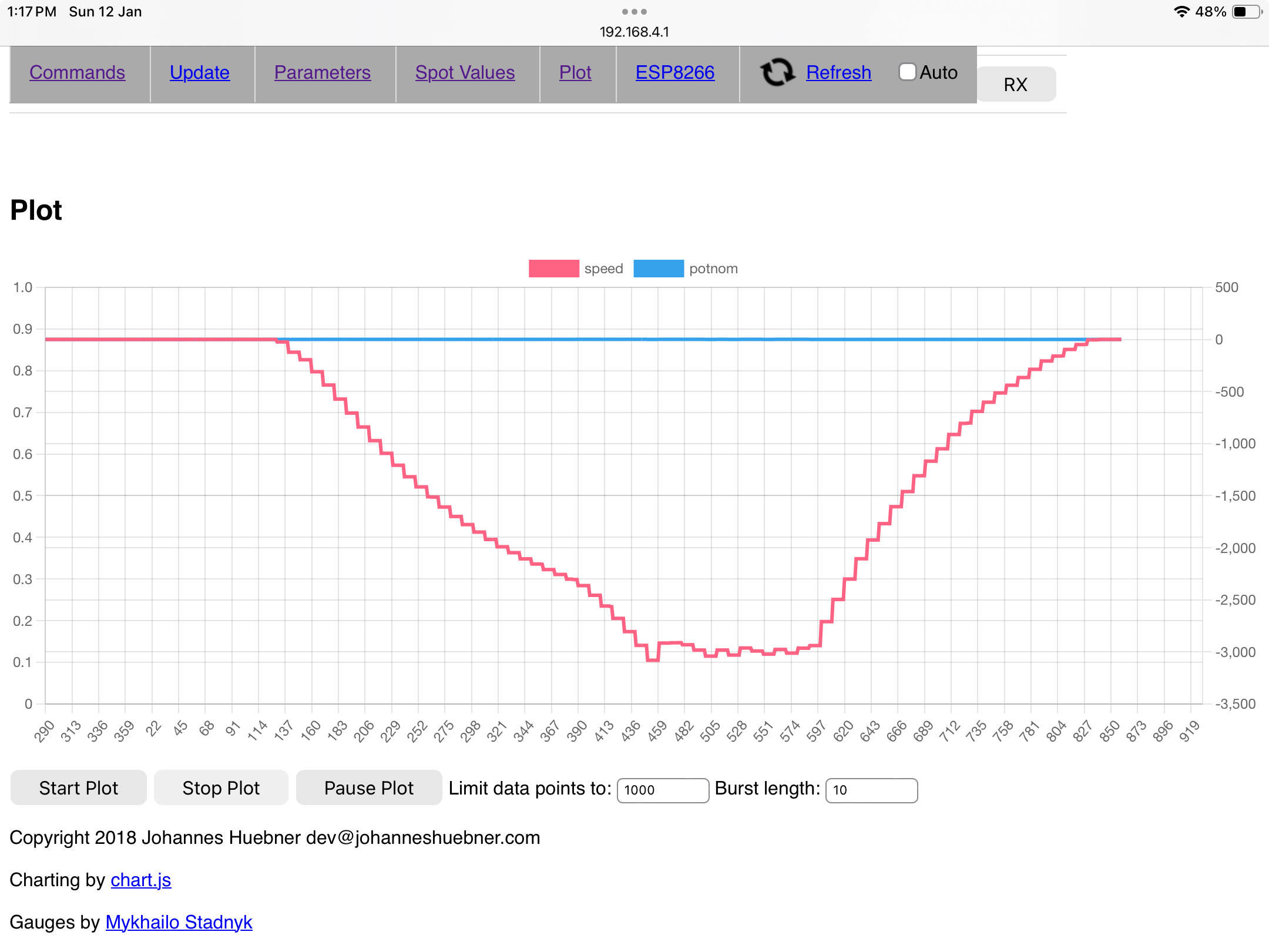

Hi Brainstrust - I need some assistance with my full 2014 Leafstack that runs smoothly in Reverse direction, but is unstable and surges when spun up in the forward direction. I have searched the forum but have not found anything yet that matches my problems. This is my setup:
Full 2014 Leafstack ( with PDM divorced so it will fit in the vehicle)
Complete Original 2014 model 24 KWH BATTERY (approx 73% SOH)
Zombieverter running firmware 2.20A
I took a couple of sound recordings which I will upload, along with a copy of my paramaters file. I have it configured with the PDM, Inverter, and BMS all on CAN1, and where possible, I have copied the parameter settings Damien is using for his L200. I am assuming my problem is related to regen, as the surging is not there when I spin the motor in reverse. I have experimented with different settings for that, but without success.
I have wired everything up as per the “ Leafstack with a Zombieverter “ wiki, and something thing strange I have noticed is that once the 12 volt battery is connected and I then log in to the zombieverter that the spot value for “Invstat” shows up as “On”, even though I have not supplied the ignition or start signals to the zombie yet. In the wiki it says that I should get “Invstat on” after I turn on the T15 ignition input? When I do turn on the ignition the “Invstat” remains on, yet as soon as I send the start signal to the zombie the “ invstat” changes to off, even though the contactors do their thing, and the zombie goes into “Run” mode???
Another strange thing is that when I was setting up my min and max value’s for the 2 throttle pots my “potnom” shows random values, often negative, and I have never seen a value higher that 1.5, regardless of the throttle position?? I was expecting to see this change from zero up to 100% dependant on throttle position?
So I possibly have more than 1 issue going on here, and if anyone has any ideas your advice will be greatly appreciated.
Thanks - Andrew

Please make a plot of potnom and speed so we can review what is happening.

tom91 wrote: Sat Jan 11, 2025 12:35 pm Please make a plot of potnom and speed so we can review what is happening.
Hi Tom - wasn’t sure how to export the plots you requested, so I just took screenshots. I hope that is sufficient. One of the plots is just me gradually applying the throttle from 0 to 100% with the car turned off. Feedback as expected from both pots, but no feedback at all from potnom. The next plot is with the zombie in Run mode and Forward direction selected, I only applied partial throttle as the car was in neutral. Again, expected feedback from both pots, but almost nothing back on potnom. And the last one is in reverse, with similar results. I hope this is what you are after, and please let me know if there is anything else you need
Hi Tom - I just realised you asked for potnom and speed. I will go and get those plots for you

Hi Tom, - this time I got the plots for speed and potnom as requested. First plot in Foward and 2nd in reverse. As you can see, no readings for potnom in either direction. Also, I gradually applied the throttle pretty much the same in both directions, but you can see from the plot,that in the forward direction that the motor gets up to the revlimeter ( 3000 rpm at present) far more aggresively. While in reverse it is a far smoother and gradual build up to speed. I backed off the throttle straight to zero the same in both forward and reverse, and in both instances the rundown to zero rpm is pretty much the same. I have regen set to zero at the moment.

Iceman96 wrote: Thu Jan 23, 2025 1:50 am “Throttle12diff”
this will create a judder
Other thing to try drop your "throtramp": 10 to lets say 2.
Iceman96 wrote: Thu Jan 23, 2025 1:50 am Potnom still does not show meaningfull values
this is a problem, can you plot potnom, speed and torque
Iceman96 wrote: Thu Jan 23, 2025 1:50 am I had no torque in reverse
"throtmaxRev": 50 is what limits reverse torque, you can try changing this.

Further update:
As per my reply to JOhannes - I tried the original Leaf throttlepedal. I still get the “Throttle12Diff” error, however it is more responsive than the throttle pedal I had been using. It also made no difference to the lack of grunt in reverse.
I have not been able to get any CAN logs yet, as I am having trouble loading the GVRet sketch on to my CanDue for some reason. But I will persevere.
I have taken some plots which I will include below, but I can clearly see the negative torque requests when I select reverse, yet unless the car is on dead flat ground ( where it will creep backwards), it just cant move the car. I even tried applying the handbrake, and in reverse there is nothing, but in forwards it can easily overcome the handbrake.
For Tom - I did the plots you requested, and I thought I was still getting nothing on the Potnom channel. But I realised that due to the scale required for the RPM plot, that the changes in the Potnom channel probably would not show up. So to check my theory I did a plot of just the Potnom value. And sure enough, it now goes from 0 to 100 and back as I applied and removed the throttle. So maybe I need to start another thread to find out how to make the best use of the Plot feature? I have searched the Forum and the Wiki, but have not found anything helpful yet.
Also Tom - I noted your point that the Leaf inverter firmware has some inherent limits, but this leaf motor had plenty of torque in reverse when it was in the Leaf, so I dont understand why it doesn’t now. From my plots it appears that the Zombie is sending the negative torgue request ok, yet for some reasong the inverter is not applying it to the motor.
For JOhannes - I tried doing the same Plot as you had done, but due to the problems I am having with the Plot scaling I mentioned above, it does not show the change in direction like your plot did. But you can clearly see the negative torque request when the car was in reverse and would not move regardless of the amount of throttle applied.
This plot is taking off from a standing start on flat ground, accelerating to 60kph, slowing for a corner then accelerating to 60 again before backing off.
This plot is of just the Potnom value showing that it does go from zero to 100
This plot is an attempt at recreating JOhannes’s plot. Starting off, accelerating to 60kph, then coming to a stop and selexting Reverse, apply the throttle again but car would not move due to a very slight gradient.

Get a CAN log please shows more detailed information.
The plots look fine to me.

Well I went with JOhannes’ suggestion and pulled out the contactors and gave them a few good bumps on the workbench. It did the trick and they both came unstuck. I power cycled them a few times on the bench with an ohmeter across the contactors and both seemed to work ok. I reassembled the contactor block and put it back in the battery pack and reconnected everything.
So now with 12VDC going to the zombieverter, and to the correct inputs on the PDM, Inverter, and the Battery pack, but no “Ignition on” signal, or “Start” signal going to the Zombie, I logged in to the zombie to see what state it was showing. Everything looked ok to me except for the fact that the “InvStat” feedback was showing as on. But no volts were showing on udc, and the DC-DC converter was still off. I then did a download of the parameters which is below:
params No1.json
(2.13 KiB) Downloaded 420 times
I then connected up my arduino Due and started savvycan logging on my CAN1 bus, which has the zombie, pdm, inverter, and bms all on it. I continued logging for a bit as it was, and then turned the ignition on. I saw no appreciable difference on savvycan ( IE no new channels appered in the list of what was being logged). I then gave the zombie a “Start” signal. I-heard the contactors close, the zombie went into run mode, and udc1, udc2, and Invudc were all indicating approx 384volts, the DC-DC converter powered up as my aux volts wentup to 14.8v and everything seemed okother than my “InvStat” was now showing as off. I checked Savvycan and there was now extra channels being monitored.
I left it like that for a few more seconds, before turning off the ignition. It sounded like the contactors dropped out, but i was not sure. The zombie went into “Off” mode ok, “InvStat” went back to on mode, i think the dc-dc turned off as i am fairly sure the aux volts dropped back to approx 13volts. After a short wait i stopped the savvycan logging and the file is below:

Something strange that I noticed was that it appears that the value I had saved for udcsw of 360volts had been ovverwritten by the actions of starting up the inverter, as it was now showing a value of 364volts. (Not sure if it is a coincidence or not, but that was a value I had been using previouslyfor udcswI ). I tried doing a refresh, but the value remainned at 364 volts. So I did another parameter download which is attached below where you can see the value has changed:
params No2.json
(2.13 KiB) Downloaded 403 times
I then cycled power to the zombie and checked the parameters again, and udcsw was back to 360volts again???
I then tried powering up the inverter again to see if it did the same thing (it did), but on powerdown the contactors sounded funny again, so after isolating eveything again and checking, i found the contactors stuck closed again. So even though I did not run the main traction motor at all, the power draw of the dc-dc converter was enough to reweld the contacts, so I wont take any more risks with these contactors, and will have to wait until my kilovacs arrive and are installed before I can get any savvycan logs of the “no torque in reverse” issue. But hopefully the one log that I did manage to get may give some insight into why my “InvStat” is behaving the way that it does???
