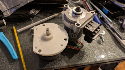

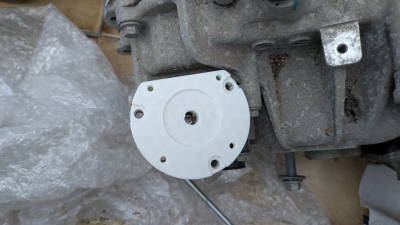

Yesterday and today I started to build a replacement for the funky parking lock actuator that is realized with a tree phase motor in the original application and a dedicated controller.
My plan is to replace that with a watertight NEMA 23 stepper (not the one in the picture, Beff Jezos didn't deliver it yet). Hopefully this Drive Unit will gain some attention once Damien starts the V70 conversion and people notice it. It's a really nice, compact unit but yet very powerful.
It is very empty still, so if anyone wants to add some information, feel free
