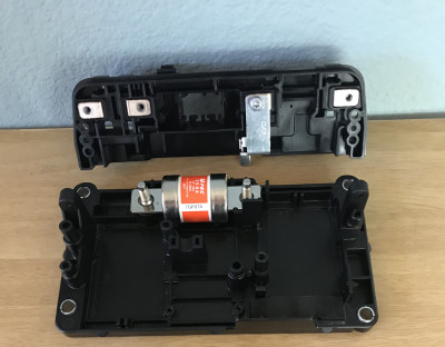

just got to thinking why don't OEM manufacturers use circuit breakers instead of fuses in the battery packs ie the contactor aka safety boxes? placement aside I know nobody would want to drop a battery pack and bust it open in order to flip a switch on the circuit breaker, but the same needs to be done to replace a blown fuse so that's a wash

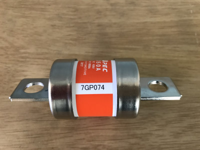

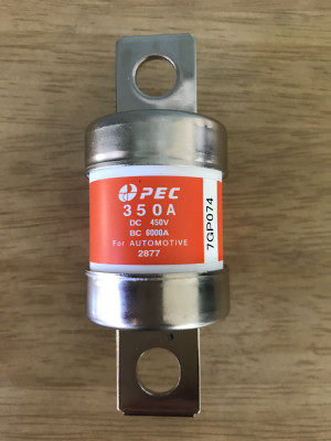

below is a 350 amp fuse commonly found in the BMW 530e, 330e, and X5 models
