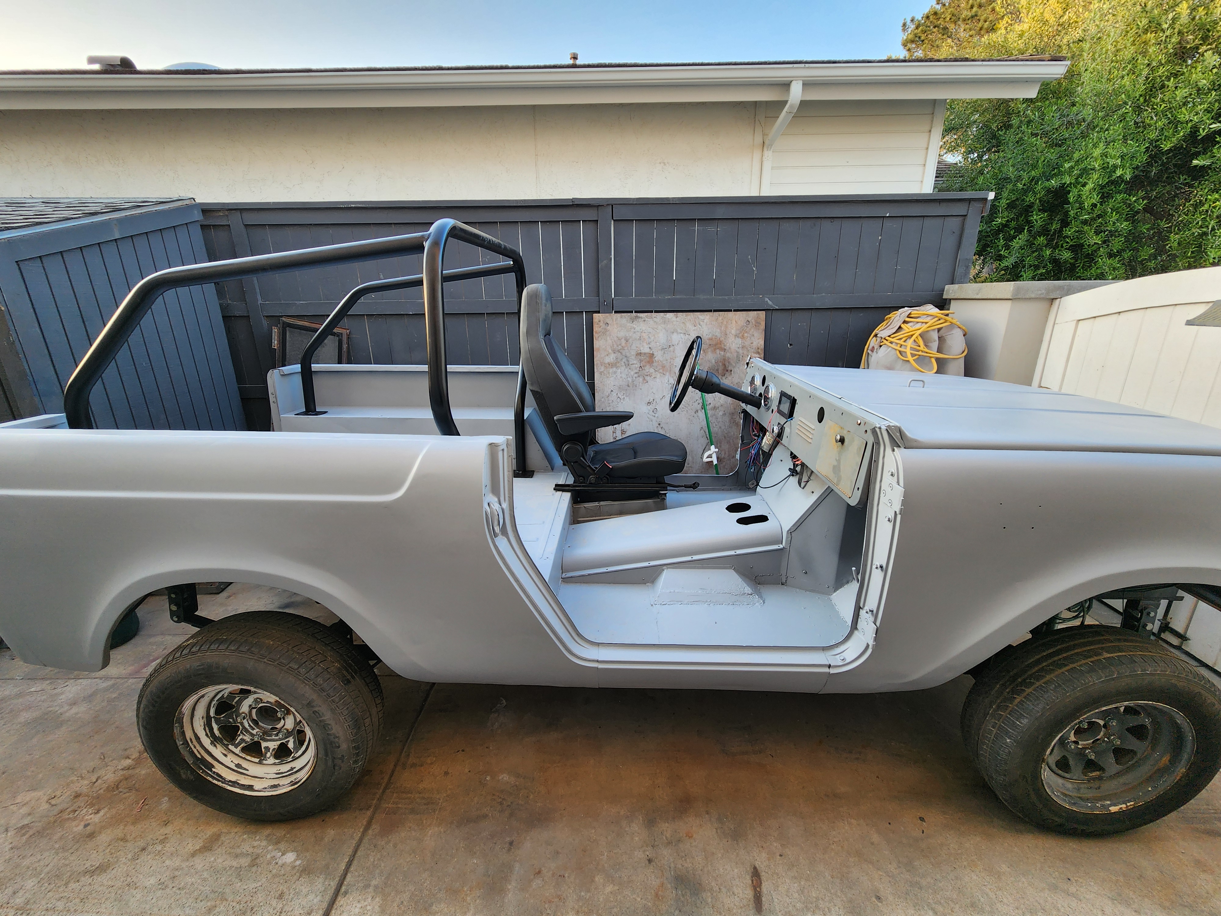

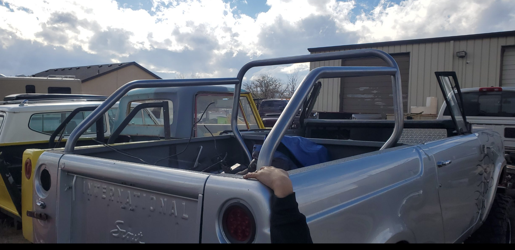

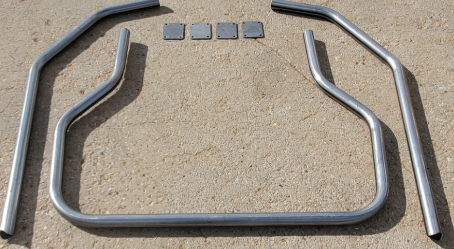

I bought a roll-cage to Mad Max this rig up a little. It's custom cut for the Scout, and comes pre-notched for welding.
This is how it should look installed (obv not my Scout)

They sell sfi roll bar padding for cages. It's pricey but worth considering if the cage is anywhere near your head. Or where your head stretched to in a crash. The padding is almost as hard as balsa wood. Hitting your head on a roll cage hurts bumping into it. If your head impacts it in a mild crash it can be lethal. It's not just the hardness but the small diameter.
The pool noodle padding is worthless in a head to cage crash.

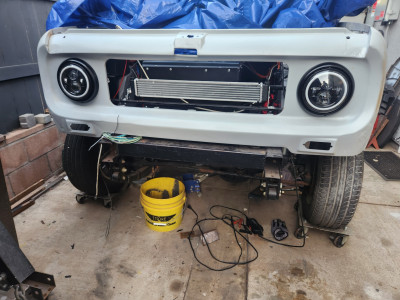

The original Scout headlight buckets were rusted out and parts are really expensive to come by. Luckily there are a ton of aftermarket parts for Jeeps, so picked up a set of DRL LED leadlamps. For now I just painted my rusty chrome bezels black, but may get new chrome ones later. The headlamp has amber turn signal capability on the LED ring

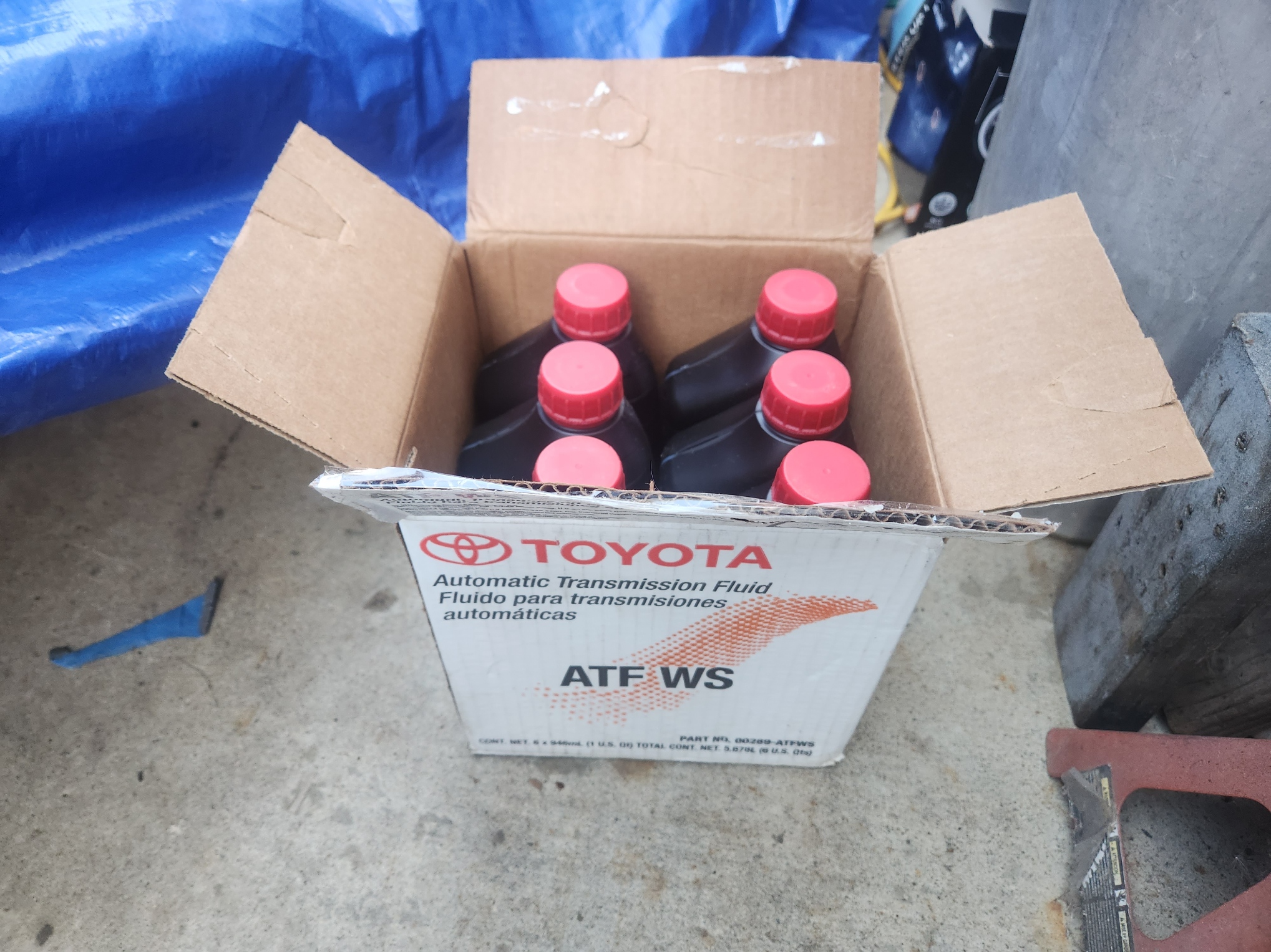

Also got my six pack of WS fluid, so need to tackle that soon
I also need to do the transfer-case oil and both differentials, but will wait until I can at least prove I can get this thing running first

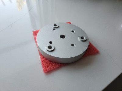

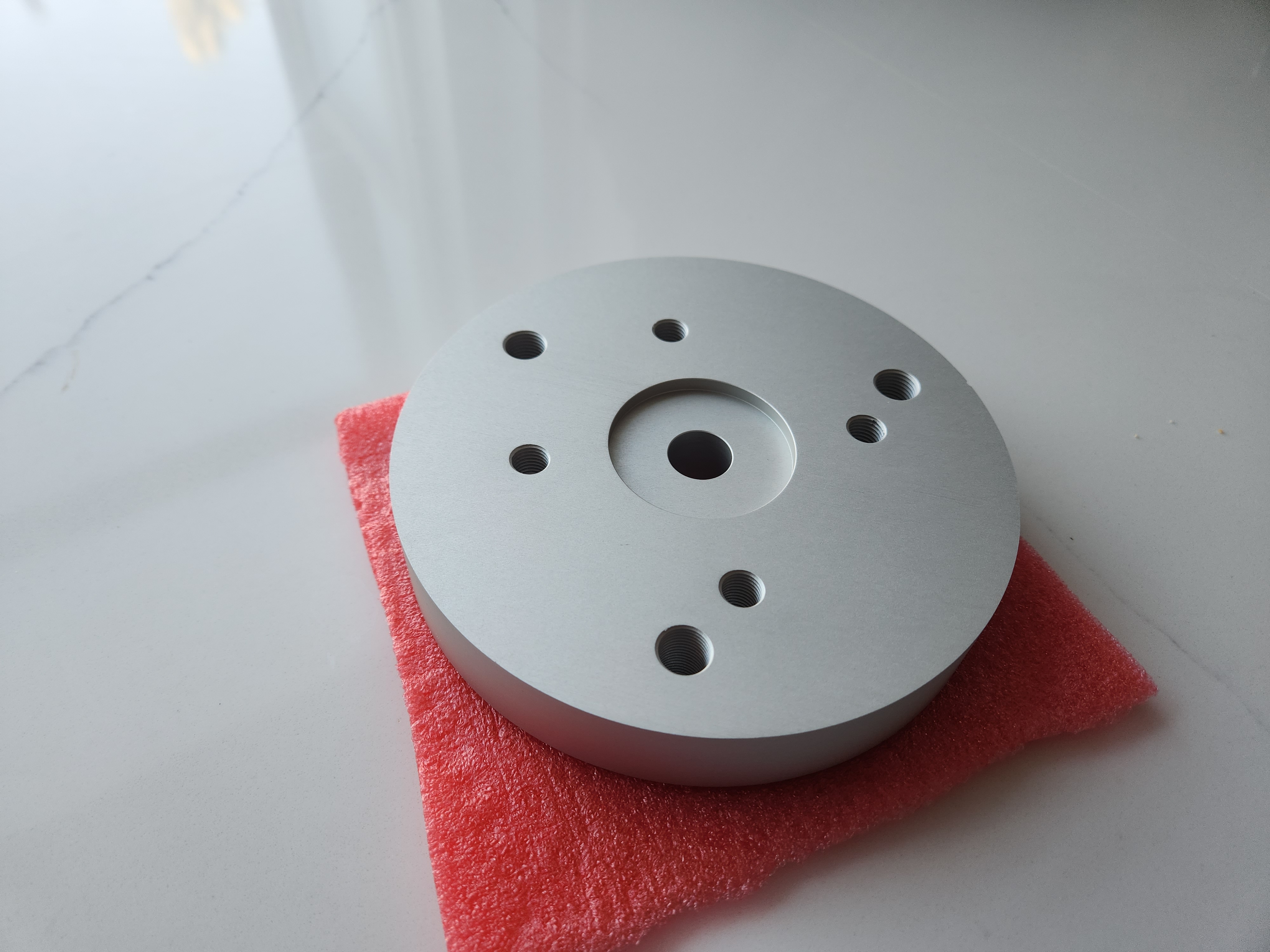

Came back from a few days out of town to find my nice new adapter all machined up from jlc:

Slow progress, but got the adapter mounted at least

robertwa wrote: Wed Jan 08, 2025 3:21 am Slow progress, but got the adapter mounted at least
Nice, is it anodized? Or planing on panting it?
Just concerned over the dissimilar metals reaction.

Bratitude wrote: Wed Jan 08, 2025 6:23 am Nice, is it anodized? Or planing on panting it?
Anodized.... this is what I chose:
Material: Aluminum 6061
Surface Finish: Bead blasting + Anodizing-Natural-Matte
Tightest Tolerance: ISO 2768 medium
Surface Roughness: Ra3.2
Threads: Yes

robertwa wrote: Wed Jan 08, 2025 4:48 pm Anodized.... this is what I chose:
Threads: Yes
should be okay, i would throw a lay of paint on the steel ends to be on the safe side being is exposed to the elements harshly

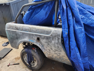

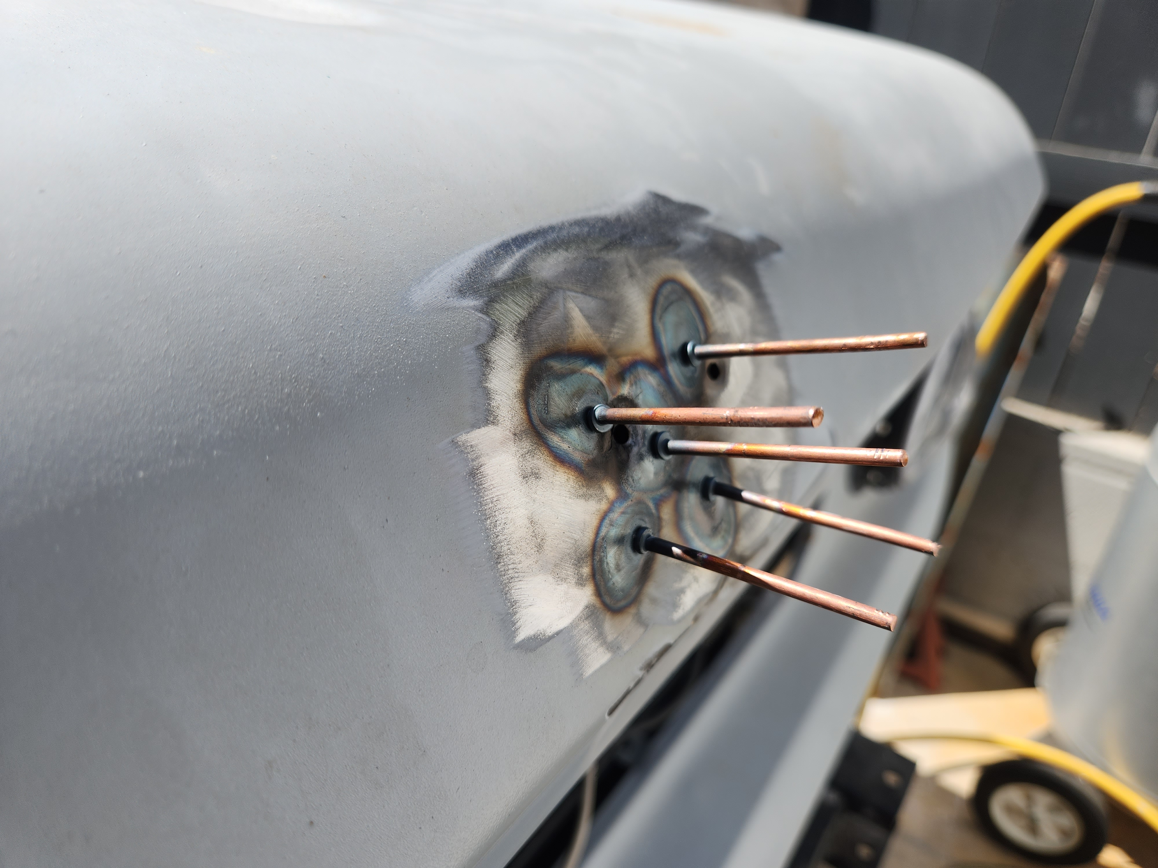

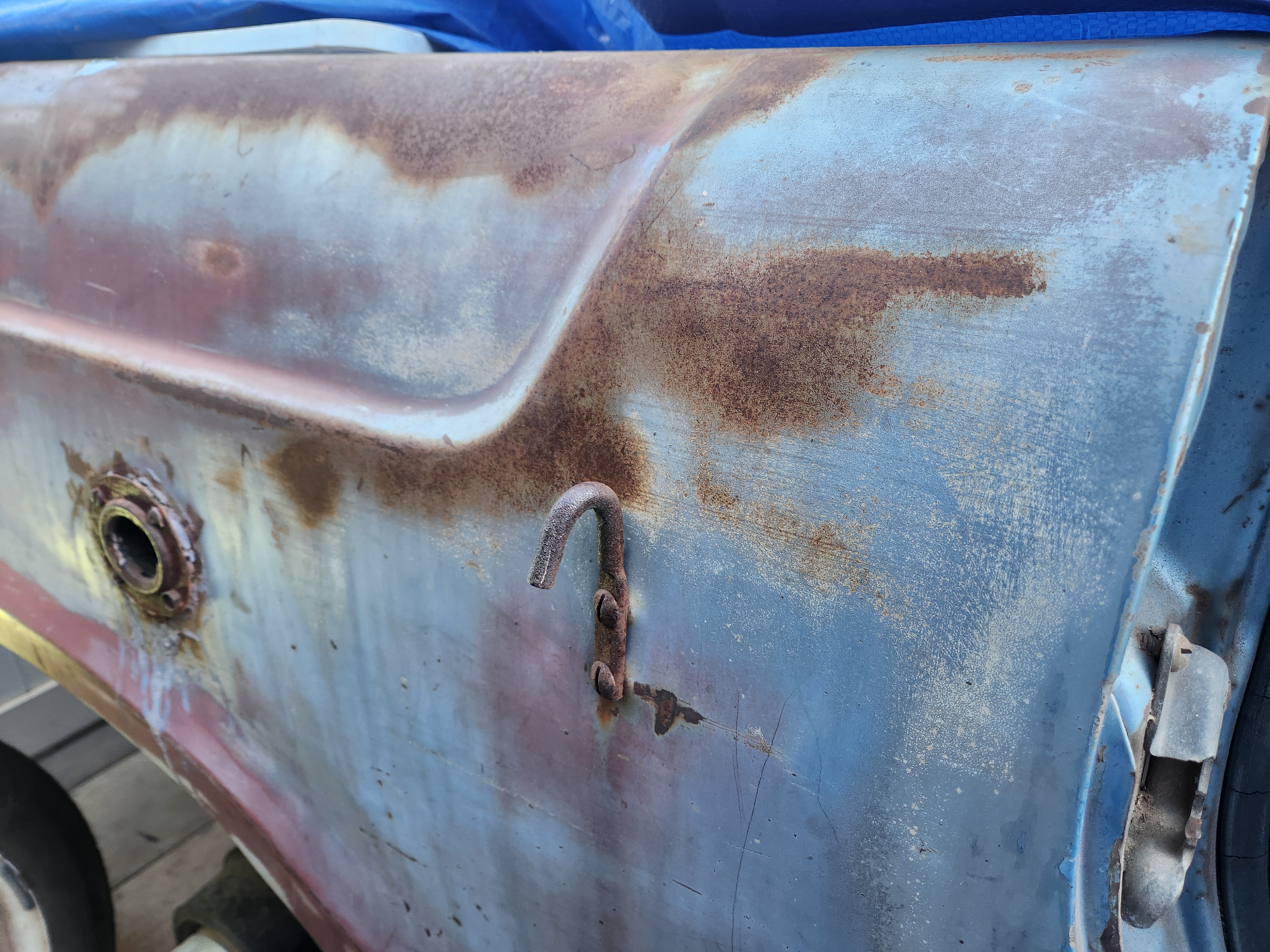

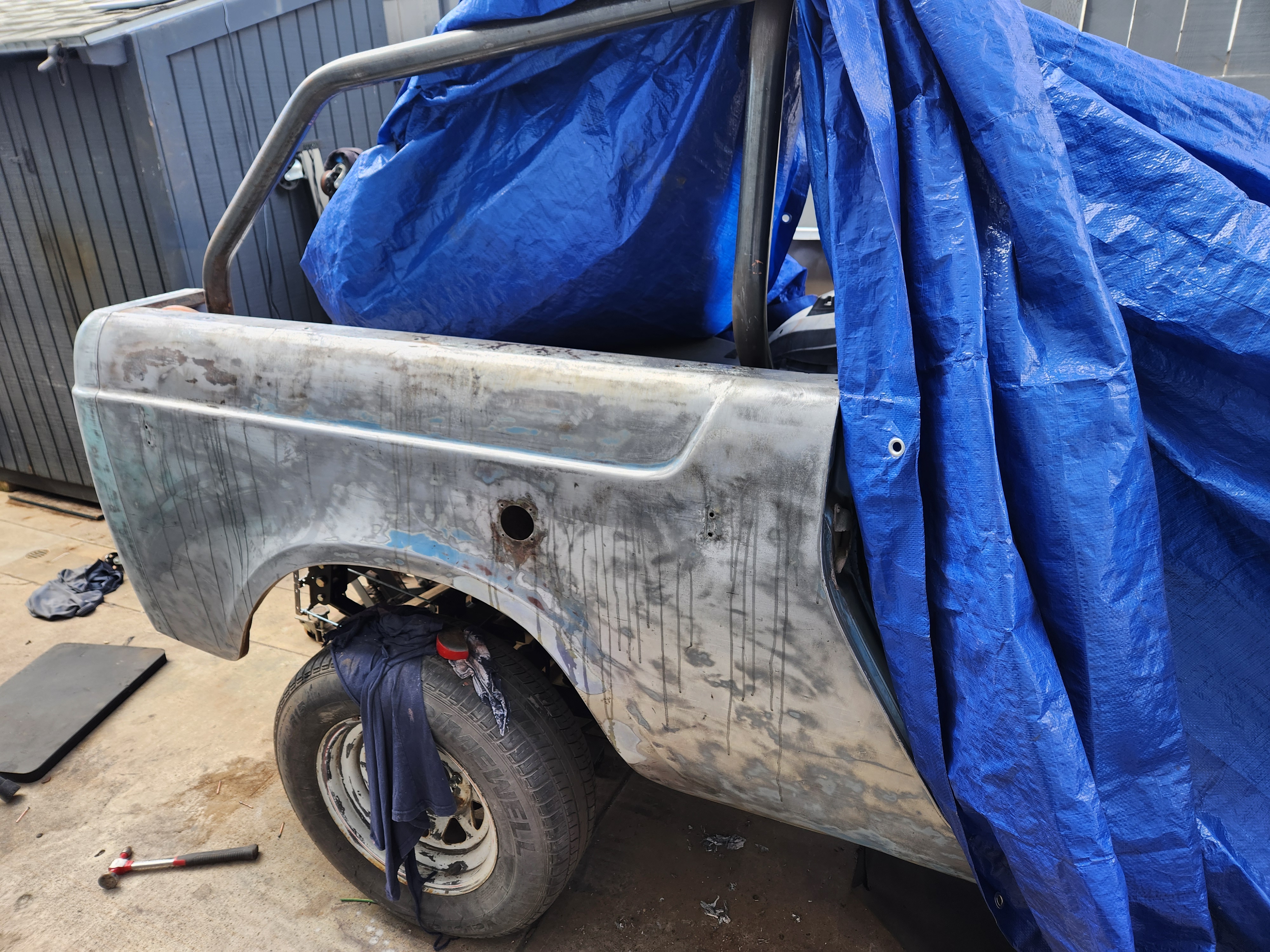

Bodywork, bodywork, bodywork. Don't buy a rust bucket. My goal is to get this thing halfway respectable, so I don't get the side eye from the neighbors.
This Scout came with (no joke), options from the dealer back in 1964. One of these options was farmer hooks. I've torn clothing and skin from these damn things over the last couple years, finally they have to go.
Stripped and ready to weld closed some holes
Pulling dents
Finally all in primer. Problem now is it brings out every single little ding, so lots more filling and block sanding to do
