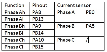

Re: Overcurrent event on start with FOC
My PWM setup with Olimex STM32-H103 looks like this:
Would that be good or should i correct it?
tnx

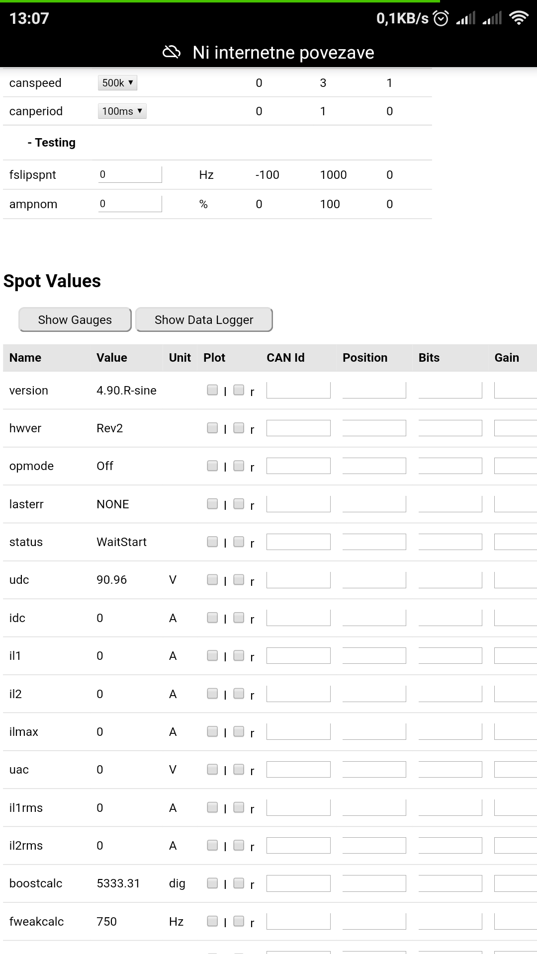

Ok, i tried to see what FW shows.johu wrote: ↑Tue Apr 06, 2021 9:10 am There are no different pin assignments in FOC. How is your board detected (hwver)?
PC9 is the desat input and PA0 used to be a separate UVLO input. In V3 I also disconnected emcystop from the NAND gate because I thought one external hardware shutdown pin (mprot) should suffice.
For the primary side it shows 5.0 FOC on rev2 hardware
For the secondary side it shows 4.9 Sine code on rev2 hardware.
screenshots attached...
When i attached Wifi module i immediately get OClimit on the brain to which wifi module is connected. I guess it draws just too much for the AD to be stable. I am waiting for 3V3 LDOs. I actually made provision for separate 3V3 supply.
So in FOC code what happens with the PC7 and PA0 pins? You dont show them connected so...?
