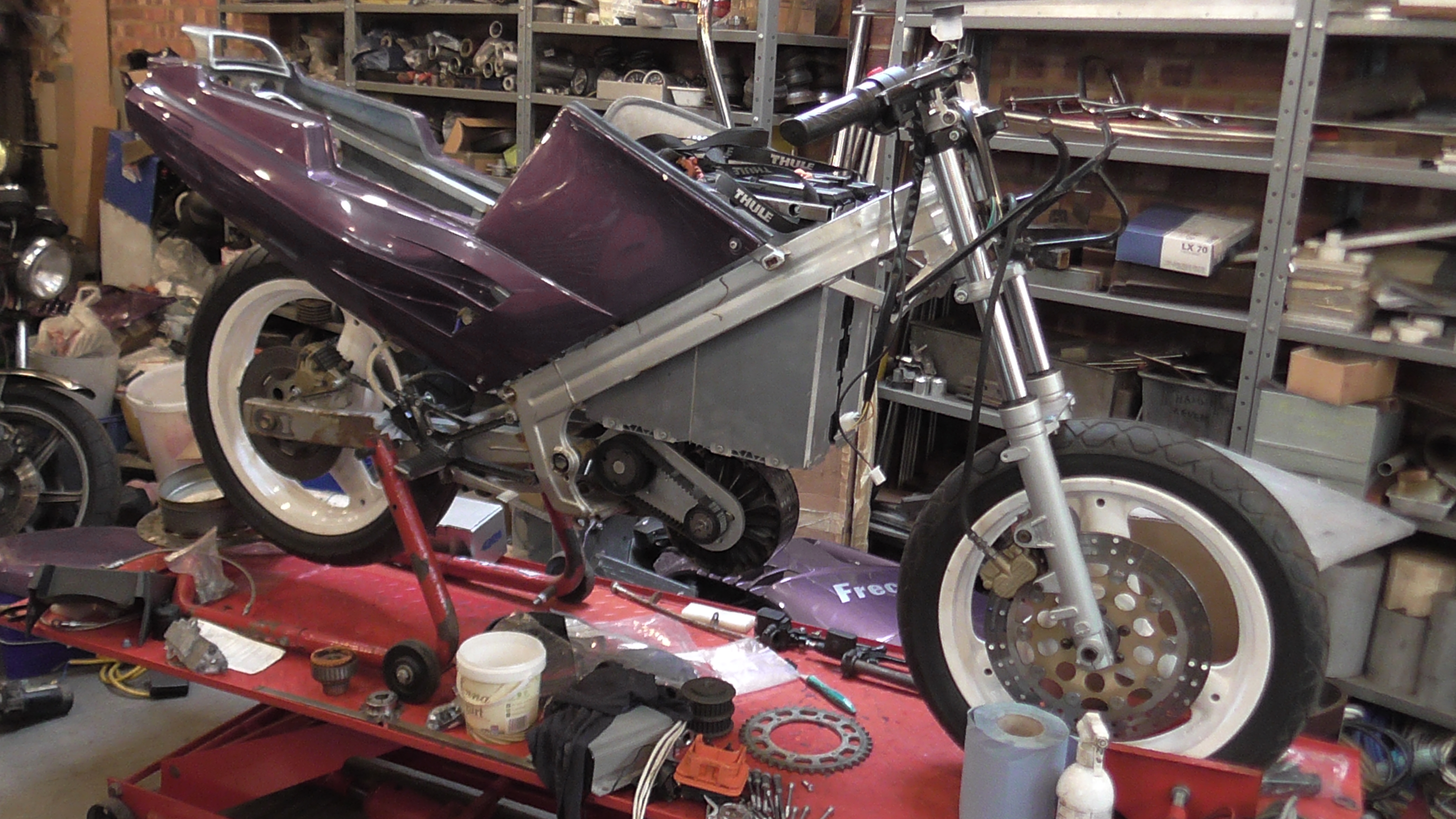

Years ago, I bought several examples of the Cagiva Freccia 125 (mostly C9 versions) to use as parts donors for my two Morini Darts. The Darts eventually moved on to new owners, but I still had quite a few Freccia bits. One was converted into an EV;
Some pictures of the work and completed bike;
https://photos.app.goo.gl/YAMNs7HdaeahVTso6
Another is on the bench now;
Personally, I wouldn't do a Dart because of the rarity and the fragile nature of the aging ABS bodywork. Freccias on the other hand were made in much larger numbers and the later C10/C12 bodywork is made of a much tougher plastic.
The dart is nowhere as aerodynamic as you might think. The front mudguard is pretty good, but one of my Darts went off to the USA to be run at Bonneville, setting four class records with the engine I'd put together from spares. It ran slightly faster with the bodywork (other than front mudguard) removed.

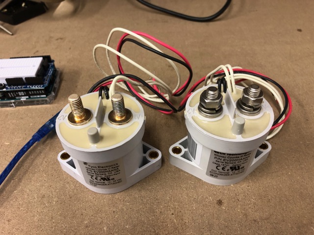

So far I have no motor, no battery, no charger and no VCU.
But I do have two of these. Gotta start somewhere! :lol:

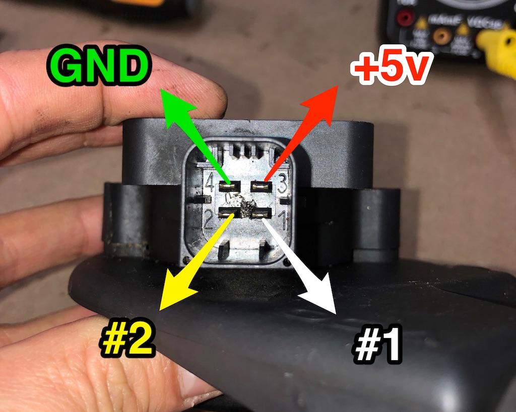

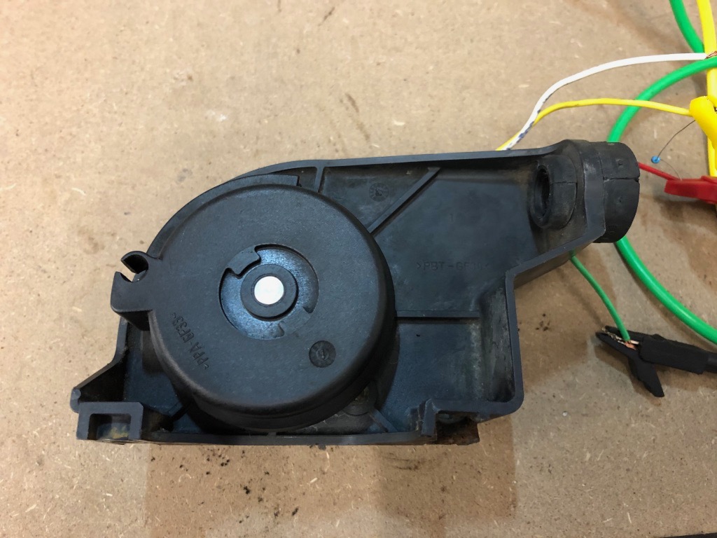

Been doing a bit of reverse engineering on a Peugeot throttle position sensor. These are cable operated, so ideal for a bike throttle. They're also cheap (only £16 new). Part number is 9643365680. Google for "Peugeot 306 HDi throttle position sensor"
Rather than a true potentiometer throttle, it appears these use a contactless sensor to output a pair of analogue signals.
Using a 5V supply and a 1kΩ pull-up resistor, I got the following readings:
0% throttle white: 0.419V yellow: 0.209V
100% throttle white: 3.780V yellow: 1.871V
I may use two: one on the throttle cable and one on the clutch cable (for regen control 8-) )

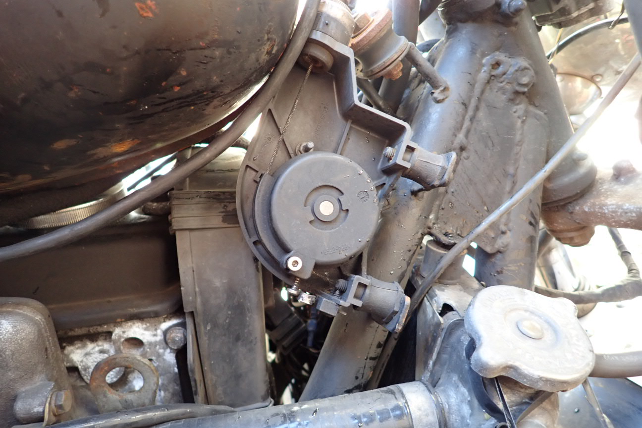

clanger9 wrote: Wed Mar 25, 2020 10:47 pm "Peugeot 306 HDi throttle position sensor"
Good choice of throttle pot.
I've had one on my 1900TDI diesel bike for about three years.

I cant actuality remember. I know I took it apart but can't remember if I messed with the spring in it, but there's a chance it had two springs and I removed one. Sorry to be vague but I was sleep deprived at the time and I can't find any photos I took of that part of the project.
I know I tried several different cable operated ones before settling on this one. The others such as a VW thrpottle pot had too strong return spring for a twist grip and no way of dismantling it for adjustement.
I also crudely fitted a microswitch to override the throttle pot at rest and give a separate digital input for throttle at rest ie a redundancy in throttle safety.

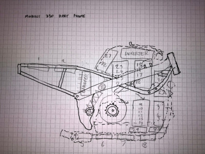

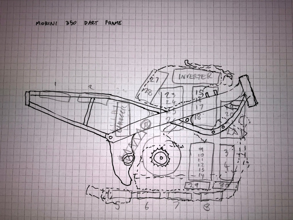

Today's rethink...

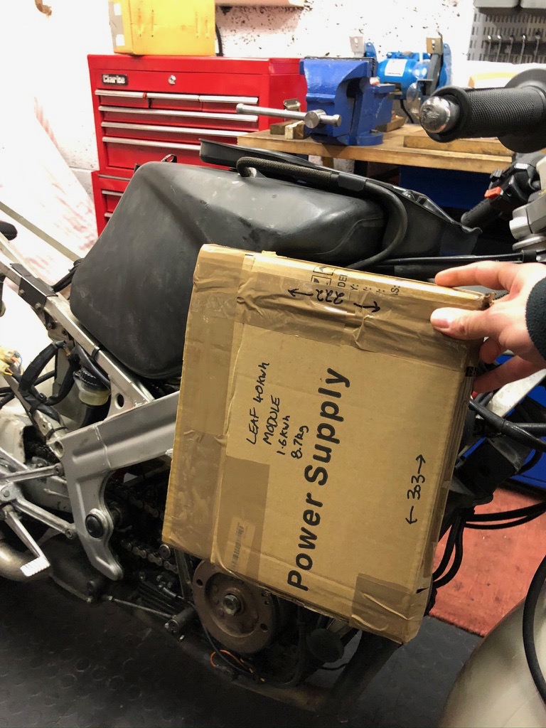

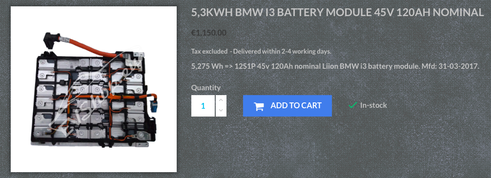

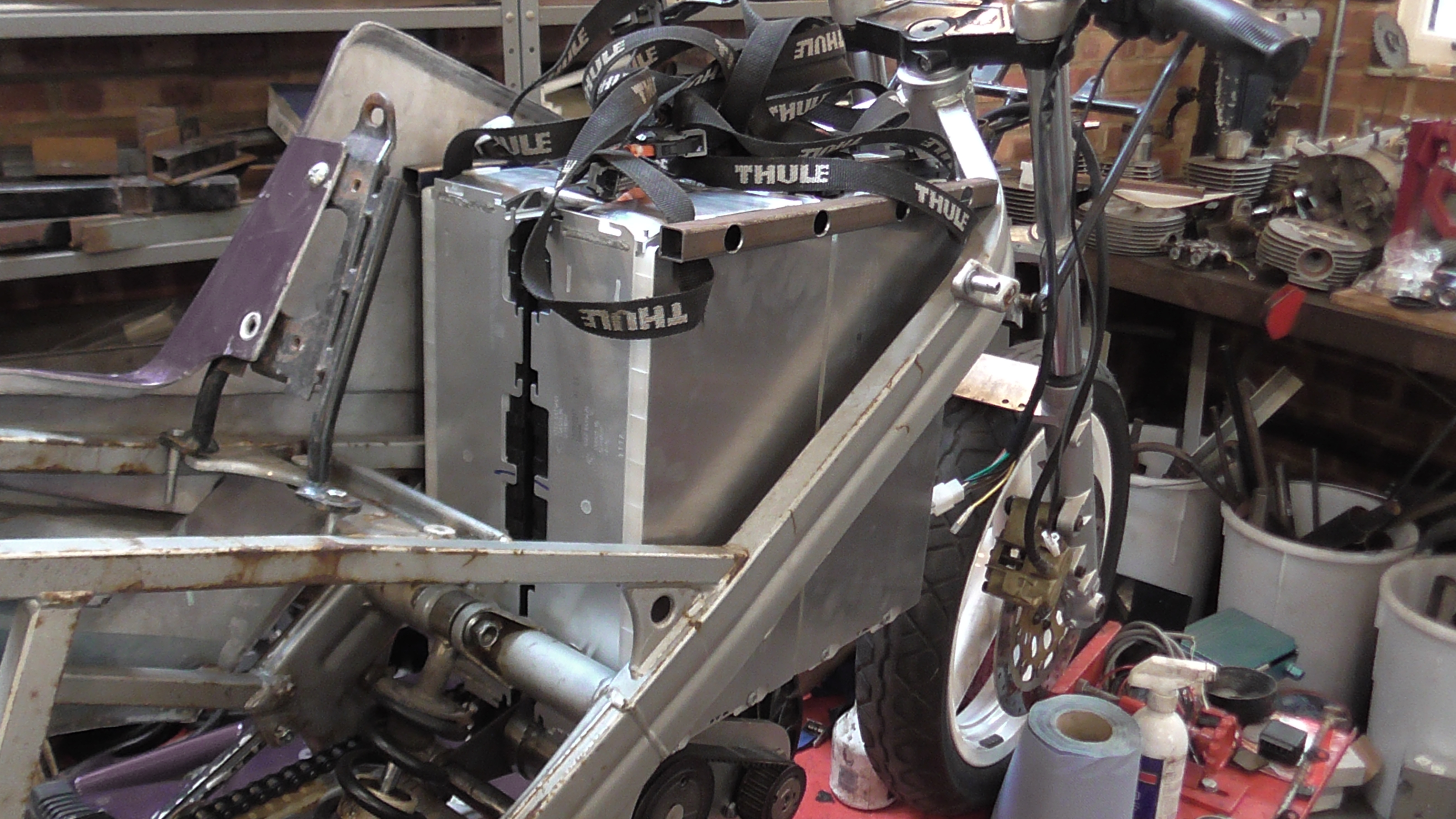

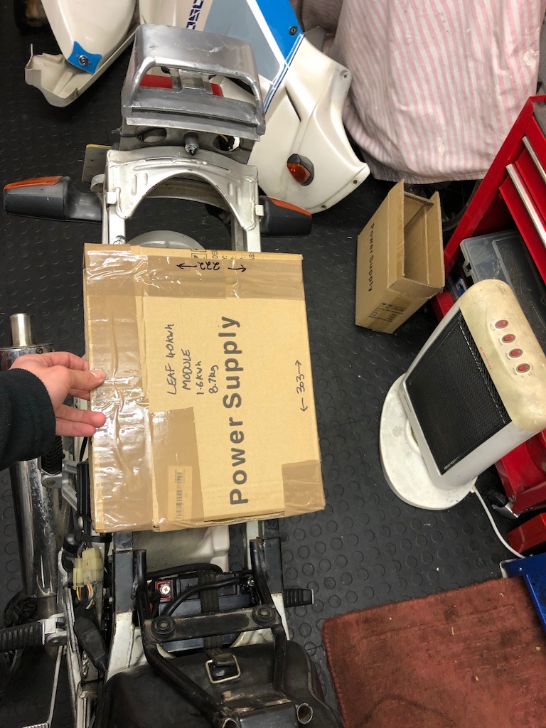

I've had a go at measuring up the space for the various components and it appears that 40kWh Leaf modules are NOT the way to go. They're just an awkward shape for a bike and don't really fit anywhere.
I think what I need is a battery pack made up of discrete cells. Which brings me to my latest idea:
2x battery modules from a 120Ah BMW i3.
This will give me 10.6kWh at from a mere 56kg - but only 90V. The beauty of the i3 pack is that it's a 12s arrangement, so the cells form a single string.
The advantage of using complete modules electrically is I think I can retain the existing BMW BMS (while unpacking and spreading the cells out according to where I can find space).
Can I get away with such a low voltage? Unfortunately a standard 27KV motor would spin to only 2,400RPM at 90V, which only gives a a top speed of 60MPH (using the standard 14/39 sprockets). I could change the front sprocket to 23 teeth and that would give me 100MPH. However, the motor is also available with 55KV windings, which presumably would give a theoretical 120MPH on standard gearing. Is this a better approach?
Thoughts?

clanger9 wrote: Wed Apr 01, 2020 4:08 pm Can I get away with such a low voltage?
I have a quad bike that uses a 72V battery and has a top speed ~60mph 8-) It should be easy to achieve highway speeds with some simple gearing (chain and sprocket on a bike).

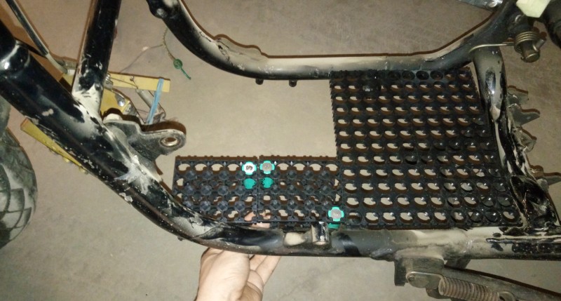

You can buy clip together 4x5 grids for 18650s, and then start to plan out how many and where you can fit them on your frame.
I wouldn't be too worried about the lack of BMS. Especially if it's only 100v. Build it capacity-matched, throw on a Bat-Bridge as a warning light, and then manually balance once a season.

More ideas from today's workshop session. It appears BMW i3 94Ah cells would be ideal! :D
https://pushevs.com/2018/04/05/samsung- ... fications/
30 cells would give me 10.5kWh at 111V - in only 60kg. Here's an approximation of 6 of them stacked together:
Even so, it'll be a bloody tight fit! The battery box and cabling will be {ahem} interesting...
Unfortunately, there isn't space for a Prius 3 inverter, no matter what I try. :?

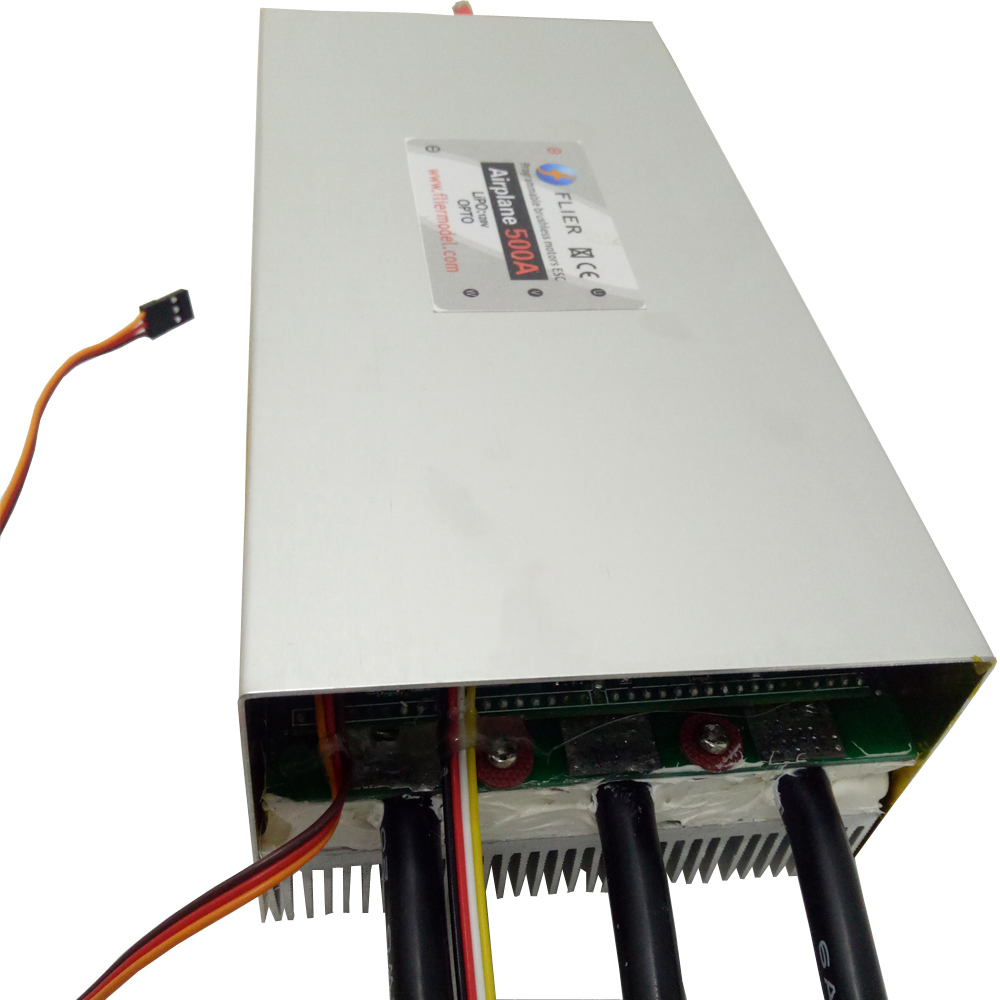

So I'll need an Elcon TC HK-J 3.3kW charger plus either a (pricey, closed source) Curtis Model 1239E inverter or a (scarily) light & compact Chinese drone inverter. Specs are impressive, but it looks like it'd destroy itself if you looked at it funny.
https://fliermodel.en.alibaba.com/produ ... A_esc.html
If I go with the Chinese 500A thing, it'll fit under the seat, which is ideal for air cooling. In my diagram, I can swap the position of batteries 1 & 2 with the inverter.
Anyone tried one?

Well, here's the answer: apparently those Chinese "500A" inverters are pure garbage. :(
Great video, by the way. Time for another rethink!
