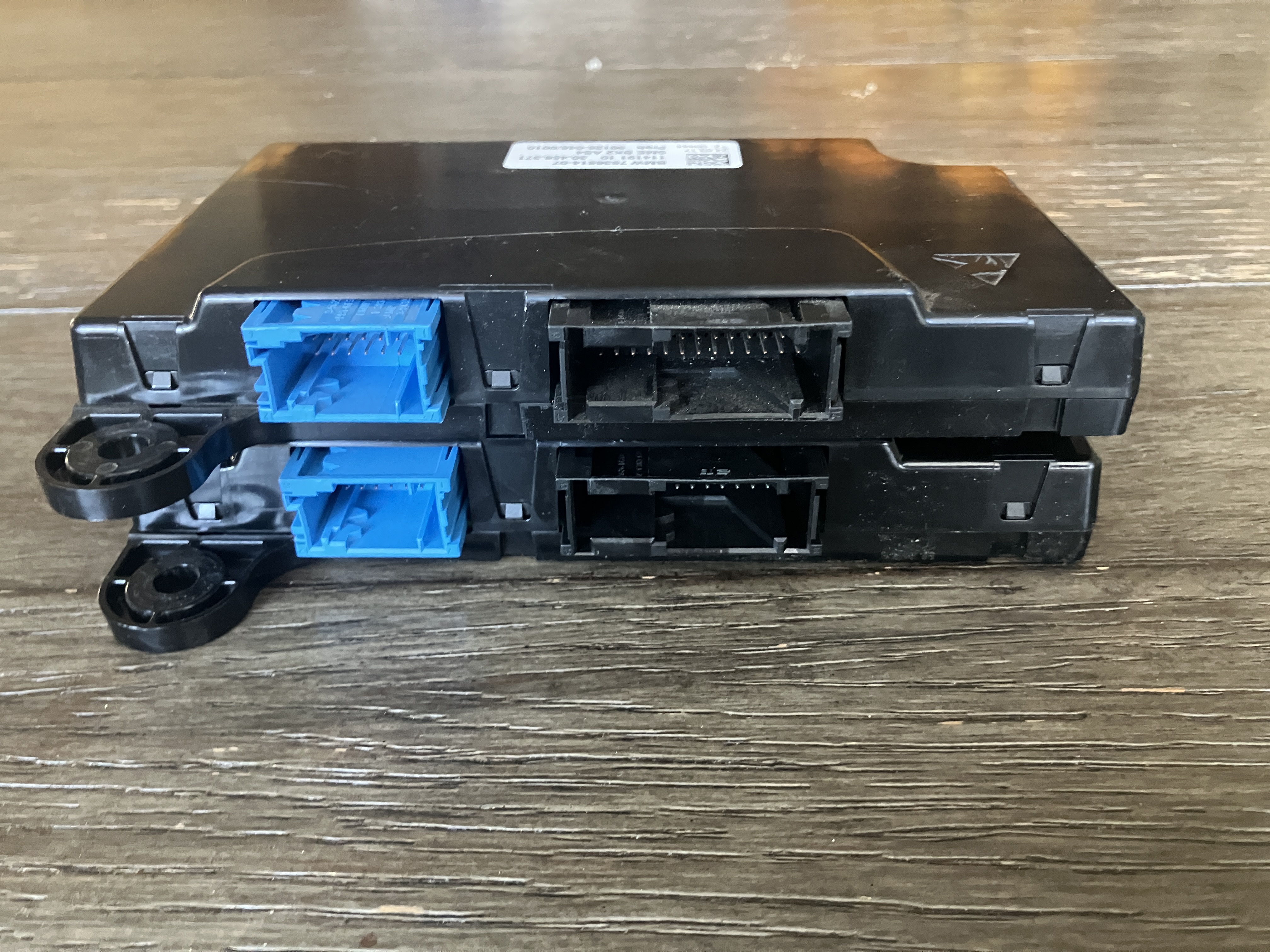

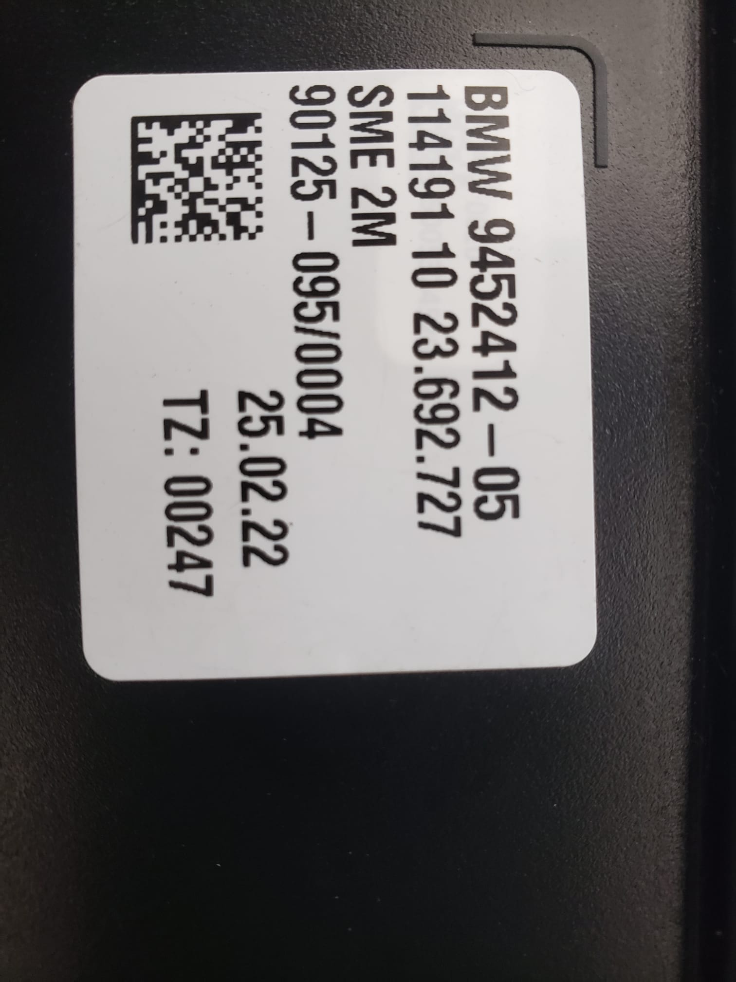

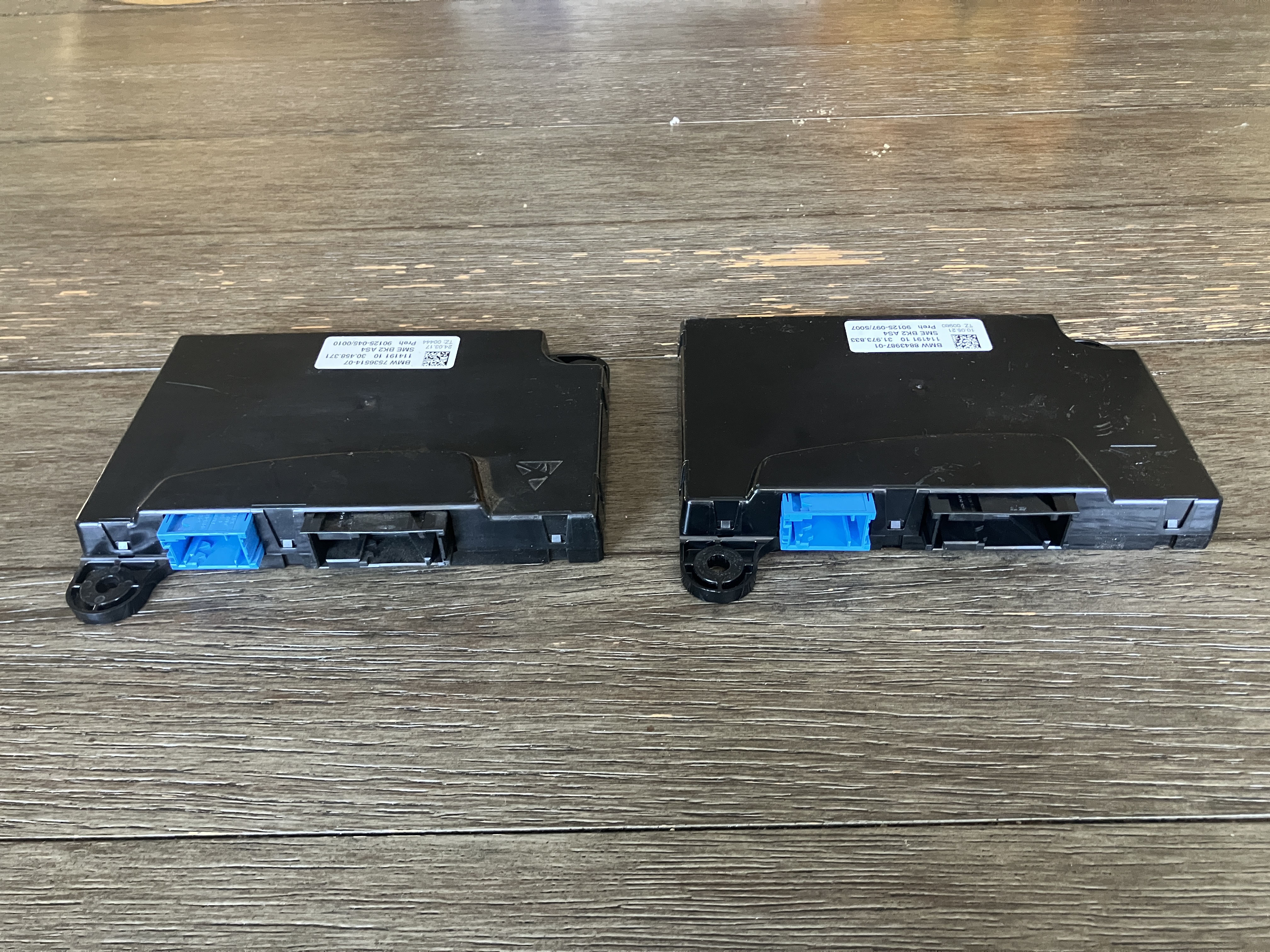

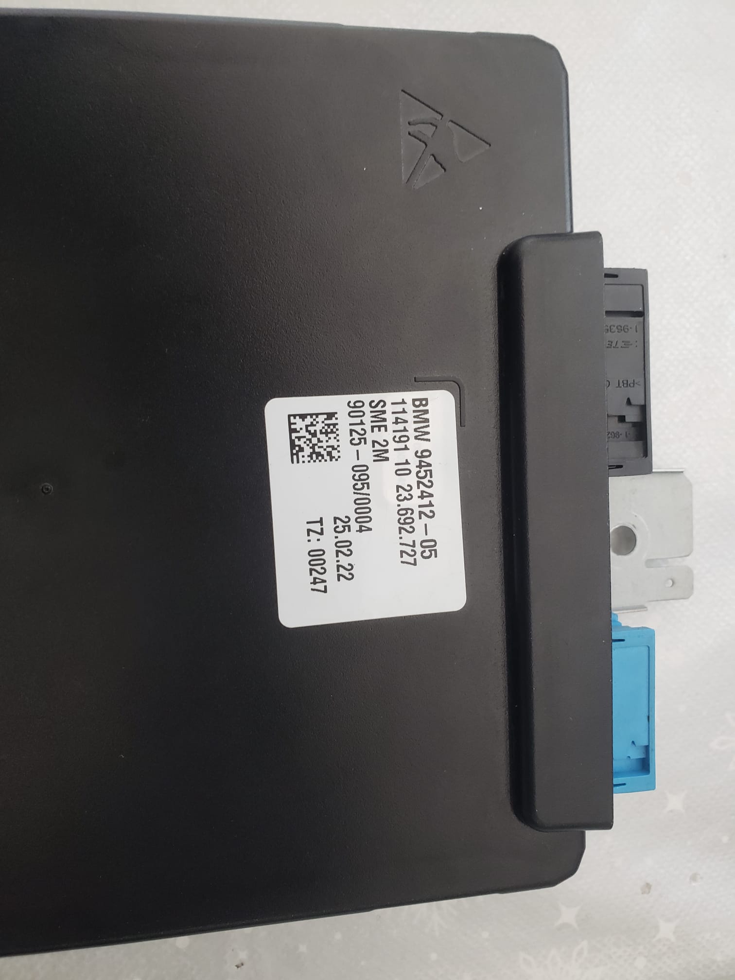

better late than never
the BMW hybrid BMS master module Gen 1 vs Gen 2
FYI: I was able to plug in the Gen 1 wire harness into the Gen 2 module
I plan on uploading pics of the Gen 1 and Gen 2 BMS wire harnesses next
part number comparison

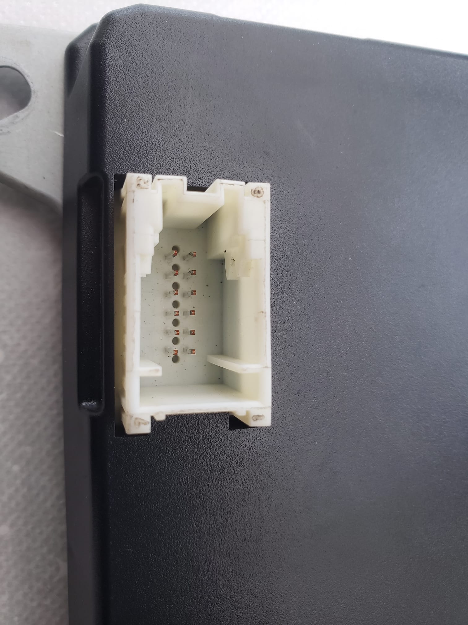

I am working on bmw mini EV.....could someone help me out with a wiring diagram for the SME module please...I want to power the module up and gain diagnostics to it....i have a issue with 12 slave modules and no Can communictaion..

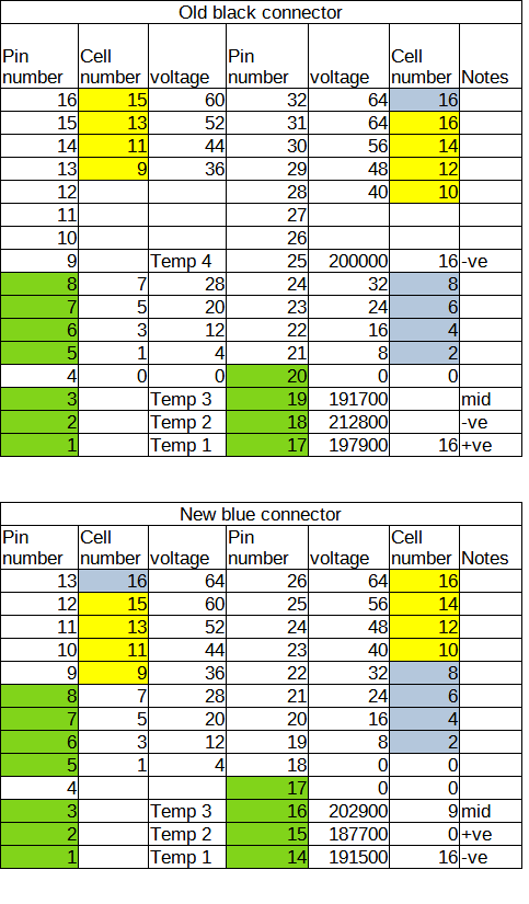

I have done some teseting on the BMW battey connectors
I think the best way to use the newer 34Ah batteries in the old BMW hybrid packs is to swap the pins in the connectors and use the same BMS system.
There is a risk of shorting the cables so if you are doing this I recomend that the pins are swapped one at a time and double check before plugging back in.
I have included the pin outs of the two plugs below for info:-
sprocketman
Posts: 55
Joined: Tue Jan 21, 2020 7:58 pm
Location: Cumbria, UK
Post by sprocketman »
Temperature valves are in ohms not volts
