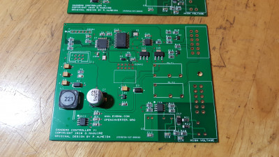

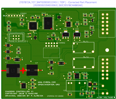

Now that JLCPCB are back to normal I've ordered some chademo controllers. Design files and those all important JLC bom and cpl uploaded for those adventurous souls among you.

Chademo controller boards in production.

Chademo controller boards have arrived from JLCPCB:)

Design files on github : https://github.com/damienmaguire/Chadem ... Controller
