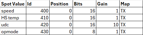

Receiving CAN is as follows:
0x190 Dec 400/Open Inv Msg. for RPM - speed 16 bits gain 1 start 0
0x19A Dec 410 /Open Inv Msg. for temps HS temp 16 bits gain 1 start 0
0x1A4 Dec 420/Open Inv Msg. for Voltage - udc 16 bits gain 10 start 0
0x1AE Dec 430/Open Inv Msg. for Opmode - opmode 8bits gain 1 start 0
