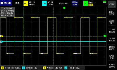

Latest - I disconnected Temp Sensor from board - there is now square wave on all driver inputs. Unfortunately, although the is a signal at the optos, there nothing out. The TVSs removed have been replaced, so I think I'll replace optos on 1 board first, then check again...S

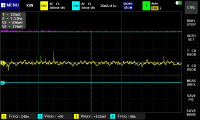

A final check of the day revealed that there Is a sq wave on the Opto outputs And at the gate outputs but this is only about 1 volt (read from scope scale).

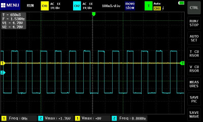

Update - I now have clean square wave to driver boards. I checked volyages from DC-DC 15.5, 0, -9.2 (all boards similar). Checked voltages and waves on Driver outputs (photo -blue trace). Not sure where to take output readings from, so did Gtop - Etop, Gbot - Ebot got +/- 24v on scope on both (photo - yellow trace). Am I right thinking this is OK ? Thought I'd check before connecting to expensive IGBTs :) .... Thanks

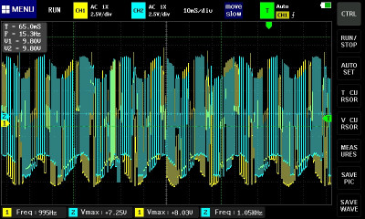

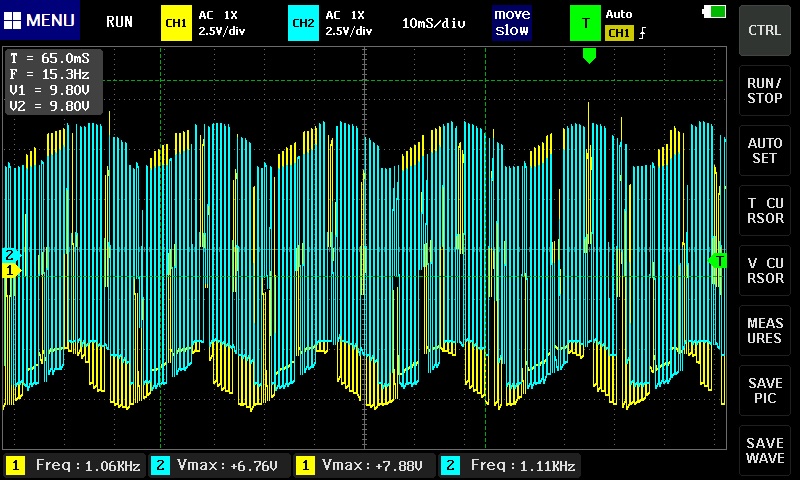

Hi, I've set everything up and given it a run with the motor connected. The motor doesn't run (or at least I can't hear or feel it running).
I've scoped 2 of the phases and get what looks like sine wave to me. I've also tried a combination of various values for fweak and fslipspnt, ampnom remained at 100. Nothing I do seems to make the motor spin.
I note from the scope, that the voltage on the phases stays at a peak of 9.3v. This looks quite low to me, as the bus voltage is 40v.
Have you any ideas what I can look for next ? Many thanks....Steve

Set boost to 10000 and fweak to 20 or so. Assuming it's a 400V motor?

Post by uhi22 »
The scope screenshots say "AC" for the input divider setting. This leads to measurements which are centered around 0V, even if the physical voltage would be unipolar. This makes the interpretation more difficult than necessary. The yellow graph of 16.Nov. shows square between +12V and -12V, this is not the reality, because as I understand the driver is supplied by +15V and -9V.
I propose change the scope setting to "DC" for both channels.
And care needs to be taken where to connect the scope ground. Especially if measuring two phases. E.g. connecting two scope grounds at two different E_top would create a massive short cut, you do not want this. I would propose to use batt- for scope ground when measuring the phase voltages.

Post by Esbro »
Thanks johu, I'll try that. My motor is 208v.
Hi uhi22, thanks for your comments on the screenshot. I hadn't realised that the setting AC or DC would give a different interpretation.
This is my inexperience using this scope. I will certainly change the settings and try again. Regarding the grounding - I am using the heatsink plate for ground and, at the moment, the -ve from the bench power supply is connected to it. The scope is battery driven.
I hope that these arrangements are suitable. Thanks again for your input. I need any help I can get just now - I've been fighting with this for over 12 months now ! ... Steve

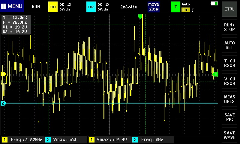

Hi again, johu 1). I tried to run with boost 10000 and fweak 20/30/40. The result was that the waves were as before, the motor didn't run and, over about 5 minutes, the heatsink (chillplate) rose in temperature to around 35C (at which point I panicked a little :) and shut it down, as there's no cooling connected). The 10A fuse I had in the battery supply melted (a bit), but the 15A replacement was ok. I let the heatsink cool down over night while the batteries were recharged.
2) Hi again uhi22 ..I changed settings on the scope and, to me, I couldn't tell the difference. The trace still seemed to be centred on '0'. This time I only used 1 channel for safety.

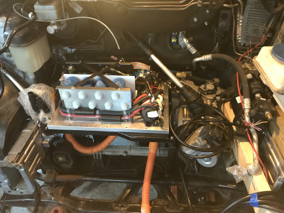

Today, I tried various settings and got a barely discernible hum/vibration from the motor, so I have decided to drop the sub-frame/motor out of the car to inspect the motor on the bench. The wave on the phases is on the photo. settings fweak 40, fsilpspnt 120, ampnom100 and boost 3000. These are all arbitrary numbers - as in what the hell..... :D
Taking the the motor out was my least favourite option. Why ?.. see photos. but it looks like that's what I have to do.

Posts: 6713
Has thanked: 369 times
Been thanked: 1542 times
Re: Mainboard V2 troubleshooting
Well fslipspnt=120 ain't gonna do much, it dumps 120 Hz onto the stationary motor and the latter converts it to sound :) Put 3 Hz or 5 Hz and slowly increase as the motor spins up (if it does)
