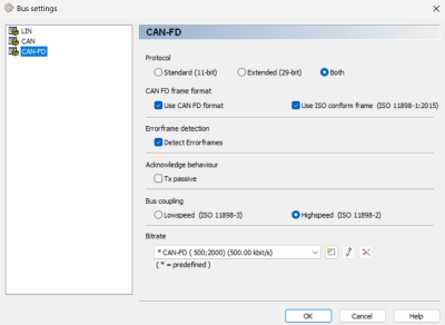

cloudy wrote: Sun Nov 03, 2024 9:21 pm It won't send CAN on it's own & it's also CAN-FD at 500/2mb - not standard CAN. You can hold wake high it seems - and it'll stay awake waiting for CAN. It'll start sending it's messages with just a counter sent to it on 0x0C0 (you'll see it in the code)
Hi, I finally got around to this project again. Now have to get the BMS working (or replace it with something else)
But I can't get the CAN bus to work with my analyzer (I have a Lilygo board, but it is not FD).
I've set it up as CAN-FD 500:2000, and tried various other settings.
I have wired it up as in the Battery emulator wiki and am sending it the 0xC0 message every 200ms with 0xF0 0x00 and increasing 14 times to 0xFE 0x00
I'm still getting no response and sometimes errors so I am not sure if I have misconfigured the CAN bus? I added a resistor, so it is sitting around 60 Ohm now.
It should send at least some data right? after the wake up. No requests needed to receive at least something?
By the way, I wired it directly on the picture below. Not through the board in the main connector, which doesn't seem to add much.
I only have the battery modules, the long CSC board, and the manager in the picture below.
Perhaps that is too little to get it running?

Recommend joining the battery emulator discord as we have a lot of people working on it. No the BMS will not send any traffic on it's own - you have to wake & poll it continuously. Suggest starting with the battery emulator working code as a starting point or use a BMW BDC to awaken it. We have contactors closing for non crashed packs, but even then they lock out after a few days.
