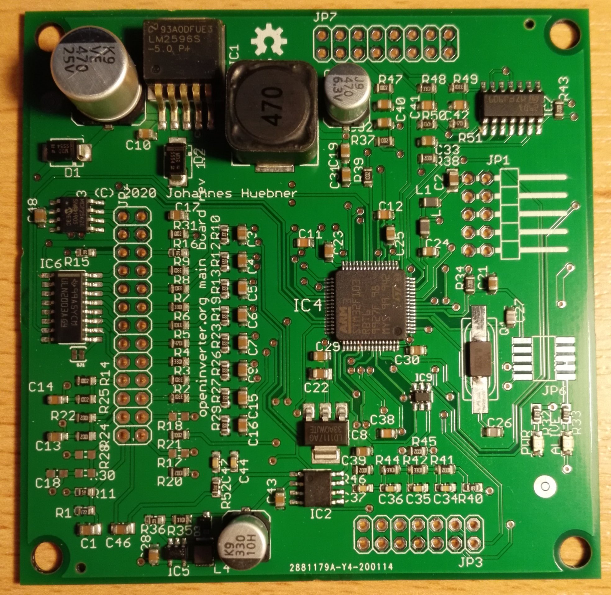

10 boards arrived from JLCPCB today. Needless to say the quality is amazing.
Thankfully there was only one little mistake: the tiny NAND gate (IC9) has a SOT23-6 footprint on board but I put an SC70-6 part in the BOM. SC70 is even smaller than SOT23 so not all pins actually reach the pads. JLCPCB placed a small sticker with an arrow next to it to catch my attention. Nice touch!
Still I only understood their hint after my automated board test failed. Yes it did fail and thus successfully identified an error
The fix is easy, just bend the pins outwards a bit and add some solder.
Sent 5 boards out today and 5 are left. All necessary files on github (including the SC70 problem..). Video coming.

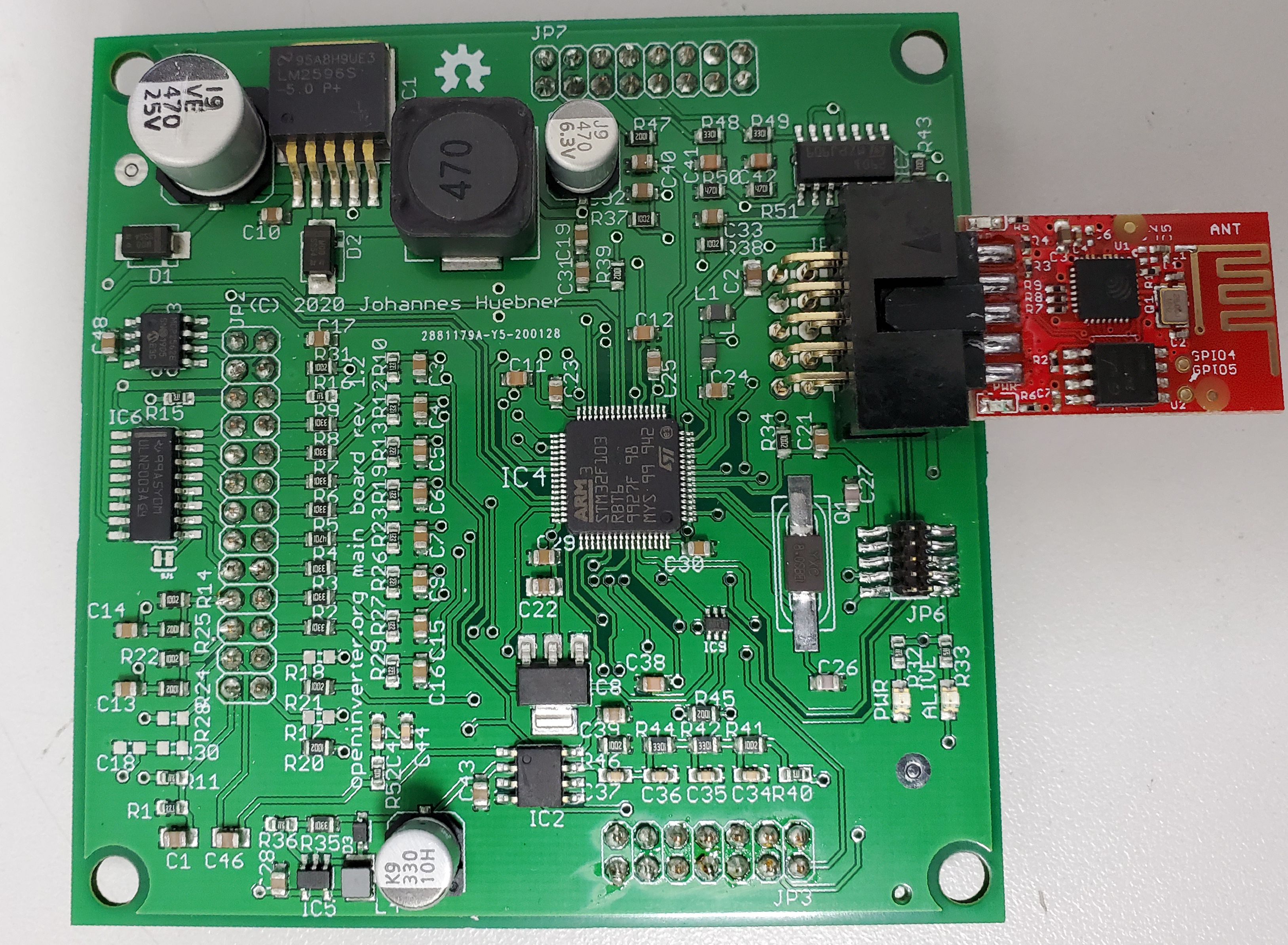

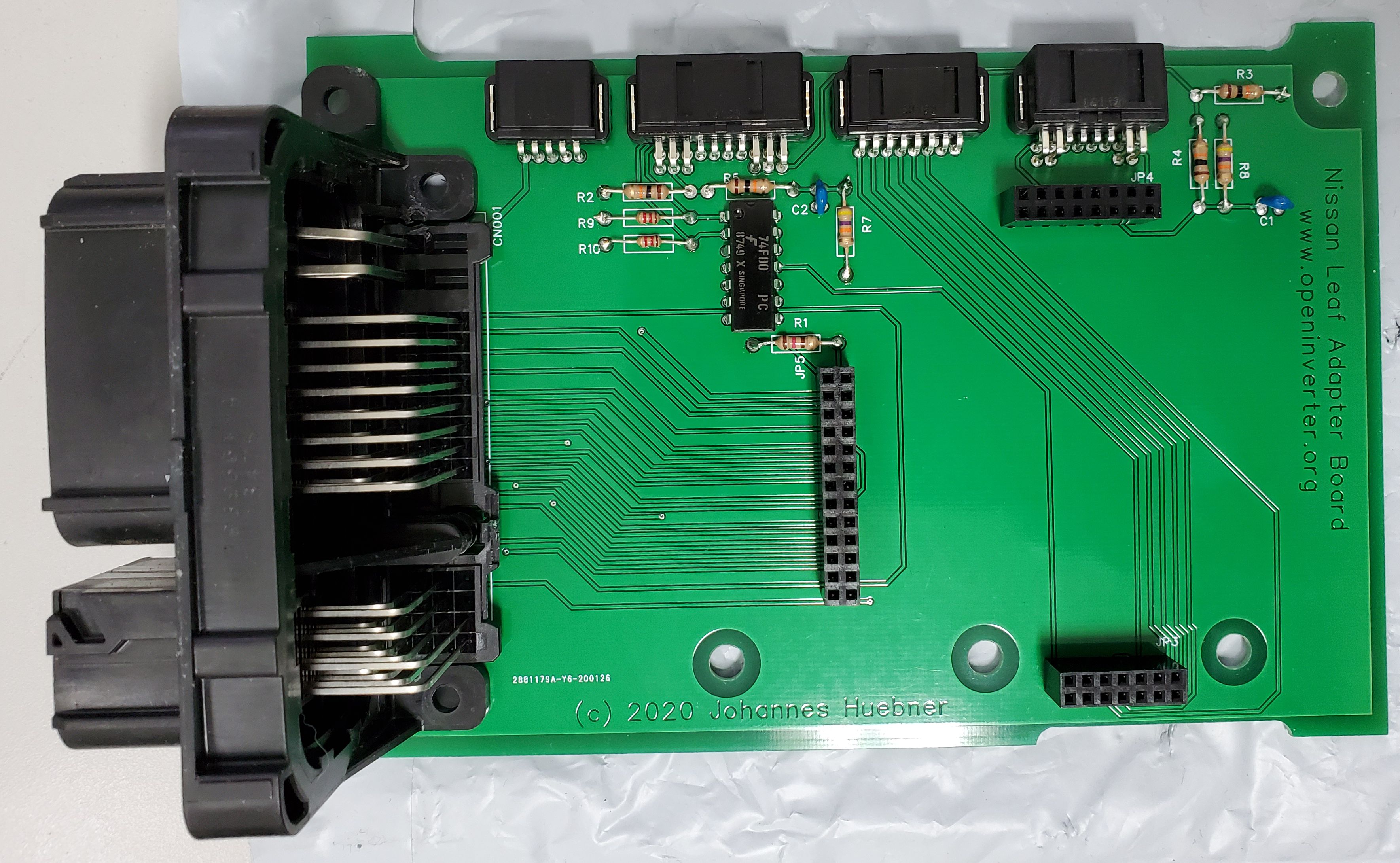

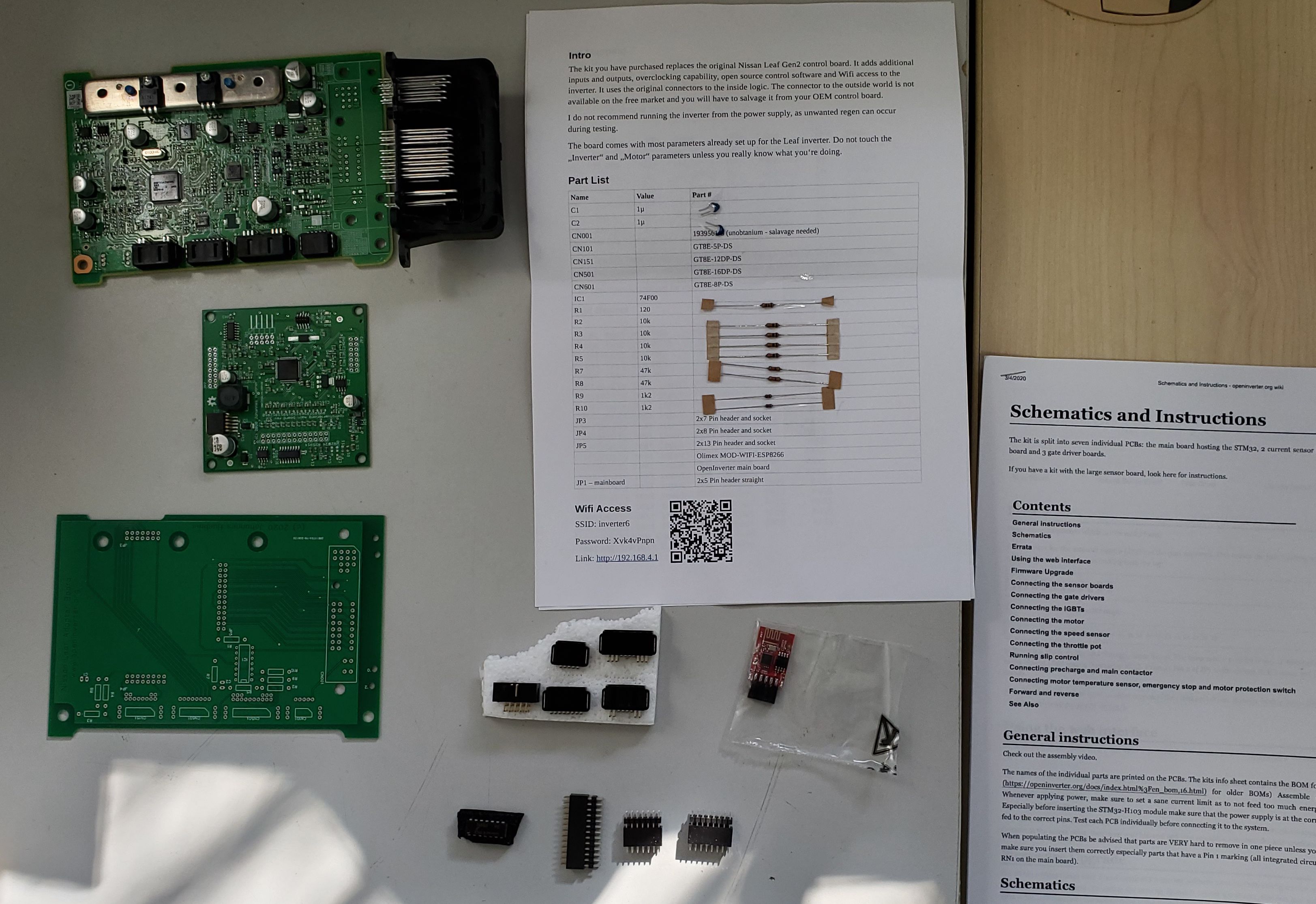

Johannes, I received my v3 main board and the nissan leaf inverter adapter board and I did the preliminary work of installing all the through hole parts. Your design and directions make it so easy for a non-EE to do the work. I also went back on your youtube channel and watched all your videos.Of particular interest for me was Lab updates 16-27 (I haven't finished all of them yet. But you obviously spent an unbelievable amount of time for us DIYer's. Thank you for that!
Now starts the big learning

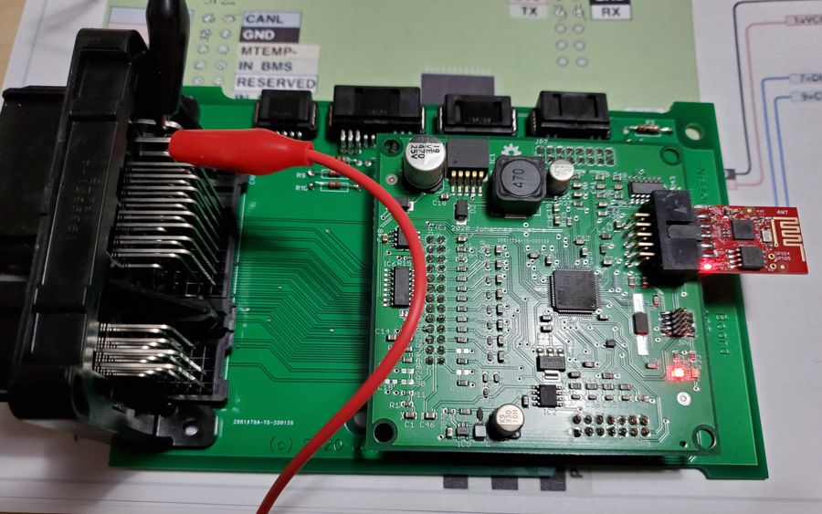

Success on first power-up!
Very pleased with my self.
I also connected via wifi too.

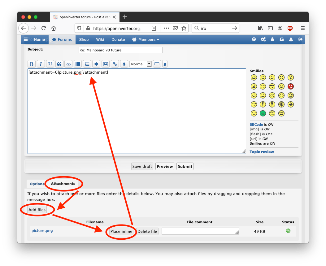

Sorry, I can't figure out how to attach a picture. [SOLVED]
Previously I chose the little picture icon and put the url between the tags.
I edited se last two posts now and just pasted the url.
But how does one attach a picture?

With help for a newbie from generous forum users, I have edited the post and fixed the pictures.
