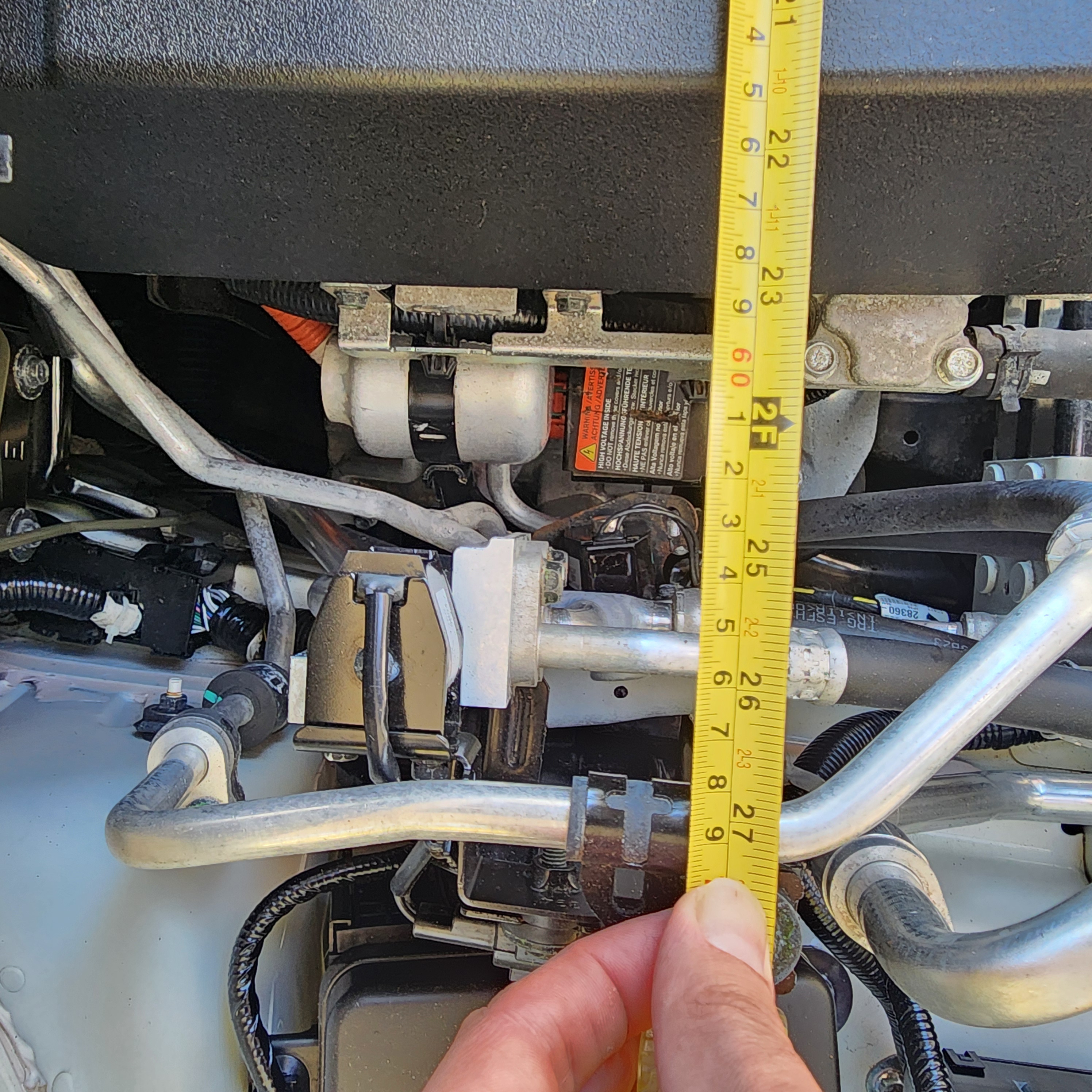

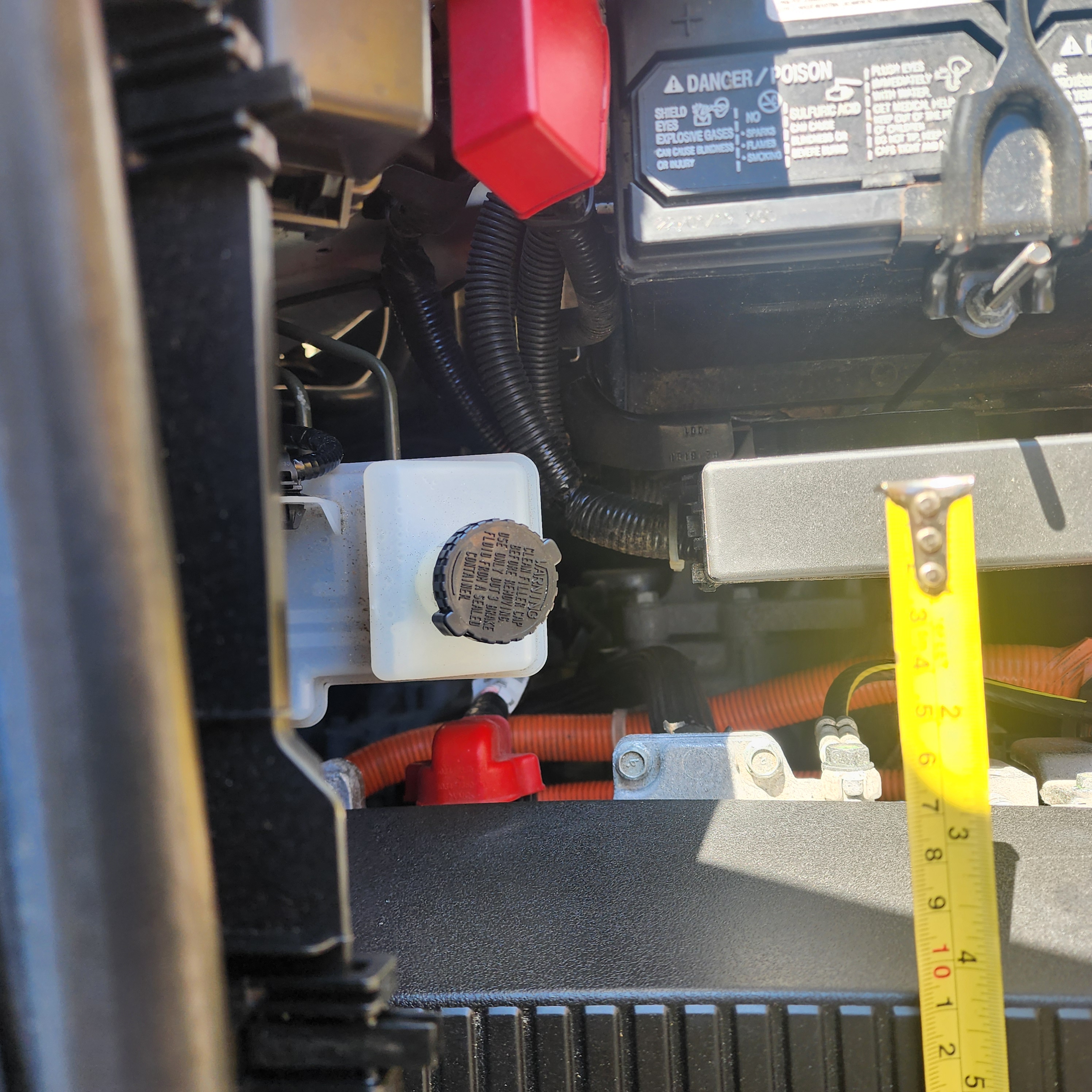

From another thread. Receiving this and dragging it here to try to keep it a bit cleaner.
ianlighting wrote: Sun Oct 20, 2024 5:34 pm Does anyone know the height of the later Leaf PDM? I know the lid looks a little different to the earlier domed ones. I am height constrained so may consider swapping the PDM, but I can’t find dimensions anywhere.
My wife bought a 2019 160kw / 62kwh Leaf (gen 3 inverter.) it's staying stock.
Not sure why these flipped...
The top width is from the parking actuator? to the right side motor mount.
The tall 69cm / 27" height is to the belly pan.

It’s not completely clear to me but appreciate you sharing. It looks to me like I might expect later gen PDM to be 245mm high. Although yours is in situ in the vehicle from what I can tell. So hard to be 100% sure where the measuring point is starting. But it’s a good start.

ianlighting wrote: Sun Oct 20, 2024 6:52 pm It’s not completely clear to me...
Yeah it's in the car, makes it tough to get a good picture.
Measurements are from the dots of each layer (bosses to top cover.)
Without scribbles,
