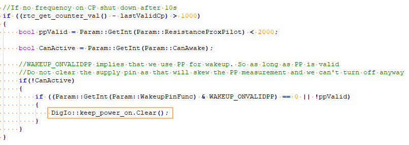

uhi22 wrote: Fri Oct 04, 2024 4:15 pm The PP resistance measurement is disturbed via the path R64 (1k to 12V), D21, PP_WAKE, JP3, PP. As long as the controller sets KEEP_POWER_ON=1, everything is fine, because Q3 pulls the anode of D21 to ground. But if the controller releases the KEEP_POWER_ON, the voltage on the PP rises, and the controller interprets this as increased resistance.
Is it still possible that KEEP_POWER_ON drops out when it shouldn't? In Code it looks like as long as CP is valid it should stay on

johu wrote: Mon Oct 07, 2024 8:27 am Is it still possible that KEEP_POWER_ON drops out when it shouldn't? In Code it looks like as long as CP is valid it should stay on
It does look to me like CP is at 5% always when the charging process is at checkpoint 710 (=CurrentDemand). This is the Previa's logs (Omega's logs show a similar result):

My impression is, that the conditions to decide to switch the keep_power_on are not robust in all use cases.
For instance, if there is just plugged-in, but the EVSE does not provide PWM yet, AND the CanActive is not yet fulfilled, and the plug is shortly removed (ppValid==0) we turn-off the keep_power_on "for ever". If at the same time, the wakeup line makes us to keep running, we always will get wrong PP measurements.
Been thanked: 1913 times
Re: QCA7000 Foccci+Clara User thread
Oh true, quite an oversight.
So it only makes sense to turn off keep_power_on when all the external wakeup sources are off. In that case Foccci actually powers down. I don't see a case where we would need to Set() keep_power_on again

Well, while we keep running (for whatever reason), we could at least turn the keep_power_on for a moment, take a valid pp resistance reading and turn off again. And discard the known wrong pp readings.

That's starting to sound like a pretty solid plan for fixing all my problems before I've even managed to touch the car let alone do anything useful.

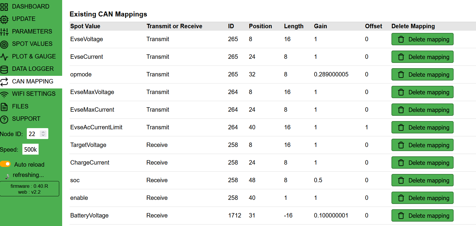

I am experiencing some strange behavior with my focci 5.1 and wifi interface, after playing around with the can mapping and having every message configured properly but one, I can't add messages anymore.
So i got everything powered up, 12v permanent to focci and bms, wakeup of focci when i plug my T2 portable station, I have access to the wifi interface I can modify parameters, start the charge by manually changing the AcObcState from 0 to 1 and to 2. but i can't map any can message anymore. I don't think i have that many mapped.
Argh, yes something goes sideways when playing with mappings for a while. Need to implement the clear mapping command over SDO. Now you can only resolve it with an ST Link by deleting the last flash page (loosing parameters and mappings)

johu wrote: Fri Oct 18, 2024 2:01 pm Argh, yes something goes sideways when playing with mappings for a while. Need to implement the clear mapping command over SDO. Now you can only resolve it with an ST Link by deleting the last flash page (loosing parameters and mappings)

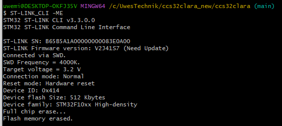

Do i need to reflash the wifi board or the Focci itself ? Maybe there is a guide somewhere that I can follow ?

I do not know the details about the why it fails, but the mappings are at the end of the flash memory in Foccci. So to clean up everything, a "mass erase" of the STM32 on the Foccci board should help. How to do this? Using an STlink programmer, which is connected to the Foccci board via the 3-pin connector SWCLK, GND, SWDIO. And then using the STLink command line utility, with the argument "-ME" for "mass erase":

celeron55 wrote: Wed Oct 09, 2024 3:32 pm That's starting to sound like a pretty solid plan for fixing all my problems before I've even managed to touch the car let alone do anything useful.
The actual fix took a little bit longer, but ready for test now: https://github.com/uhi22/ccs32clara/issues/40
Basically now Clara ignores the PP readings which are known to be invalid, and cyclically (each 2 seconds) turns the keep_power_on active for a moment, to get a valid reading of the PP resistance. On the desk this works, attached an osci plot to the issue.

Zieg wrote: Fri Oct 18, 2024 4:04 pm Oh, interesting. What causes it? Too many things mapped?
I've dug into this a bit as it was frustrating to see so many people hit this problem. It's caused by a memory leak/corruption of an internal data structure when CAN parameter mappings are removed. Unfortunately the corruption is saved to Flash and there is no way to fix it using the CAN interface.
I've raised a bug against the core libopeninv library (https://github.com/jsphuebner/libopeninv/issues/24) to cover the problem. This affects all OI projects.
It should be possible to clear the fault with a serial console attached to your Foccci. Issuing "can c" then "save" will wipe the CAN map and allow new entries to be added again.
Once you have the system running just add map entries carefully. Removing faulty entries works but you can only have 50 parameter mapping entries past or present in the lifetime of the system.
Hopefully there is enough information/replication steps that johu can now address the bug.

davefiddes wrote: Mon Oct 21, 2024 6:07 pm Issuing "can c" then "save"
Unfortunately not, Foccci doesn't listen to terminal commands

uhi22 wrote: Mon Oct 21, 2024 6:31 am I do not know the details about the why it fails, but the mappings are at the end of the flash memory in Foccci. So to clean up everything, a "mass erase" of the STM32 on the Foccci board should help. How to do this? Using an STlink programmer, which is connected to the Foccci board via the 3-pin connector SWCLK, GND, SWDIO. And then using the STLink command line utility, with the argument "-ME" for "mass erase":
Done with full chip erase via the gui stlink utility, but now i have to put an uncorupted bin/hex back in the stm32. I'm using windows and i'm not that computer savvy, last release of clara is v0.22 so quite old.
Could someone provide here or on the git a compiled version ?

johu wrote: Mon Oct 21, 2024 6:15 pm Unfortunately not, Foccci doesn't listen to terminal commands
Apologies for any confusion caused. I did check the clara code before commenting and the serial commands all appear to be there. If it's not intended to work perhaps there is a good chunk of flash space that could be saved.
