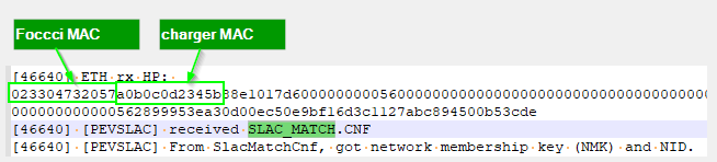

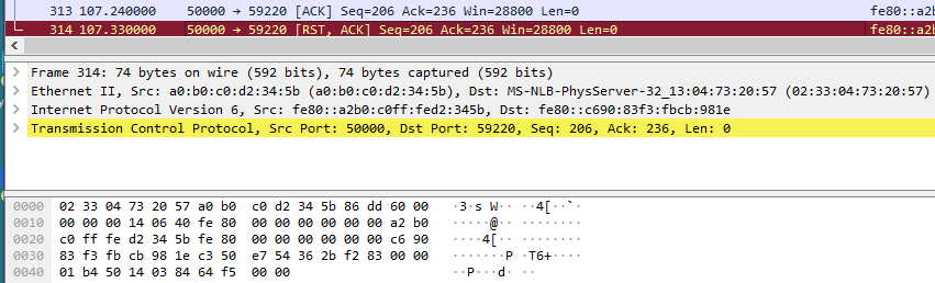

An other interesting finding in this log file is, that for a single SLAC_MATCH request we receive two SLAC_MATCH confirmations, which are addressed to different Focccis (023304732057 and 023428831057), and contain identical source MAC address a0b0c0d2345b.
One explanation would be, that both chargers are using the same MAC address, which would make addressing "a little bit" tricky.

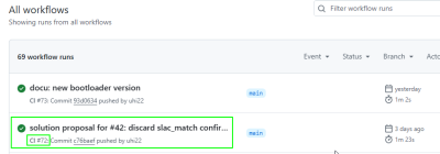

So please do two steps:
1. Use the latest firmware e.g. from the github continuous integration build here: https://github.com/uhi22/ccs32clara/actions
2. In single charging sessions on each charger, check whether both cables of the charger have different MAC addresses. The MAC address of the charger can be seen in the SLAC_MATCH.CNF message, e.g. here: If it turns out that really both chargers use the same MAC (which I do not hope and which should never happen) we need to think about a workaround.

Fortunately, the two SLAC_MATCH.CNF in this log contain to different destination MAC addresses.
destination source
023304732057 a0b0c0d2345b
023428831057 a0b0c0d2345b
So we can implement a filtering in Clara, that it only takes the "personal" message, and discard the message which has a foreign destination MAC. This can be easily implemented in the function evaluateSlacMatchCnf().
Edit: Created https://github.com/uhi22/ccs32clara/issues/42
Edit2: Implemented a solution proposal. Ready for testing.

Try flashing this boot loader: https://github.com/jsphuebner/stm32-CAN ... s/tag/v1.2
- uhi22
- Posts: 1116
- Has thanked: 204 times
- Been thanked: 611 times
Re: Two FOCCCI's on the same bus
Good point, I just updated the clara user manual regarding the new bootloader version.

I tried charging it using two chargers at the same time.
But it didn't work, the situation is the same as last time.
The first charger is started and charging begins. Then, when trying to start the second charger, the start sequence does not proceed.
When charging on the first charger was manually stopped, the second charger's sequence automatically proceeded and charging began.
When I tried to recharge the first charger in that situation, the same thing happened as before.
It's like a seesaw game.
Both Clara version : 0.39.18.B
The logs are attached below.
The addresses of each are as follows:
1 2 I'd appreciate it if you could take a look at the data and let me know what the next steps are.
I checked the MAC address of each charger.
