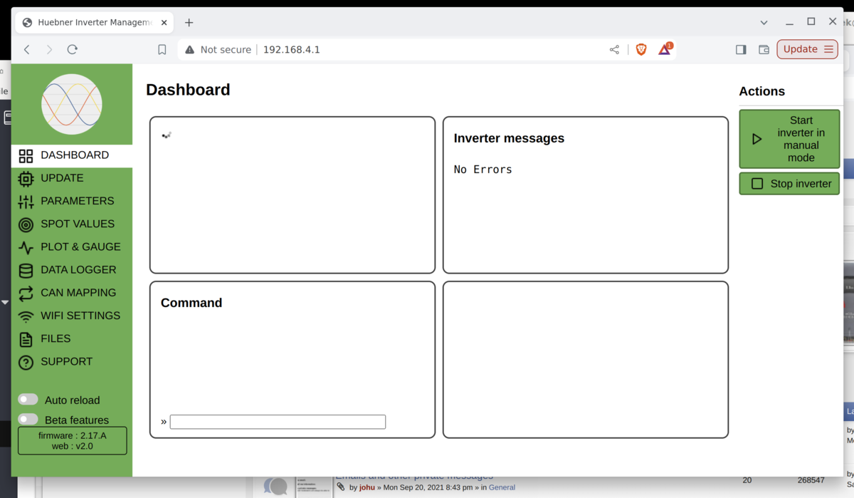

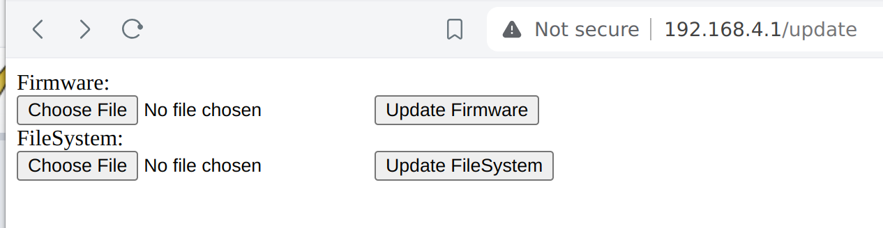

Prepped it all up. I am able to access it via WIFI a http://192.168.4.1
I get an immediate response "file not found" and a couple of secs later the update page shows.
I was reading somewhere that the firmware is already pre-loaded. But it seems not.
I downloaded images from 2.17A from here: https://github.com/damienmaguire/Stm32- ... /tag/2.17A
stm_vcu.bin
stm_vcu.hex
Not sure which one is the firmware file, so i tried both.
When I trying to upload the firmware file, I get the magic error on both.
Secondly what is the filesystem file and nwhere do i get it?

The message youre seeing means the wifi module is missing local files that contain the web interface.
Search forum for curl, that should bring up solutions

I guess I figured how to load the needed files for the web server on the wifi board.
Its' pretty much all the files from here:
https://github.com/jsphuebner/esp8266-w ... aster/data

Here is a small bash script that helps to upload all in one go
$ cat upload_webfiles.sh
#!/bin/bash
IP=192.168.4.1
# curl -F 'data=@ajax-loader.gif' http://$IP/edit
# cd esp8266-web-interface/data
for file in *
do
   echo "$file"
   curl -F 'data=@'$file http://$IP/edit
done
After reboot things look now much more promising. Seems like the VCU board already has the latest 2.17A firmware loaded. nice
